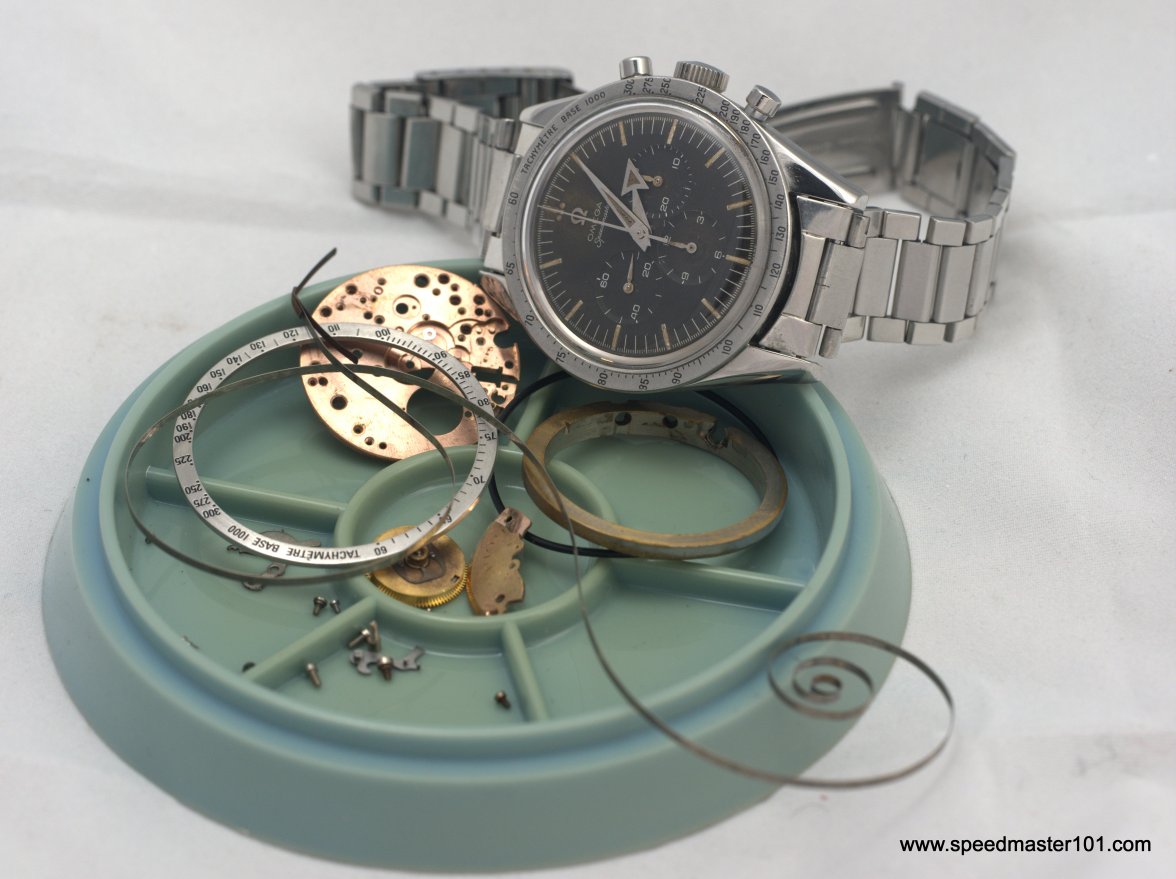

Here is what we replaced inside:
Actually I missed six further tiny parts and screws in the bag. Remember, sold to me as serviced, inspected and running.
Would you mind sharing what was wrong with the mainplate and spacer ring that rendered them unserviceable?
693
705
I was wondering the same thing. And does STS have spare mainplates, or was a doner sacrificed?
383
410
Hello Robert,
the retaining ring is clearly worn at the pusher holes.
Please notice that also the friction spring for chronograph runner seems to have been substituted. This might suggest that an MK2 mainplate has been employed...

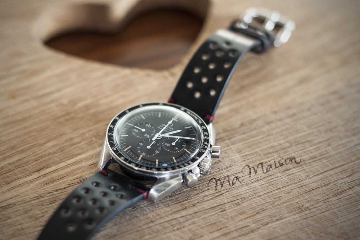

I do indeed have a solution, after all the helpful input and opinions I have decided that I am best to keep the watch, and split the repair costs with the seller.
Proper pics will appear once it is returned from repair. But, for now, just a teaser of one I took before I sent it to the watchmaker
242
171
Good looking speedy, I like the strap.

Hello Robert,
Cheers,
Maurice
Good morning Maurice,
Understood, thank you for the reply.
All the best,
Rob
