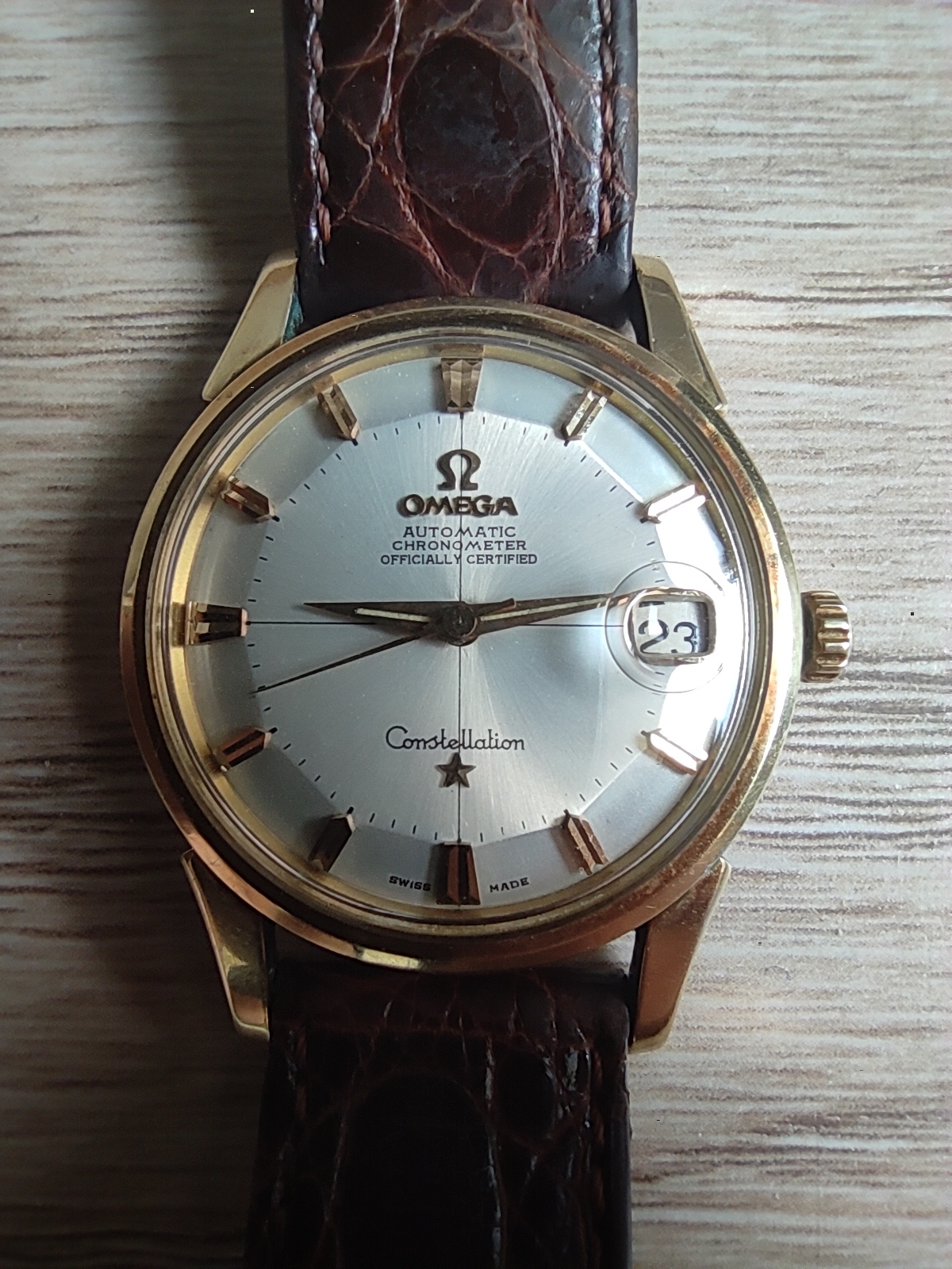

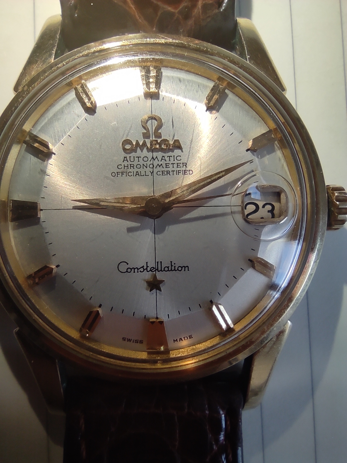

I’d like to have your opinion on this constellation pie pan dial.
The reference of the watch is 14393 61 SC.
It is announced as an original dial but I have some doubts.
On first picture the date window is well sided and looks good to me, so that's a good point.

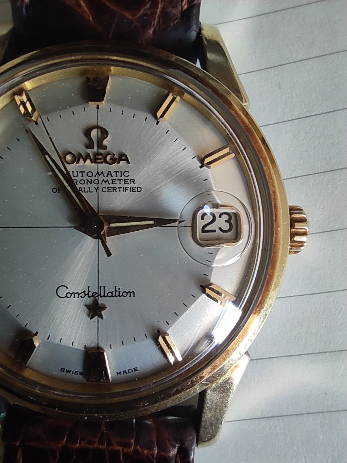

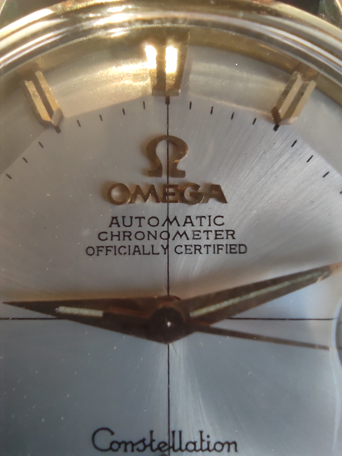

As you’ll see in next picture, the dial fails MOY test but I understood from Desmond site that this can happen.

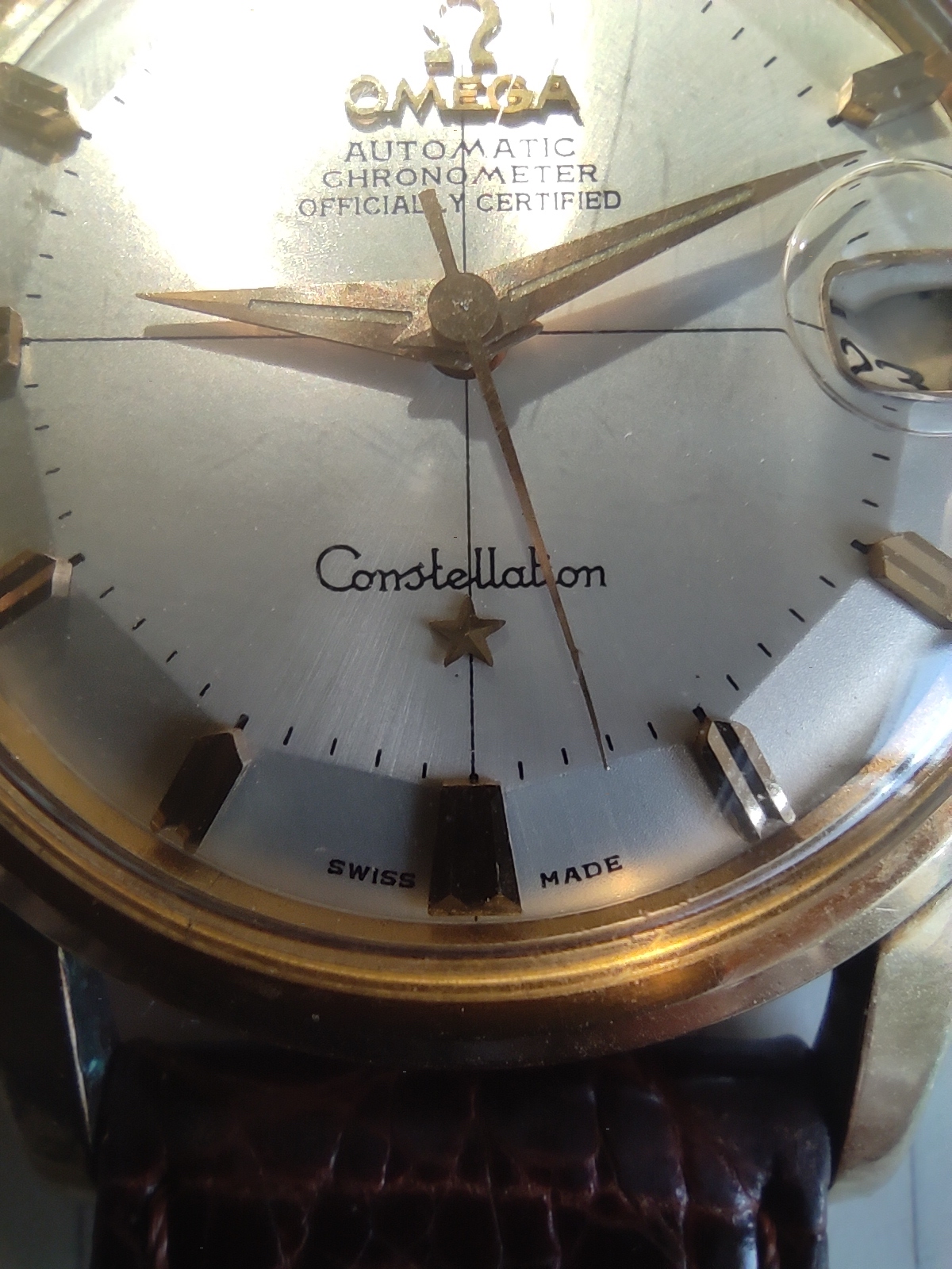

Last pic makes me more skeptical : the « Constellation » font doesn’t seems good for this watch. According to Desmond’s essay on dials, it’s the type of font used in what he called « Third Phase » so if I’m not wrong late 60 / 70.
What’s your opinion on that dial ? Original, Fake, refurbished ?

Hello,
To me, it looks like a redial for sure. The fonts, thickness, position of text and second track, soleillage of the dial… Numerous hints 😀
3,595
13,551
Yup, the seller’s announcement is incorrect, unfortunately. Redial.
6,835
10,503
Well, you can’t say they didn’t put the serifs on the lettering!
Rather elaborate redial.
3,238
6,787
Redial: you can see that on the "i" in Constellation. Minute-hand IMO to short.
6,835
10,503
I think that’s probably the least of its problems 😉
3,595
13,551
Yup, it's just a little weird that they got the serifs printed but completely failed with the sizes of the letters. In "AUTOMATIC" it's all over the place.

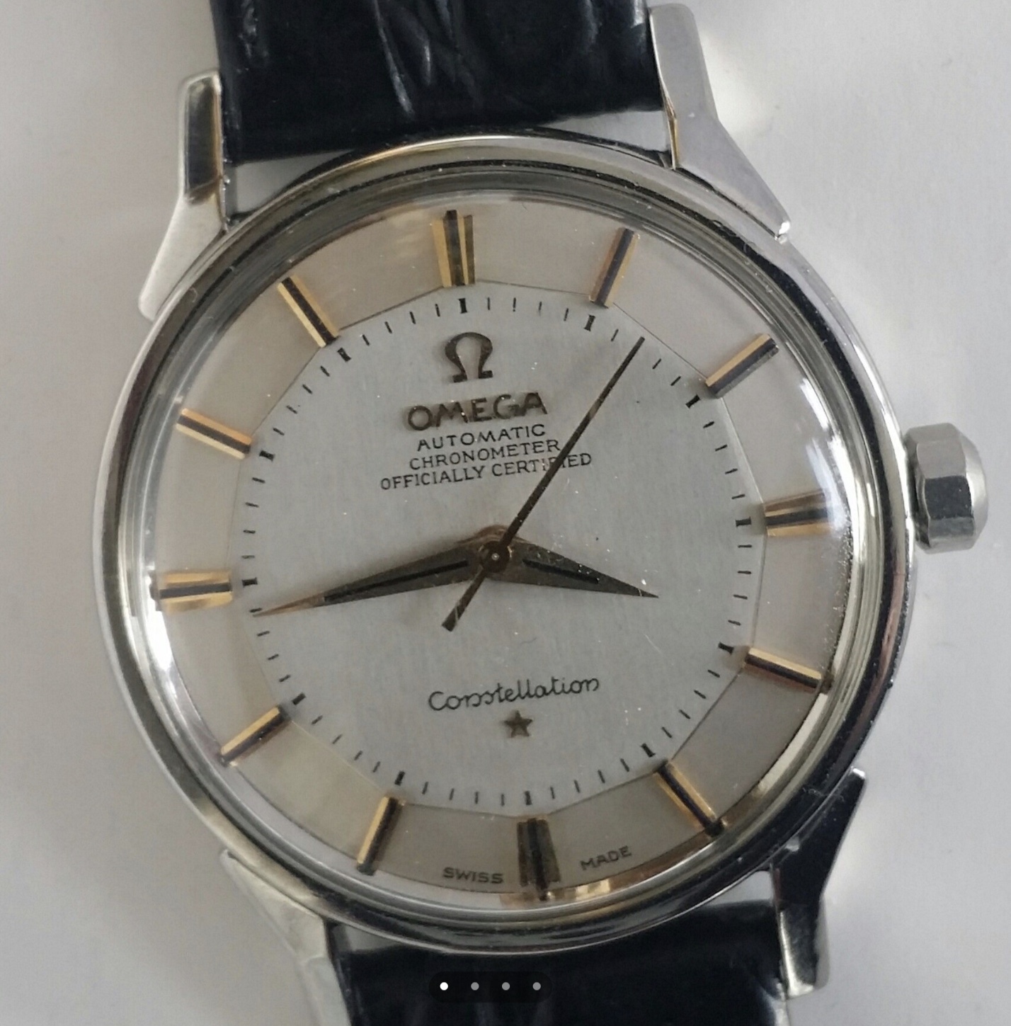

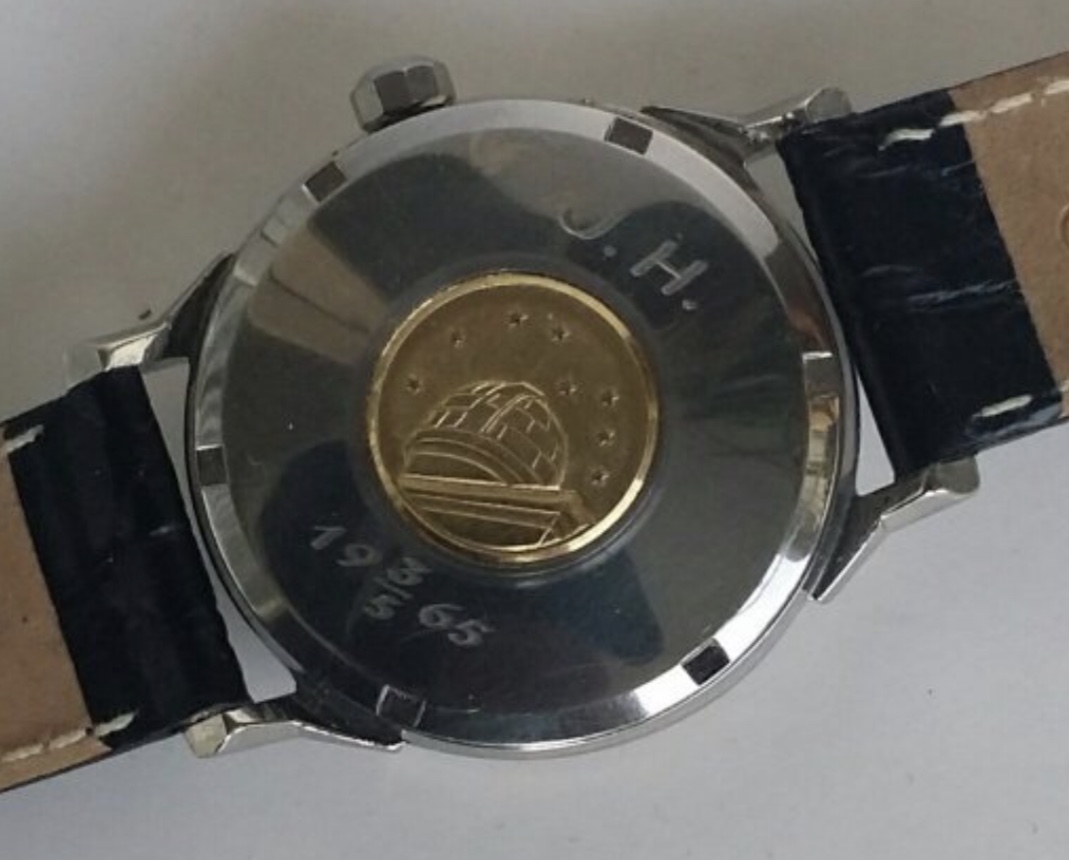

I see some nice redials out there recently, for example this one
https://www.tradera.com/item/190118/473957580/omega-constellation-pie-pan
Must be the same guy - also serifs, also completely wonky writing. Printing quality is worse, though, that's far of a "nice redial" in my book.
@BERTY_CLB You have to know what it's worth to you. The users here are a bunch of enthusiasts who usually wouldn't tolerate redials - regarding the price that means that the watch is worth the sum of the remaining (original) parts. 1500€ will buy you an example in nice condition, all you need is some patience. 😀 For this one, I wouldn't want to spend a 4-figure sum.
/edit: @hejsam is obviously waaaay quicker in typing. My post reads like a c&p now. 😁🤦
6,835
10,503
I don't agree that this is a "nice redial", the quality of the printing and the dial surface looks horrible.
Sorry to say @cineaste
@hesjam is being polite - That is a terrible redial and a pretty awful frankenwatch too.
edit: pics added for reference
