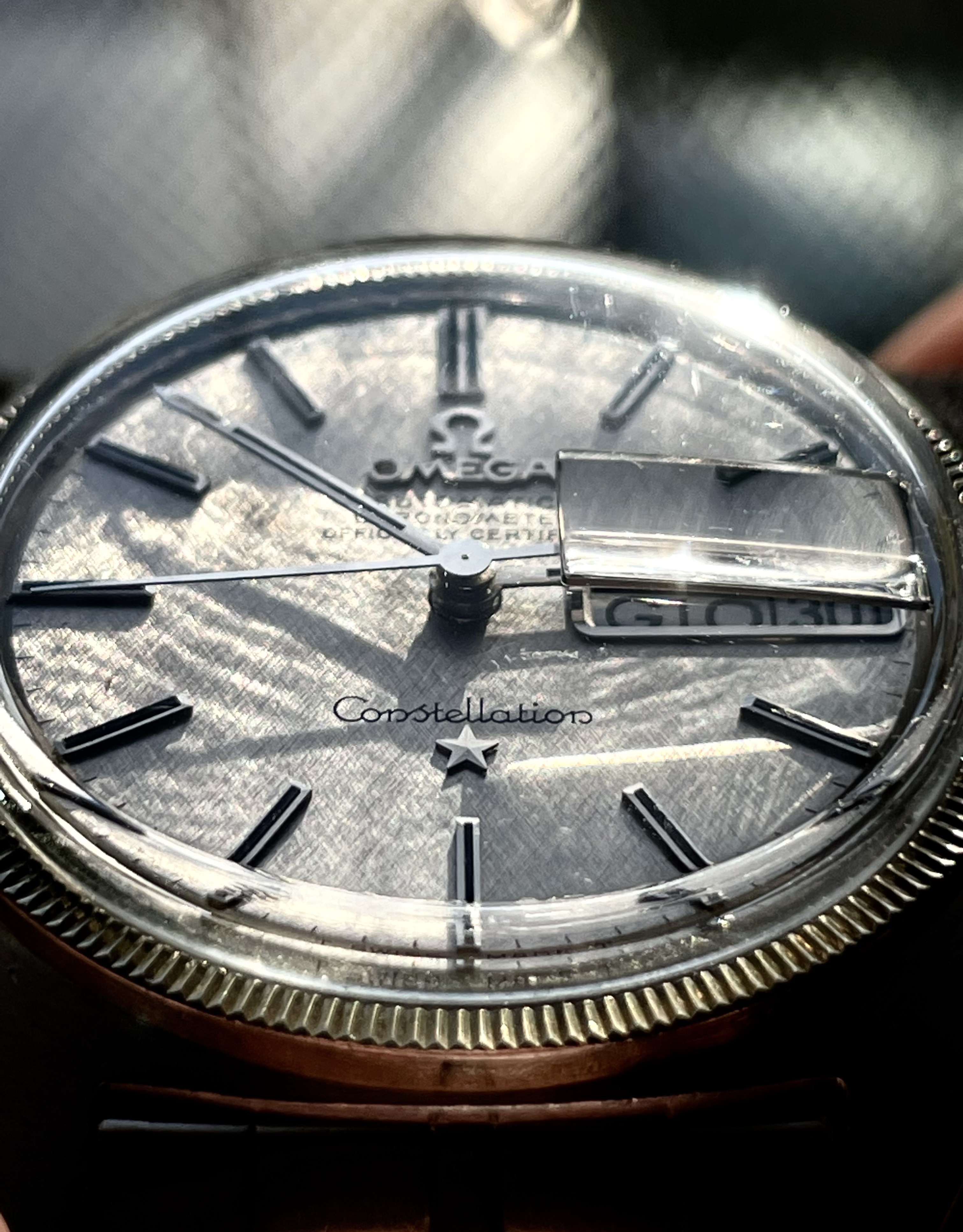

Constellation or seamster conversion
6,832
10,502
That's a 168.017 upper case, now you have to find parts for 3 watches on your quest
Just 3 watches ? - what reference is that dial from?
2,681
3,161
168.017 caseback is good news - the crown also looks like a correct C-Case crown, I'll be up for buying the upper case and the crown with stem if you decide to split them
Worth would be $80
Caseback is I guess $50 in a long sale
You can sell the movement / dial / hands combo for $200 ish easy if you communicate that it's a valid 168.005 serial, Omega did you a solid favor there
6,832
10,502
The dial has:
a painted Omega
Mixed Ms
Straight Ns
A painted star.
it might be from some random 70s c-case but it’s not from any constellation I recognise.
631
788
Hard to tell without a straight on dial photo, but the minute track might be slightly misaligned. Could it be a service dial? Either way, none of the 4 components began their lives together.
43
Hmmm. the thing at the top and the star are both embossed silver does that mean they are still painted ?
I see the mixed ms , would someone really have replaced one?
6,832
10,502

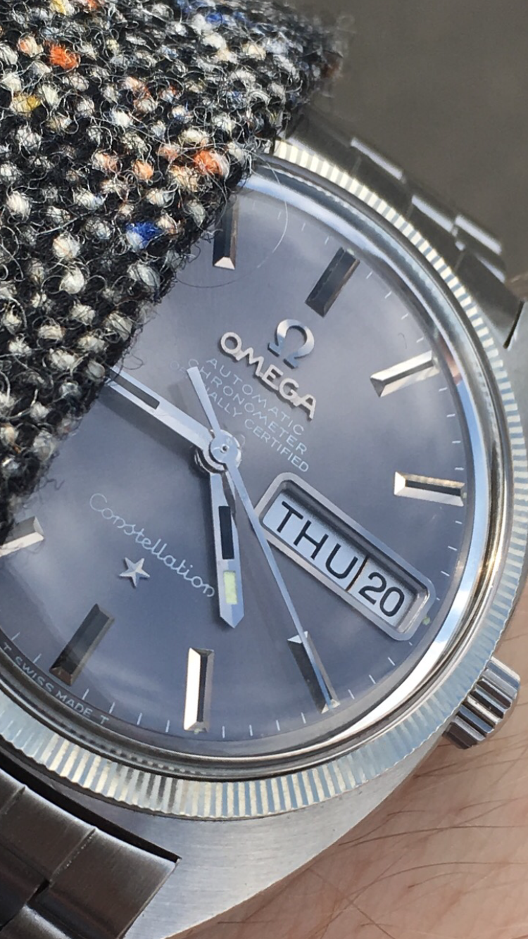

the OMEGA and the star should be three-dimensional applied metal furniture as per this example below
(Photo from c-case thread)
It may be your photos but both look flat and painted on your example.

Theyre both 3d but the star is not as raised as the pic above

3D and made of applied metal ?
They should prominently stand up from the dial surface.
(Like the Omega symbol)
Neither look particularly 3D from your photos.
The OMEGA looks completely flat.
Both look painted on rather than applied pieces of metal.
Again, the photos may be misleading but they don’t look right from what we can see.

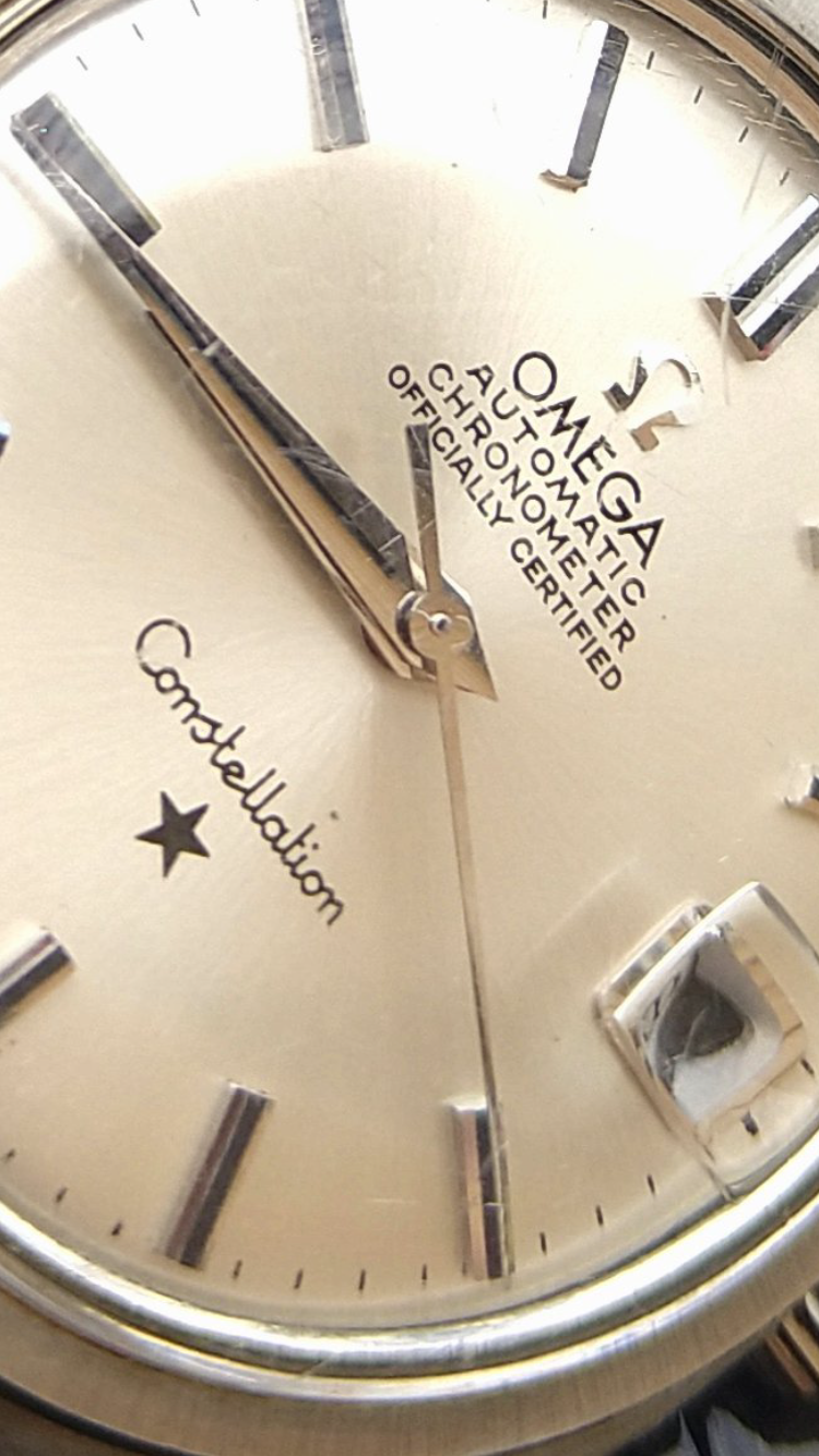

Also just seen this in the c case thread.
Splendid bit of photography by @BrunoCodispoti wonderfully illustrates the applied furniture on a constellation dial.

I see what you mean, so the symbol is raised but the rest is not. I really do have a bit of a turd here.

In terms of originality, yes. Didn’t your partner buy it for you though? I’d get it serviced by an independent and wear it as is.

well, @Milog , there’s no point sugar coating it, if not an actual turd - the mongrel that might produce one.
it’s often the case that when one thing is wrong, then multiple things could be wrong.
This was why we asked for pictures of your watch as it was a fair bet that something was up.
( I’d like to know who at Omega mistook an obvious c-case mid-case for a Seamaster case)
Generally called a ‘frankenwatch’ your watch really is made up of parts from a number of donors.
I know it’s going to bug you because it’s not correct but as ‘bitsa’ watches go, you have a very wearable watch, which looks good and has a great engine under the hood.
I’ll go back to my original advice an suggest that you come to terms with owning a mongrel and enjoy the watch for what it is.
- and then look for a correct watch of whatever reference takes your fancy after you’ve delved into the details of what makes it correct of course …..

yes she gave me the money for it, but its like driving an 1 litre fiesta with xr2 bodykit on it. Ill just be a fraud

I appreciate the advice. But it will just bug me too much. Ill stick it in a cupboard and forget about it.

Personally, I think it's quite a remarkable watch. It's not easy to assemble something from multiple references that fits together so well and looks quite appealing.

Wel if you want an accurate analogy it’s like having a 1 litre Fiesta, with an XR2 body kit, a Sierra interior and wheels from an Escort 😉

It’s yours now anyway. Personally I’d keep it and wear it as a beater, but set aside some time and money to buy an original example and take this as part of the learning curve.
