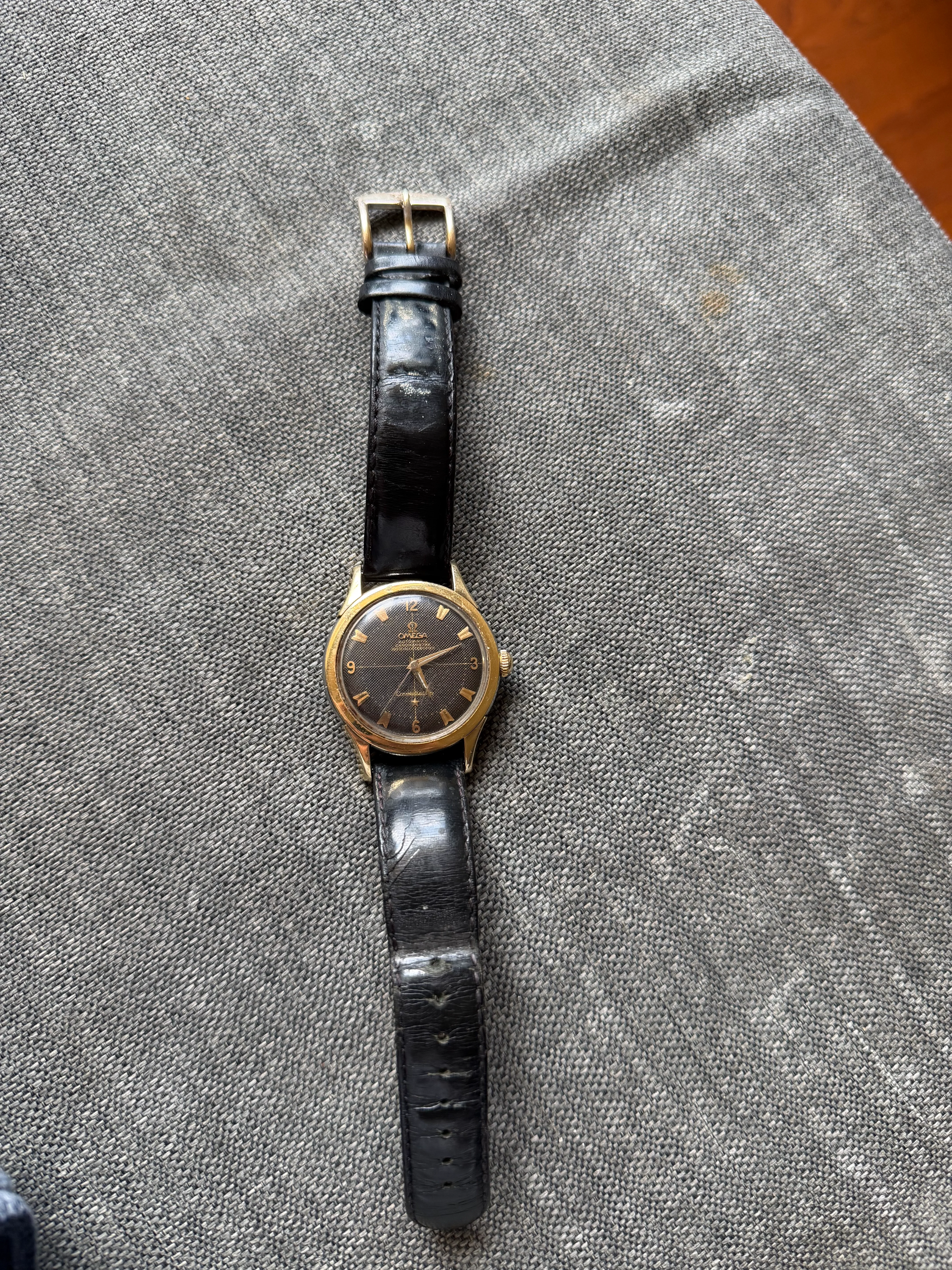

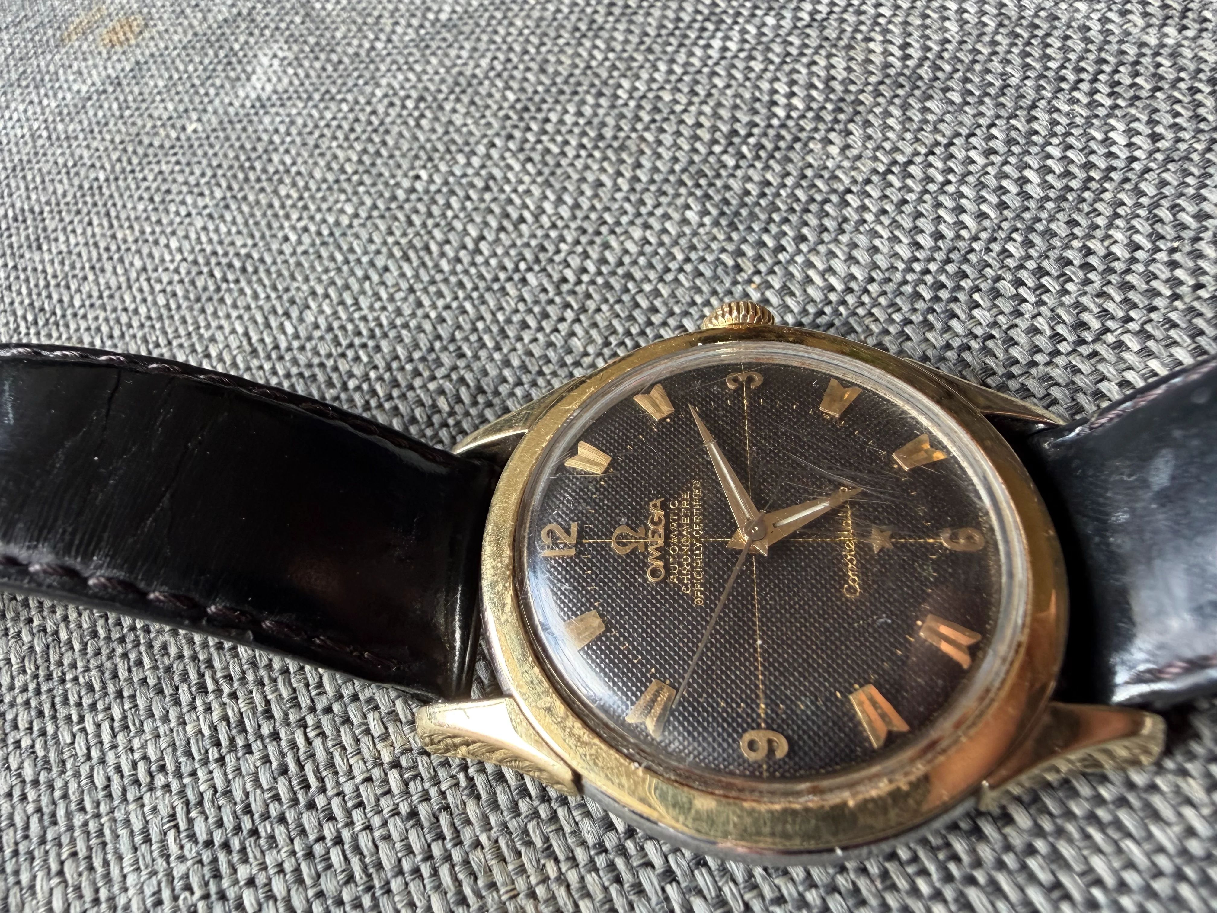

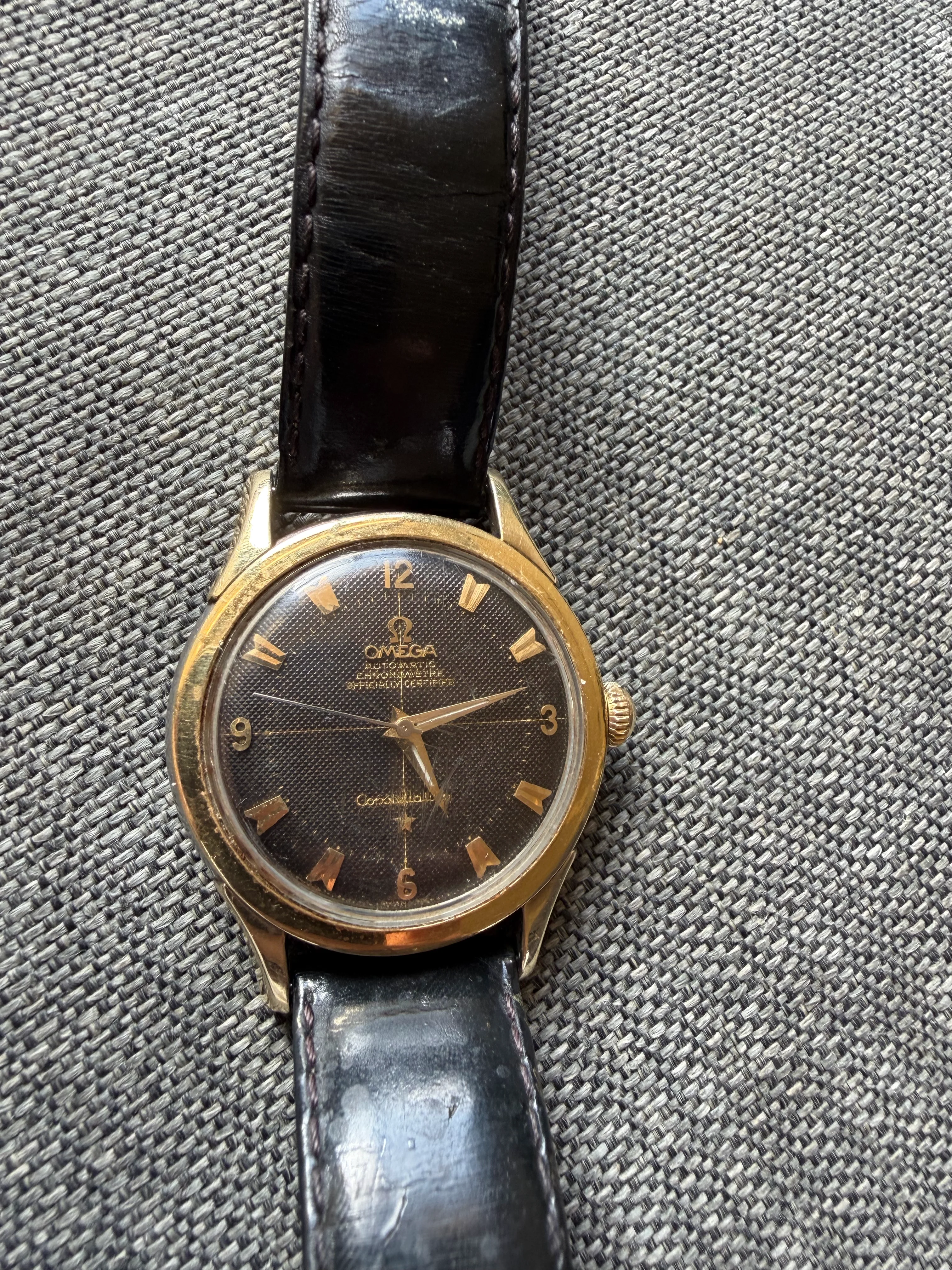

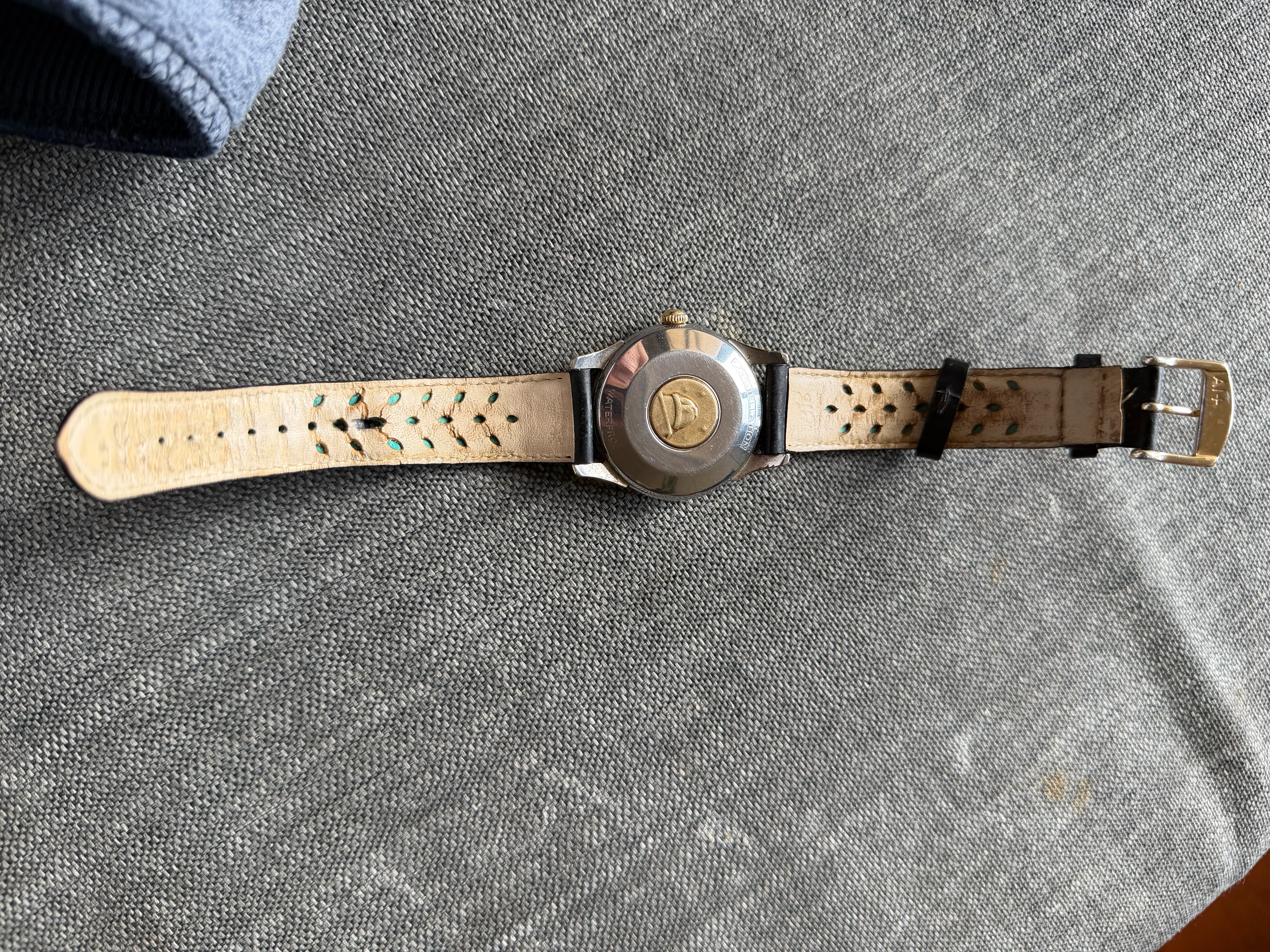

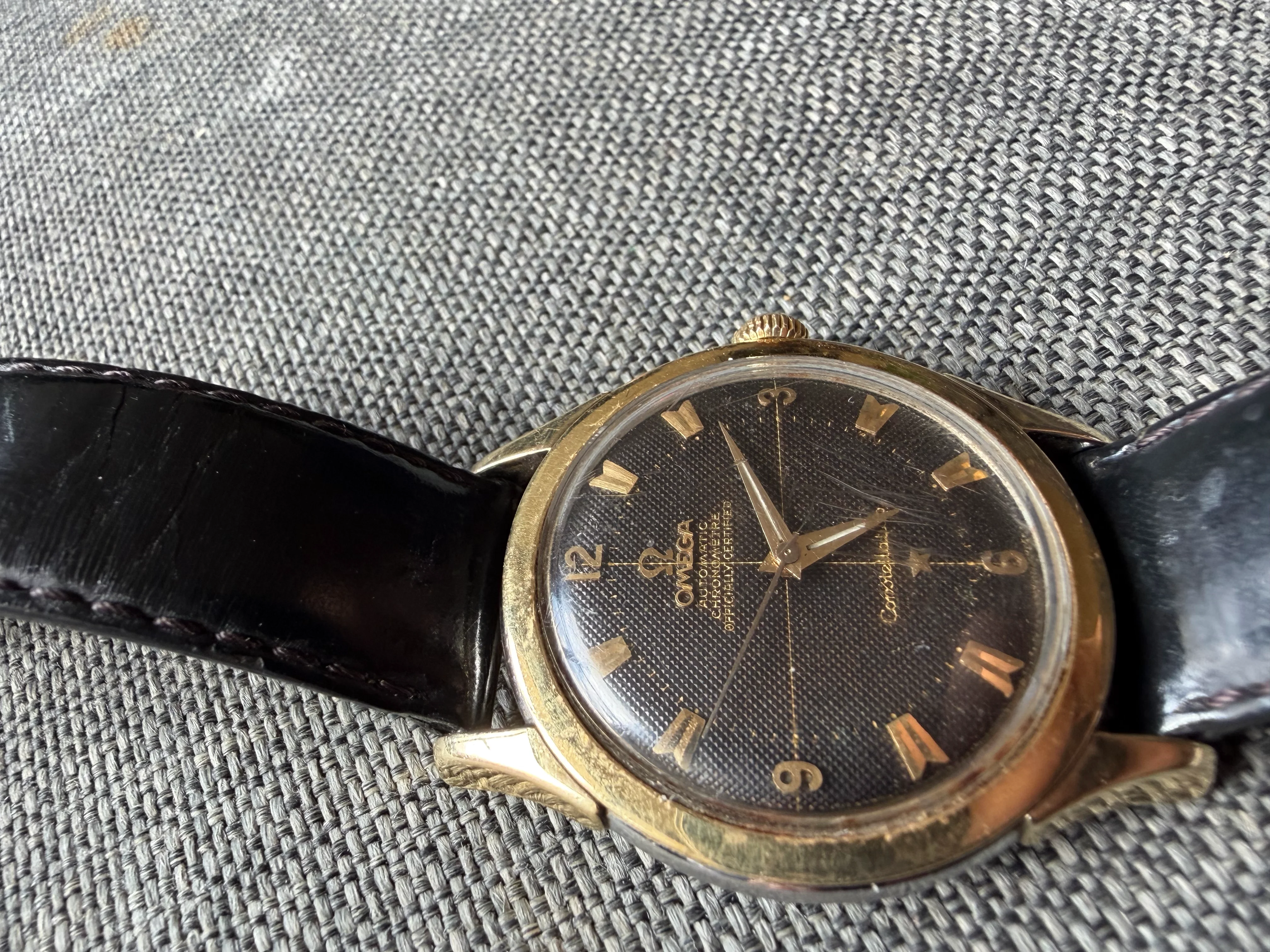

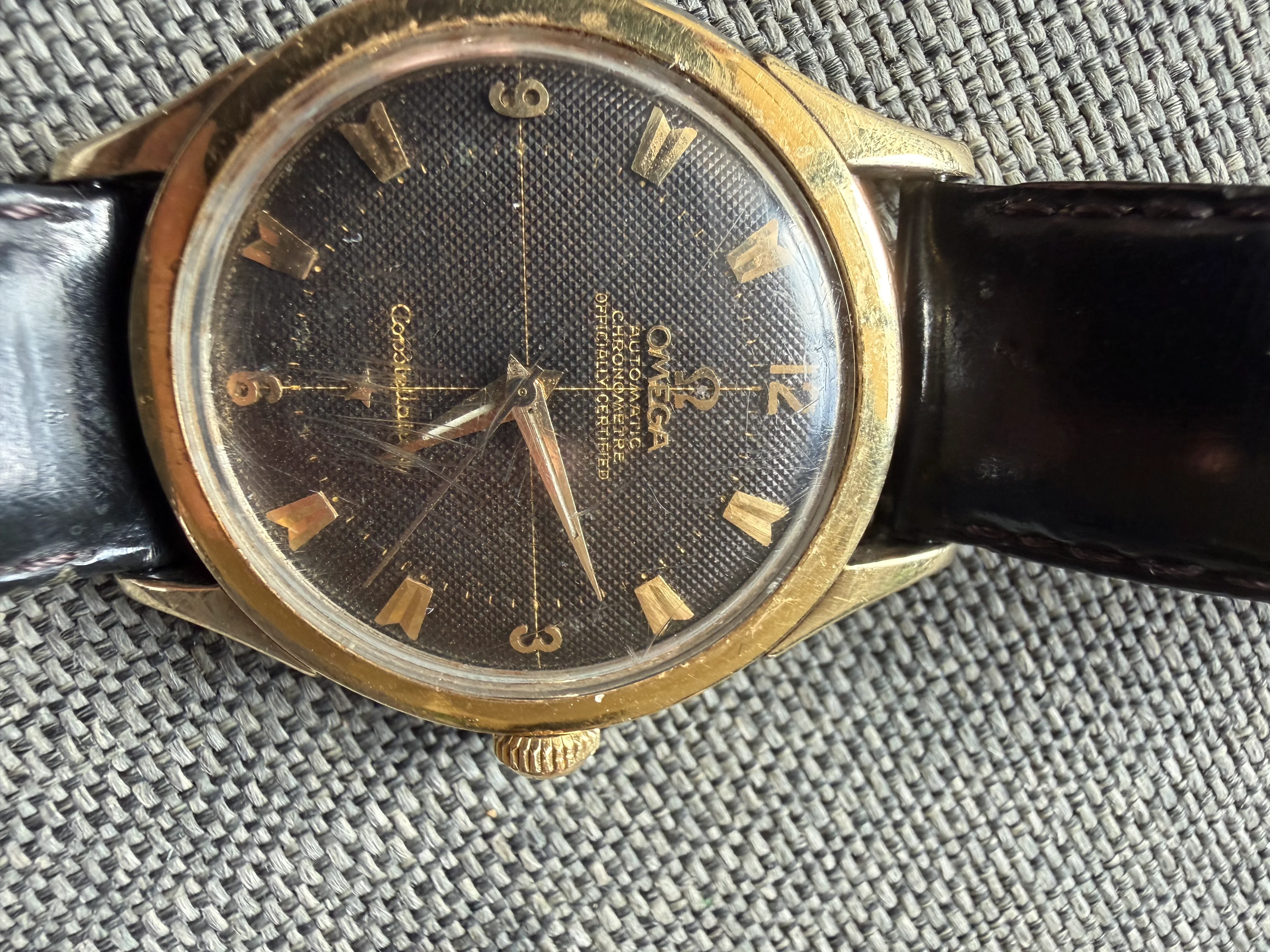

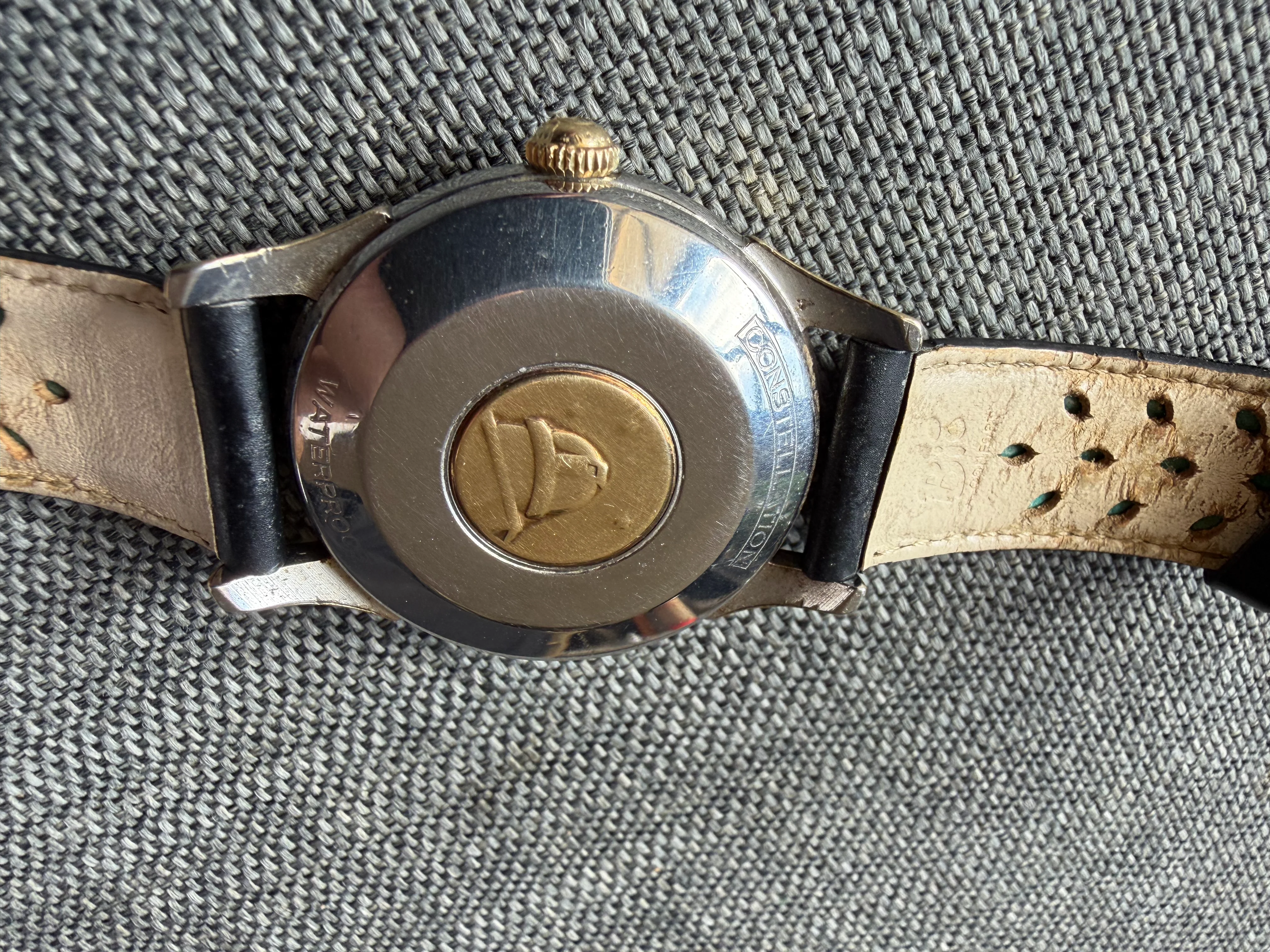

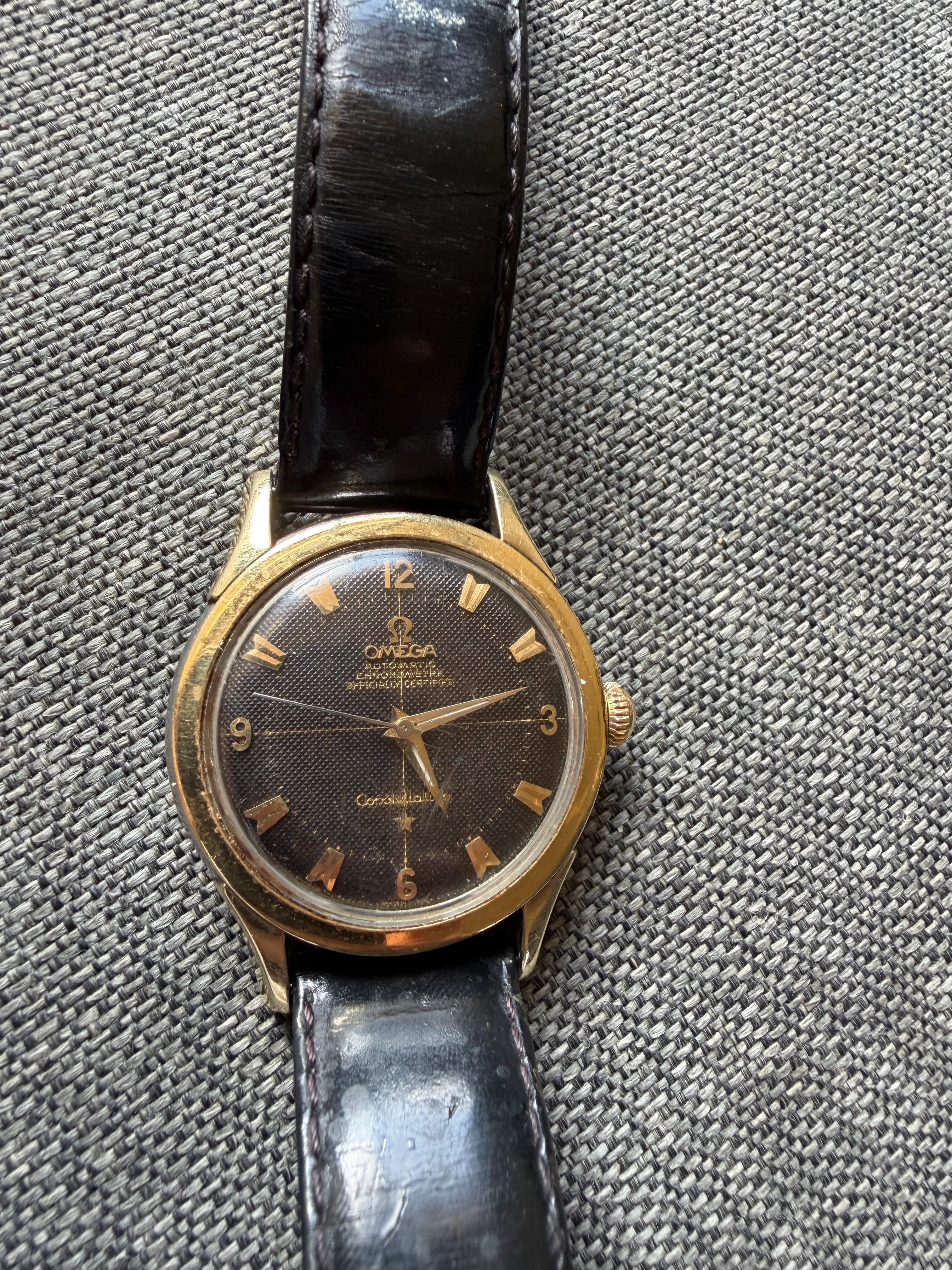

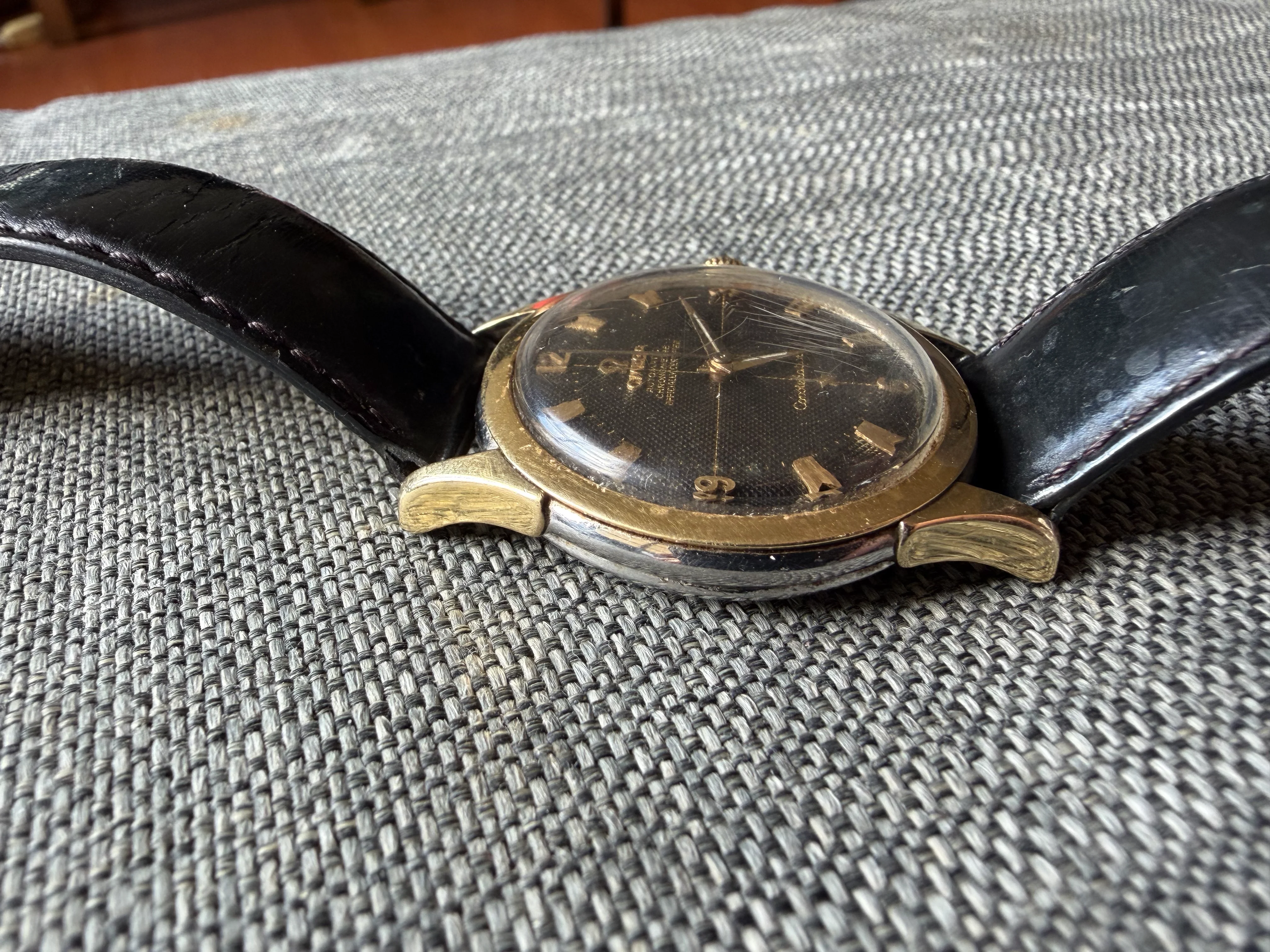

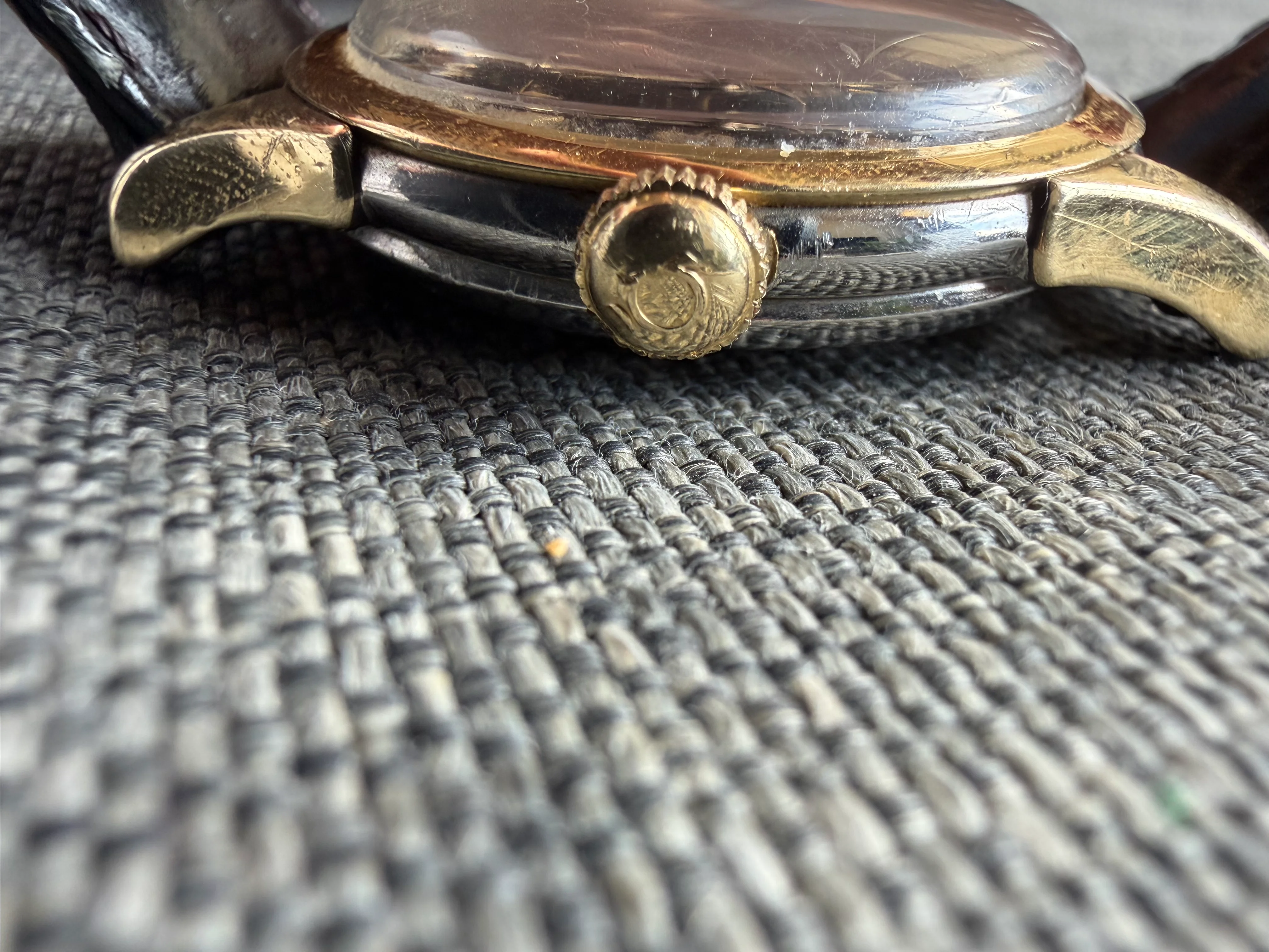

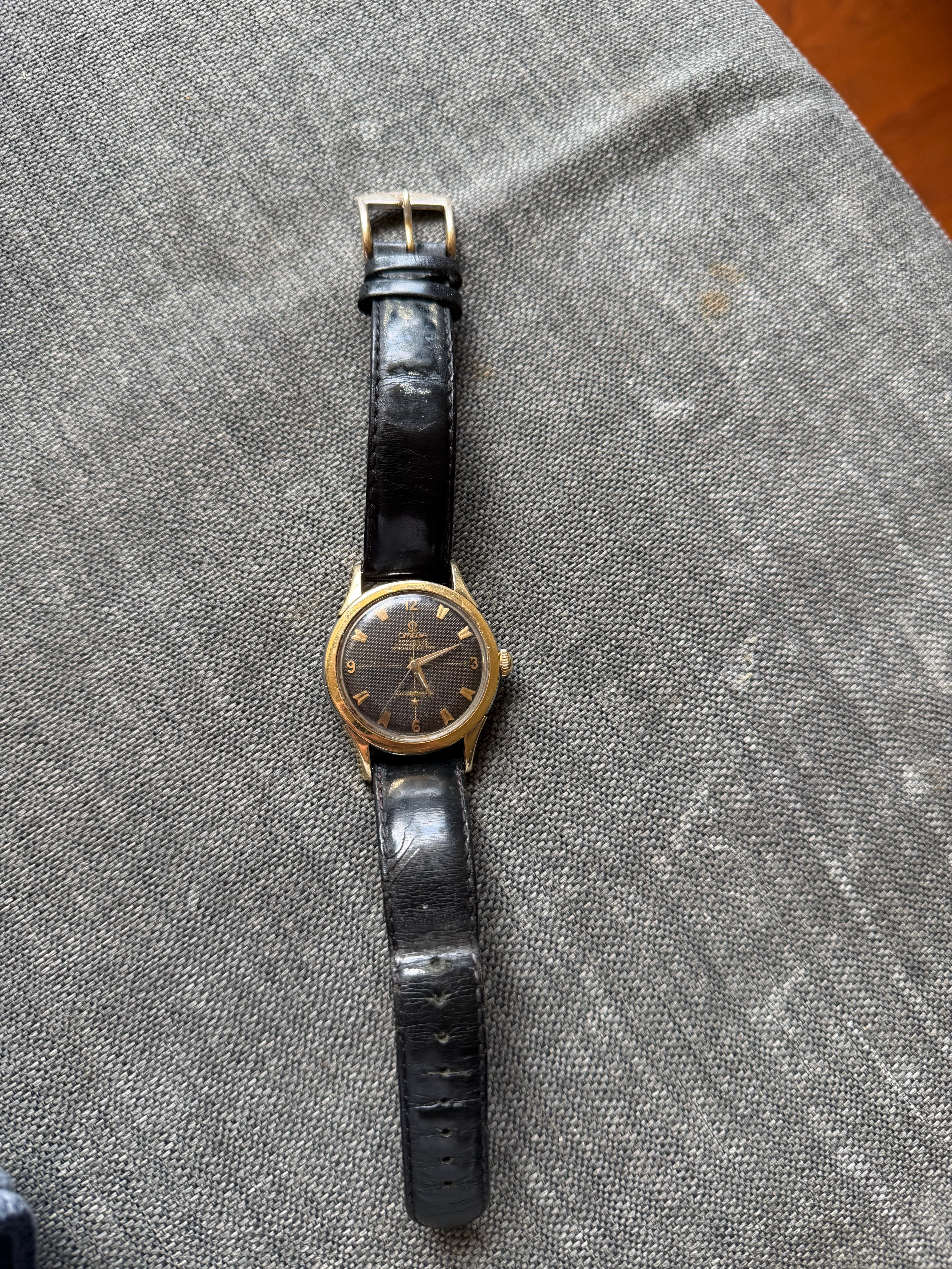

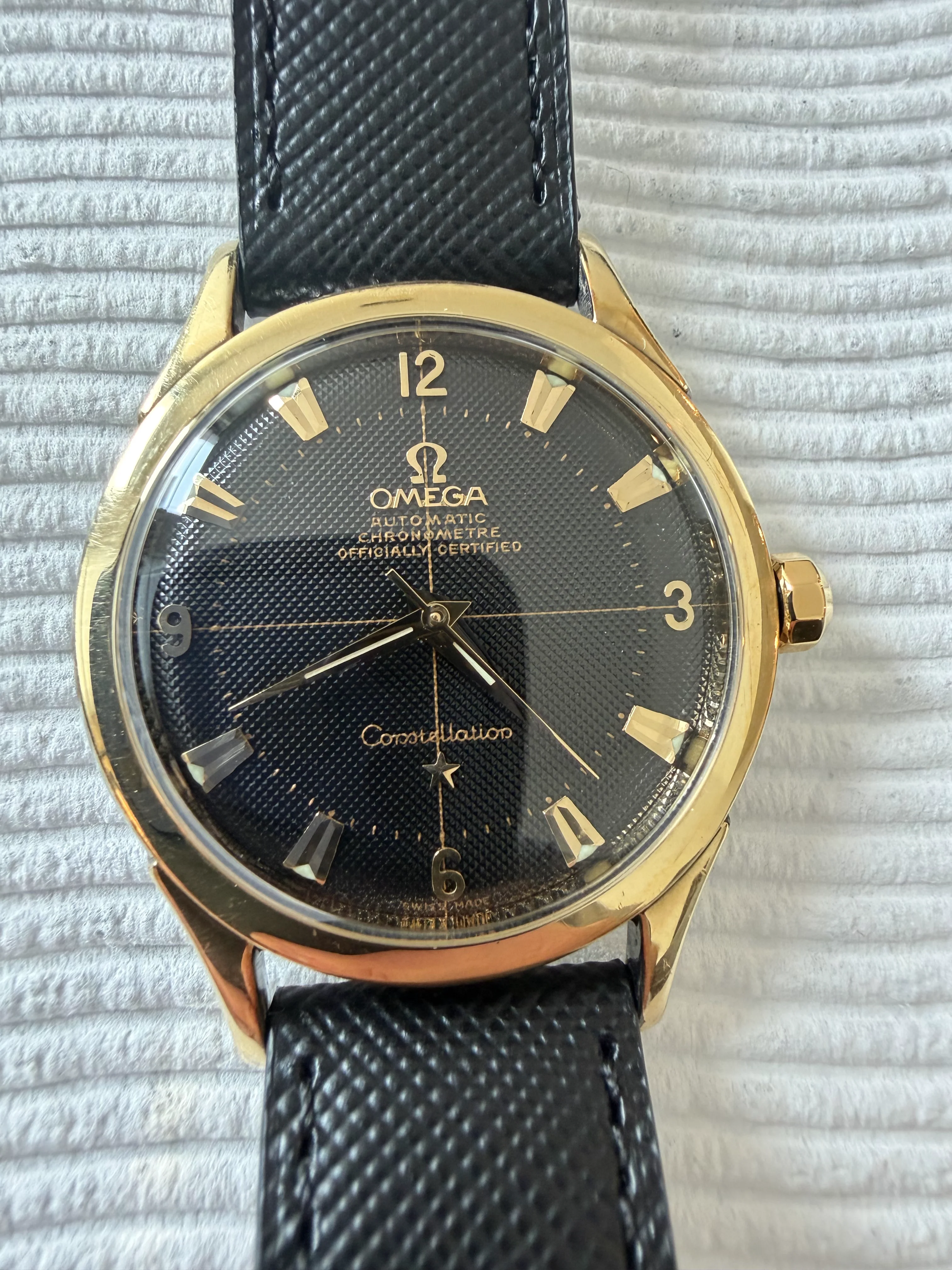

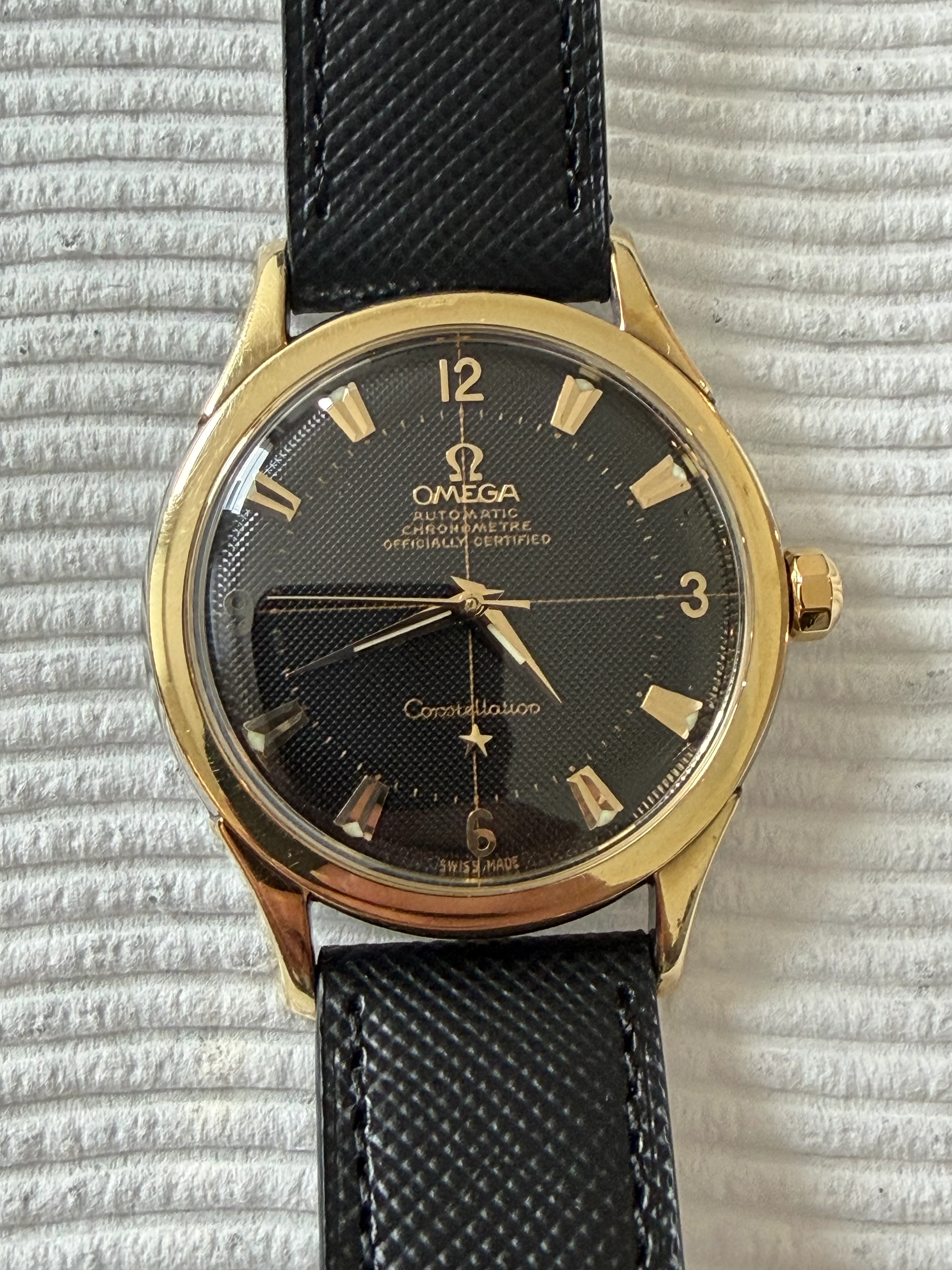

Hi All,
I inherited this watch from my grandpa who would wear it everyday.
It's old & worn, I plan on getting it restored and then wear it myself but would first like to get some more info on what exactly it is.
It still holds time great and i'm not sure if he ever previously got it worked on.
He was located in France, so likely purchased in France/Switzerland.
The case is two-tone, the dials have the 3/6/9/12 numberings, no date.
Inside the face reads: "Omega; Automatic; Chronometer; Officially Certified; Constellation"
On the back is written: "Constellation; Waterproof"
The strap appears to be off-brand. I do very much like the black leather strap for it, so will likely get a new one for myself.
Pictures attached, any info on the era/specs of this watch would be much appreciated, and any suggestions for the restoration would also be much appreciated.
Thanks!

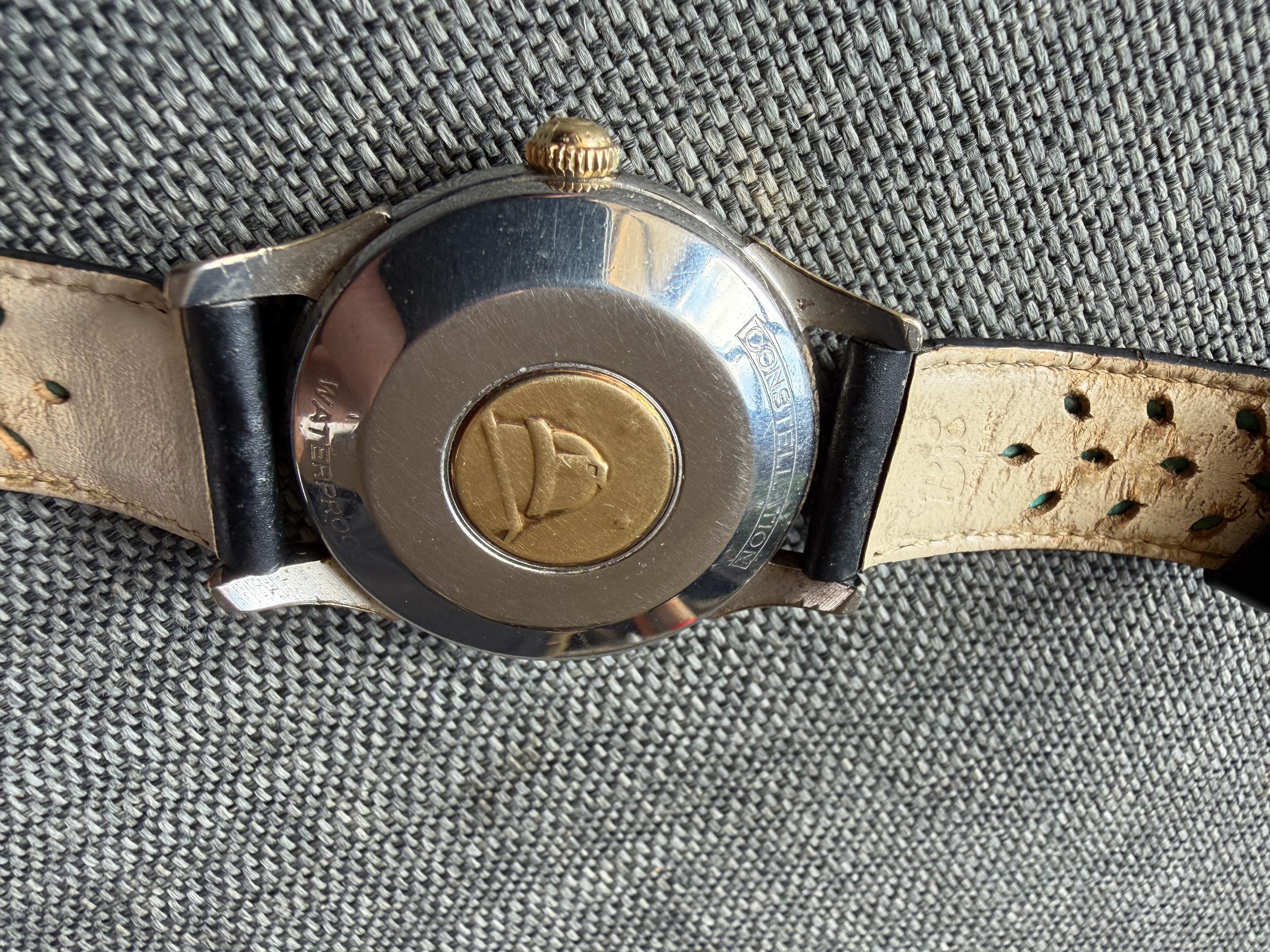

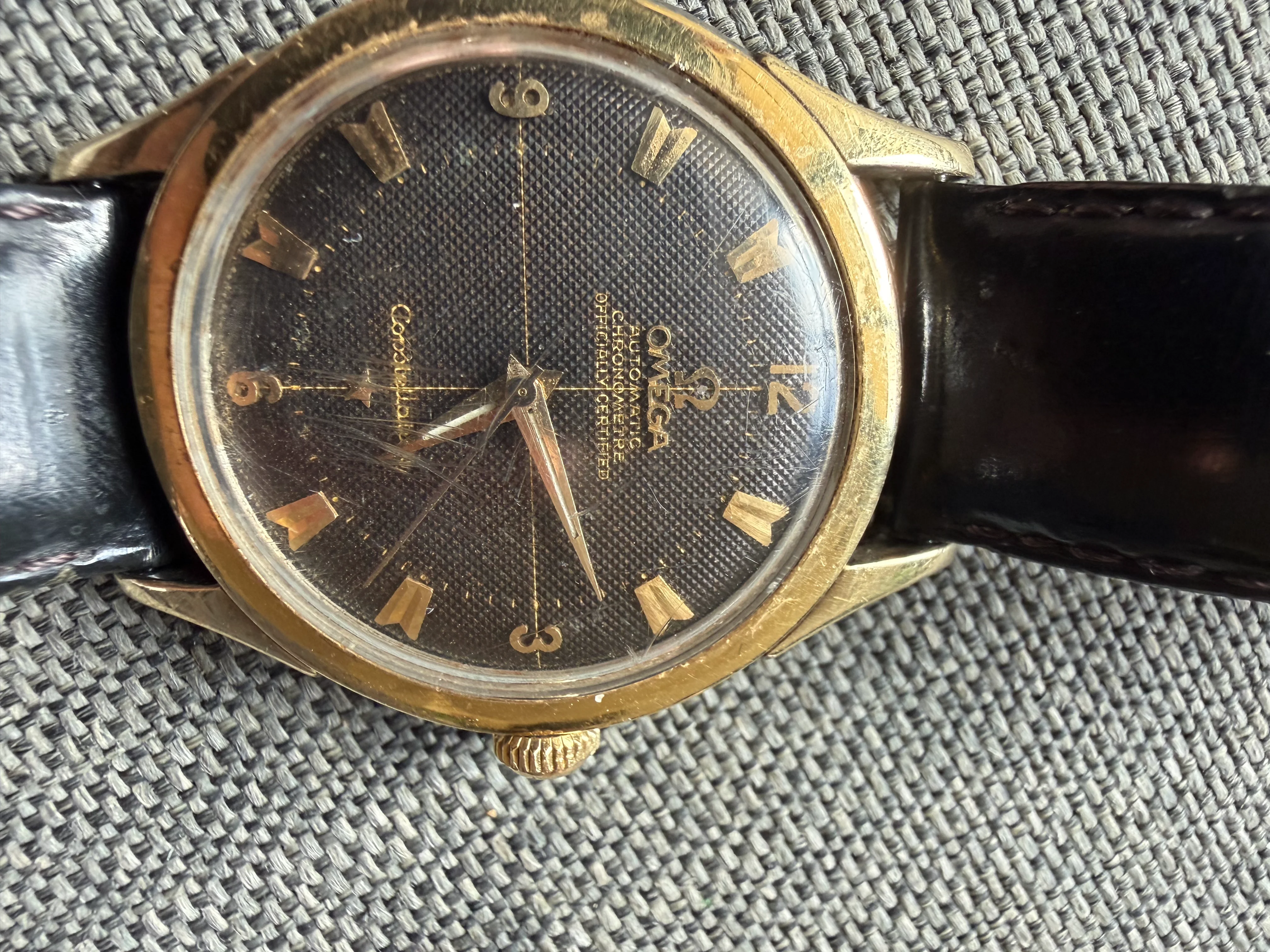

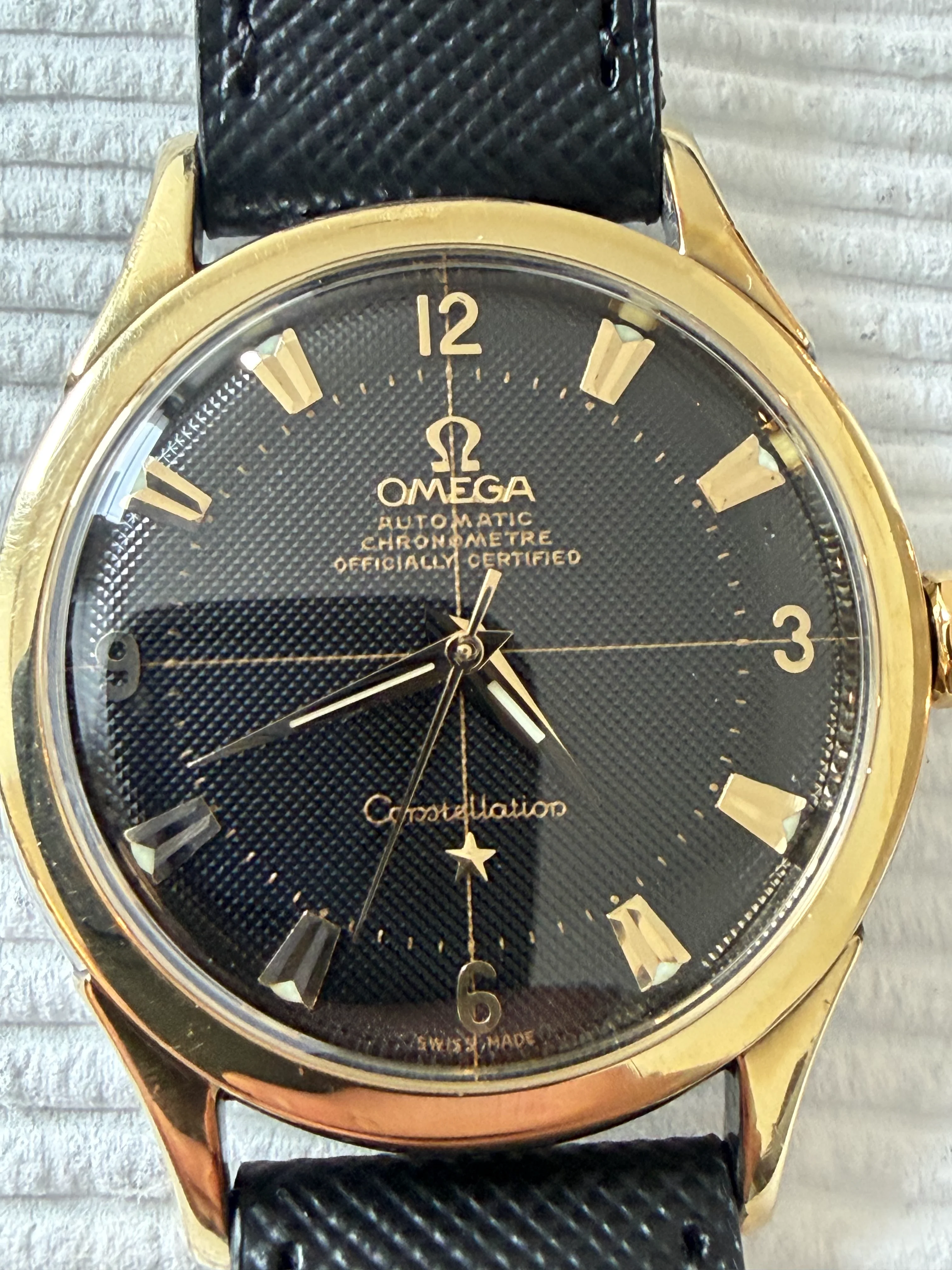

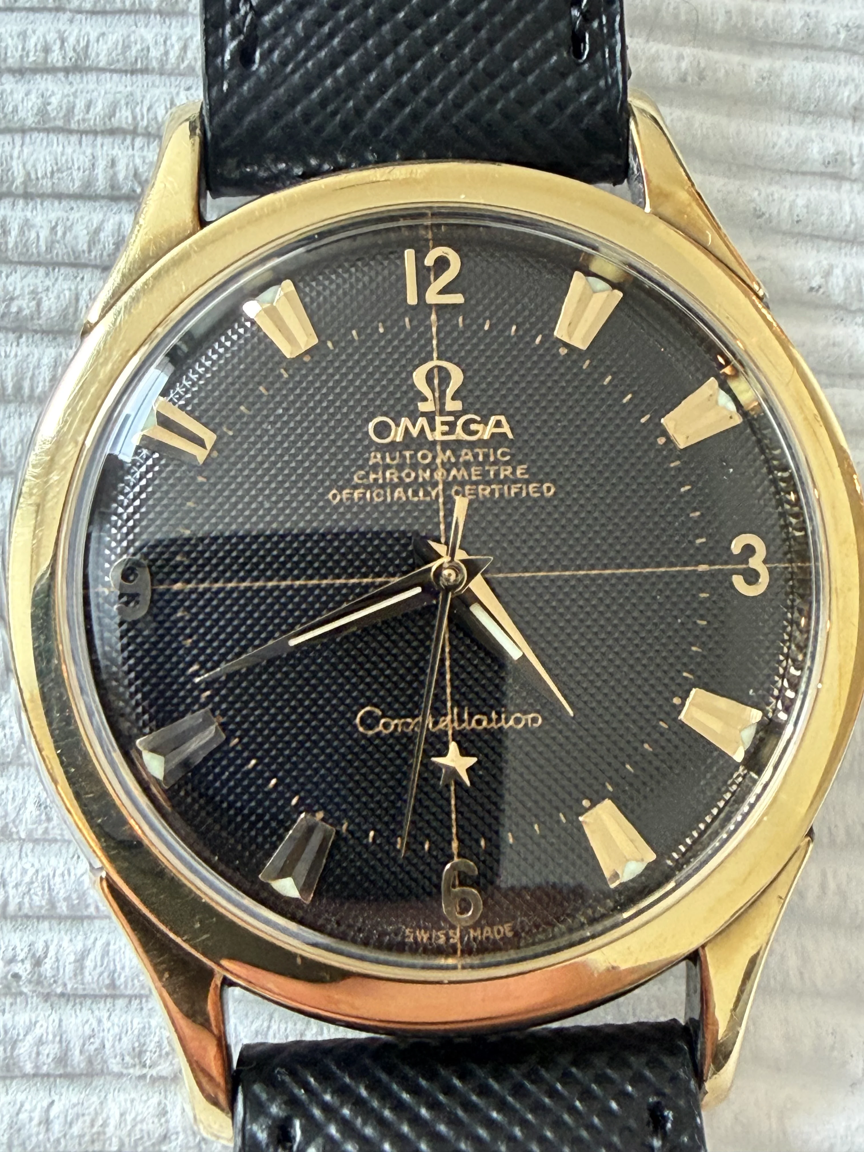

Shifting the topic to the watch itself, the reference will be in the inner case back. Looks like a 2852. The dial is a black honeycomb/waffle dial. Looks original to me. To assess this, it's usually best to have close-ups of the fonts.
Note that the dial says "Chonometre" (French spelling for Chronometer.. this changed for the last batches of 2852 and for further 5-digit references).
Once the watch is open, the serial number on the movement will tell you an approx. date. Likely late 1950s.

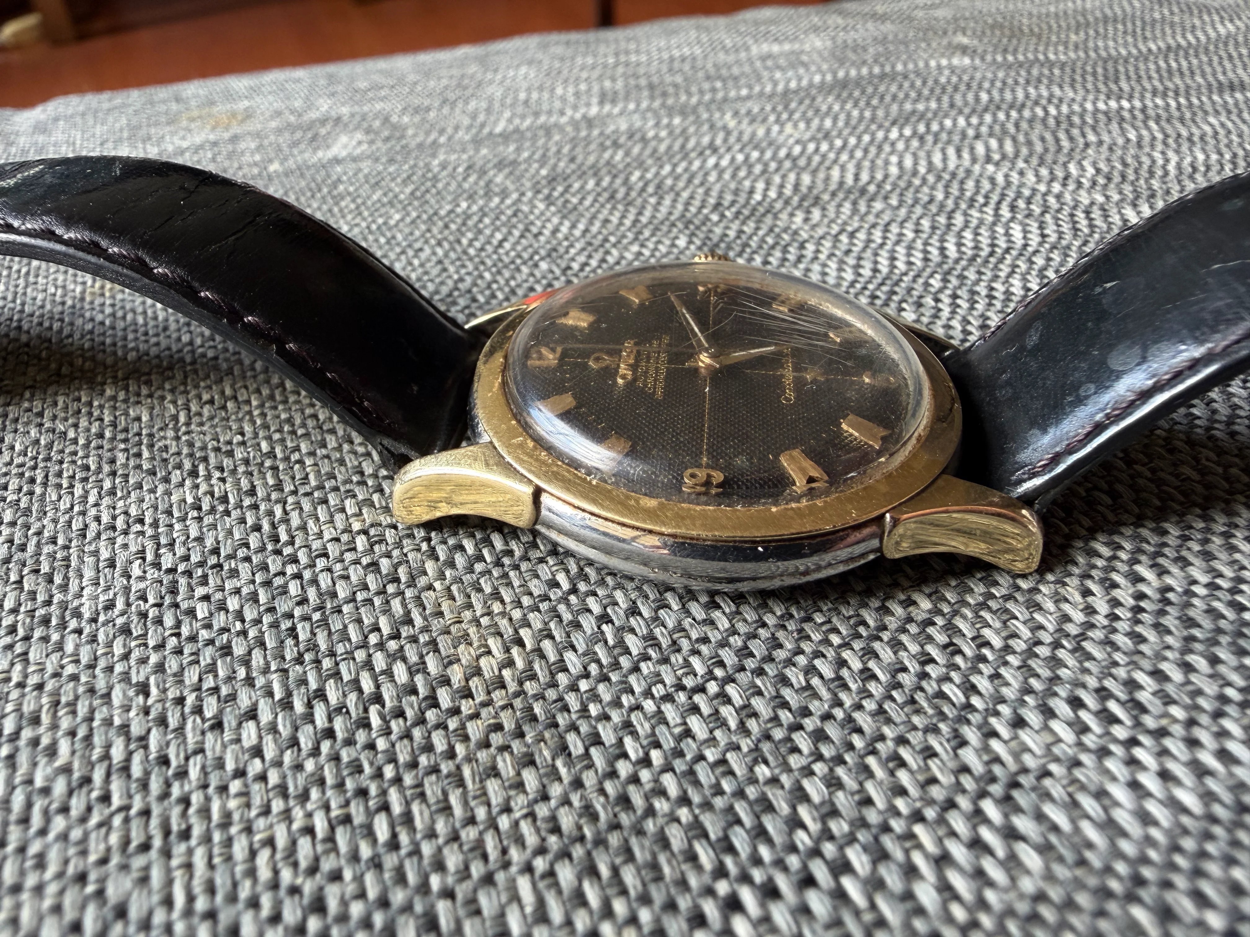

The case is worn and what we call "soft" in the hobby - which basically means it's been polished and worn - clearly a watch that's been enjoyed. I wouldn't mind, as I has sentimental value.

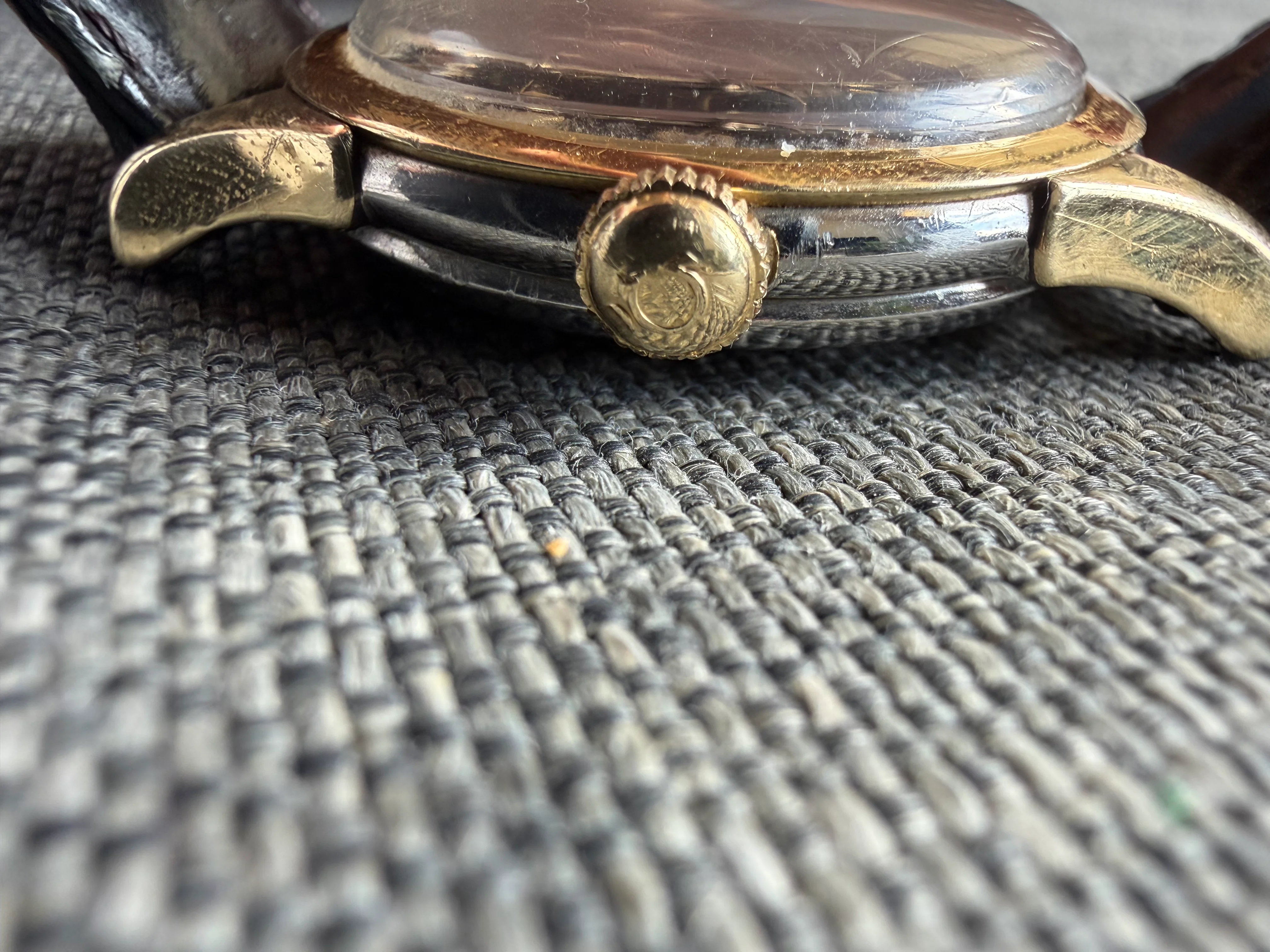

The crown is a replacement crown, likely swapped during prior service. A competent watchmaker should be able to source a correct period crown for this reference if this matters to you.
I think the hands have also likely had some sort of re-lume in the past, as the color looks pretty bright.
Enjoy it with care and hoping it brings you a lot of joy!
