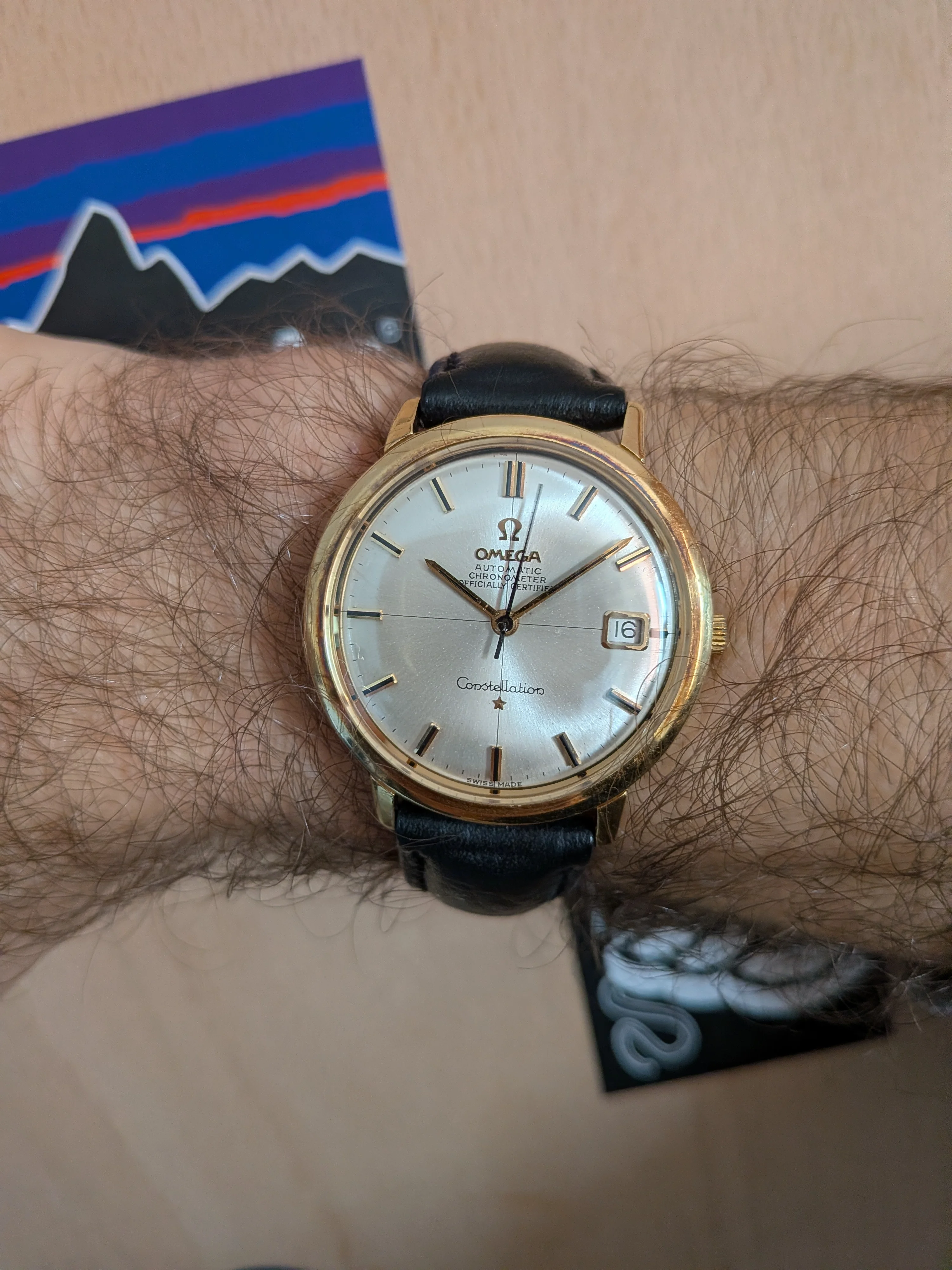

I don't have the watch returned yet, so can't post any pics post-service, however this is the watch in question:

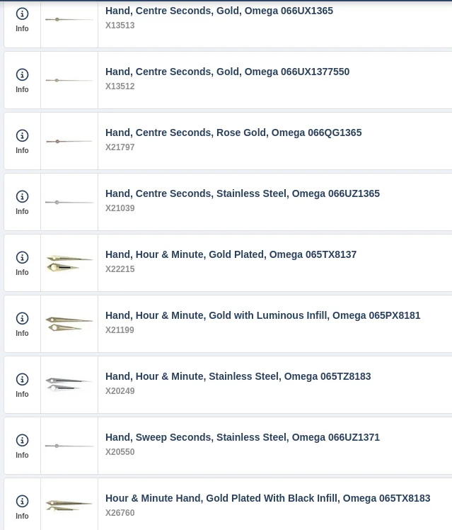

Thanks for this, v helpful. Cousins UK website still seems to allow you to search for Omega parts by case number (although you can't order them), using 168.004 I see the list in the attached image, the following seem to be most relevant for my watch:
  • Hand, Centre Seconds, Gold, Omega 066UX1365 X13513 (13.5mm)
  • Hand, Centre Seconds, Gold, Omega 066UX1377550 X13512 (12.75mm)
  • Hour & Minute Hand, Gold Plated With Black Infill, Omega 065TX8183 X26760
Searching for 168.5004 (AIUI the UK ref for the 168.004 case) doesn't show any Hour/Minute hands, but does show this seconds hand:
- Hand, Centre Seconds, Gold, Omega 066UX1355 X21200 (10.5mm)
Which is 10.5mm in length(!), so much shorter than the options for the non-UK case.
I'm not sure what to make of this!
I'm also not sure which would be the Omega part number, am I right in thinking it's the one beginning with a 0? So for the dauphine hands I would want to be searching for 065TX8183?

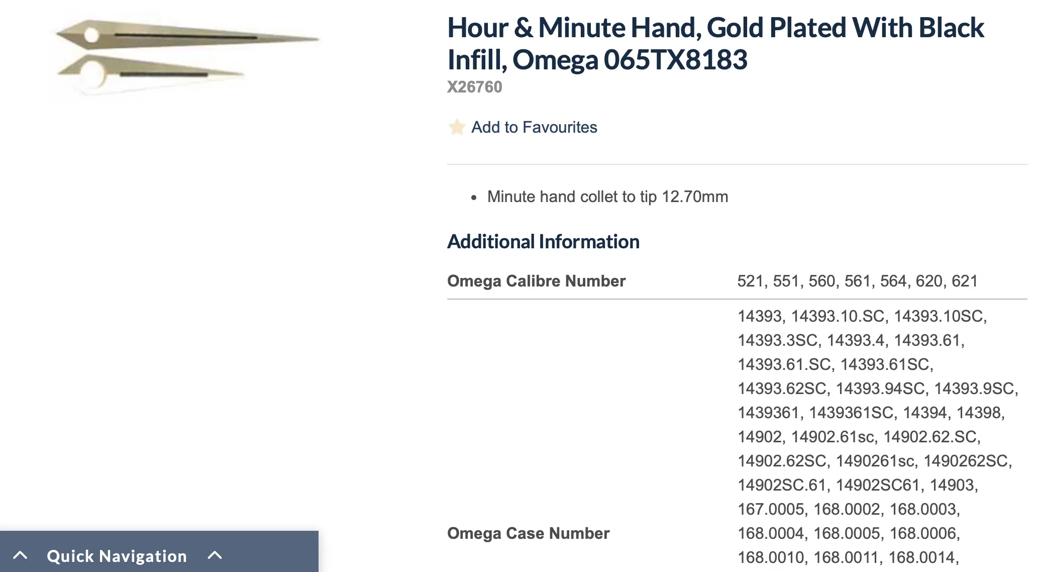

The hands should be (measured by eye) :
Hour : just short of 9mm - so 8.75mm sounds right
Minute: just short of 13mm - so 12.75m sounds right
The second hand should be approx. the same length as the minute hand.
You don't say what length the 8183 hands are but I see from Cousins that they are 12.70mm for the minute hand. (hour hand not specified)
So 12.75 for the second hand (above) is about right.
yes the reference no. is the 066... number
You won't find a reference for hands for a 168.5004 as the movt., dial and hands were sent complete from Switzerland to be fitted into an English gold case.
The reason the crown may differ is because it has to fit an English case.
I see that these hands appear to be common to a lot of the Constellation references
Odd that Cousins don't give the option for the shorter pie-pan hands.
