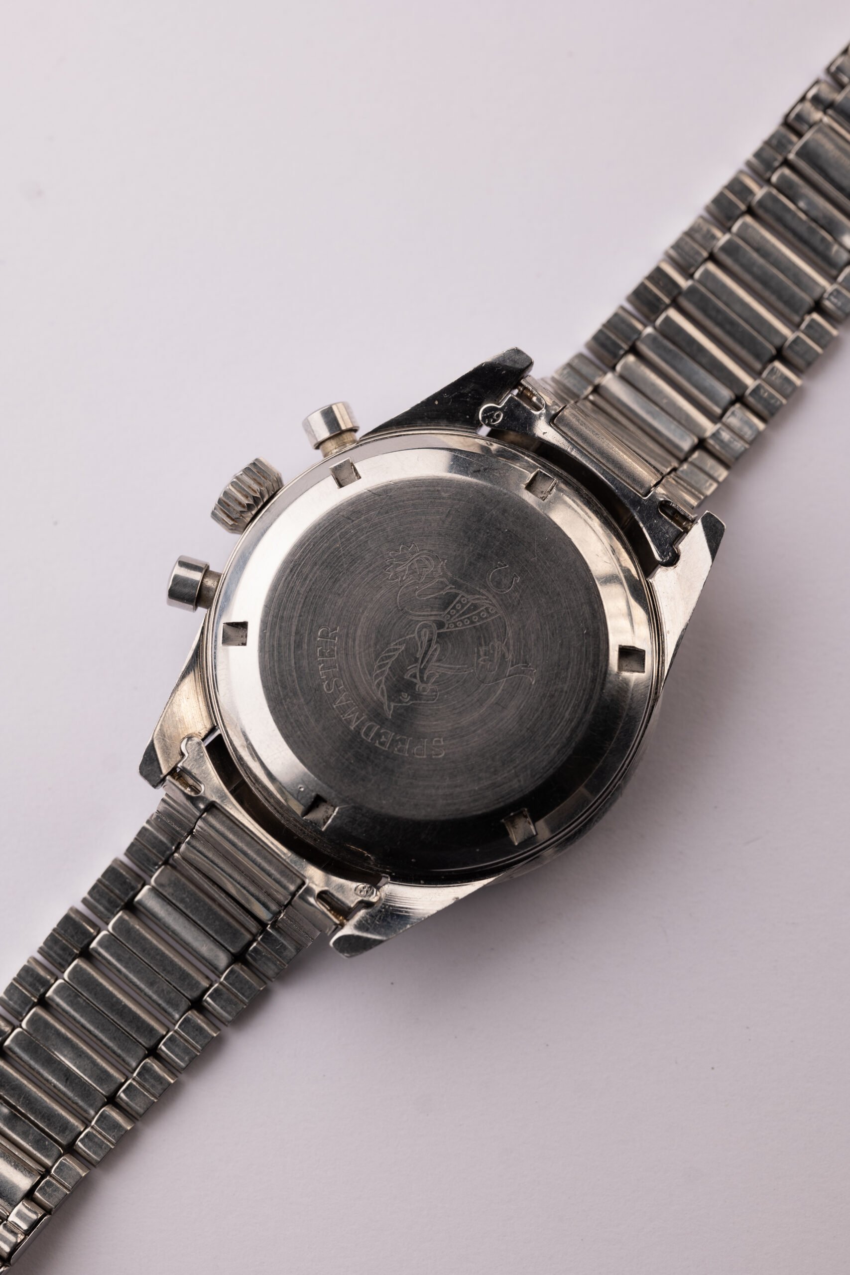

Hey all!

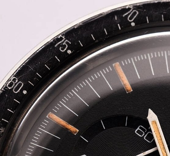

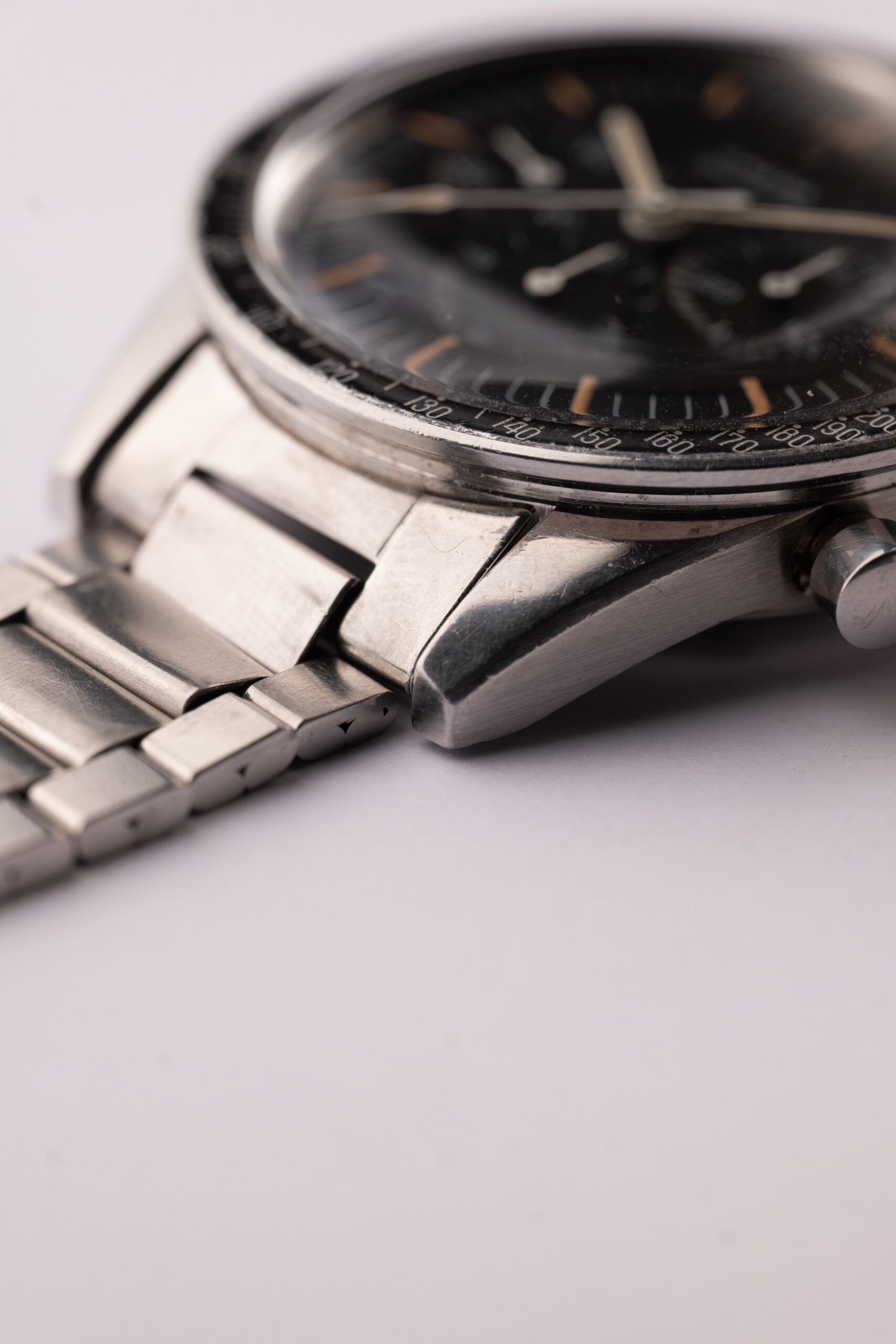

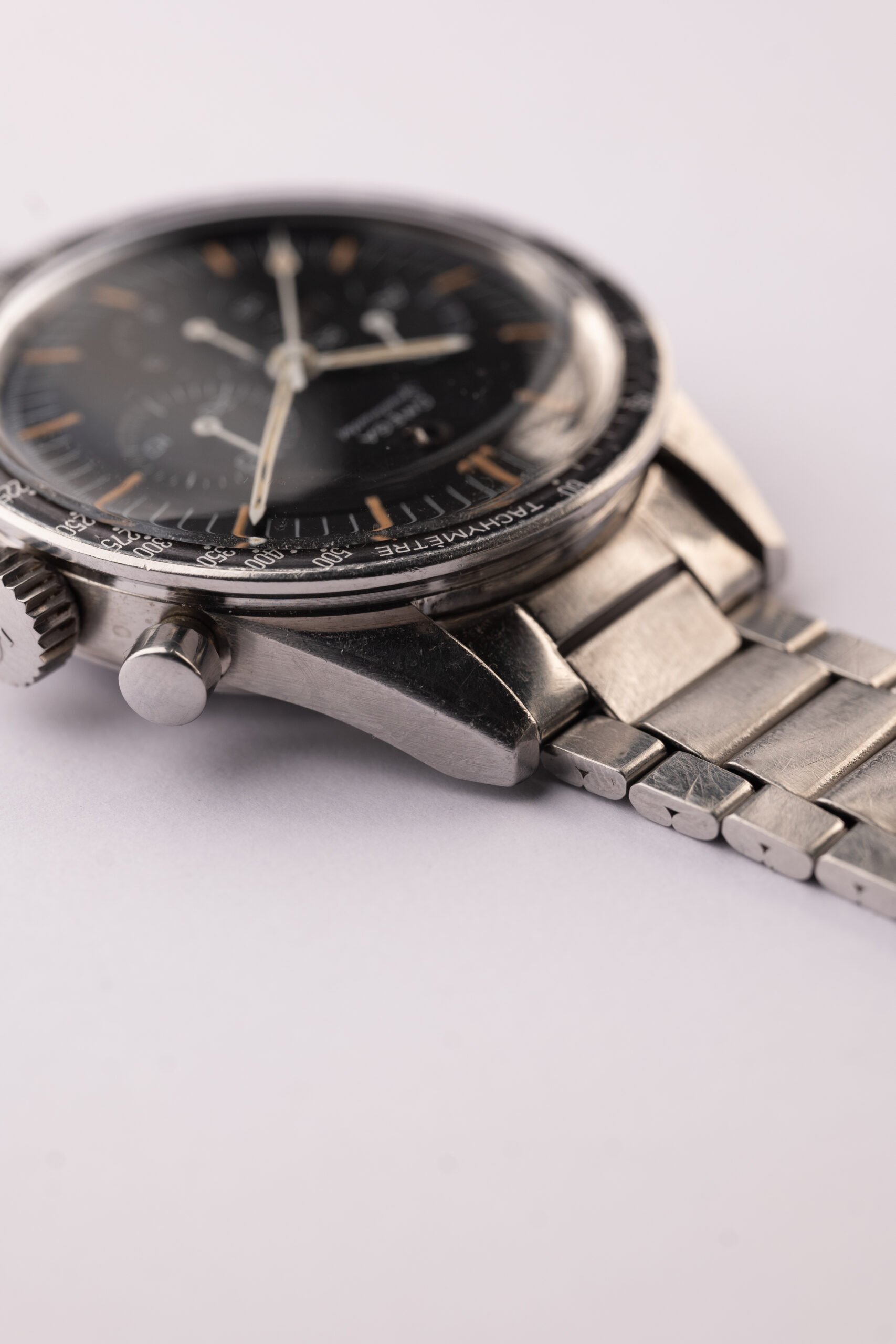

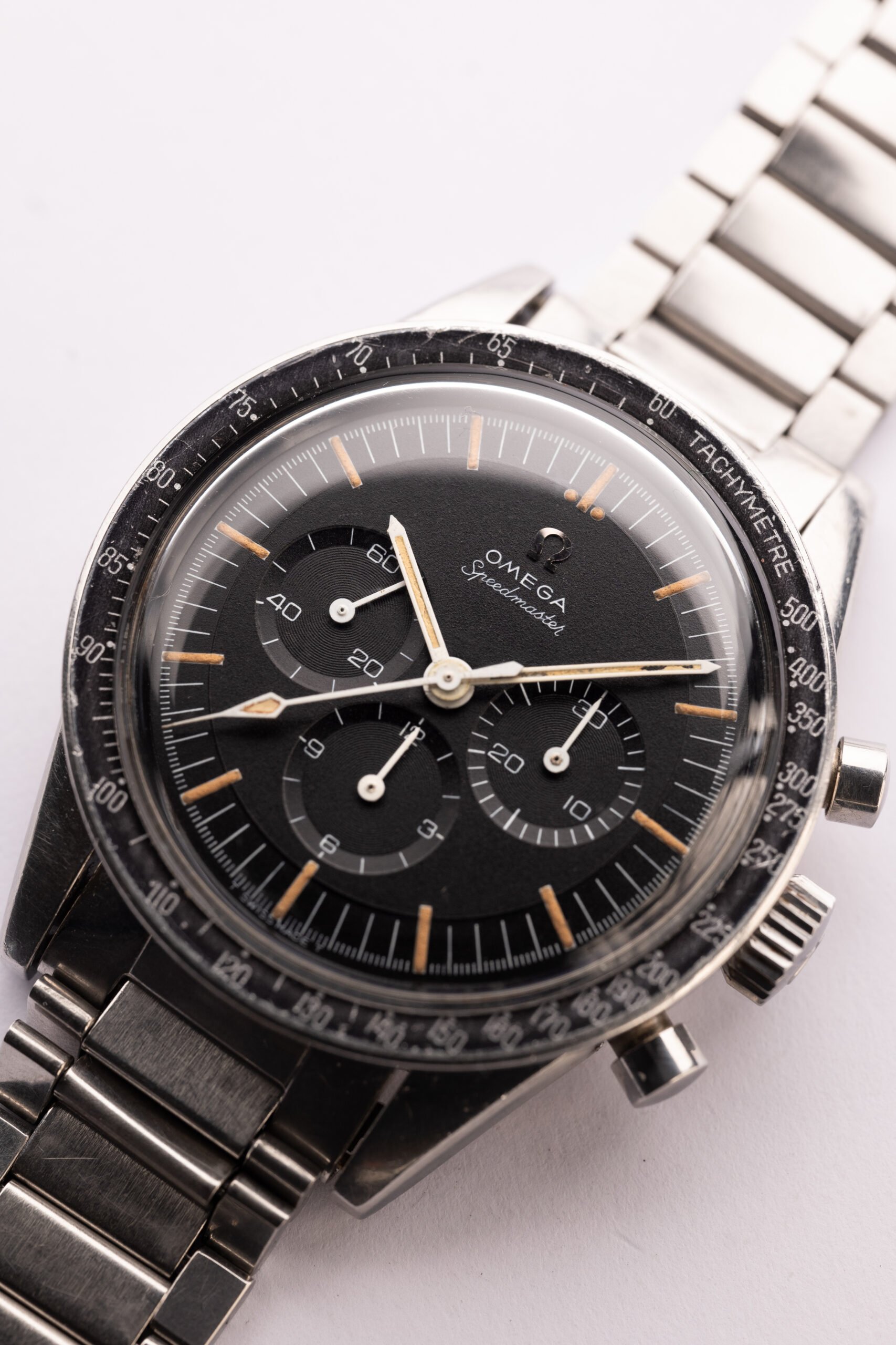

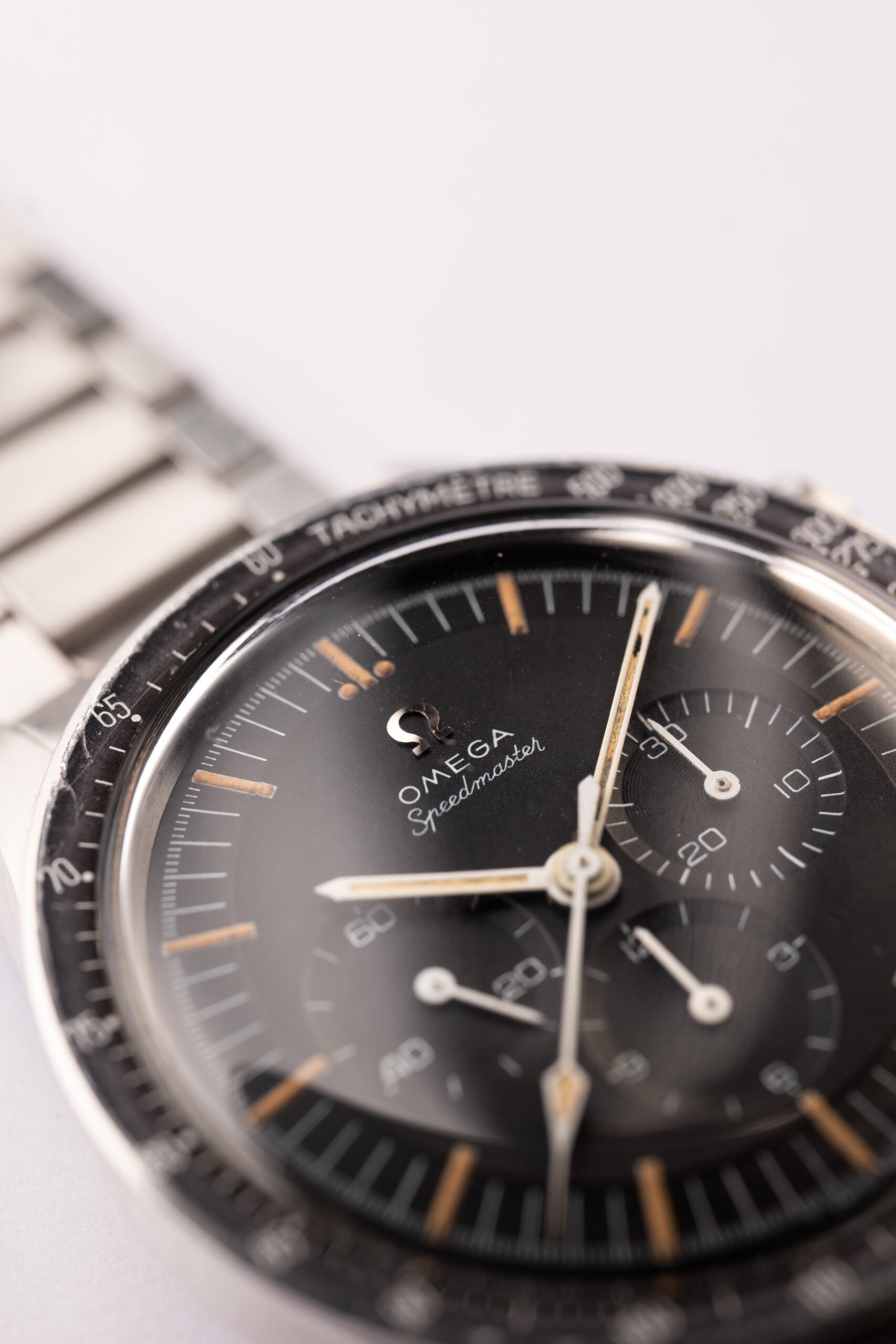

I am considering a 105.003-65 and have a few questions. The dial and case look rather nice, the only thing giving me pause is the lume. It appears puffier than most Ed Whites I have seen. Could it be period correct? I also don't know if the pushers/crown are original, any and all help would be greatly appreciated! Thanks!!!

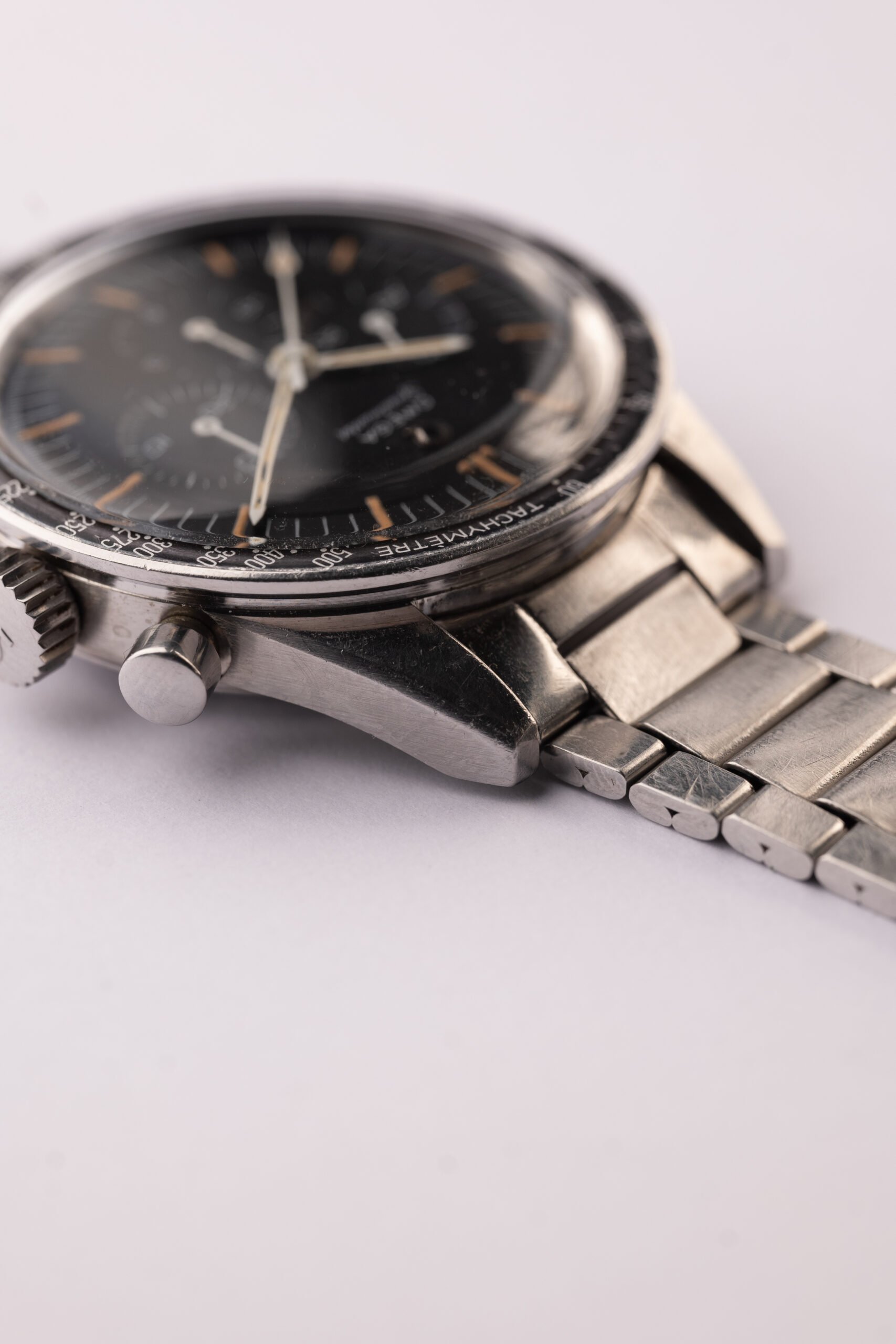

Hi, impossible to say anything on crown and case, since no pic... The quality of the case depends mainly on its polishing degree, especially the lugs.
Pushers ok.
Nice dial, the lume doesn't surprise me, correct bezel, it could be a very desirable -65 👍... (And probably a correct bracelet too...)

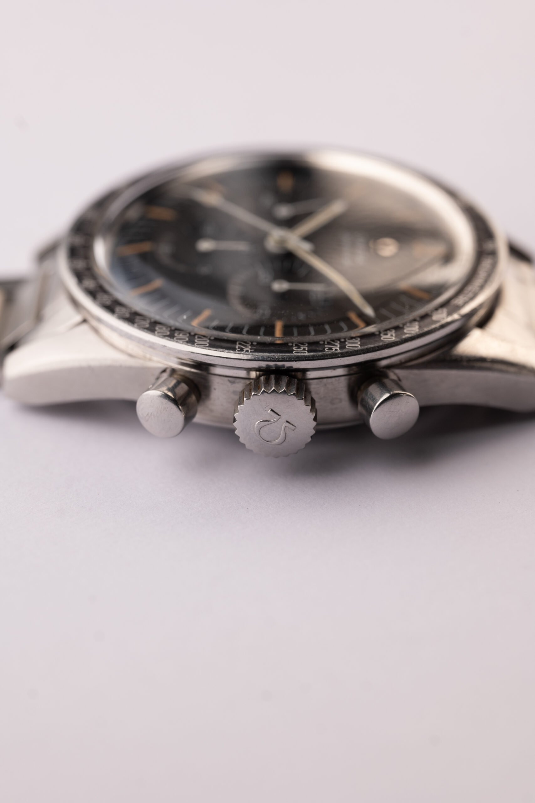

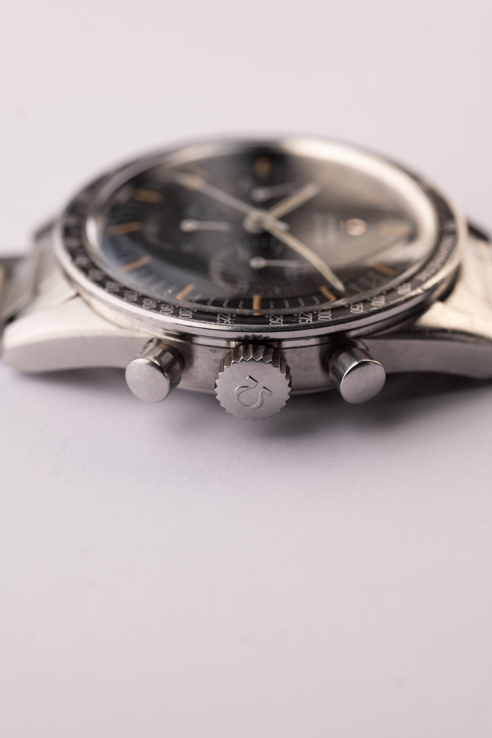

Thank you for the reply! Added a pic of the crown. I am also waiting for a movement pic from the seller before I make any decision.

Yes, check the serial is a good idea 😀
Perfect crown. It seems you can barely see the facets of the lugs. Even if they surely have been polished in their long life, the case could be quite nice too...
Case looks alright to my amateur eyes.

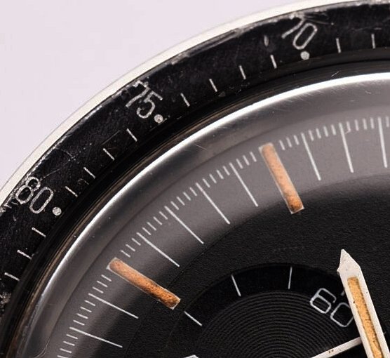

It’s a slightly darker shade of lume than what I’d usually associate with a -65 but just because it’s a slightly outlier, doesn’t make it a relume.
Nothing else is jumping out as a concern.
The only way to be more sure is to view it under a loupe and test with uv or a bright light. However, some of the relume artists are getting so good even this is no longer foolproof.
Begs the question, if even experienced collectors can’t tell, does it matter?

Is the hight of the lume (dial) in the usual range?

If price is in the range of course, for sure a nice -65 👍
(When serial is confirmed 😉)
Many references, particularly -65’s show shrinkage of lume etc. the colouration and ‘puffiness’ here is more to the extreme end of the spectrum imo but still within the bounds of what’s reasonable.
It is one that I’d want to see in the flesh before I handed over any cash though.

Very important to see movement and verify SN.

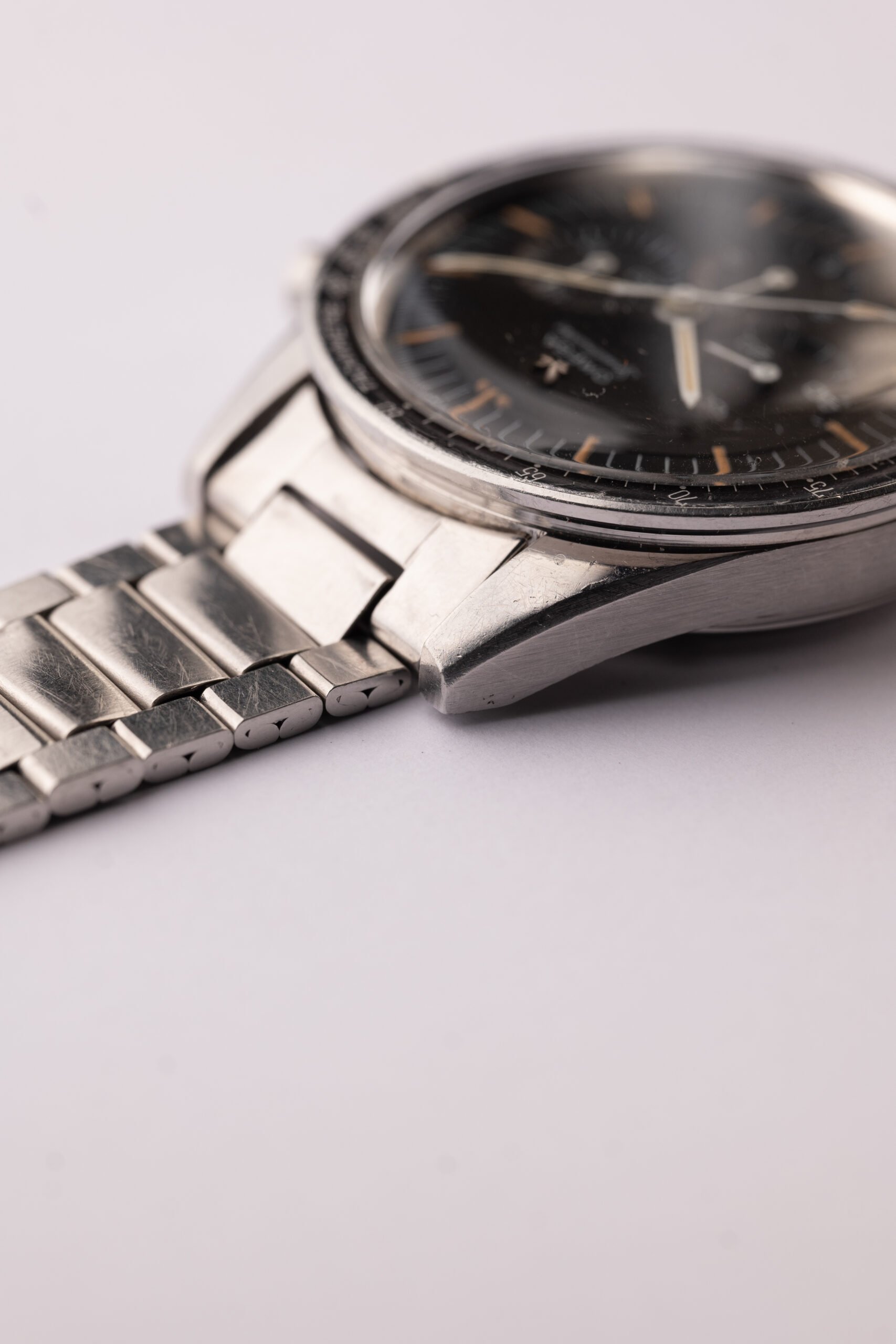

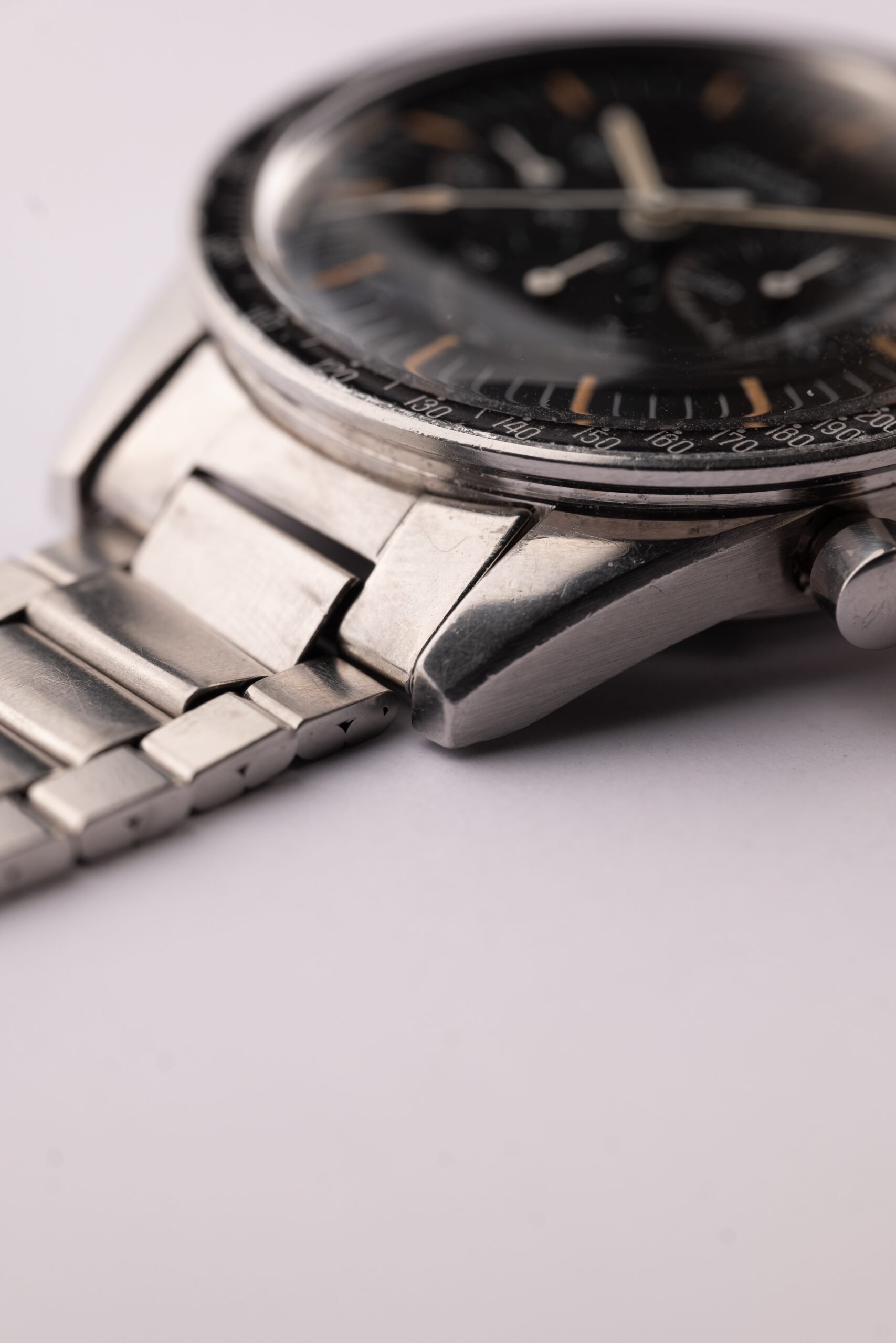

It's listed for $14,750 and has correct bracelet + endlinks. Doesn't seem unreasonable. I'll get a movement pic today.

It's a 1035 ? 7912?
7,392
23,861
Yes; see this shade more on a ‘63.

There was a similar darker lume -65 being sold here last year. I suppose the longer run produced a couple of lume variations.

Looks solid to me. Nice watch. Pleasing condition and lume colour. Price isn’t too crazy either, especially considering the presence of bracelet and EL’s.
