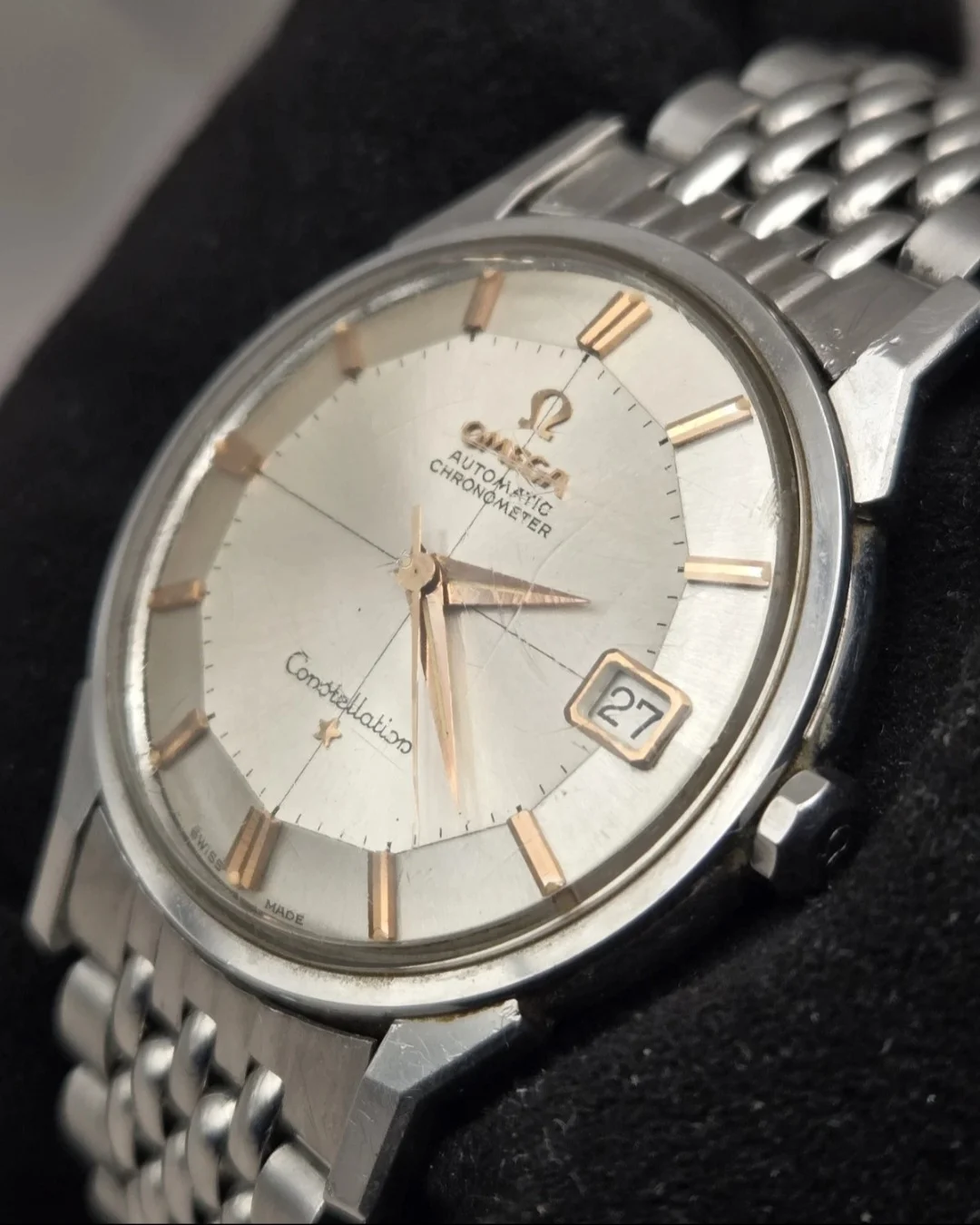

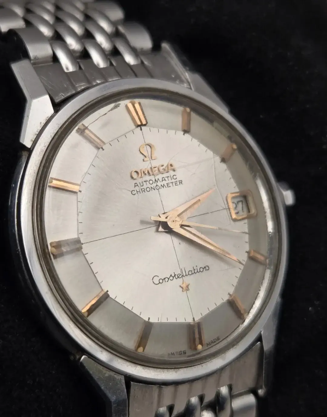

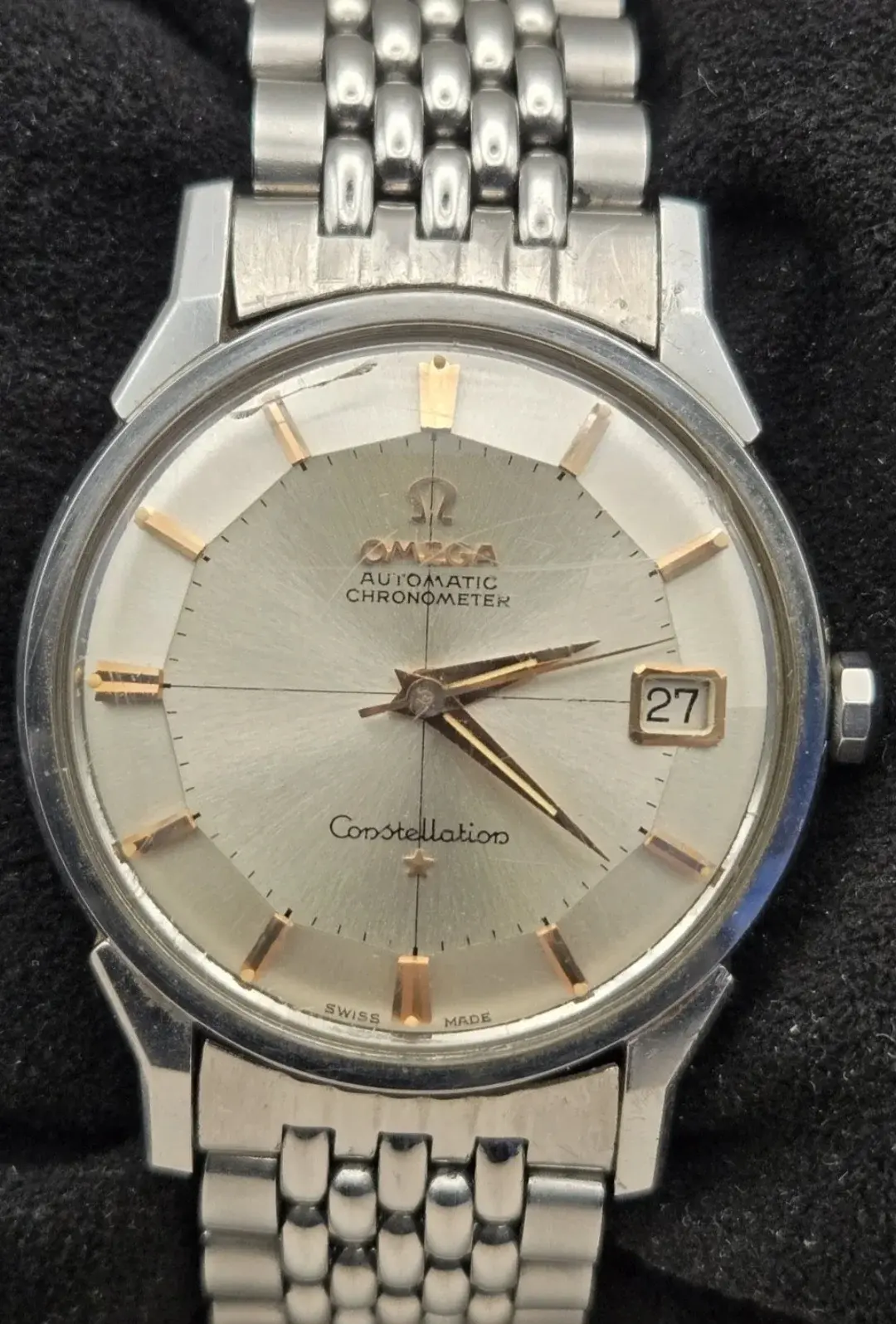

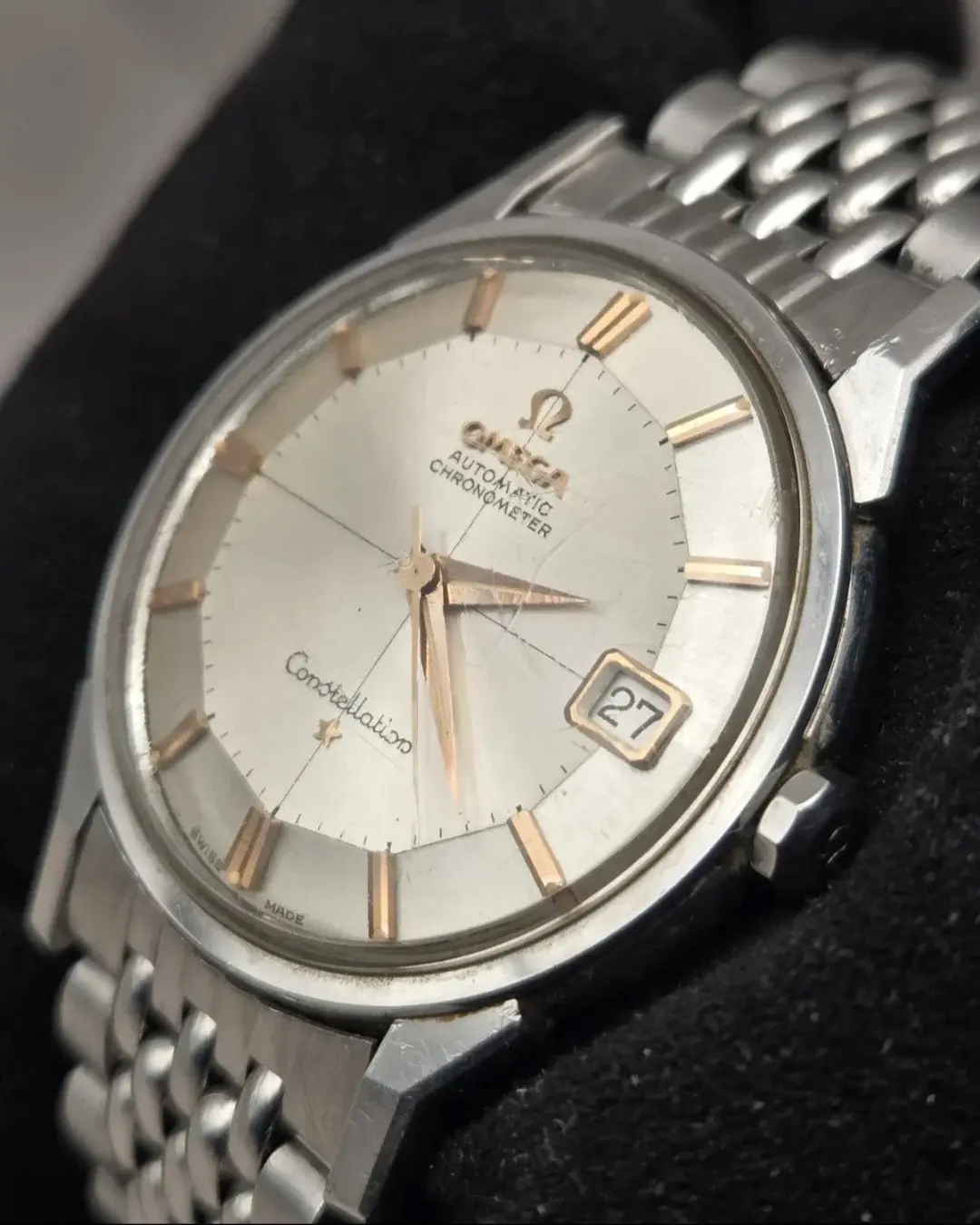

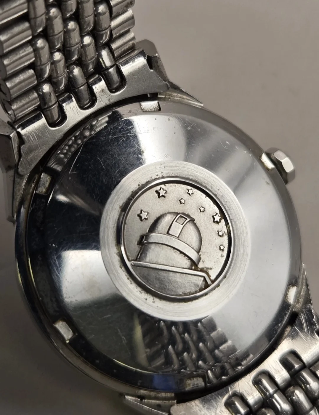

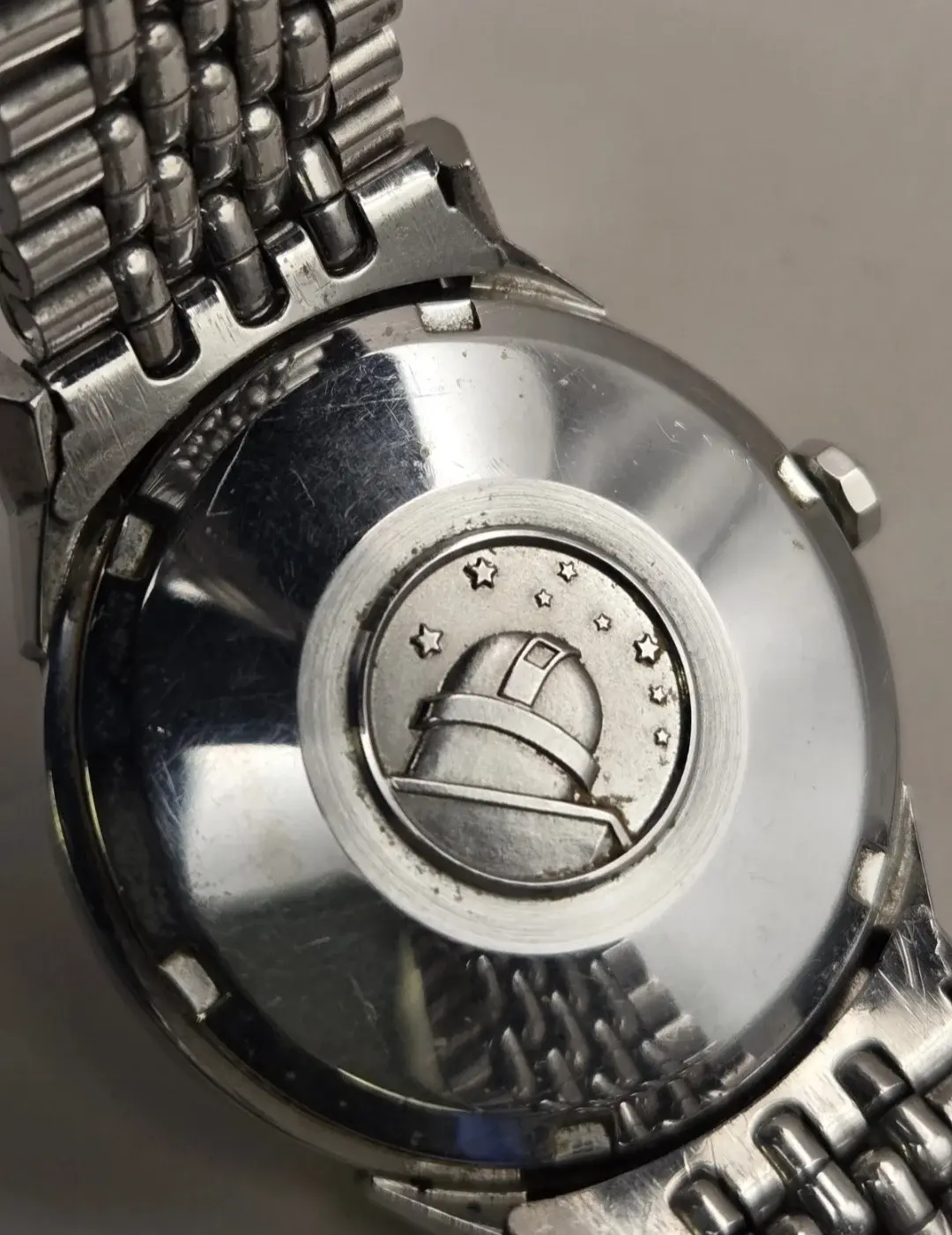

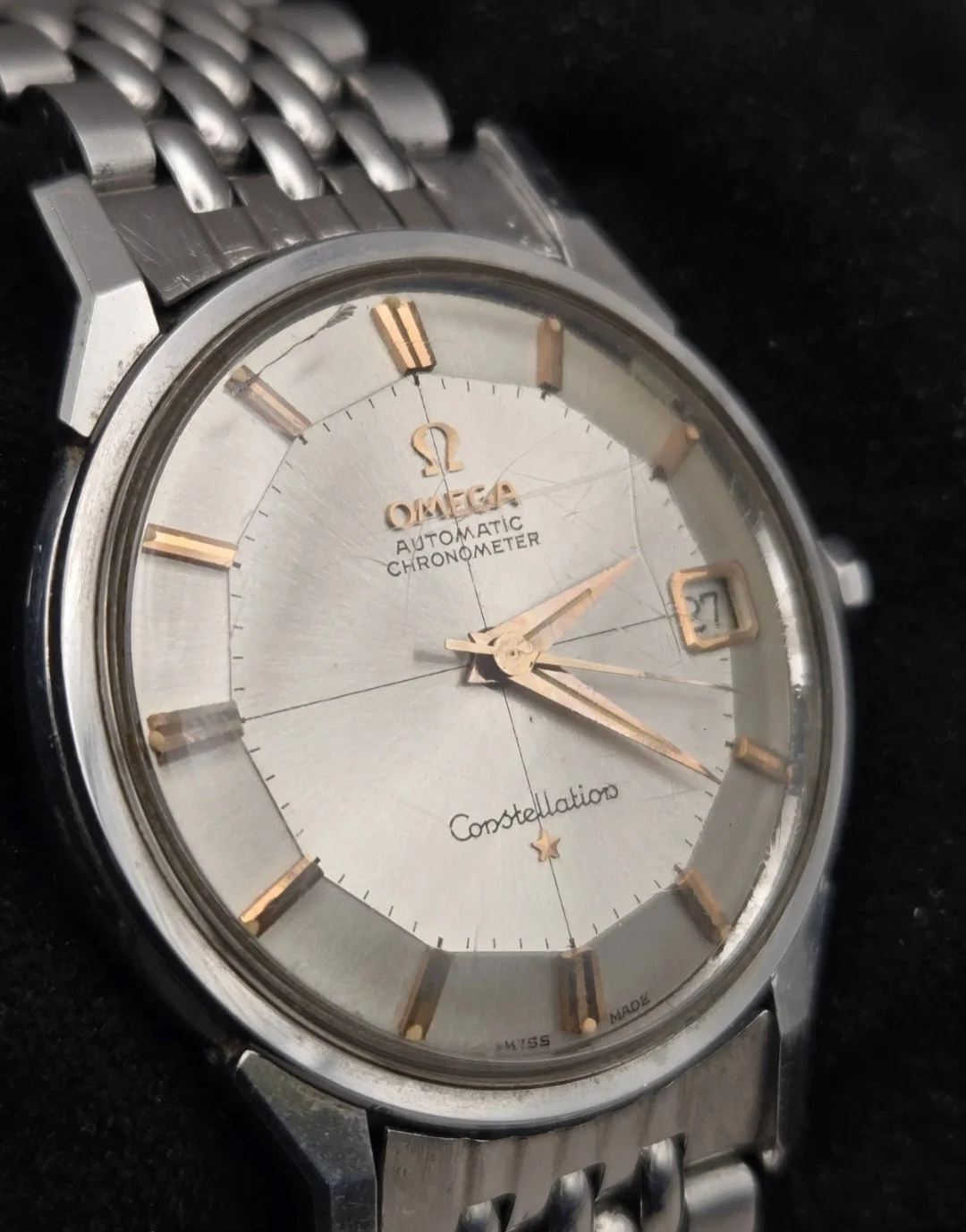

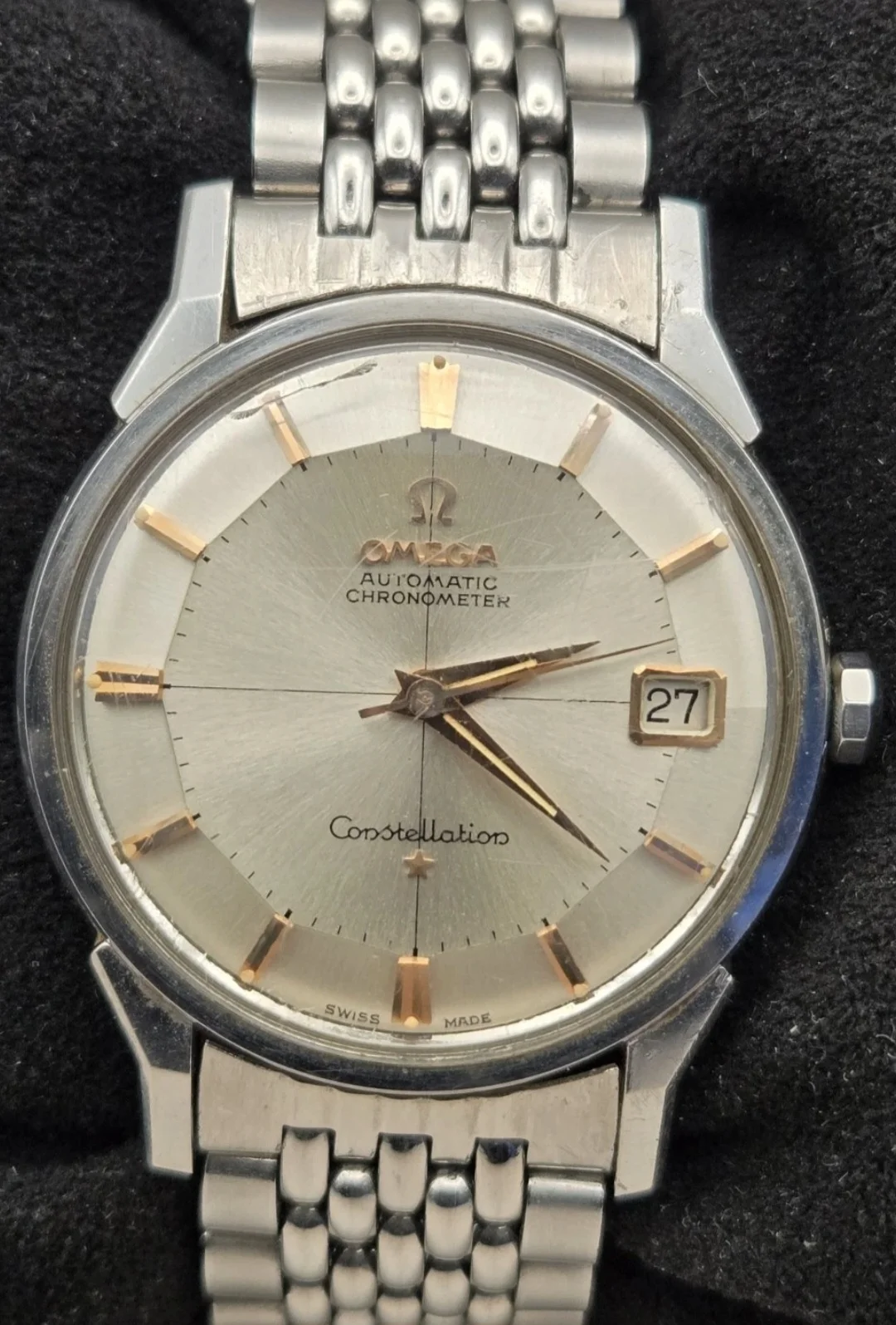

Hey guys looking to purchase this piece. Any red flags? I unfortunately can't get a movement picture.
Nothing stands out to me on the dial. Edges could be slightly better, but its not bad.

Love the gold furniture. Lugs look pretty good but need angled photo to see better. If can’t see movement I would factor uncertainty in price negotiation. More photos avail?

Case lugs look sharp one bite out of 5:00 lug . Bezel and caseback look good. Omega logo on crystal.
I don’t see any issue with dial
Do they state what movement and reference ? Serial number ?

Unfortunately its an auctuon and they have no idea on the movement and reference. The condition on the dial makes me feel a bit better of the unknown since I don't see any signs of water damage.

Highly trusted auction place to add... have bought from them before

Reckon it looks like a good example, only thing to note in my mind is you might want to replace the crystal at some point
Missing text dial, no Ts but has lume.
Almost certainly a 14902 with a cal 561 movt.

All looks good, lovely watch, a survivor, it will clean up very well. Only thing of note is the crack in the crystal at 11, but that’s small stuff. Good luck with the auction.

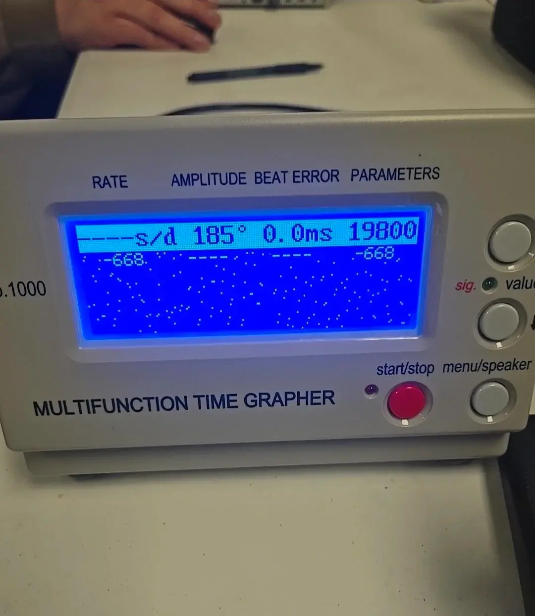

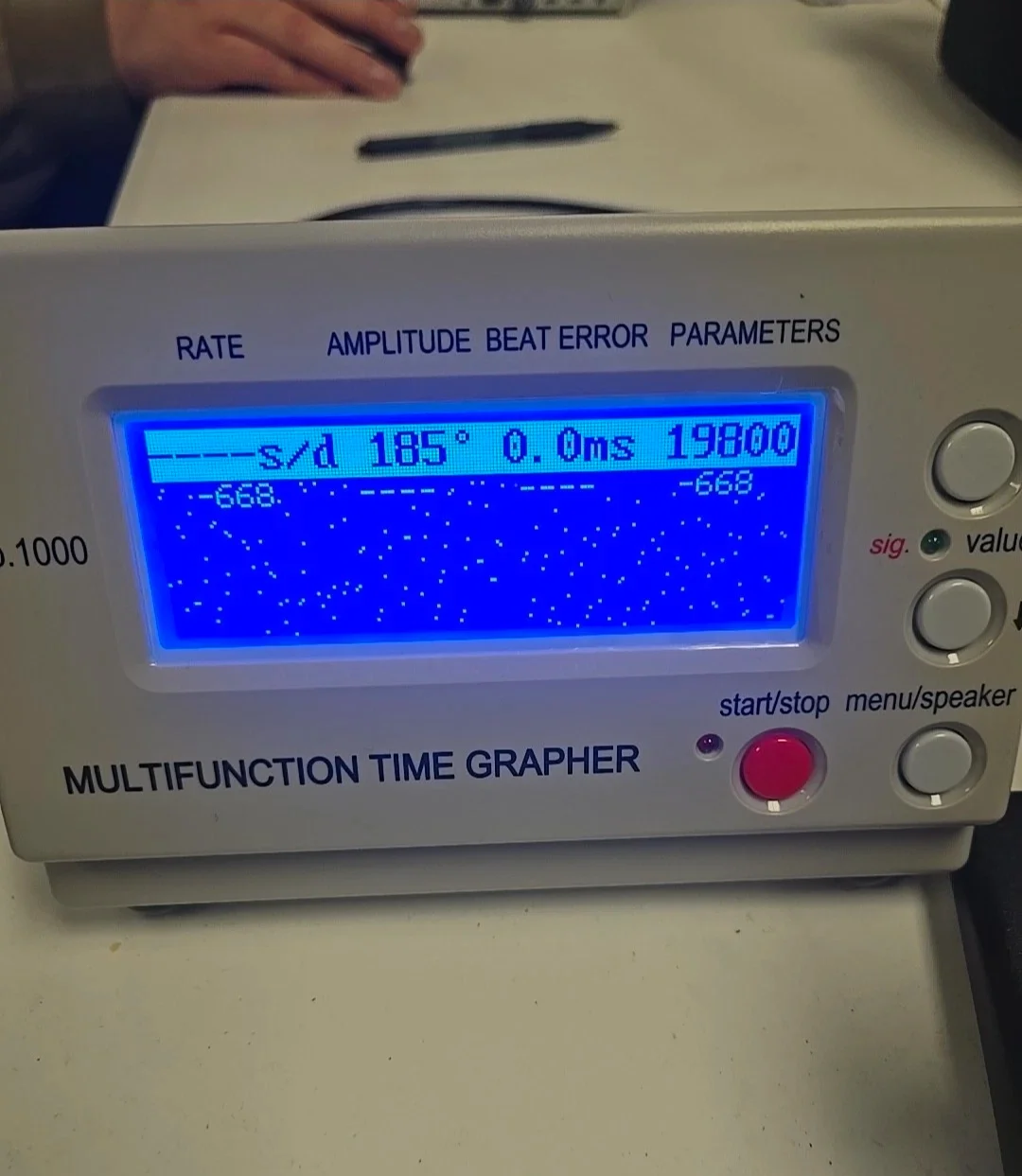

Can someone help with the below timegraph? I tried to look online but wasn't able to find much...
That means it needs a service.
Thanks I figured as much for sure haha just wasn't sure if that meant something worse since I don't have a picture of the movement

I got it. Probably overpaid a bit but just loved the rose inserts and a nice piece in my opinion. Have been hunting for a nice pie pan for 6 months or so
“Time tested for accuracy”
From the original description 😁
Anyways. It’s a nice piece and I don’t think you overpaid. Steel Doglegs aren’t easy to find with gold furniture, it’ll clean up nicely and prices have gone up, especially since the release of the “new” Dogleg Connie.

Well I suppose that’s true. It was “tested for accuracy”. The test just showed the accuracy was appalling
