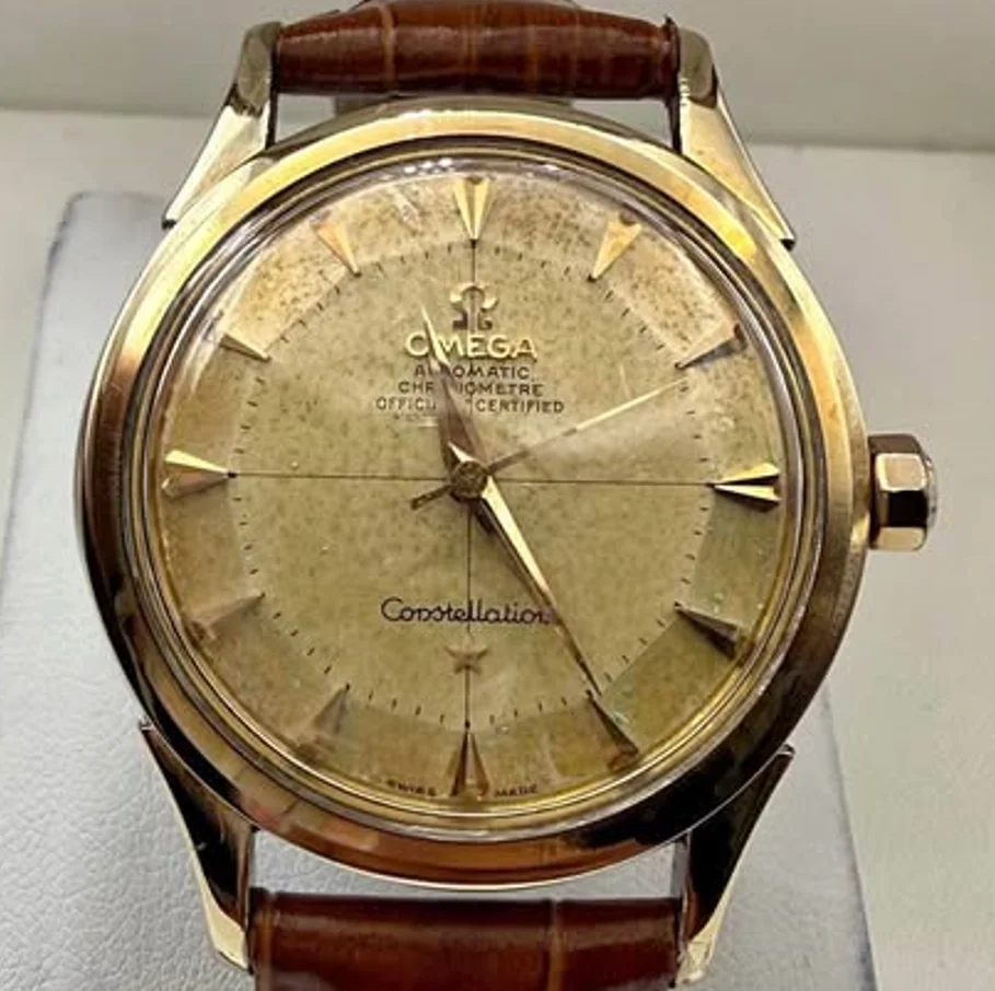

Hi everyone,

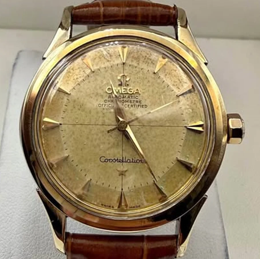

What do you think about this Constellation 2852‑3? How does the dial look to you? Is the crown correct? They’re asking about €900 - If you think it’s worth looking into further, I’m going to ask the seller for pictures of the movement as well. Thanks in advance!

Dial looks OK for me (poor pictures from the seller , PRO?) - never buy wthout pictures of the movement, time-grapher mesure and the inside caseback.
3,596
13,553

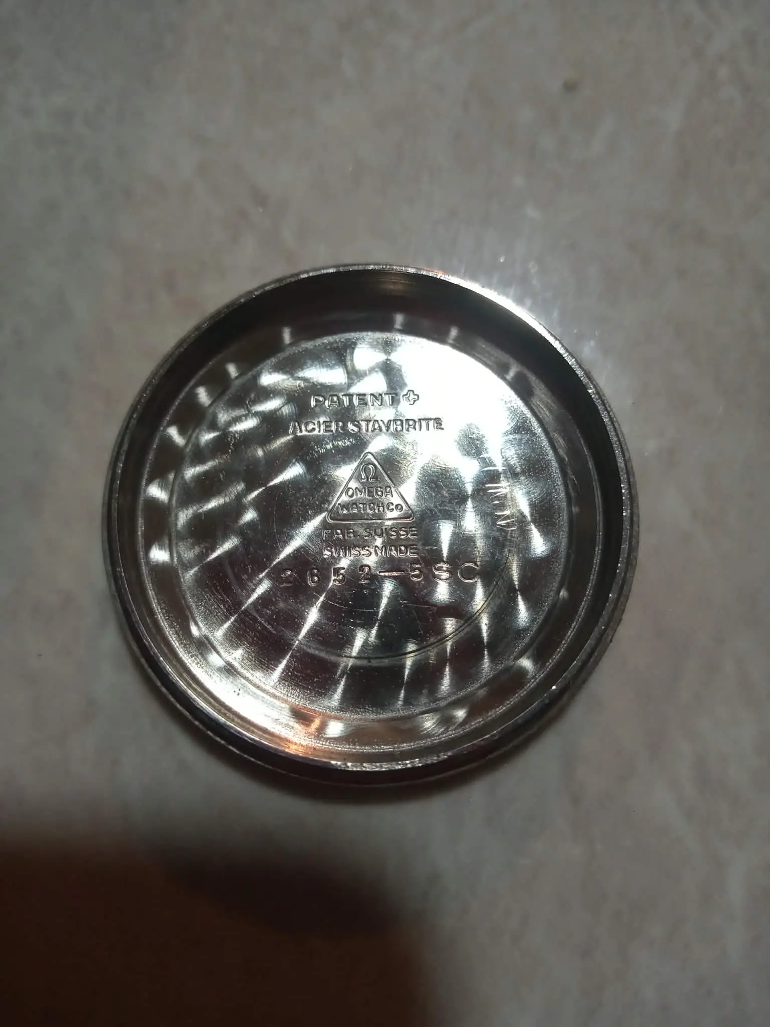

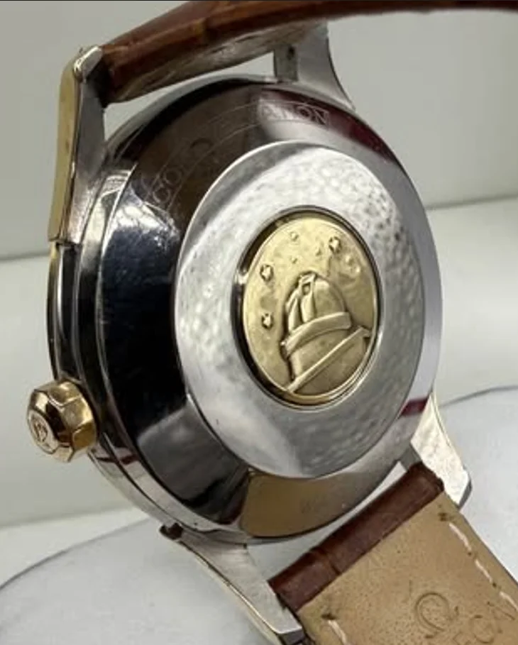

While I completely disagree with the above statement to “never buy without timegrapher measurements” (or even without movement pics, even though they’re both nice to have), the dial does look ok, as in original. Case back looks poor.
You know the reference of the watch - if you look at some other examples, what can you see regarding the originality of the crown, since you’re asking? Those are easily compared.
Do a little legwork, don’t just use this place as a free evaluation tool. You’ve been posting a constant stream of vintage Omegas of all sorts to have the forum check it without any noticeable research of your own.

Posting on this forum is part of my research; there are many Omegas for sale in my area, and I don’t ask for opinions on all of them. I only post the ones that look good to me and seem reasonably priced.
Here, people point out any flaws or if the price I thought was good actually isn’t. Regarding the crown, it looks good to me, although when looking up reference 2852 I found at least three different types.
46
7

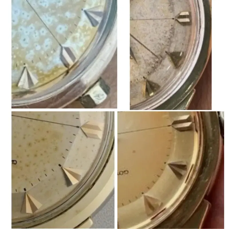

Furthermore, the vast majority of the 2852s available for sale have different dial indices from the one I posted, which I believe is a 2852-5 and not a -3 as stated by the seller.

Take your crown question for example - there are numerous threads about the correct crown for 2852s and an ongoing debate if it’s only one that’s correct (thick decagonal, #42019) or possibly two (clover, #42023). I summed this up for you now, you could’ve found out the same info with a short search on the forum.
The question about the indices, on the other hand, is a different matter. Using the forum or google, it’s easy to look at a couple handful of examples and if you notice that a certain style of indices seems uncommon, that’s a specific and legit question that you’ll always get an answer for.

The watch looks legit and correct, but unappealing IMO. Personally, I would not get any joy from that watch because of the poor overall condition (blistered/moldy dial and overpolished case). I would much rather spend a couple hundred more for an attractive example.

Thanks for your opinion - honestly, I couldn’t find any for sale at just €200 more. €900 is the best price I could find for a 2852 with the original crown, using eBay and Chrono24 as references, I see that prices for this model start around $1,400 USD and go up.and they go up to €2,500 for one in great condition (not this one for sure).

The price you pay depends on where you are looking and how patient you are. Asking prices on eBay and C24 tend to be silly and exorbitant and that's not the way to do valuations.
To get a good watch at a fair price, you generally need to give yourself at least a few months (depending on the rarity of the reference), and cast the net broadly, not only the easy places like eBay and C24, but forum sales listings, internet sales platforms (in the US they are Reddit/Craigslist/Facebook), local sales locations, auction houses large and small, etc. Be flexible, sometimes you need to buy a lot of multiple watches and then sell the ones you don't want. Sometimes the watch has potential but will need some TLC, etc. Educate yourself in advance so you are ready to jump as soon as you find a good one.
