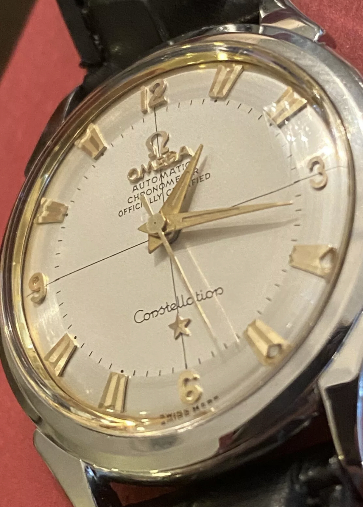

Connie 2852. Redial or not?
1,719
7,386
Another photo from the listing:
1,719
7,386

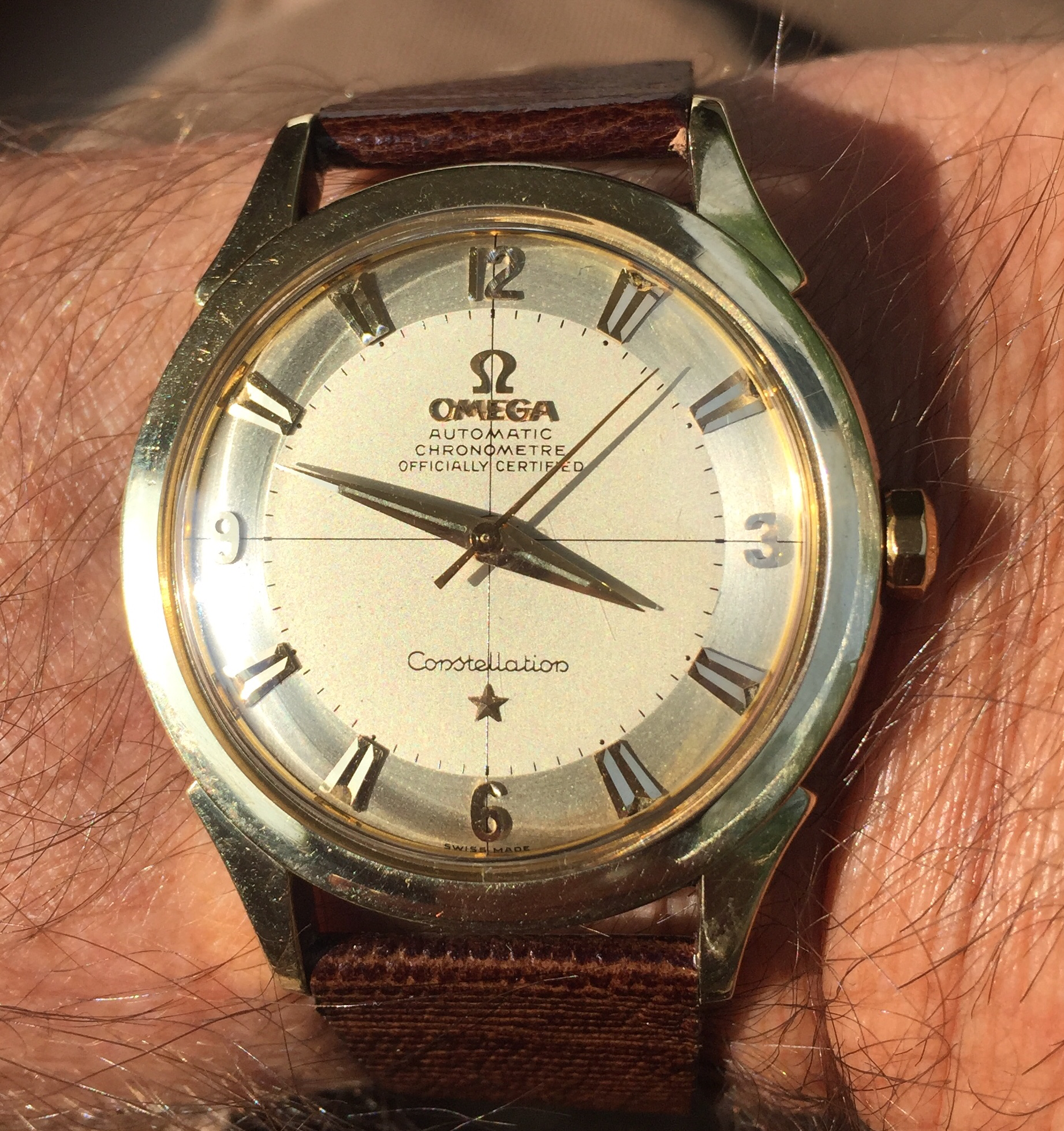

My own 2852 keystone for comparison
1,138
2,219

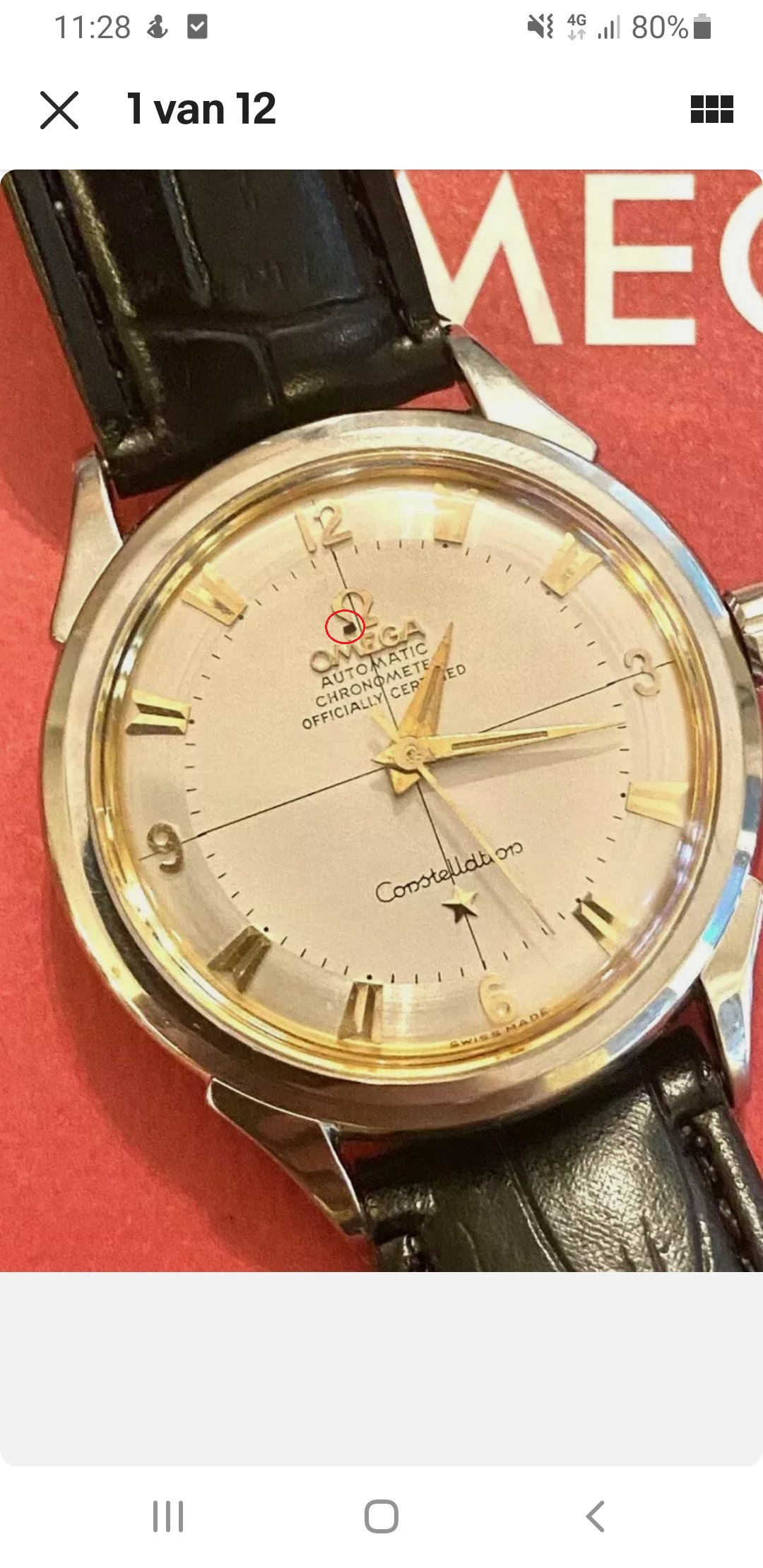

Look like the logo is bent and lifted at 1 leg:
Edited: At your other picture I also the "2" at 12h marker is also lifted.

I have never seen a redial with a silver/matte two-tone dial reproduced.
1,719
7,386
@Shabbaz is right: the missing crosshair under 6 and the weird a in Constellation are giveaways! Damn good redial!

The funny thing is... the second time I did'nt see the crosshair problem under the 6 o'clock... ::facepalm1::
1,719
7,386
Neither did I 😗
