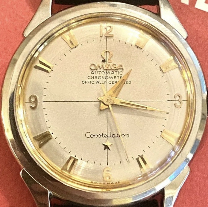

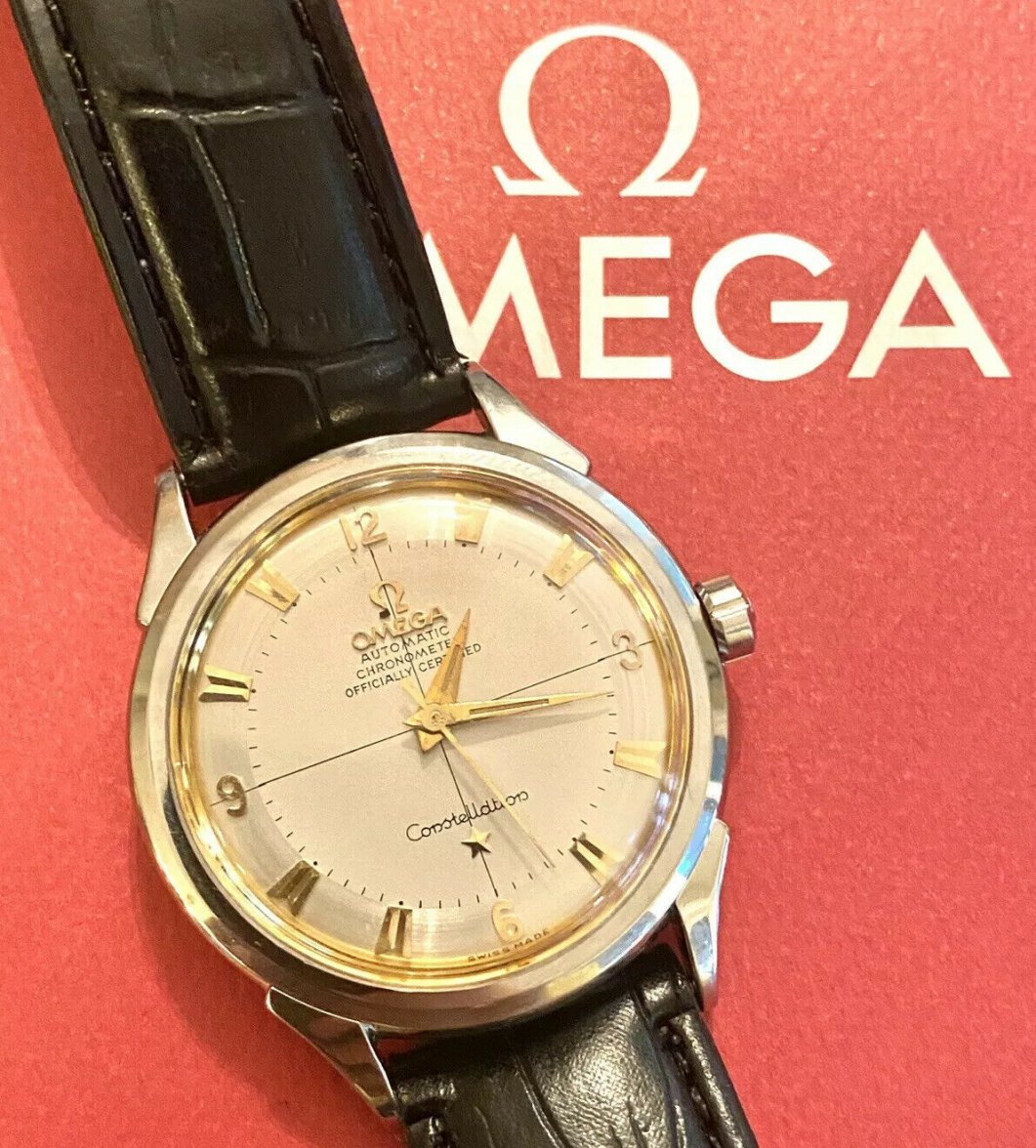

What do we think of this Constellation 2852-6?

Funny. The straight up picture gives a totally different perspective.

Funny. The straight up picture gives a totally difference perspective.
I was impressed until I saw the head-on picture. Too thick crosshairs and inconsistencies in printing (at 6 o'clock as @Shabbaz says).
This is true. However, these are easy defects to fix for the next one.
They got the basics, such as the fonts, aging lacquer and the two tone finish correct.
That's why it is scary good.

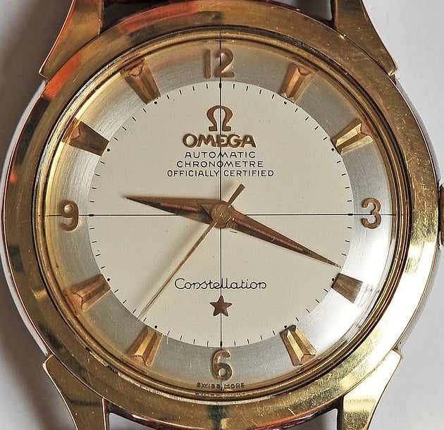

REdial.
How that dial should look like:

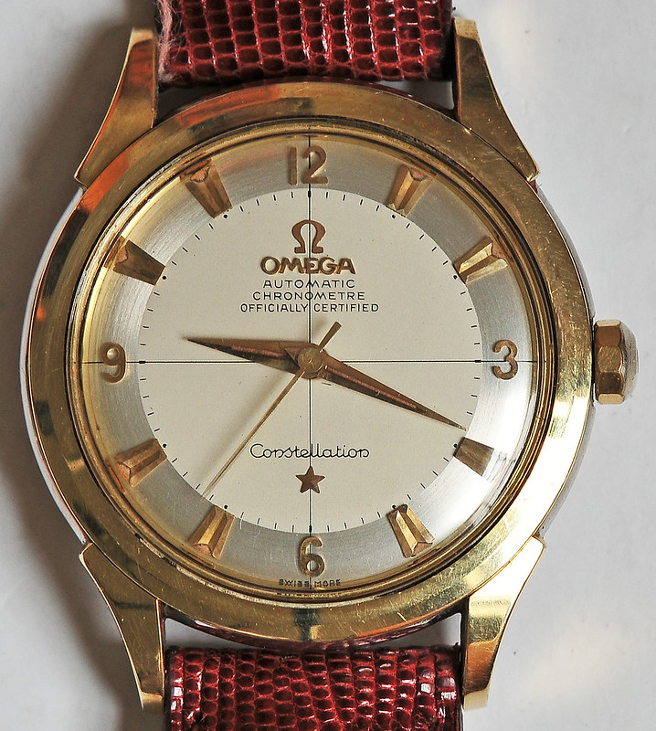

Let’s put these side by side for comparison
If I could only adjust the lighting.
Still way too close for comfort.

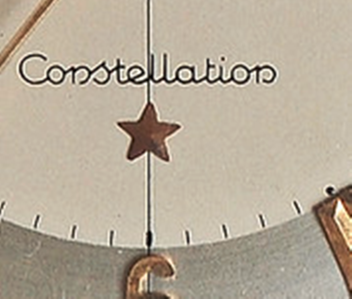

Swiss Made isn’t centered under the 6 either. I was fooled at first too. The straight on photo makes it clear.
This is an enormous peeve of mine - when sellers photos make it obvious he’s trying to hide something. Particularly the professional watch dealers on eBay, whose photo quality varies depending on the watch.

Here’s my comparison of the two dials
This makes it really obvious. I don’t like the hands either.

Look at where the crosshairs meet the minute hashmarks at 3,6,9, and 12. Lots of decent redials get those spots wrong. And of course what I meant by REdial is the use of ER instead of RE in chronometre.

Before I joined this forum, I didn’t know about the importance of straight-on pictures. This is the best proof. Looks so much better from an angle, even though - thankfully - there are still smaller details like the weird a and the re vs er spelling. But much harder to notice.
A bit of a critique of that particular picture: way too much use of image sharpening.Notice the white areas around the black areas. It has the effect of making the edges of the lines look sharper than they are.
Oooo I also noticed this and was wondering if this is a dead giveaway of a redial? Could it be possible that chronometer/re could’ve been produced both ways originally?
