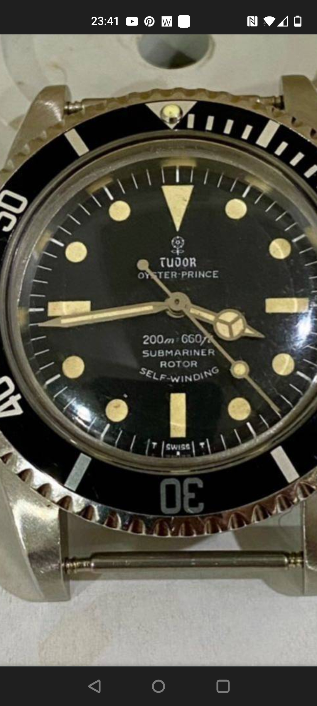

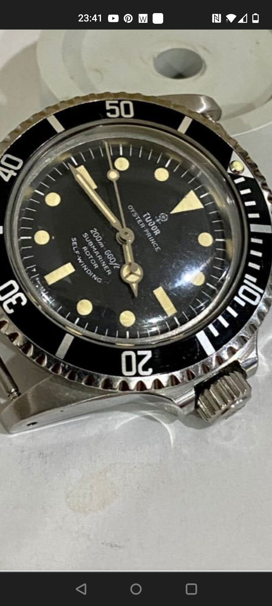

Hi all,

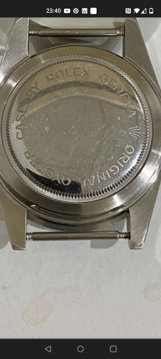

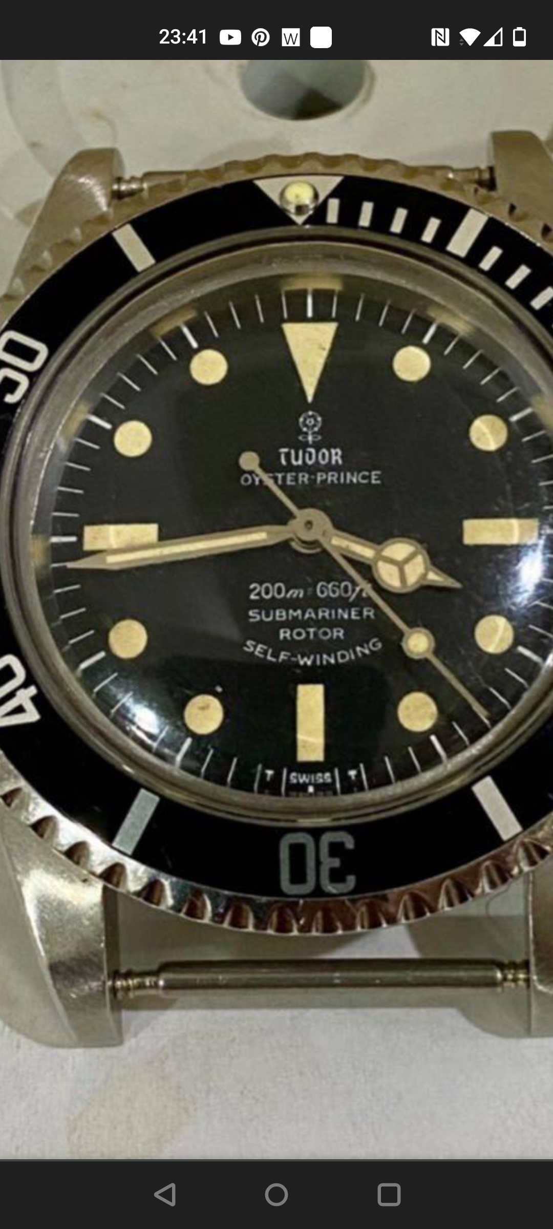

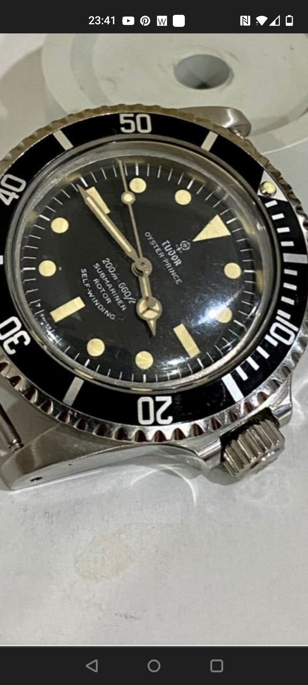

Id appreciate any pointer on what to look out for when spotting a legit Tudor 7016. Im pretty good on modern Tudors, but these older ones make me sweat.
I know obvious dial tells around the rose and the <25 , but while these both look ok to me, as does the rotor there is something that seems off. Fully accept these pics are less than desirable but any pointers/tells greatly received. My suspicion is it's a franken with a refinished dial.
1,615
3,862

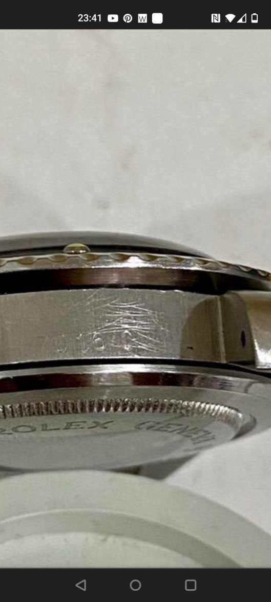

Case looks new, no endlink marks under the lugs? I generally stop right here and call it a fake/franken...
897
3,715
As you stated its really hard to tell based on the photos you provided. The case definitely looks polished. The bezel also looks off but could just be the angle of which the photo was taken. Would need clearer pictures to provide a better opinion.
115
142

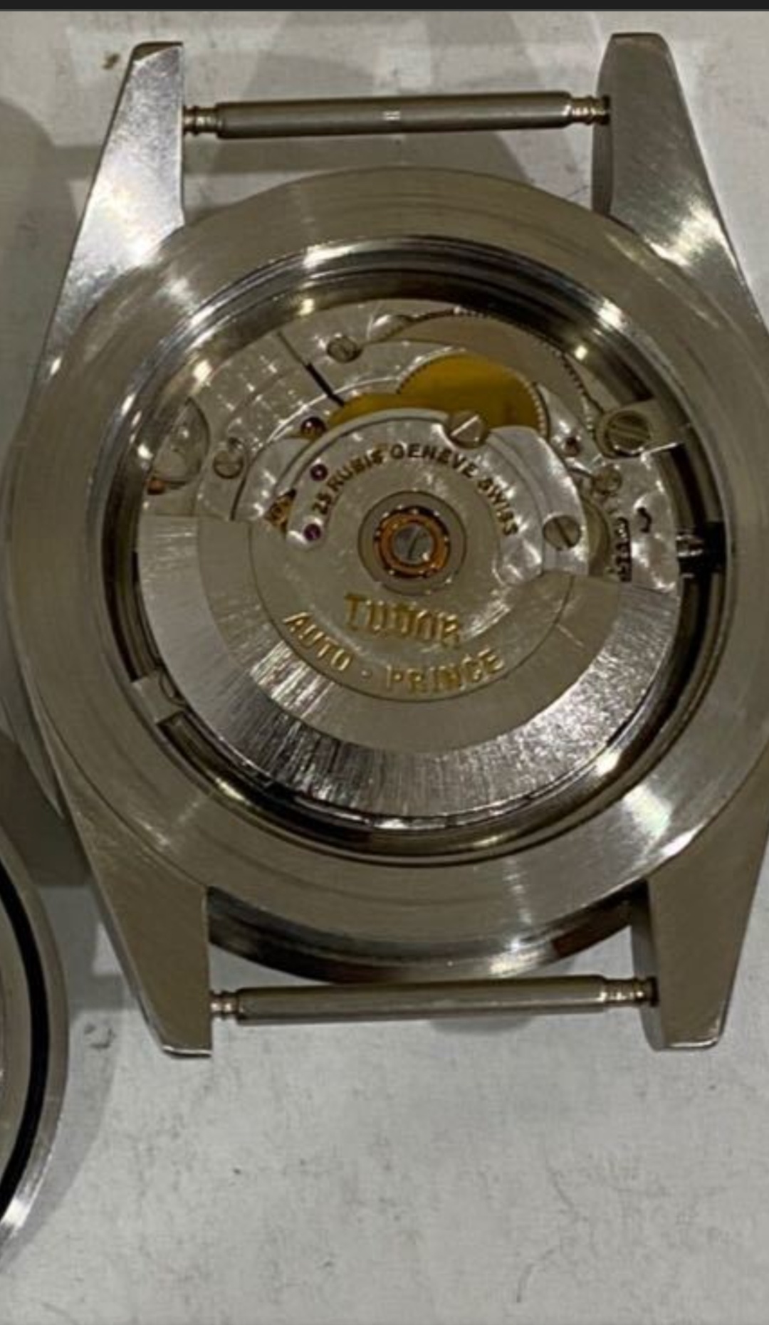

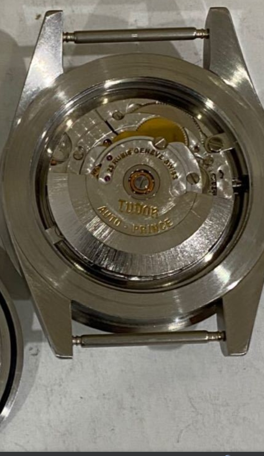

100% fake. Every single part is brand new. Looks like the ones coming out of Vietnam
