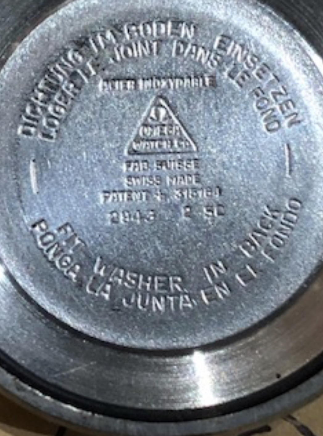

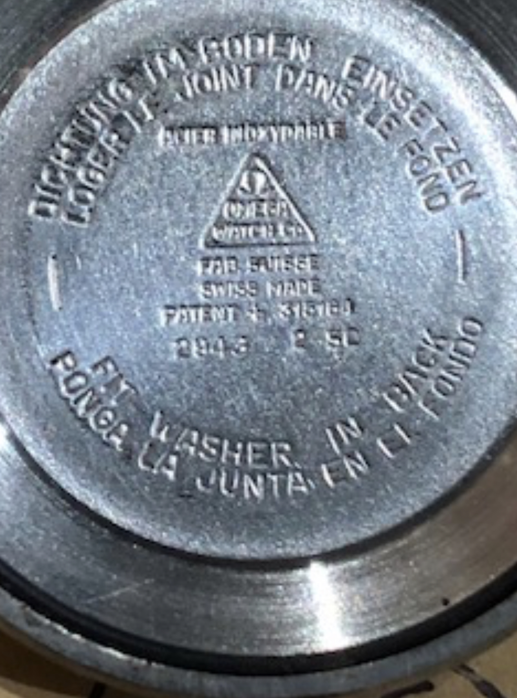

Did you get a photo of the inside of the case back? That's where the reference number is. That would answer a lot of questions.
I have been sent this photo of the case back.
the reference number is 2943.2.SC
Case 33mm (not 34mm as my cheap digital callipers suggested)
