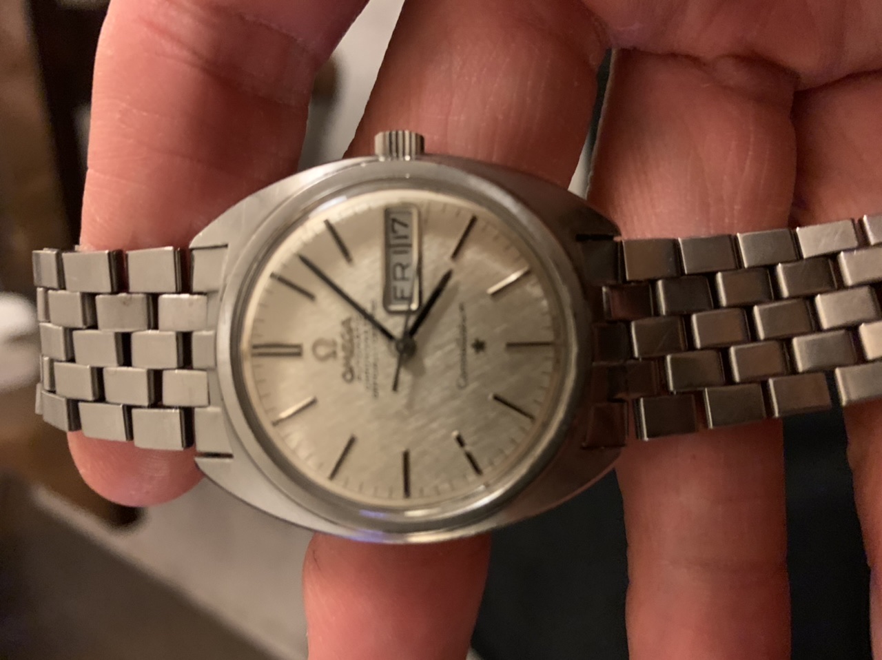

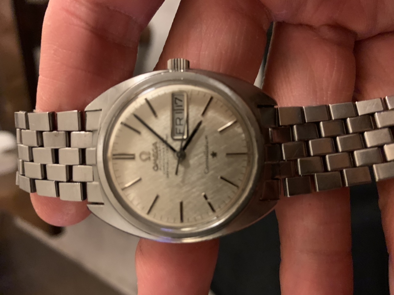

A poor quality photo, but just a quick grab shot of another Omega from the small collection. Is this a 1969/70 Constellation day date C case?
4,593
10,813
Somehow I get the feeling you know the answer to this and all previous questions already. Maybe it's just me?
