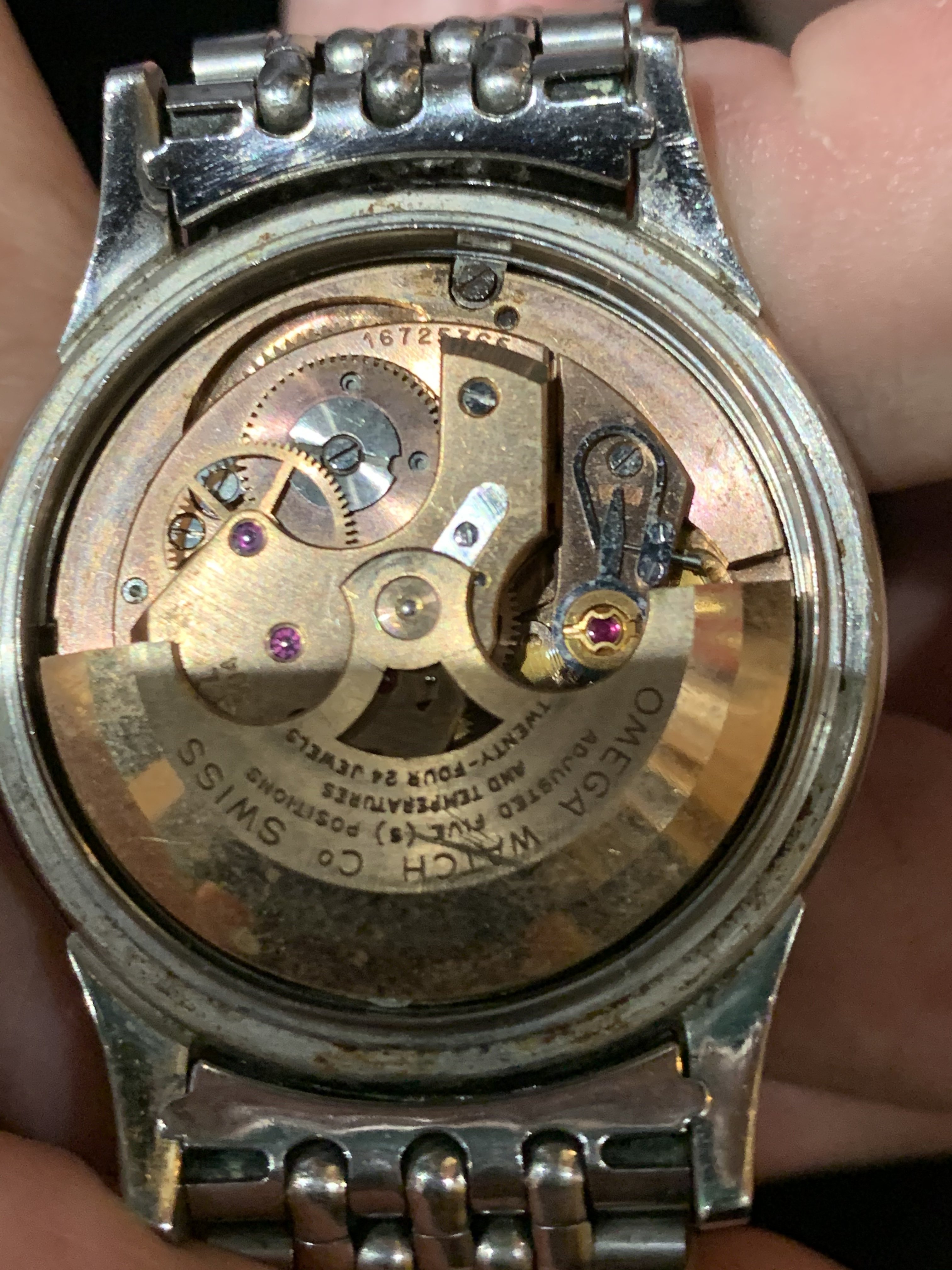

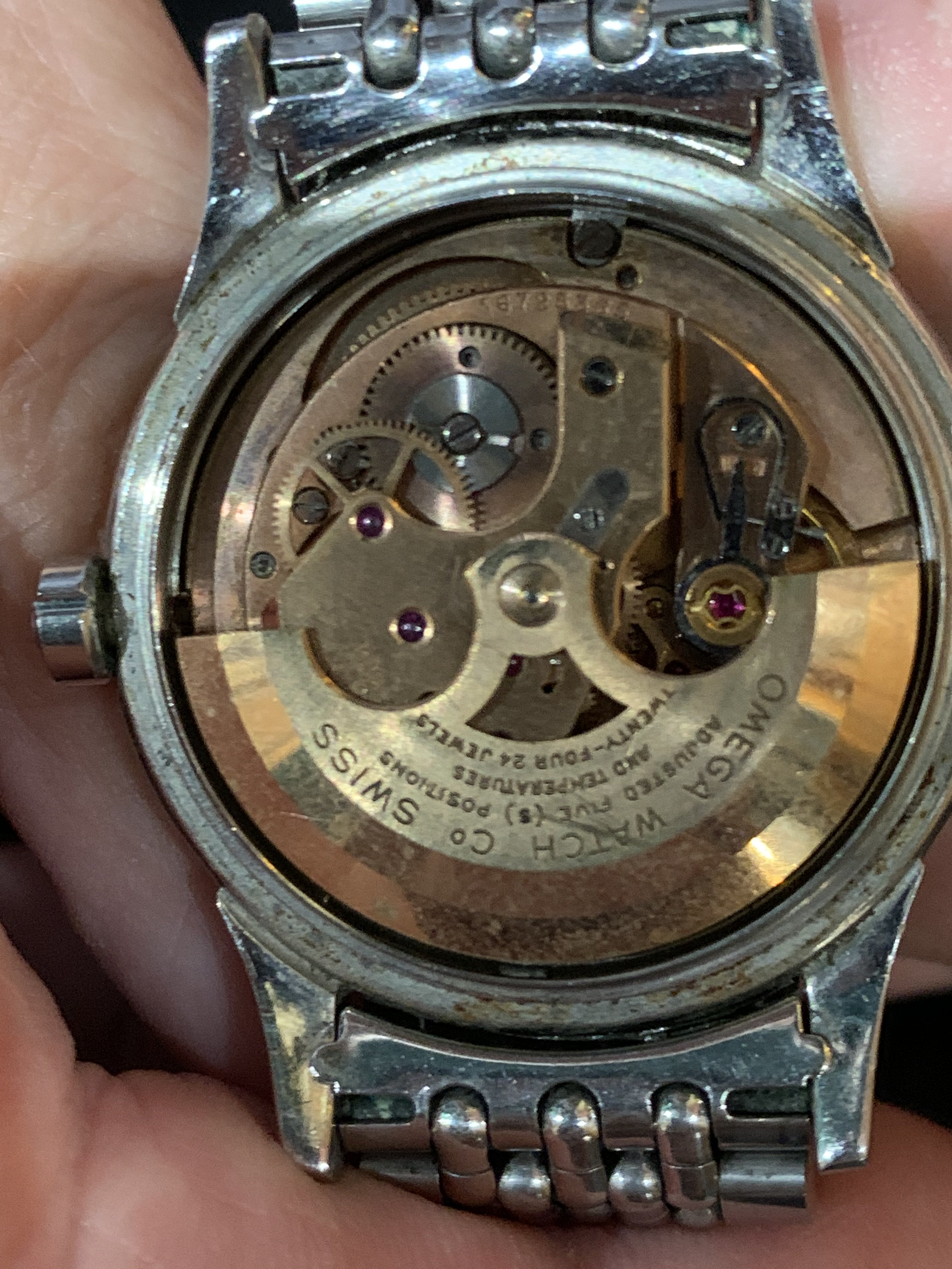

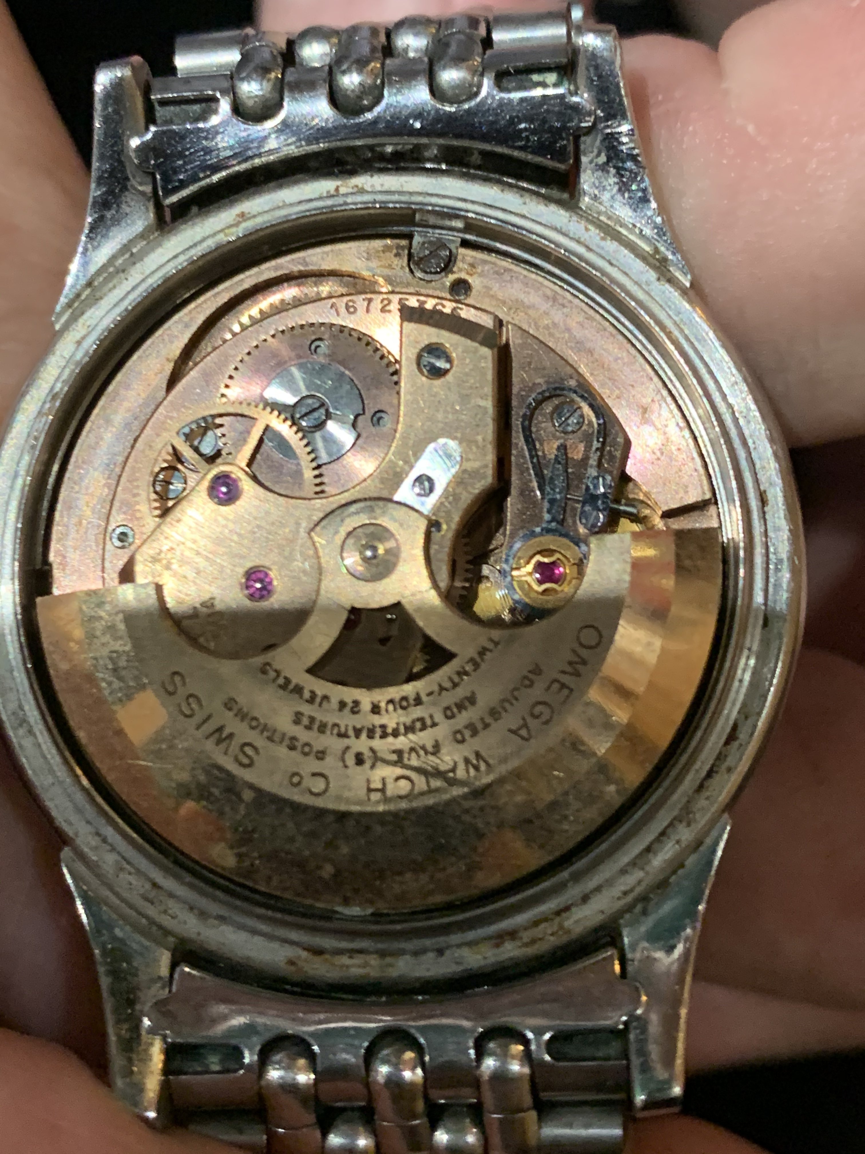

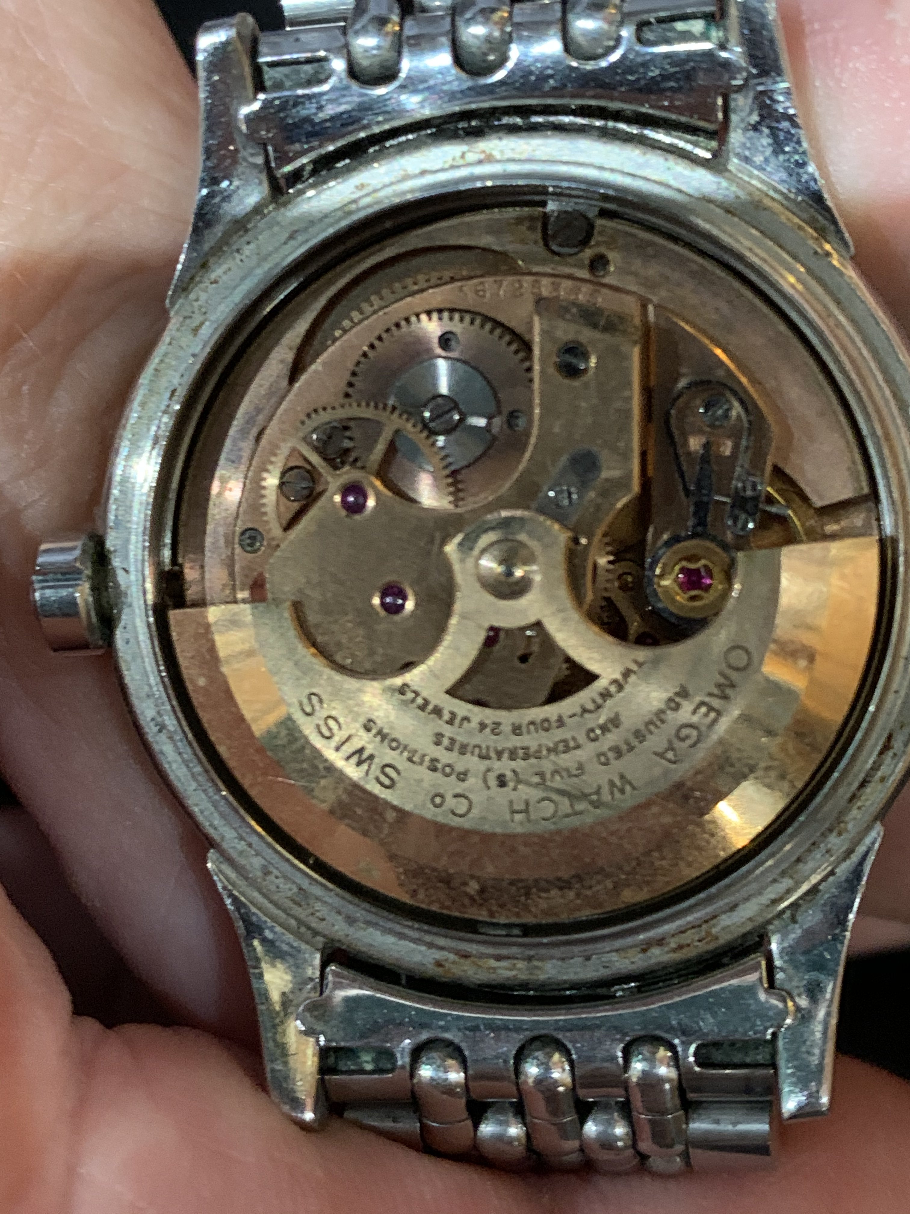

So watch has been taken to a jeweller, the back opened, and details noted.
Year 1958
Serial number 16725366
It is being sent off for an estimate of work needing done.

Did you get a photo of the inside of the case back? That's where the reference number is. That would answer a lot of questions.

Also, in a matter of days, I’ve gone from been given the impression that there were issues with the watch’s originality, to now realising that the watch is 100% original and unusual.
The chap who inspected the watch commented that the watch case back was entirely clean inside, and the gasket intact. There was only a single area of dirt around the crown stem, which gave him the impression that the watch had never been opened before.

Option 1 only please, this is quite a rare watch.
And as @MtV says, then wear it yourself.
All your watch needs is the case and bracelet cleaned in a sonic bath, the movement serviced and cleaned (and parts replaced if need be)
It needs nothing else, unless the lume in the hands require stabilising, or the crystal needs polishing.
no polishing of the case, it will look much much better after a sonic bath, I promise.
