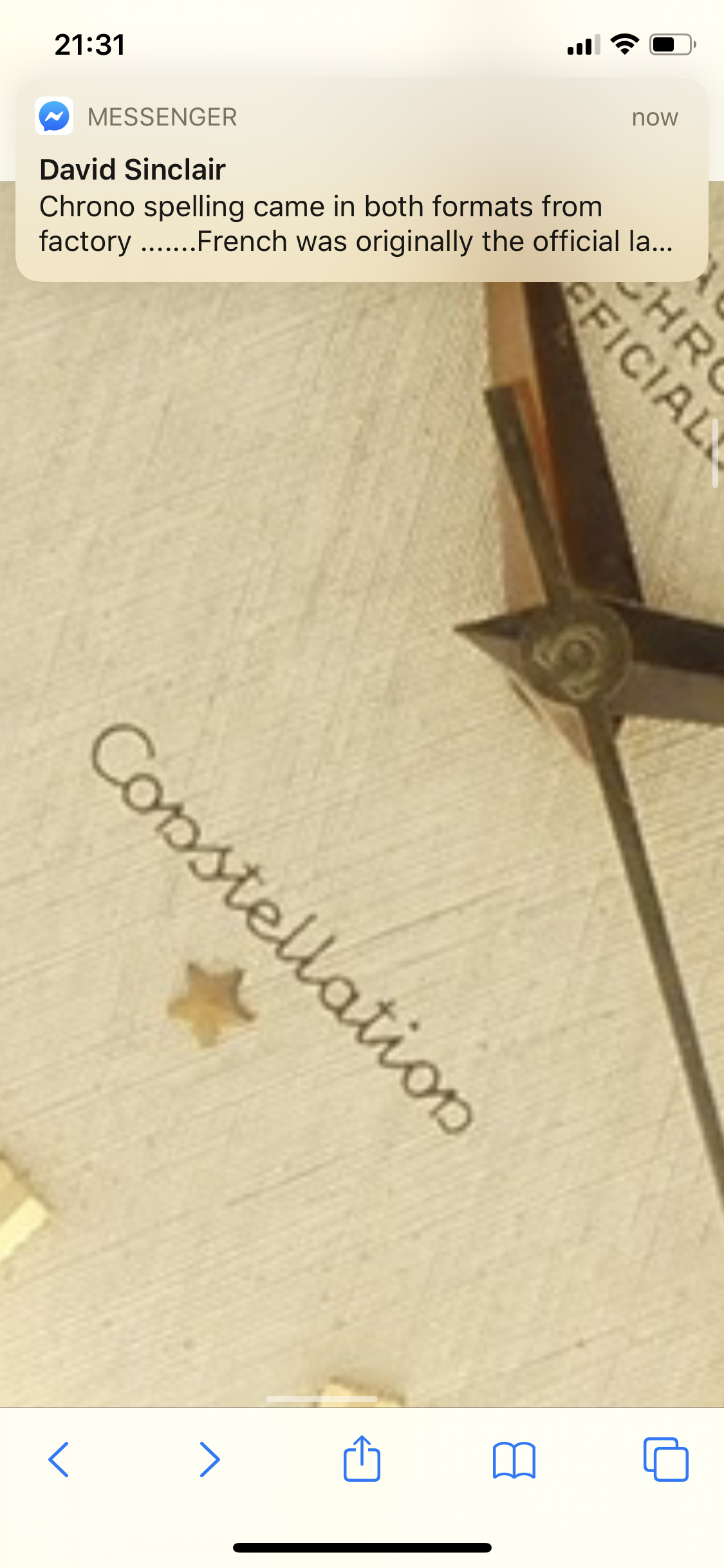

Can anyone offer help with this watch please
63
57
Something strange, the double crossed T's are from the earlier references.
I'd guess maybe a redialled 2943

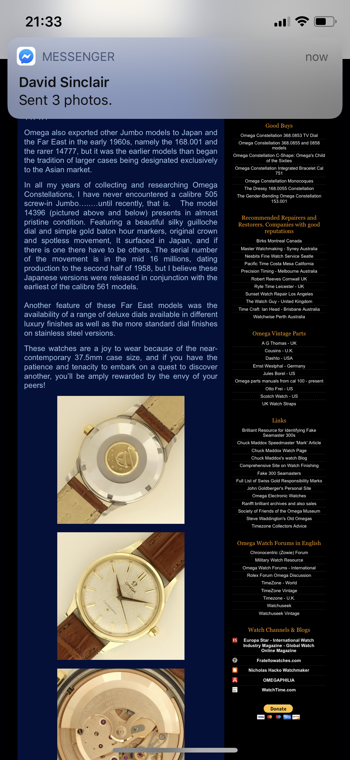

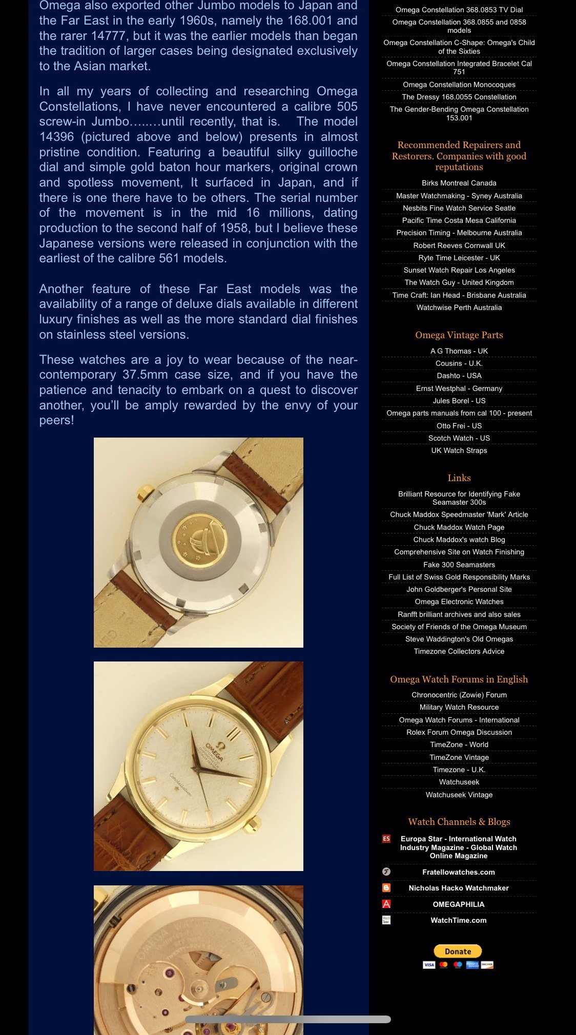

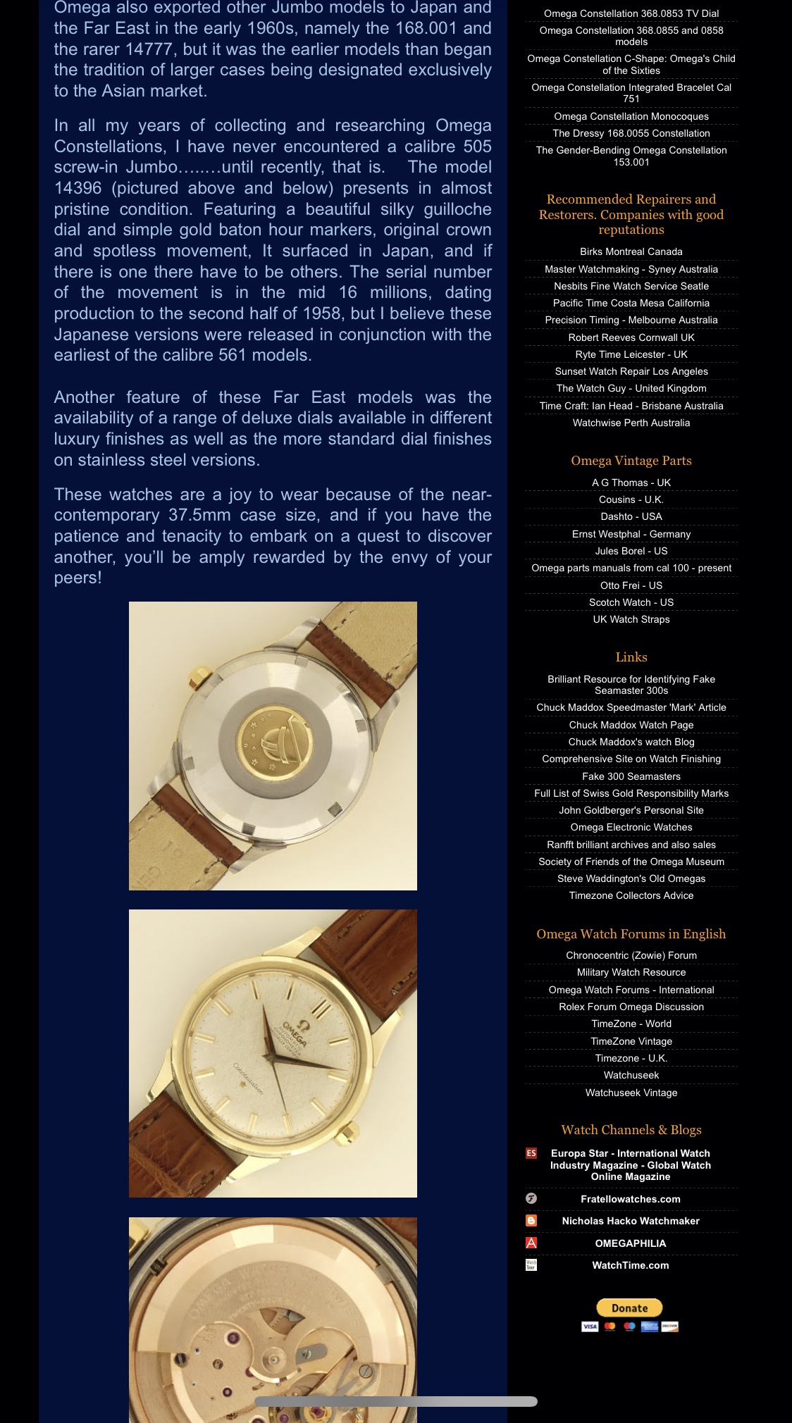

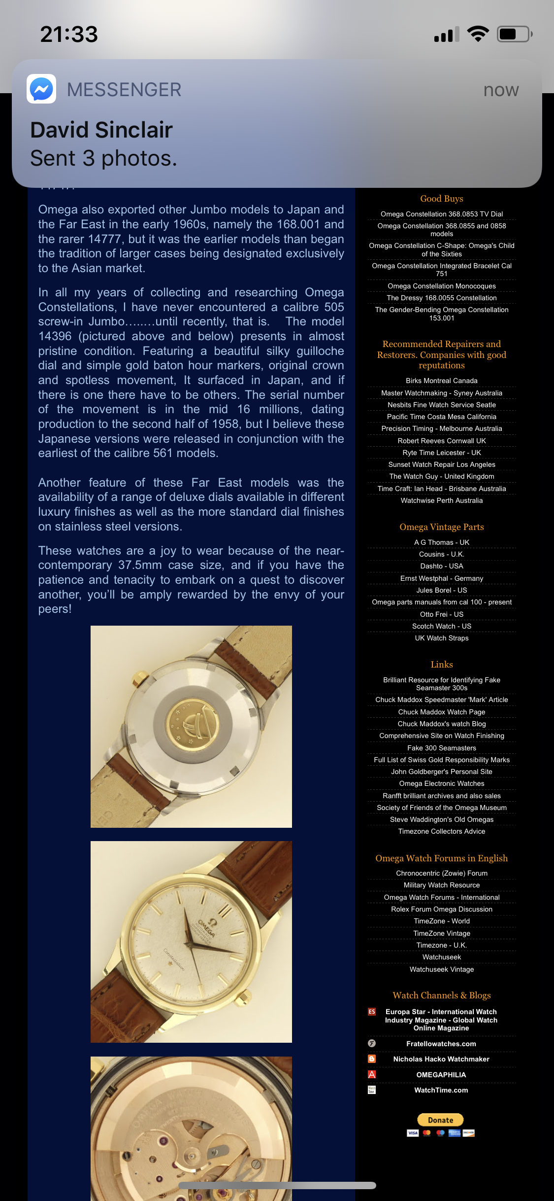

I have found something similar on another website http://omega-constellation-collectors.blogspot.com/?m=0 which seems to show a similar font on a Japanese market model... my watch would likely have been bought in Singapore or Malaya. So I am not sure if this is typical of some Easter spec watches?

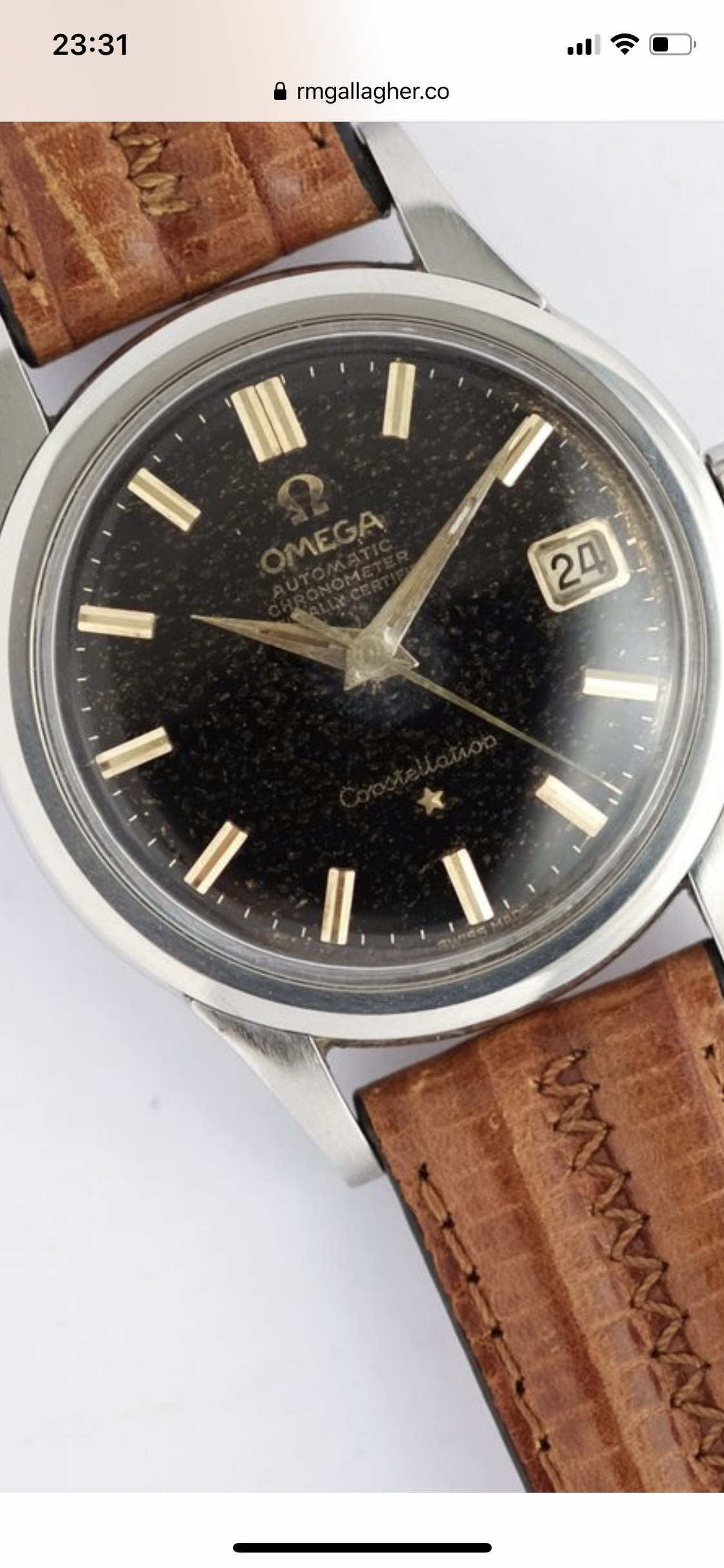

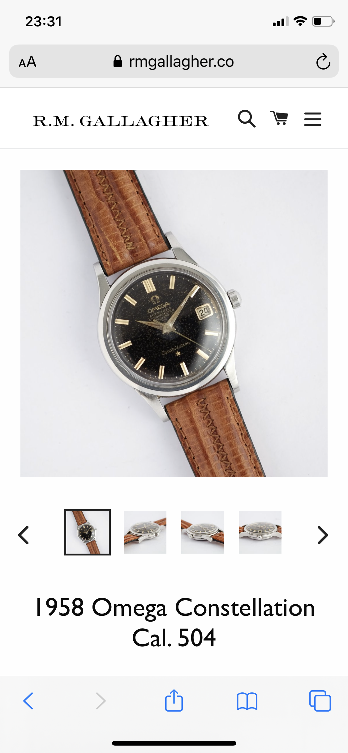

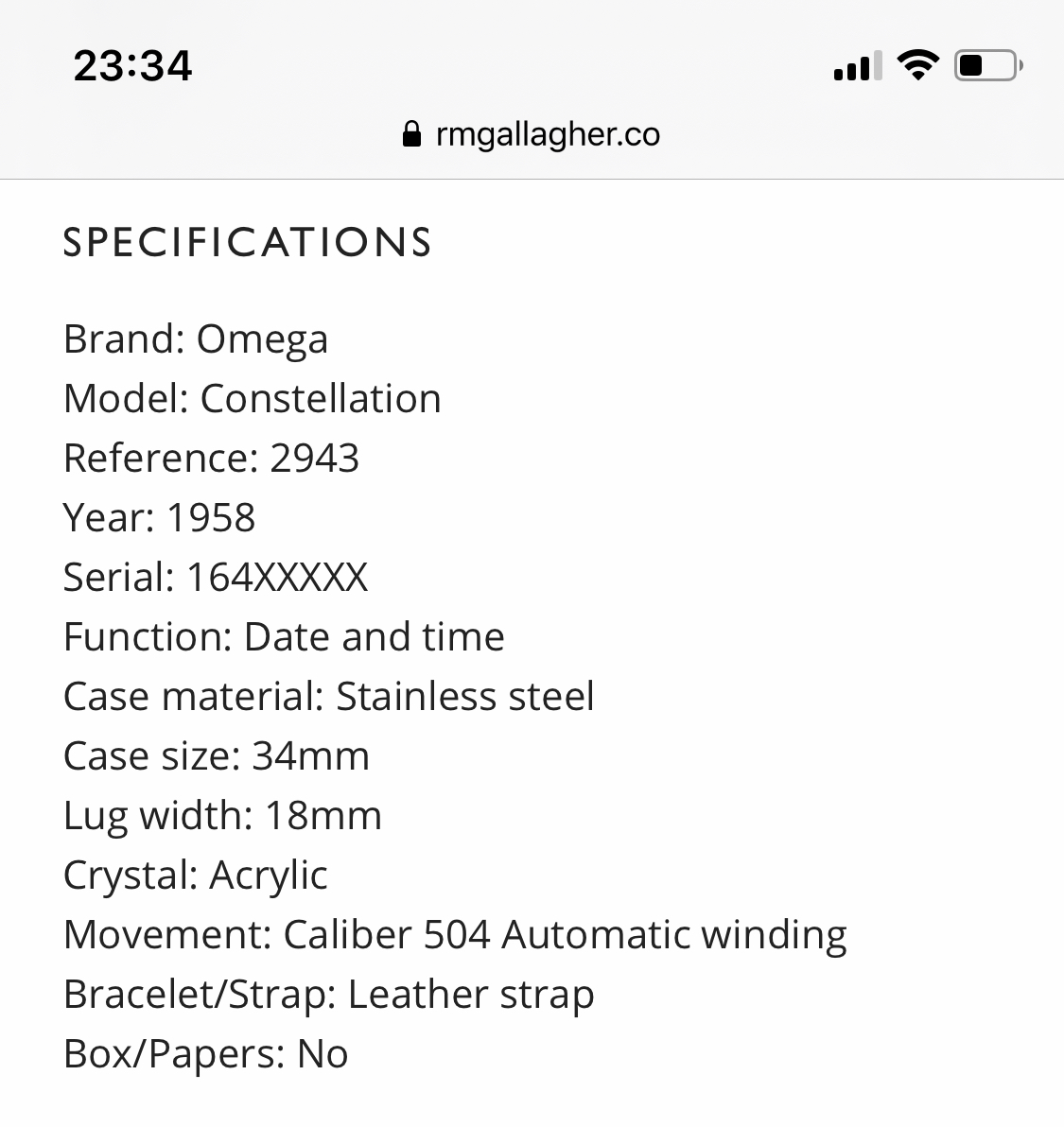

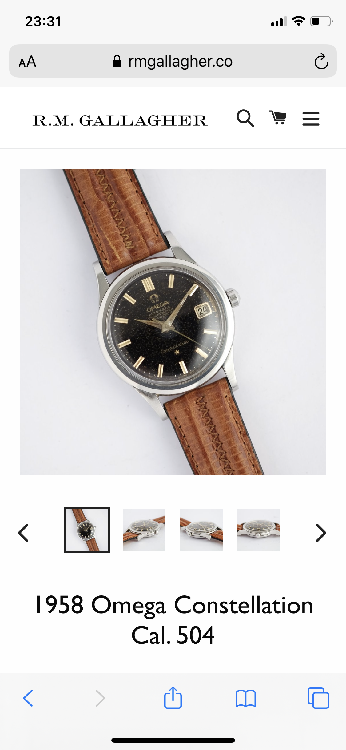

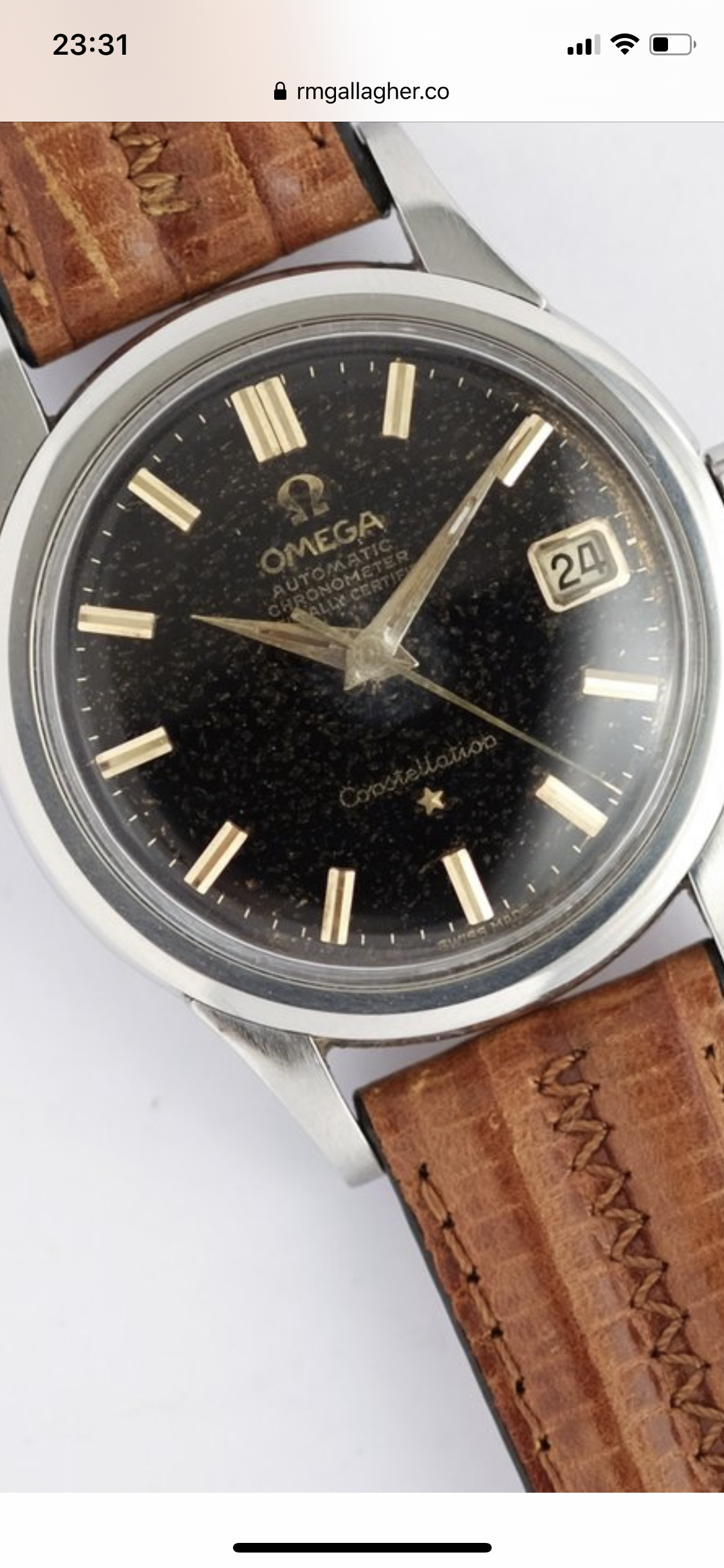

Could this be the same model... I seem to have gained more questions than answers ... such is the joy I guess.
https://rmgallagher.co/products/1958-omega-constellation-cal-504-2?variant=12482843148385

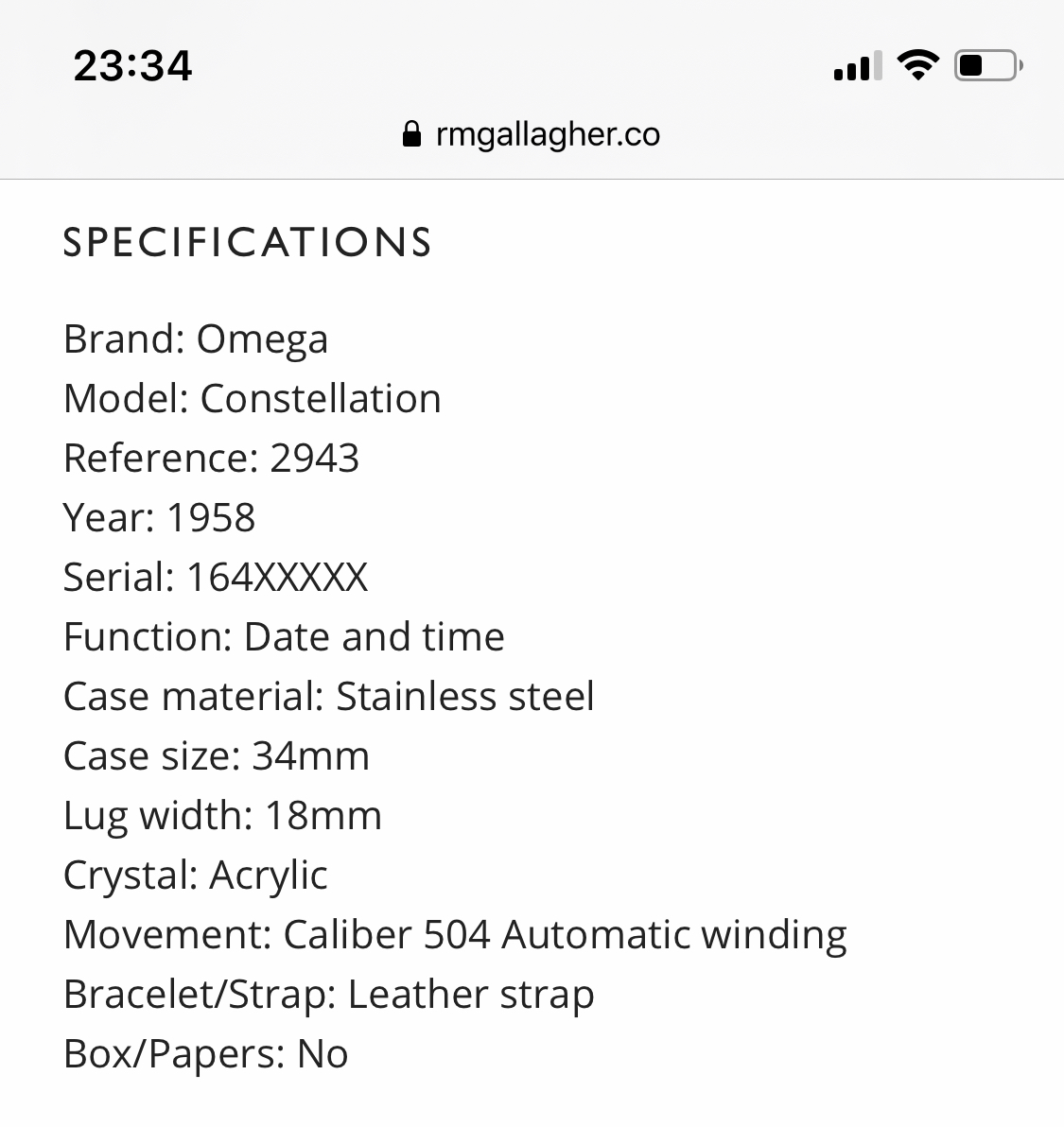

Thatt's an interesting development and certainly makes me now believe it could well be an original dial especially as you have also found an almost identical to yours black dialled cal 504 ref 2943 with a non 'calender' dial for sale.
Indeed, and two identical examples of that ‘Constellation’ font type on different watches.
I must say when the font type was pointed out, I thought something would be far wrong here. However it seems like a recognisable thing. But how strange compared to the usual font.
I can’t believe I had never noticed that before. Some eagle eyes on this forum! Great stuff. I’ve gone from knowing zero about this watch to loads in days.
Another thing pointed out by a friend of mine is the crown. Apparently it is seen on the Seamaster, but some made their way into Constellations straight from the factory in 1958.
Also I have read that the word ‘Calendar’ appears less often on 2943 models where the spelling of chronometer changed from ‘-metre’ to ‘-meter’.
In addition, I have read that black dial models were usually special order ones. The word ‘calendar’ apparently appears even less often on black dial models.
The gold hands appear to have the mark where the radium has faded. Again other similar watches have the same hands. The gold on mine has a heavy patina, so I suspect they are original.
Everything I have read suggests that the watch is from 1958. However the BOR bracelet with the over reaching Omega sign seems to be that of perhaps 1957? I’m totally unclear on that.
The cyclops lens too is unusual. It looks like an original to my non expert eye.
Would all these factors suggest a watch made to order based The cyclops lens, black dial and BOR ?
If this lens was a ‘redialled’ watch then how would I tell? It certainly matches the identity of the other black dial model I have found. In addition, there are one or two points on the black finish we’re a gold colour is showing through, perhaps a patina showing its age. Would a redialled or refurbished model show this too?
the font used in the word Constellation remains a strange feature, but again is respirated on other watches. Has anyone else come across this before?

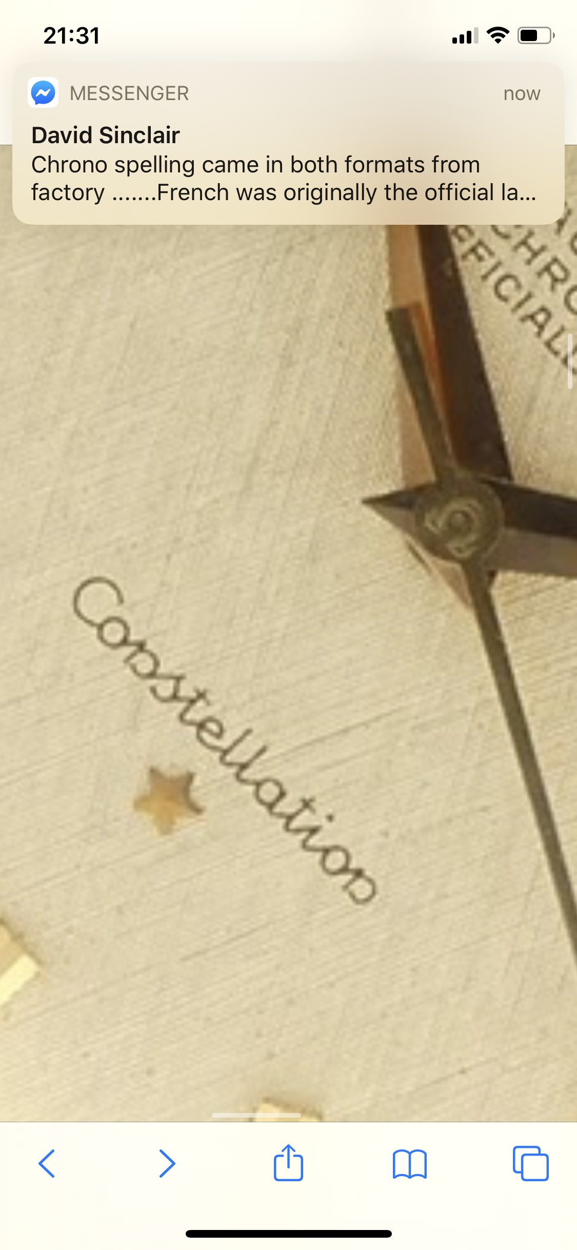

This is classic Omega.
Crossed Ts only appear on XXXX references and with ‘chronometre’, that is until they appear on a later reference - with a particular font and ‘chronometer’
There are variations of the earlier crossed T fonts.
Especially the connections to the n.
Desmond shows the ‘full n’ version with looped connections to the n but this also occurs with the sharp connection as per the other types Desmond shows.
(@MikeMan2727 had one like this)
None have the high-connection’ to the top of the i that @MtV pointed out.
but to have the two black dials and the linen dial jumbo that Desmond shows, all with the high-connection i and chronometer, this makes a genuine type IMHO.

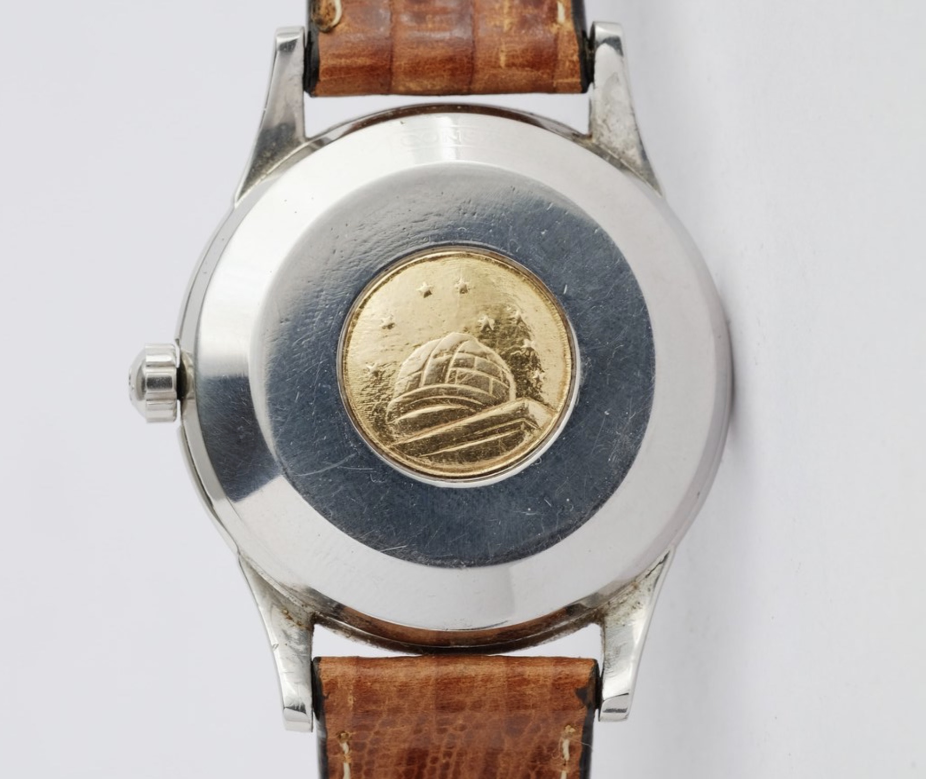

One oddity with the RM Gallagher watch - it has a brickwork observatory.
If this is a genuine medallion, it predates the ‘change’ by about 7 years.
10,725
16,697
Hat's off to Sockie. We are often quick to tell a noob to do their research, and that is just what he has done and found something that many of us thought wasn't out there. I can't understand why there is lume on the hands only on both the black dial Connies too* so either this is a genuine rarity reference or both have been messed about in the same way (which seems unlikely).
* can anyone suggest any other Omega ref that has lume only on the hands and not dial?

Is that not lume down the centre of the RM Gallagher indices?

A couple of points that may help:
1. No Constellation of this era came from the factory with a bracelet. They were dealer installed options. Although a bit later than your example, this is the general idea:
http://www.old-omegas.com/catuk63.html
2. I have seen a very few of the last of the 1st generation Constellations (ca. 1958) with the Chronometer spelling on the dial. These were generally Ref. 2887. There was a discussion on these “-er” dials on this forum some years back:
https://omegaforums.net/threads/ome...ref-2887-a-very-uncommon-case-reference.4421/
In my view, this is an original dial. The radium was supposed to be painted on top of the markers. It could have deteriorated naturally, or been cleaned out at the request of a former owner.
I think this quote from @MSNWatch, who probably knows as much about these watches as anyone on the planet says it all...
Collectively in this forum we know more about vintage omegas than omega does but nobody has a monopoly on knowledge about a particular vintage omega model. While some members here know a lot about specific models, no one knows everything about any specific one.
Maybe. Doesn’t look that way on the OP watch but maybe it is.
6,687
10,318
I would say definitely no lume on the OPs watch other than the hands.
However, I don’t know enough about earlier Connie dials to say it didn’t originally have lume as @gatorcpa suggests.
On the other hand - special order dial, special order crystal, who’s to say the original owner didn’t order special hands?
- or simply had them changed at a later date.
Zero lume on the markets... just three smooth surfaces.
I assume it was radium down the markers. I just assumed they were decorative grooved in the hands, but someone else suggested it would have been radium at one point.
I don’t see my late Grandfather being someone to change something once it was bought. Perhaps I’m wrong.
5,631
5,814
I can see someone asking for luminous hands. I am well known to my watchmaker for wanting functional lume. 😁
It's possible the watchmaker found a reason to change the hands unrelated to anything yourr grandfather might have asked for, too.
