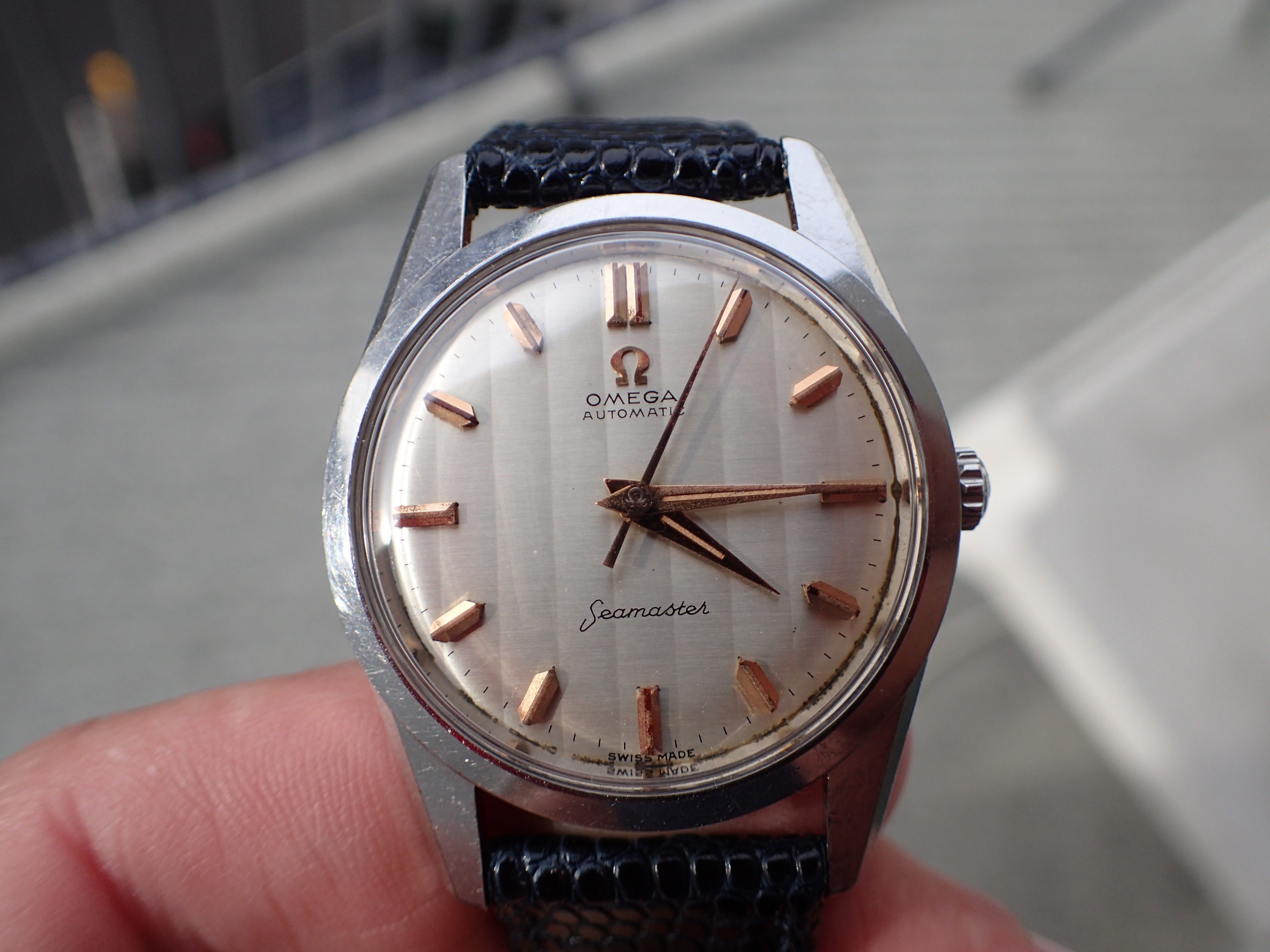

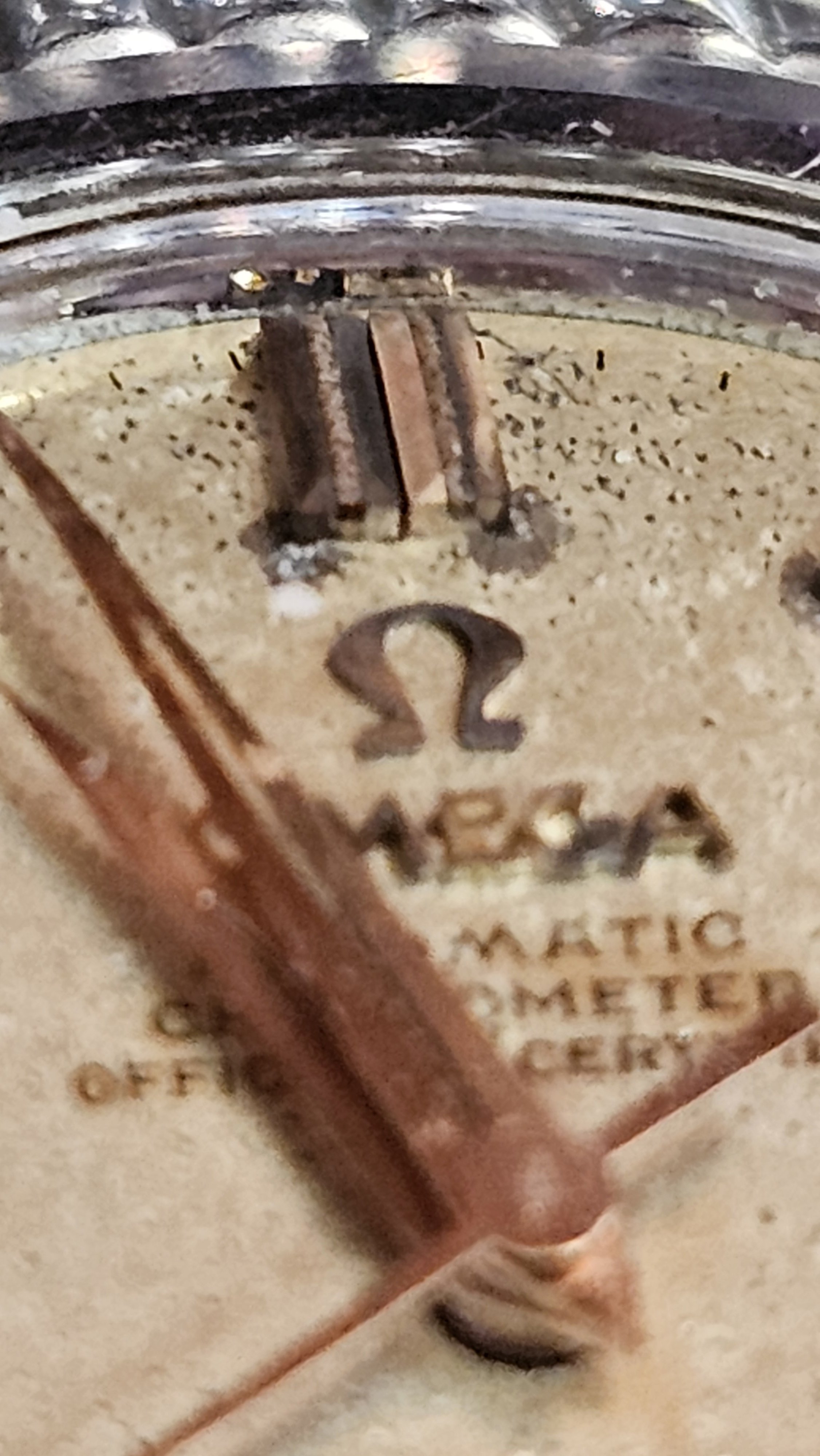

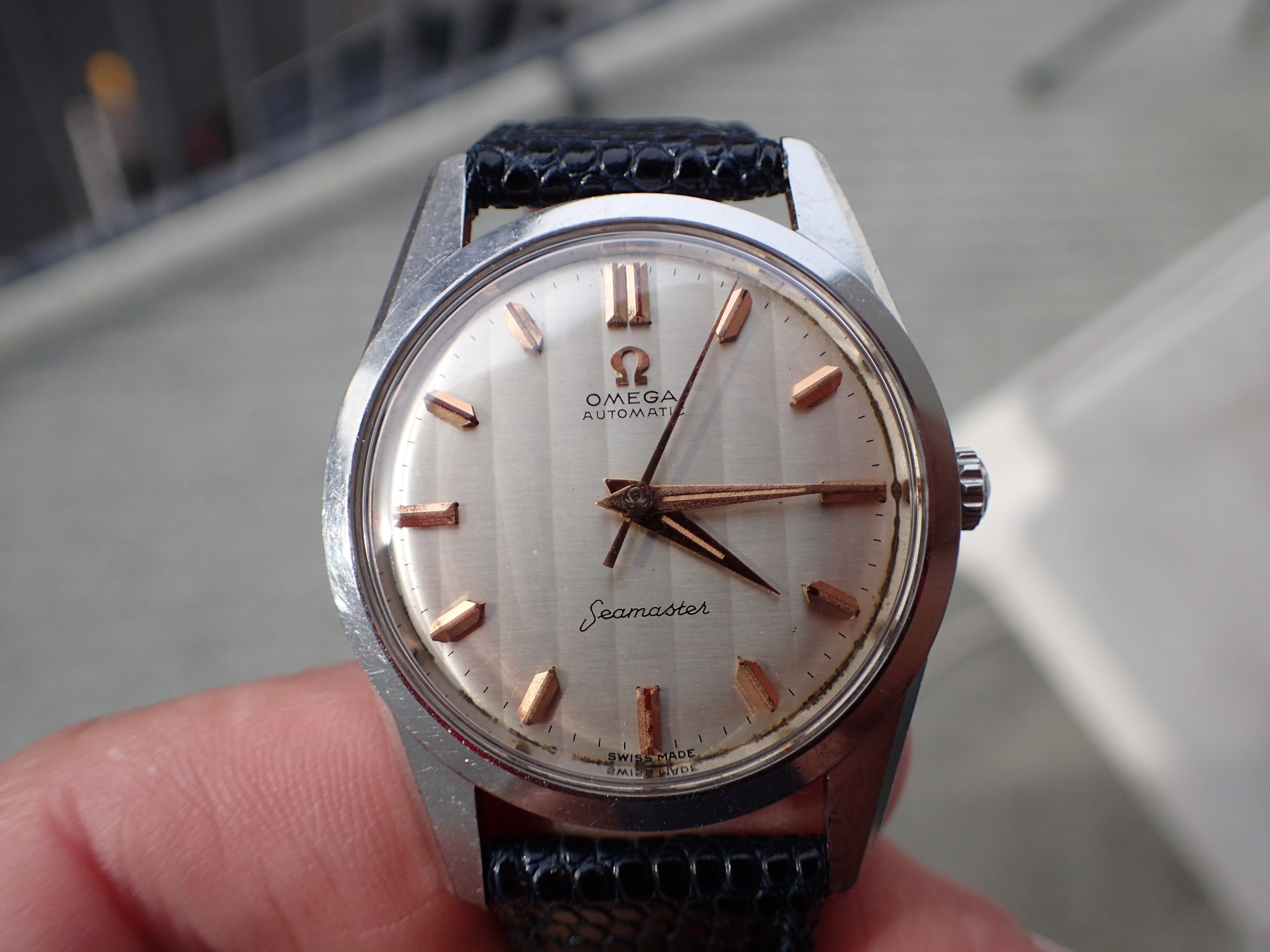

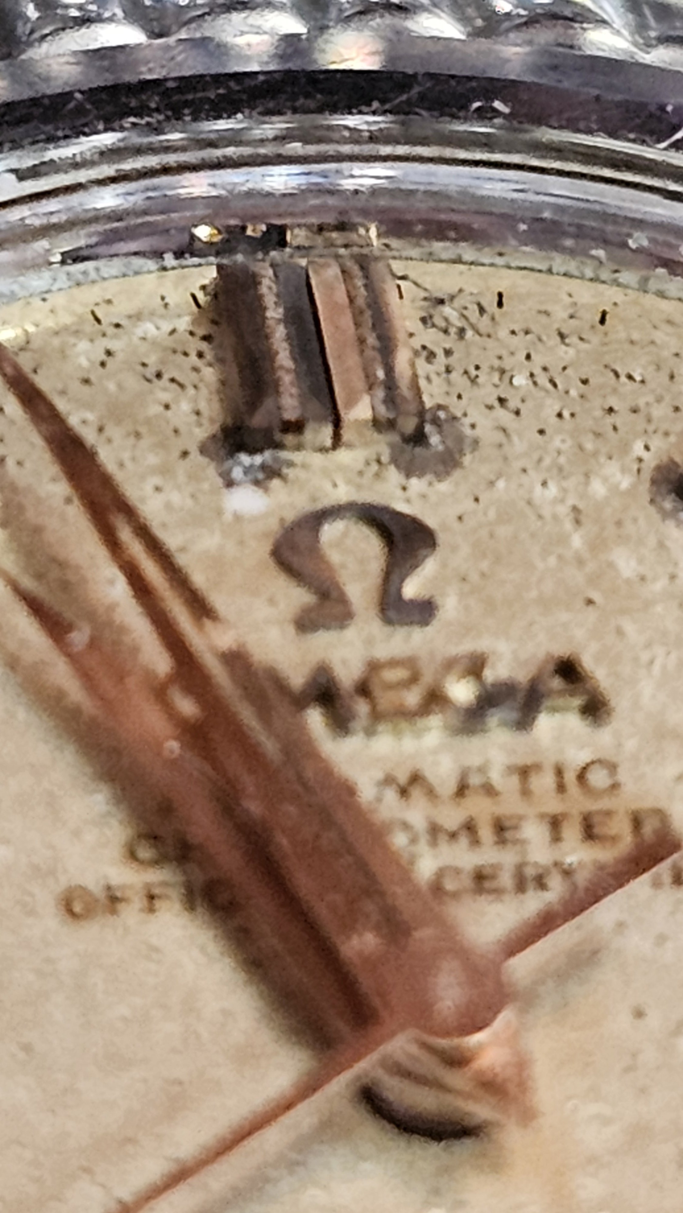

This is a 14700 of mine with indeterminate inlays - of a reddish-brownish hue - which have started to flake away and created a residue at the edge of the dial. The hands have what appears to be radium but it is inert (as are the markers). I don't know if those are onyx inserts on the markers but they look similar to the op's.

Whatever mine are, they are not radium. They do not respond to UV light at all and a Geiger counter registers only background radiation. I have several watches with radium lume. They all register on a Geiger counter.

Omega used radium to fill the markers and on some dials, they deteriorated badly and look ugly.
Then the guy cleaned them off and used a black pigment mixed with glue or something to refill them.
He did not do a good job and now some start to flake off.
Well, the second part is my speculation but I hope it helps you feel better.

I’ve decided that I’m going to just live with it. The watch has a spectacular dial and handset. The defect in the marker is essentially invisible to the naked eye and it doesn’t affect the overall aesthetic of the watch. It’s good enough for me.
