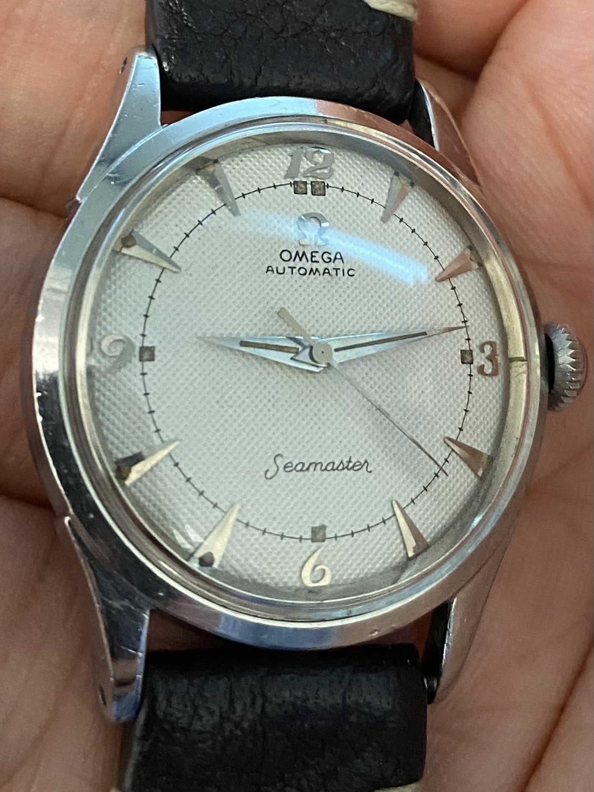

Anyone want to hazard a guess on what the hour markers and numerals are made of on this 1952 Seamaster 2635? White gold? Solid? Plated? Plain old steel? A la Mr. Spock, “Cast Rodinium, the hardest substance known to our science”?

Anodized aluminium would be my guess, same as they use on most Speedy dial's, with out black paint and polished surface of coarse

I believe these would be rhodium plated 18K white gold. But formed over a mold with very little gold.
Not a high stress item.

I have some from a damaged dial. I assumed made of steel and rhodium plated.
no interest in filing one though

Thanks, I’m going with gator’s answer as it’s closest to my own thoughts, but who knows? Whatever they’re made of, they’ve aged quite well.

Hello! Most indexes on solid gold AND gold capped watches are made of gold.
I second, most likely they are white gold. At least I have found that out on 30 Rg chronometres.
When researching for my book I sent a dial to a local University to have tested the alloy and it turned out to be white gold.
Edit: For the analysis a scanning electron microscope was used, the best and probably most sensitive research method for this purpose.
Average contents of metals in the alloy taken from 4 different locations of the indexes:
Au: 70-80%
Ag: 10-20%
Pd: 10-15%
Cu: 0,5%
Thank you.
