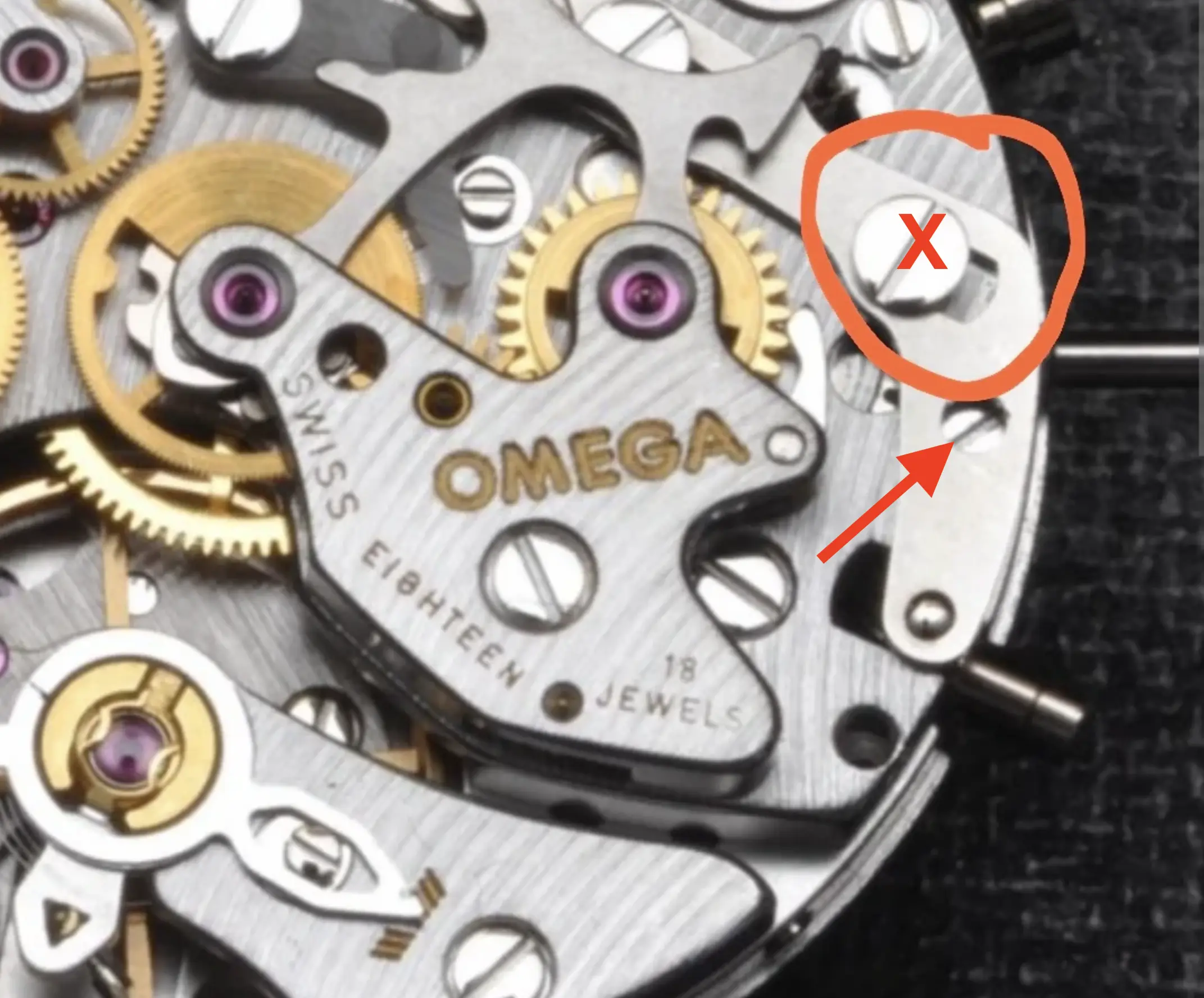

The setting lever screw has likely come loose - this would simply require taking the case back off, the tightening the screw. If the screw has snapped off in the setting lever, it would require a more intense intervention, and possibly the removal of the hands and dial.

You could try it yourself. If the screw has backed out too far already, or in the process of trying to fix this you back it out too far, then for sure more work will be needed.
When you are starting out, I would first screw the screw all the way in, without the stem inserted. Then back it out 1.5 turns, use the screwdriver to push the screw down, then see if the stem goes in all the way. If not, unscrew it just a bit more and try again. Once the stem is all the way in, tighten the screw and see if the stem stays in.

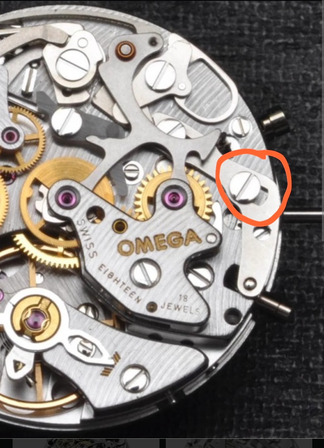

Than you, I will try it. Is this the screw in question?

Thank you gentleman, I manage to solve the issue using @Archer post. Now I got position ZERO (winding) and position 1. But, on the position ZERO, it only winds 3-4 turns and that's it. And the movement has been stationary for weeks, so no power in that mainspring. Did I tighten the screw too much?
