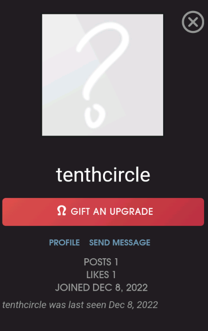

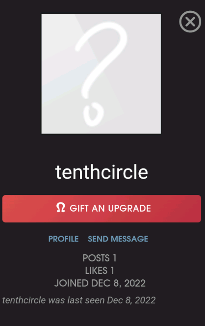

Uhmm, don't think you'll get an answer from a one time poster whom didn't even came back to read the replies.
