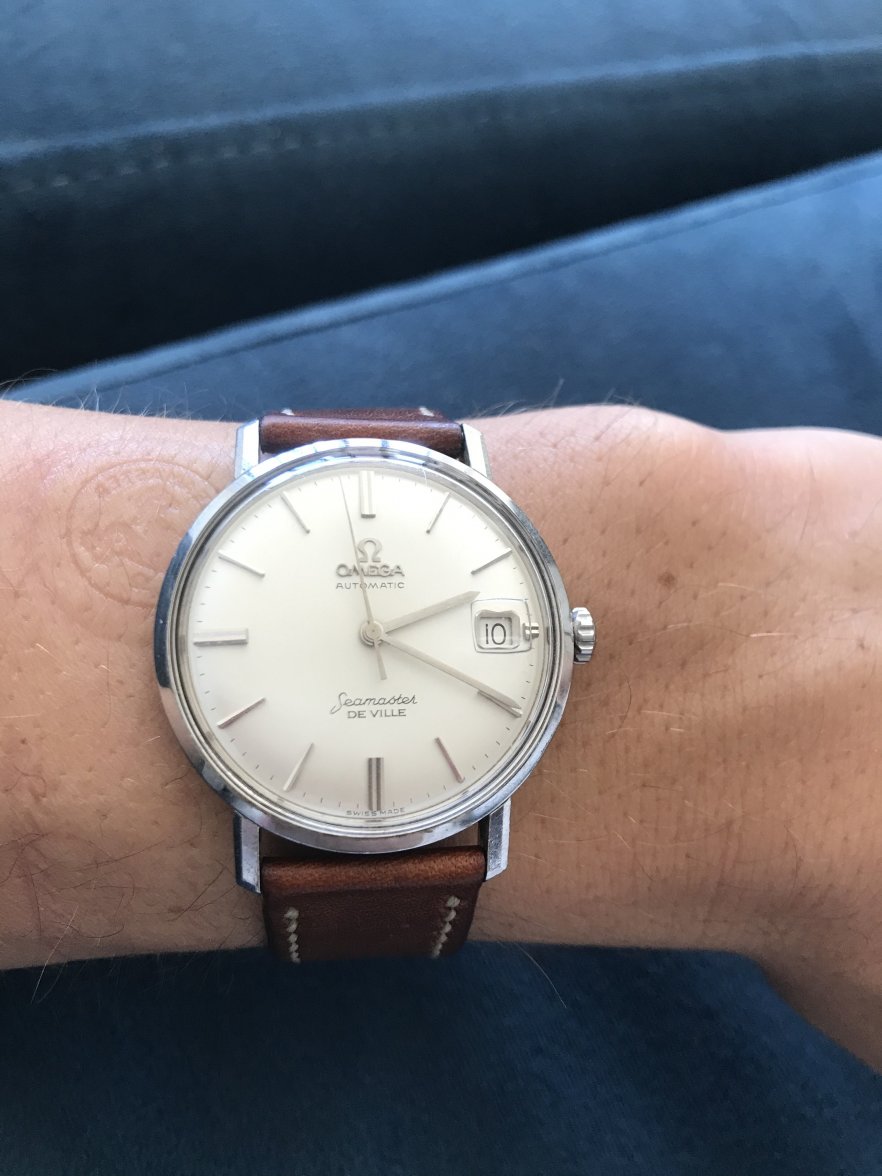

When I go to set the time on my Seamaster De Ville (CK 14910, Cal. 562) the minute hand has a tendency to 'jump' forward by a minute when I push the crown back in. Does anyone have any insight into why this happens? It doesn't necessarily bother me as I've learnt to factor in the 'jump' when setting the time but I'm more interested to hear if it's a common issue and what may be causing it from a mechanical perspective.
Here's the culprit:
