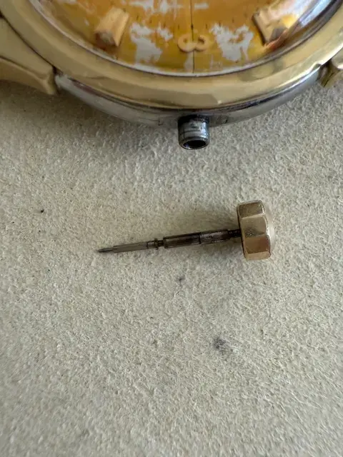

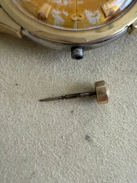

Here's a pic

Stem notch doesn’t appear to be worn

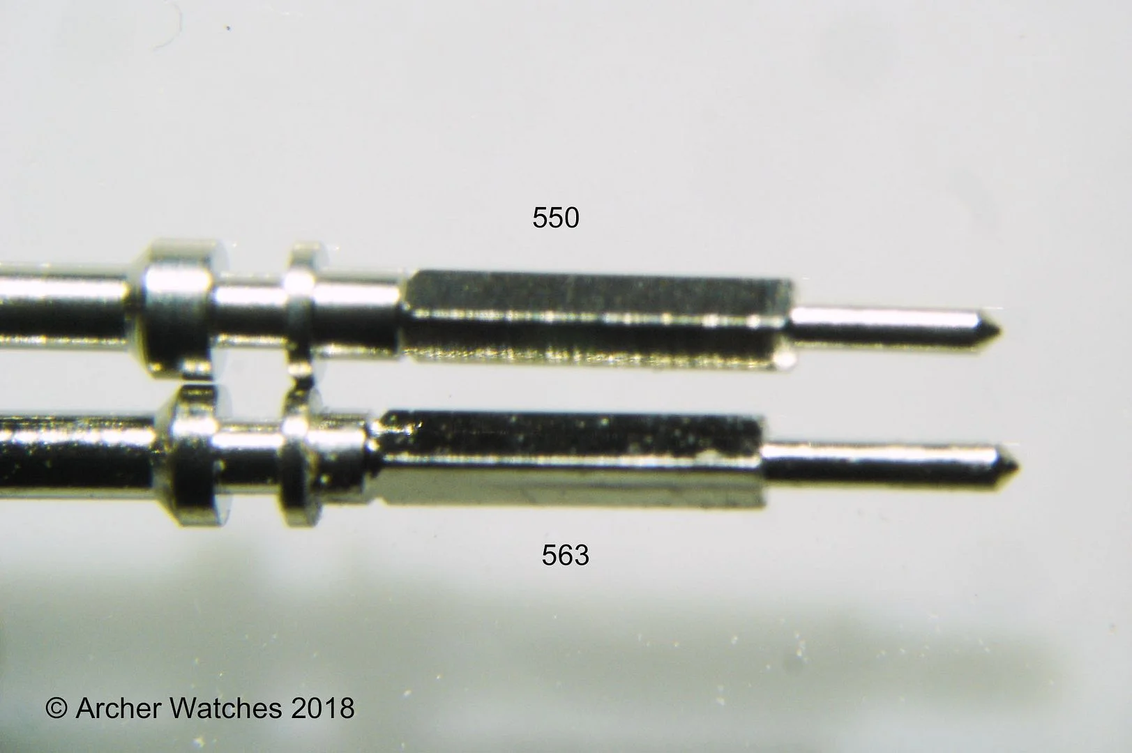

As noted, there is no screw for the setting lever, so nothing needs to be tightened. There are typically 3 spots that cause this - 2 are easy to fix and one is not.
First is the setting lever - the portion that retains the stem can be worn, so may cause the stem to come out too easily. Setting lever is replaced.

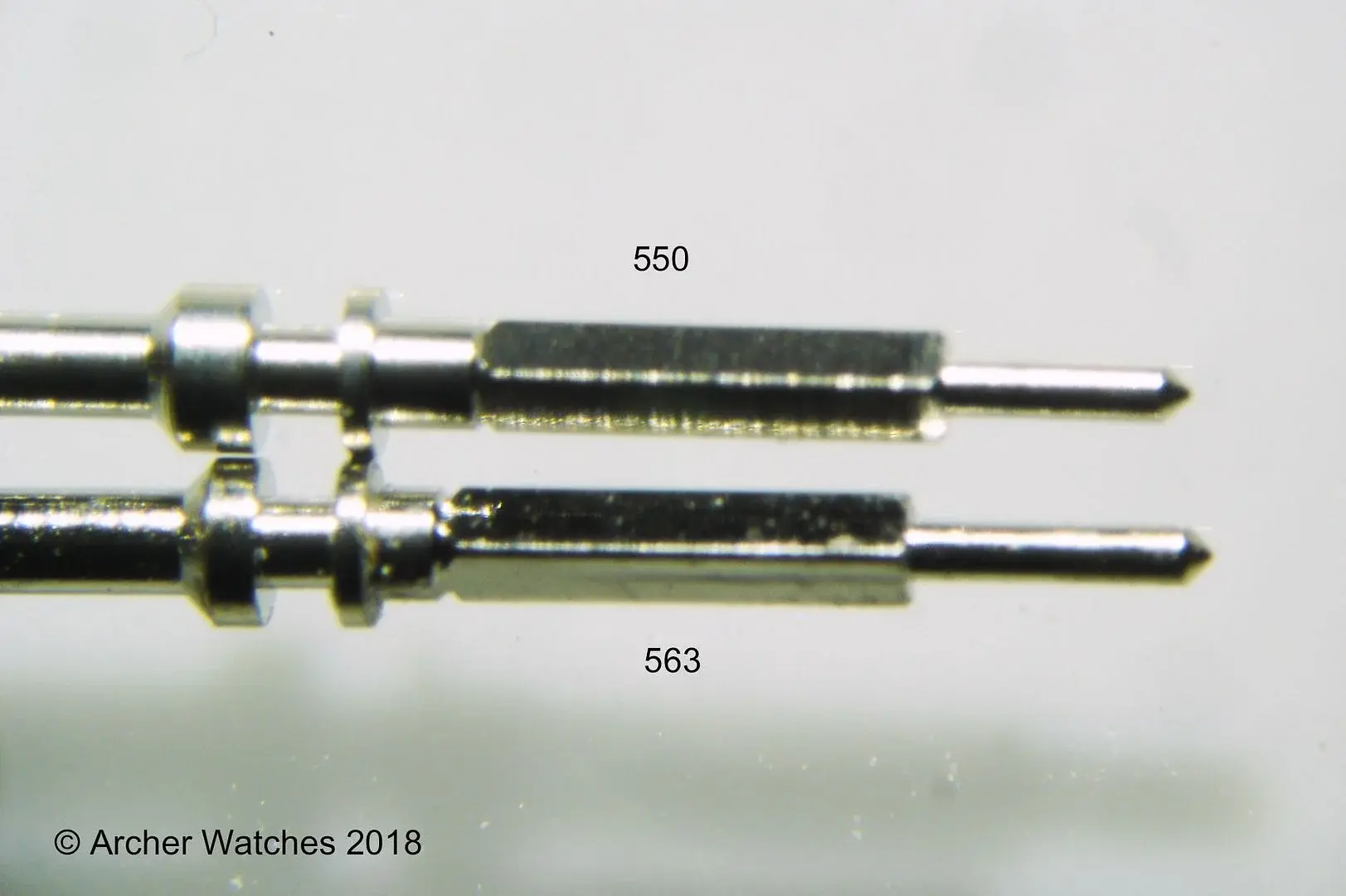

Second is the stem itself - The flange shown on these two stems that is just to the left of the square section, can be damaged and this can allow the stem to be pulled out.
I've seen instances where a part of this flange has been broken off, so if the stem is rotated one way it cannot be rem oved from the movement, but when it has been rotated 180 degrees, the flange is gone and it can be pulled right out. In these cases, the stem is replaced.

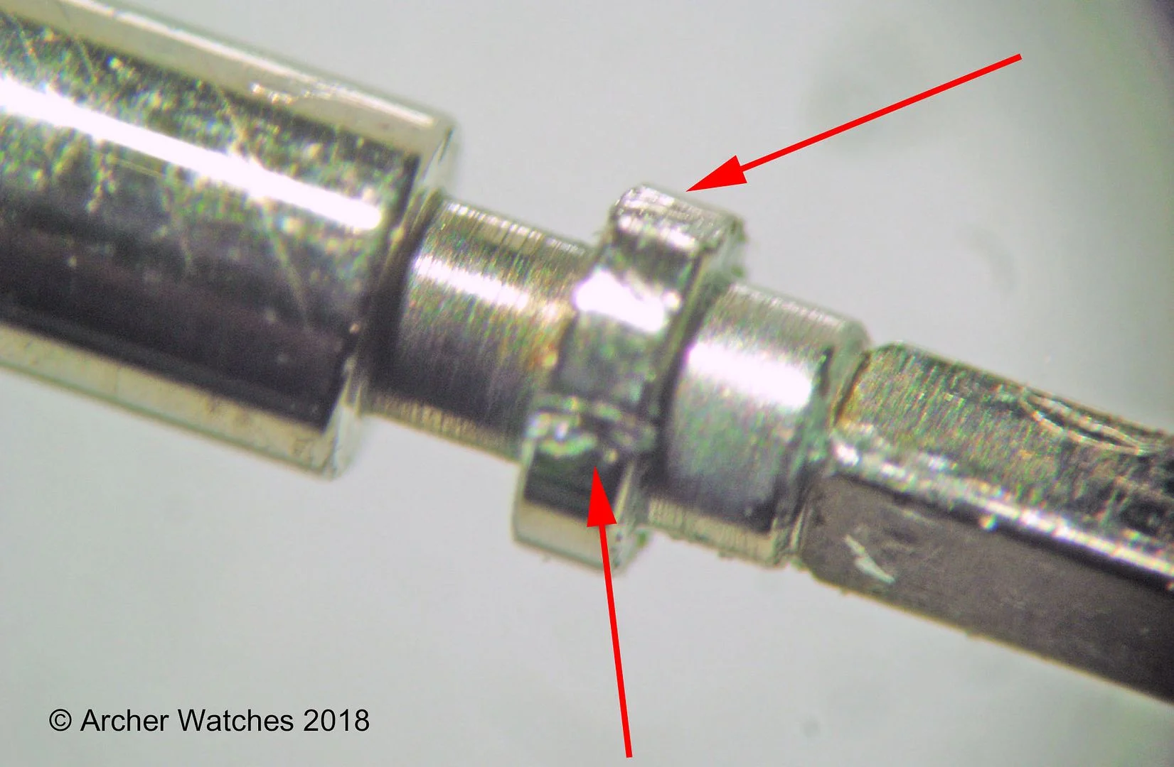

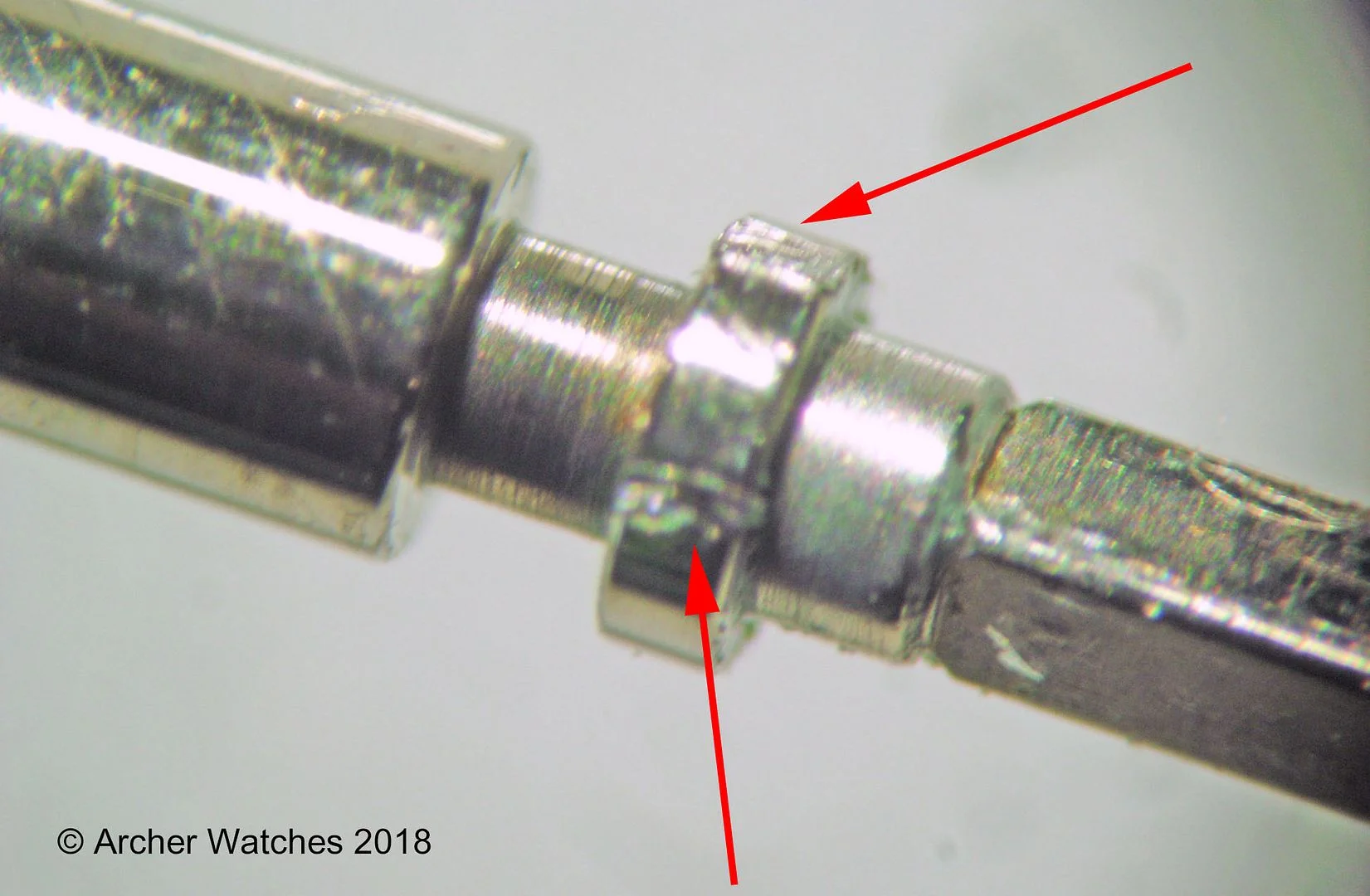

The third one is wear to the movement itself. The stem typically goes into the main plate through a hole, and the clearance in that hole has to be reasonably tight. If the hole has been enlarged over the years, it can lead to the stem having so much play in the hole the it can cause the setting lever to lose contact with the flange. This happens when the stem has burrs on it that can cut into the main plate's soft brass - here's an example of burrs on the stem:
These particular burrs come from someone using a pin vise to clamp down on the stem when changing a crown, but clamping in the wrong location.
This repair is more difficult, and can involve a new main plate, or repair of the plate. In any case it's something that should be able to be repaired.

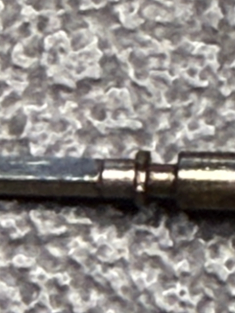

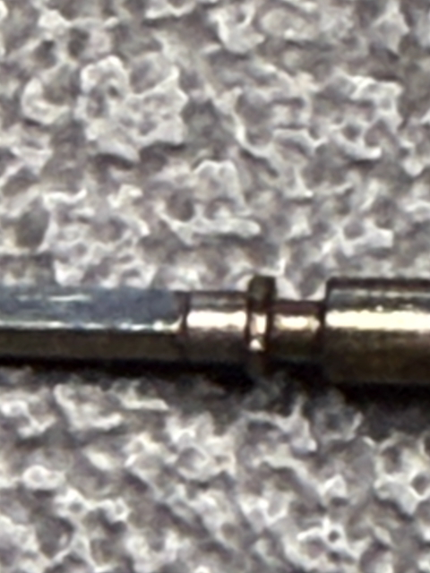

This is incredibly helpful. I examined the stem under my magnifier which isn't very strong but I clearly saw something. I tried to capture it with an iPhone here and I think I can see marks on the flange, although I'm not sure if these would have caused problem 2, or 3. It looks pretty beat up. Getting good photos is difficult on the fly, need to get out the camera stand.

Tough to see much there, but it does look like maybe there is a chunk of the flange missing or it's damaged.

There's at least 2 marks like that, and I think it was a vise of some sort like you suggested.

Time for a new stem me thinks. It looks kind of beat up. If that doesn’t solve the issue it’s only a few dollars. They aren’t expensive at all.
I’d change it and see.
