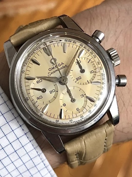

Hi esteemed collectors,
Does anybody know which bracelet works on the Seamaster 321 chronograph CK14360 or 2907?
I've heard that the BoR pairs well, but it seems like there's a couple different versions.
What about the "oyster" style flat-link (a la 1039) bracelets?
Which endlinks (14360 uses 18mm)?
Any help is greatly appreciated!

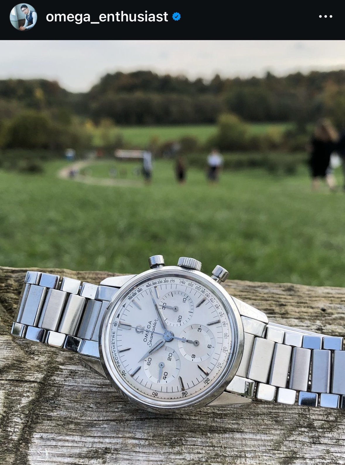

(sample picture of the reference attached, courtesy of Omega Enthusiast)

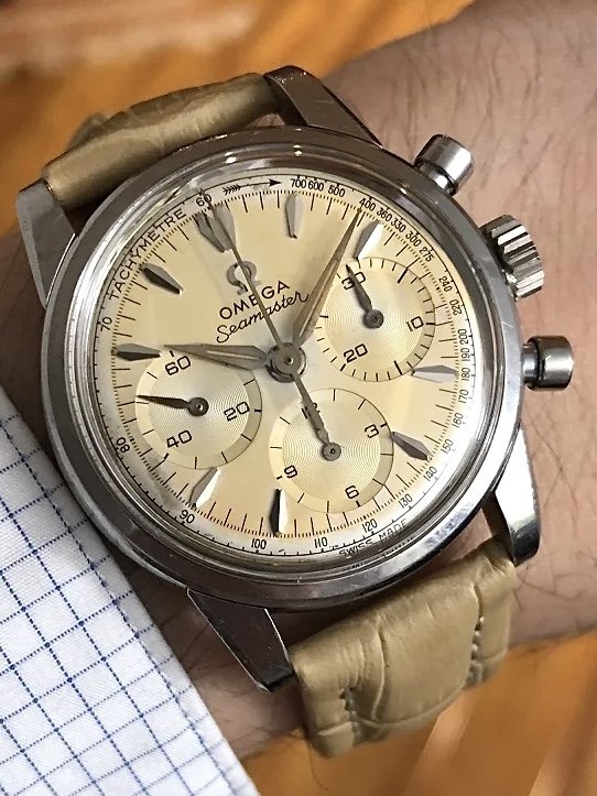

I don’t think these came with bracelets as a standard option, instead coming on leather.
A 5 row beads of rice such as the 1502 would be the obvious choice but you may have to do some trial and error on the Endlinks. Perhaps No.11’s?

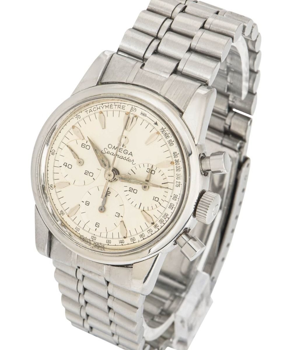

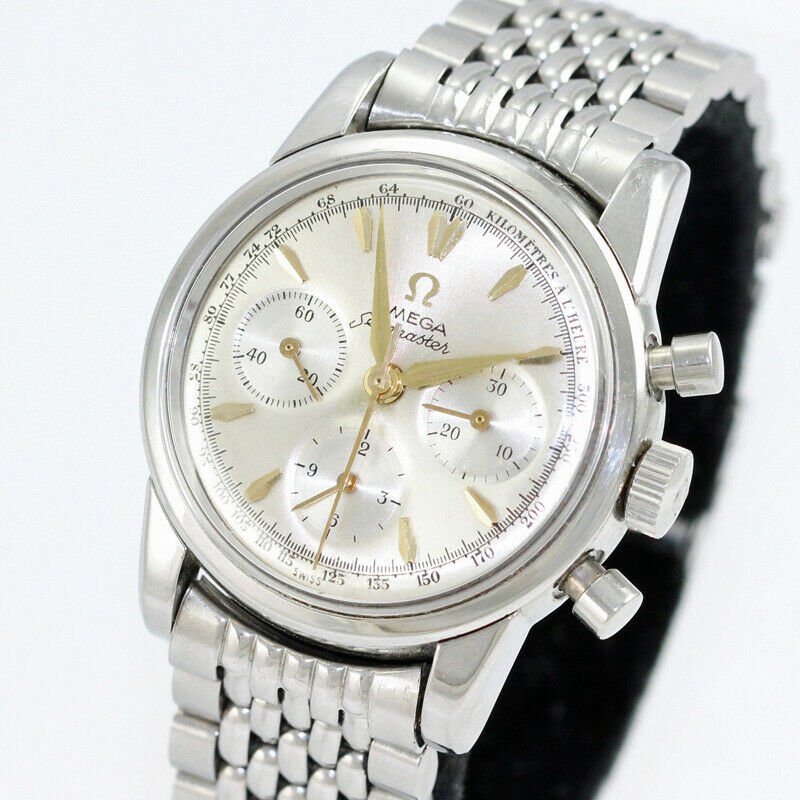

Personally I'm not a fan of a BoR for that watch, but that's just me. This looks better in my eye. It's very similar to a 1118 with 582 endlinks, but probably someone else can better identify it.

Yes I’m also looking for something other than the standard 5 row BoR. That’s not a bad option, although it doesn’t look too cohesive, is that period correct?

If the one in the photo is actually a 1118, then I believe it's from the late 60s. So not really period correct.
I wouldn't worry too much if the watch was never sold with a bracelet, as nothing will be cohesive. I'd get something that looks good on it.

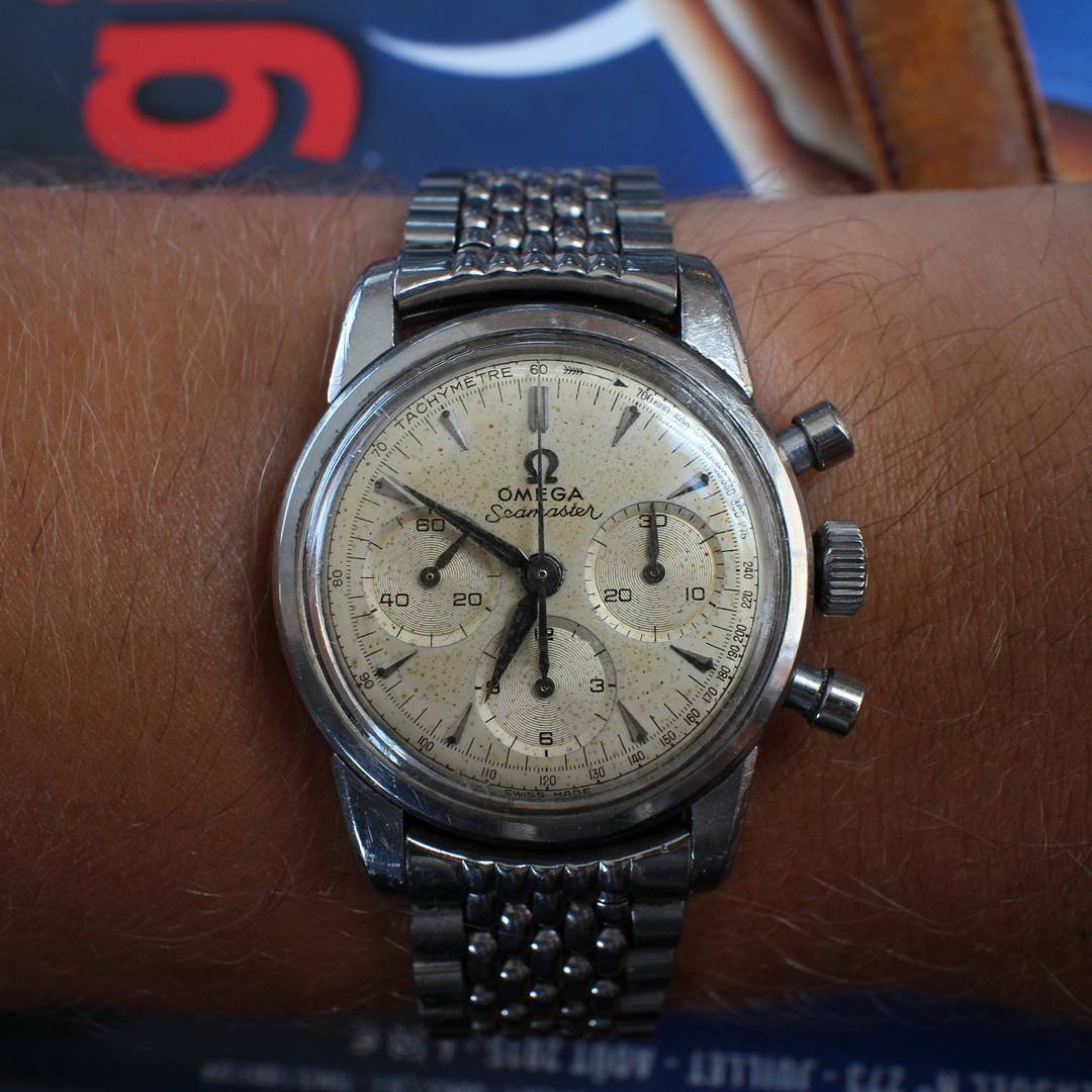

Three years ago, OF helped me out on a similar question for a 1958 Seamaster chronograph ref CK 2907/2.
I was told the modern version is 3010/511, and that a 1506/724 would also work. Key thing was to look for 511 or 11 end links.
It took a lot of looking to find a used BOR with 11 end links. Ultimately, the bracelet I found listed here on OF with 11 end links might have been modified - the clasp is stamped 1036. But it was the end links that were most important; the lug width on my watch is old school, so just under 18mm.
In any event, the bracelet works very well. Very comfortable, and to my eyes suits the watch. It’s a five row BOR.
Hope this helps. Good luck.

I'm really surprised to not see any pictures of this. I think this reference would look great on a flat link bracelet, just like the 50's Constellations do.

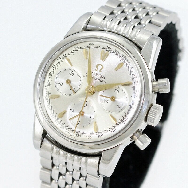

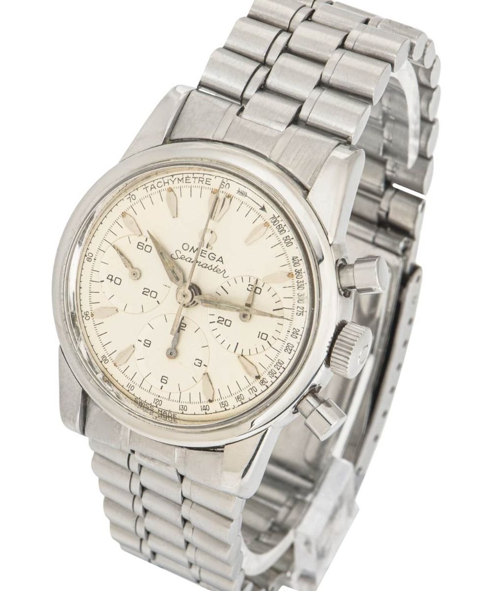

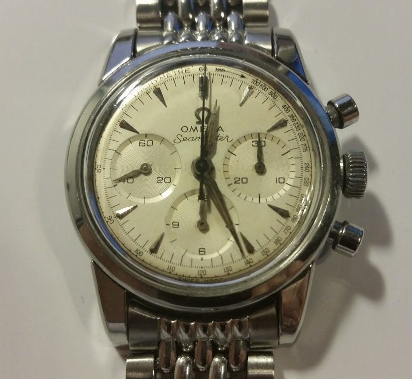

In regards to 1506, you mean something like this? (Courtesy of OmegaEnthusiast again; though this is a 14364 as an example):
40
12
The flat links really works on an angular lug reference like the 14364 or the 2884. Wonder how it will look like with the rounded beefy lugs like a 14360…

Thanks for posting the picture of the 1506; very nice. Just a matter of personal preference between that and a BOR, I suppose.
I have to say they both look really good to me.
