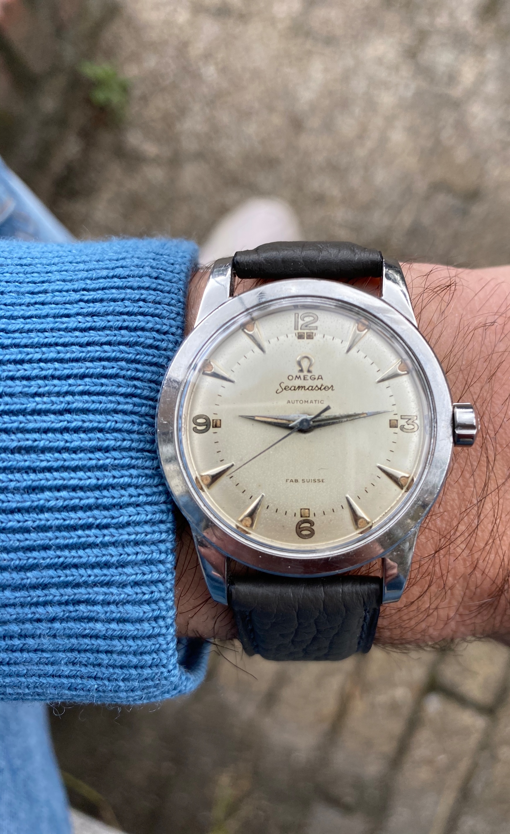

Hi all,
I am on the lookout for a beads of rice bracelet for my Seamaster 2577-2.
Lug width = 18mm.
Did some research, but so far it's not clear to me which BoR bracelets / end links will fit.
Ref. 1036?
Ref. 1502?
So any help is welcome!
Thanks,
MJK

First, congrats for this very nice watch 👍
I guess that you want a 5 row to match those beefy lugs. A RG 1036, 1038 or 8220, with endlinks #11, 12 or 512 would certainly wears well on this ref 2577. OF have some experts about BoR bracelets, guess they're on their way 😗

Nice looking watch that. You are maybe already aware that the BOR is later than the 2577 and wouldn't have been seen in period, but it is still a good addition. As well to those mentioned above, 14 links would likely fit too, they look pretty much identical to no 12s to me. I use a 1036 on my later 2846 which has the same case form factor.

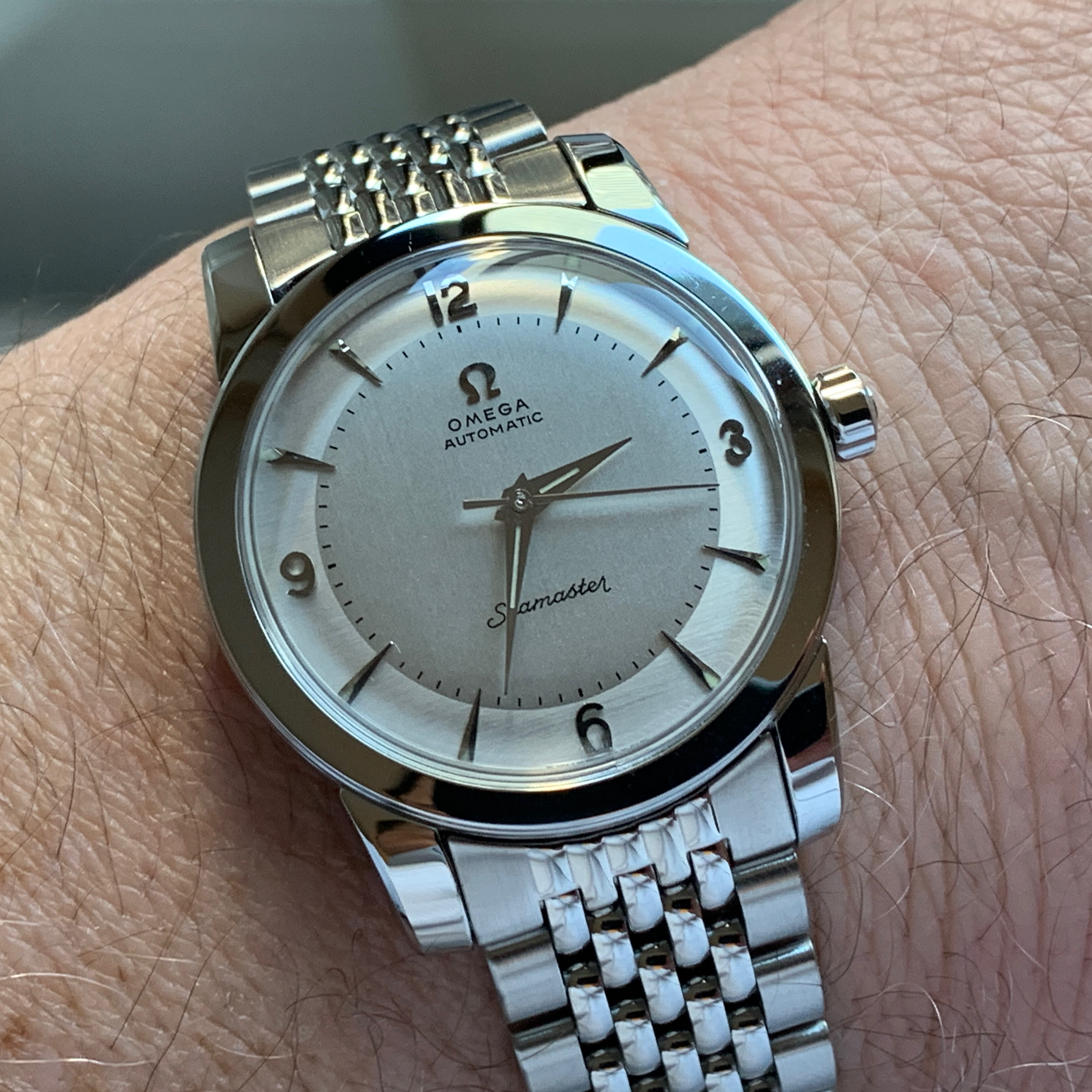

1955 Omega Seamster 2767 with a new Omega-sourced 3010/511 Beads of Rice bracelet. The 511 end links are serviceable but not a perfect fit.
3,595
13,551
Hardly surprising, given that the BoRs were never intended for this reference. 2577s were introduced long before the bracelet. Yours is a later example with the beefier lugs, which works a bit better with the #11/#511s I found. The earlier 2577s are harder to fit.
