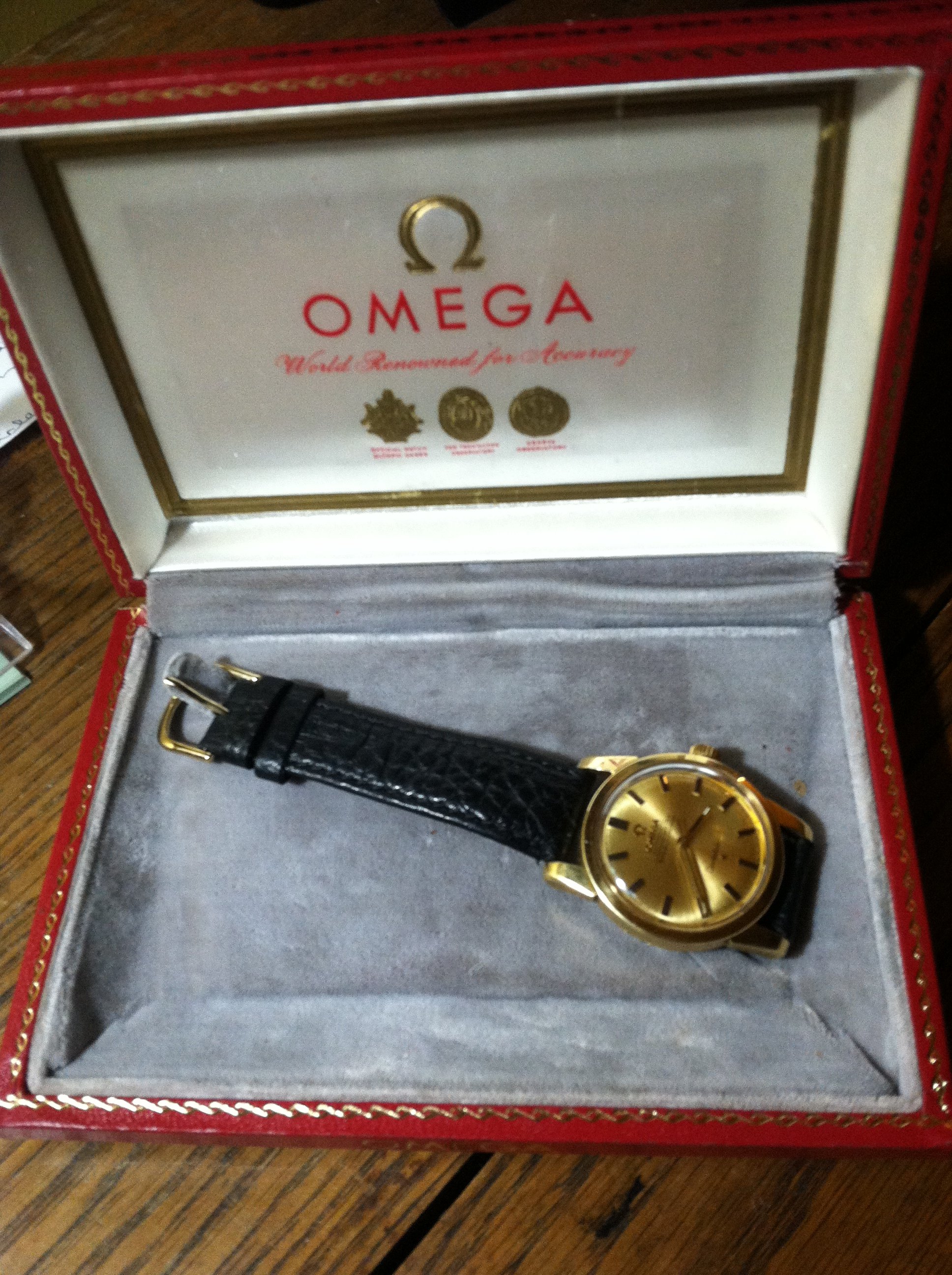

    Greetings,
    As part of a bundle package I recently purchased a 1958 Seamaster Chronometer (505 movement) in an 18k gold case. Great watch - it just has the wrong (very wrong) dial.
    Some time at least four years before I bought it (and two owners ago) the dial was replaced with a Constellation replacement from the 1970s.
    I am having a difficult time sourcing the proper Chronometer dial (preferably from within the U.S.) I would even consider a comparable Seamaster period dial so it was not such a bad marriage (botch job)
    I am attaching an image from an earlier thread of what I am seeking. And another of what it looks like now (just cant live with it this way)
    Anyone have one or point me in the right direction?
    Thank you in advance for your assistance.

  7. gatorcpa ΩF InvestiGator Staff Member Jan 26, 2017
    12,203
    15,717
    [​IMG]
    If that is your watch on the left, I've seen that style of dial before. I believe Watchco in Australia and other OEM suppliers carried these.
    What I think it is, is a modern Omega replacement dial for a Constellation, made in the 1990's or early 2000's. Certainly not correct for the watch, but not an ugly redial either.
    It would have the dial feet in the correct places for a cal. 501/505 movement.
    Hope this helps,
    gatorcpa
    Bottomdrawer likes this.

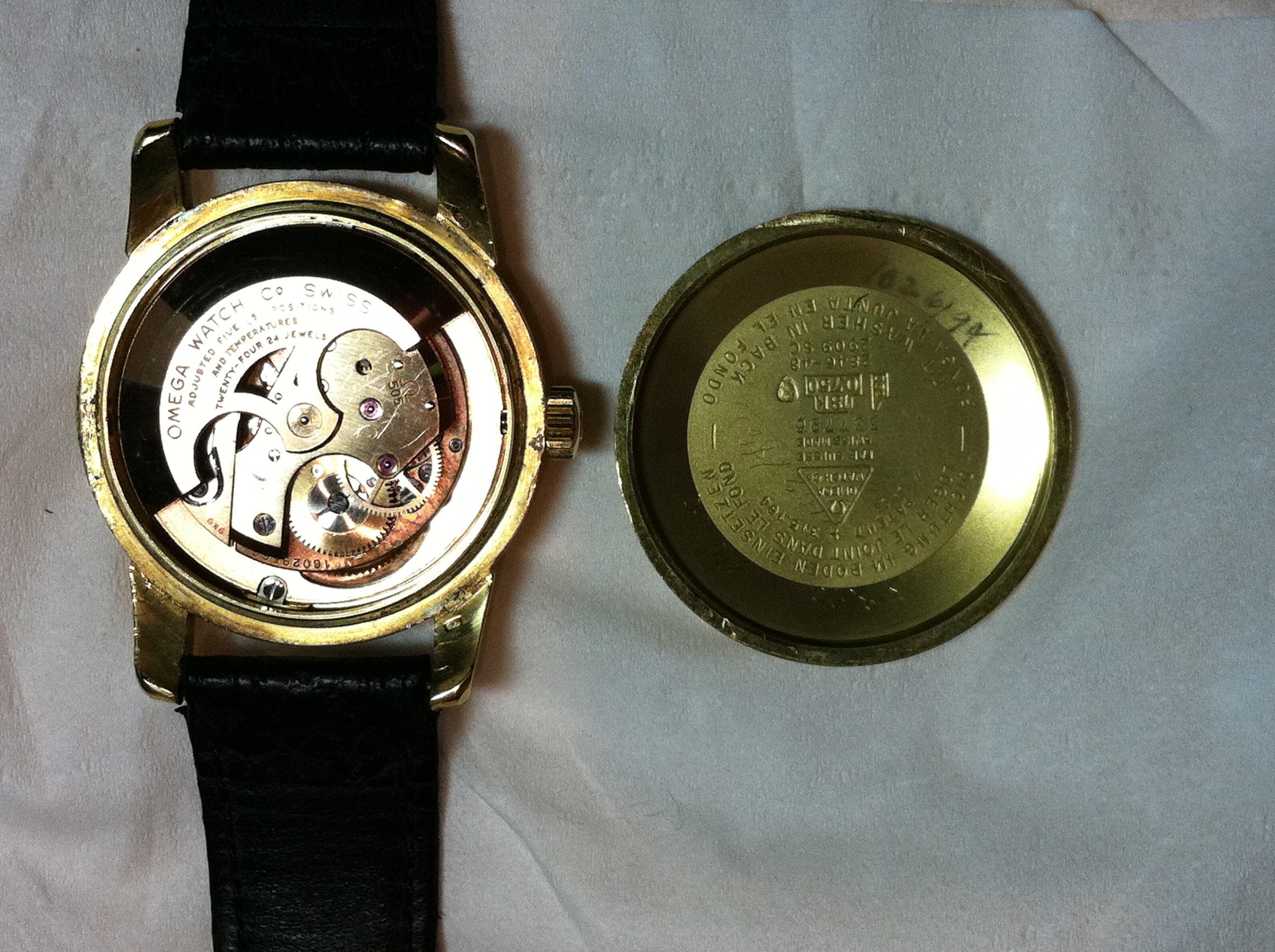

  8. Bottomdrawer Jan 26, 2017
    6
    7
    Don, I haven't completely disassembled it yet-so I don't know how it is attached. I think it was an older dial obtained in the 1970s.There was an old thread on this watch back in 2013 and someone said that there was a small hoard of these old stock dials available back IN the 1970s from Australia (?) - so I misspoke it was not a 1970s dial. Here is a photo of the case back.
