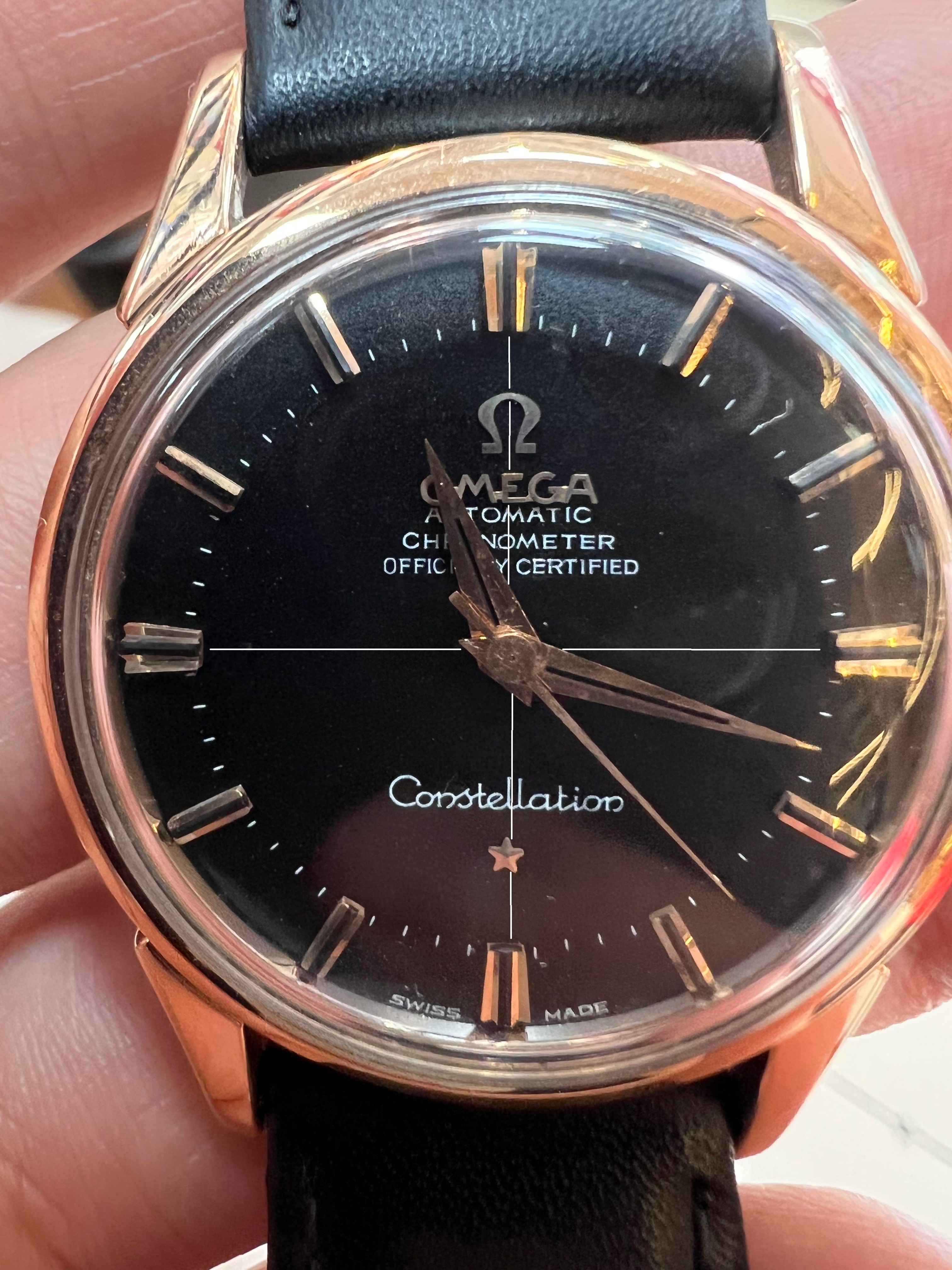

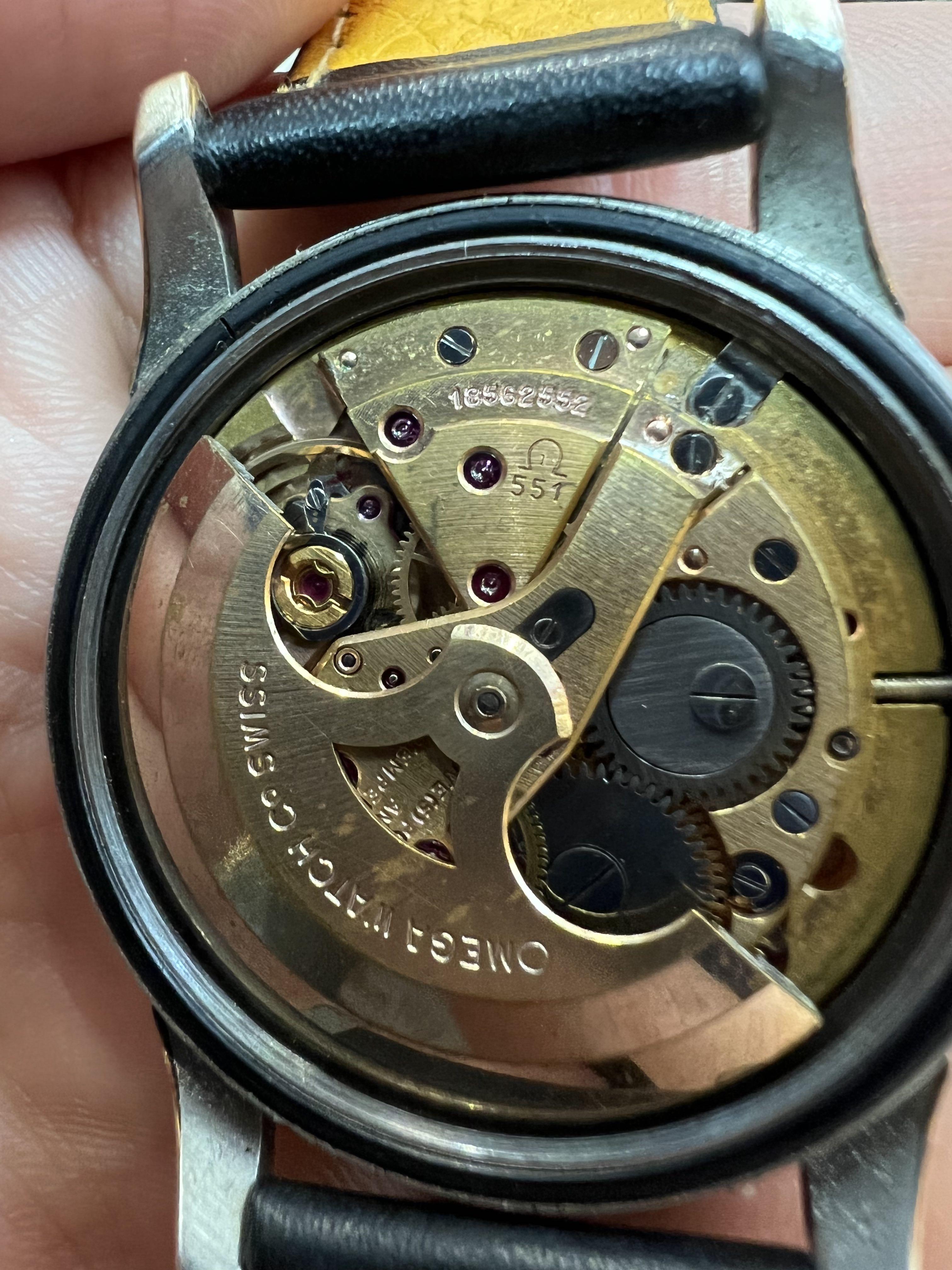

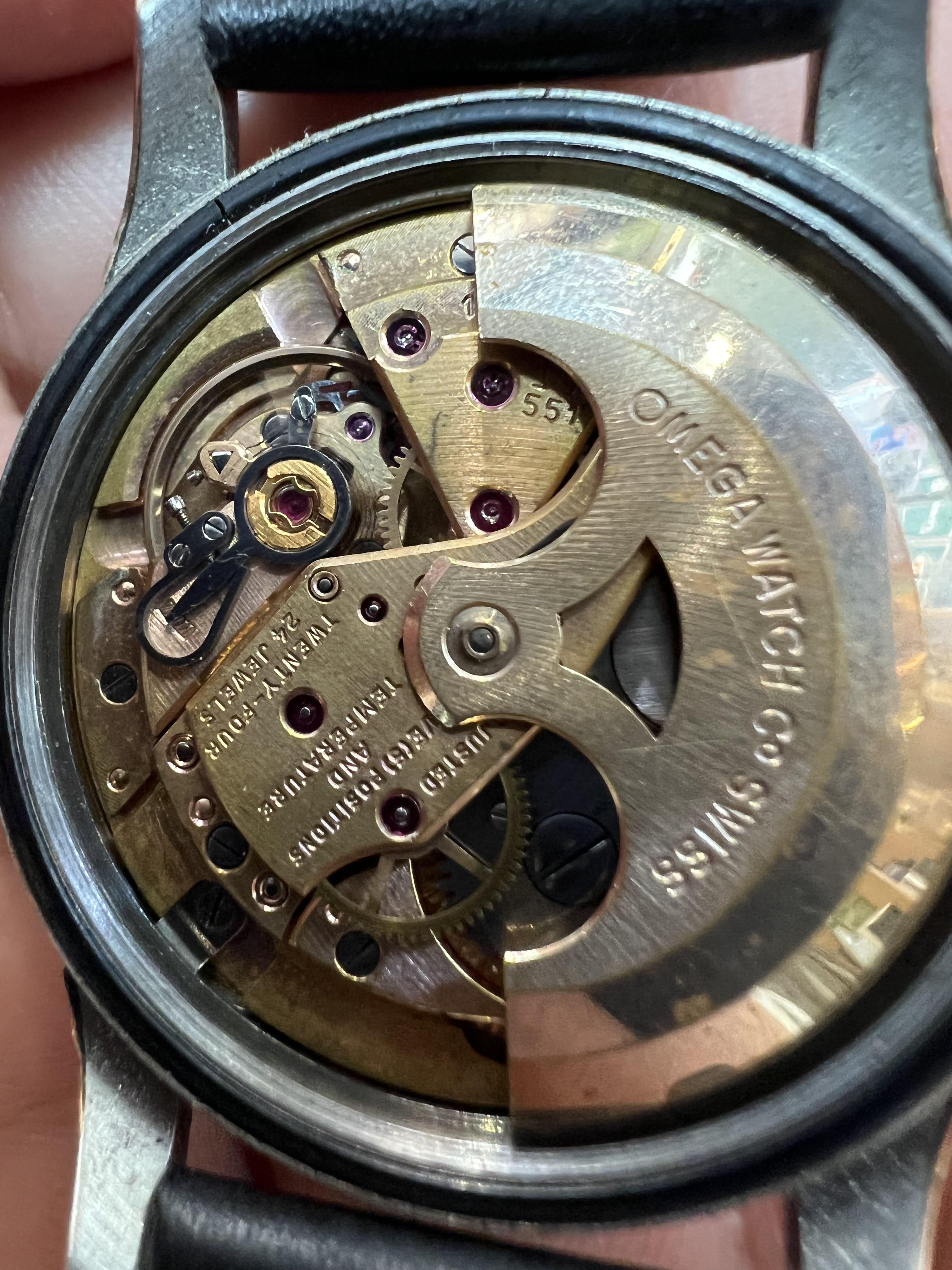

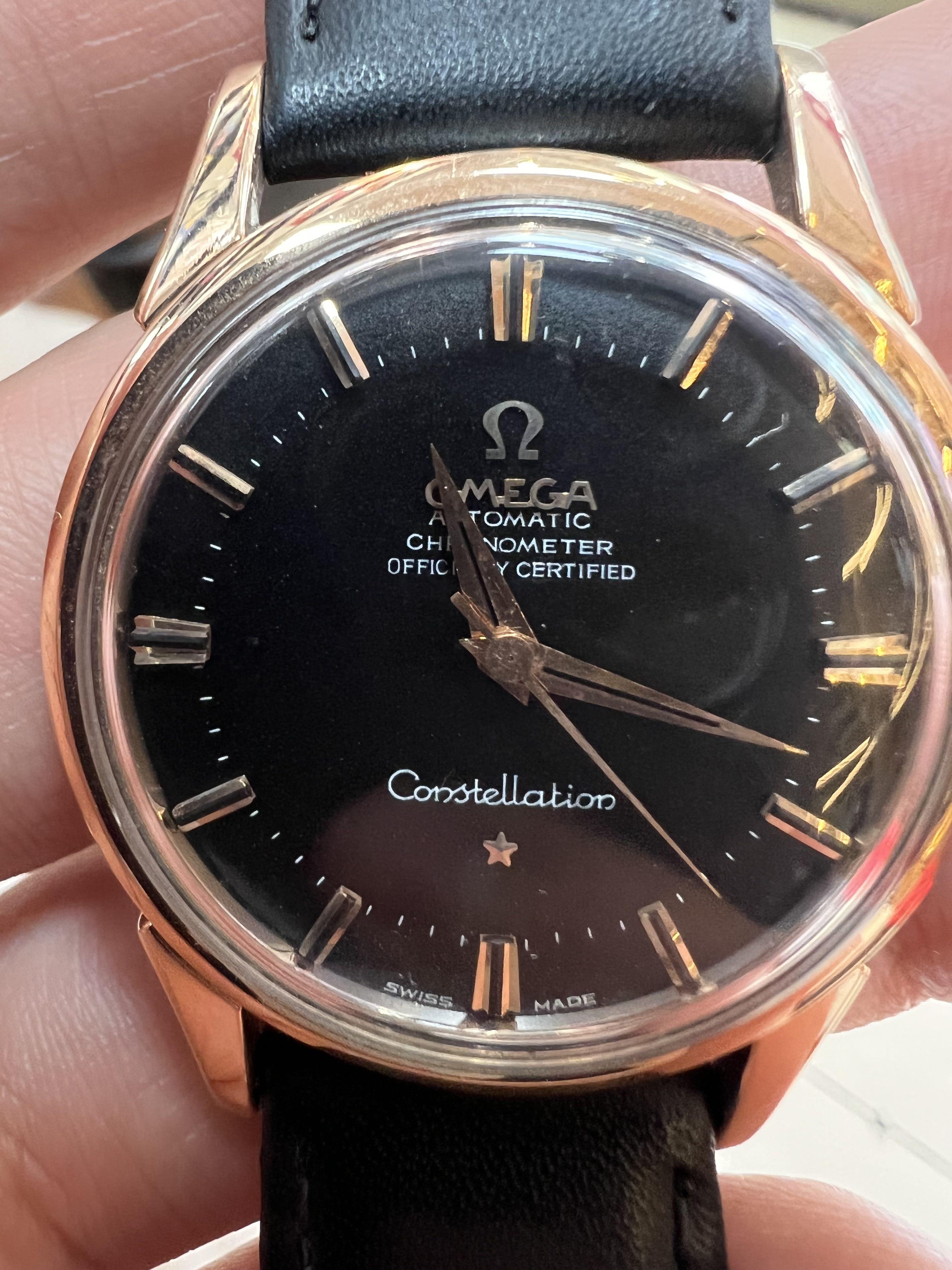

Hi guys,
need some legit check on this gold top no date pie pan black dial.
all looking good to my eyes, let me know what you think.
thanks in advance

I think it’s a redial.
Isnt? Whats give? Yeah i also never seen a white text on gold top connie before, what do you think? Thanks for the advice man

If it bothers you to have a redialed watch don’t buy it! Font as well as font size and placement are definitely wrong

Ah i see thanks man yeah just thinking should i jump the gun on this one, but yeah black pie pan is rare for a reason right

Heavily polished, the edges/chamfers are just gone. The dial - which is not a pie-pan dial, by the way, but a regular dome dial - was badly reprinted without any of the features that you would characteristically find when looking closely on a factory-spec Constellation, and the movement is about as tired looking as it could be.
This watch is the definition of a turd to me...

Thanks for the advice bro! Cant believed i missed that!

If you cannot determine that AUTOMATIC is jammed up too close to the logo, I'd have your eyes checked.
or get a better and larger monitor.

LOL yeah i know right! on my way to got my eyes checked out! thanks man 😉
