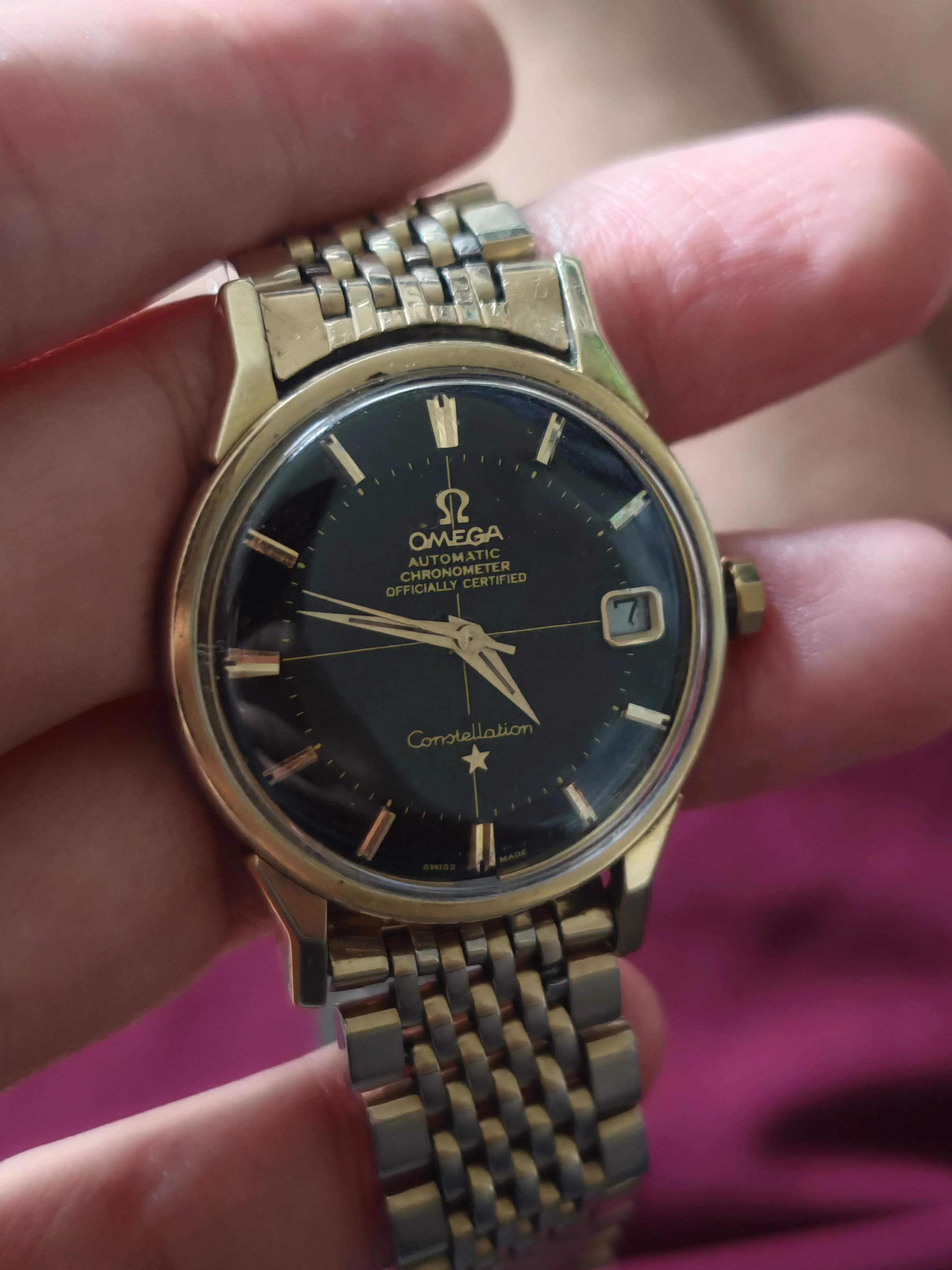

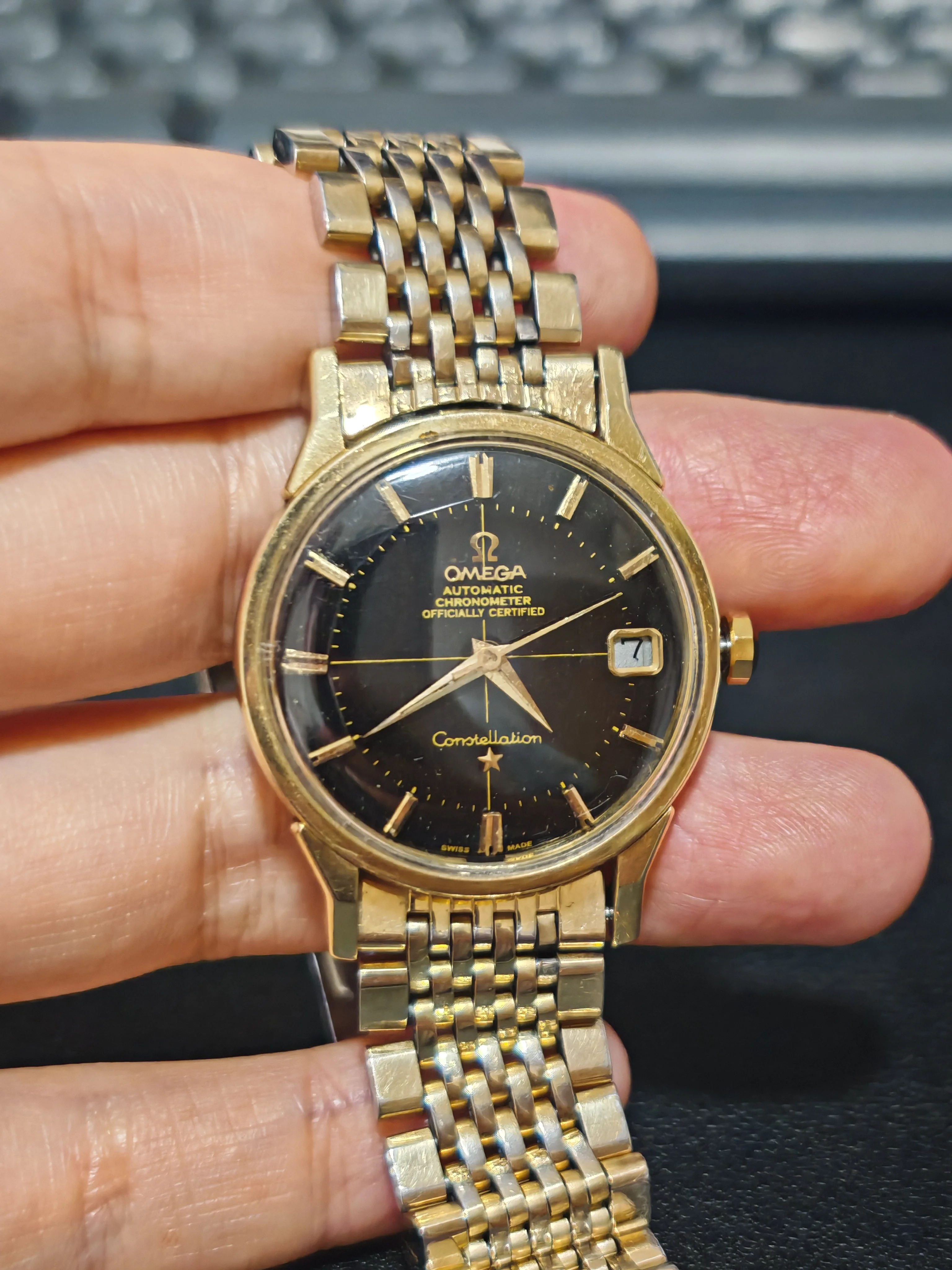

Hi Omega enthusiasts,
I recently came across a pie pan Constellation ref 168.005. On first glance, the watch looks aged which is consistent with a 60 year old watch, but the letter "A" in "OMEGA" looks extremely misaligned. Is it likely that this a refinished dial? Are there any signs that point towards a cheap knock off?
Thanks in advance!

The A of the applied Logo is bend. This happens when someone removed the Logo and indizies without caution to reprint the dial.
The Gold layer on the Steel is also wearing of. I would keep my Hands away from this one. There is a good and well priced example in the private Sell area.

Note how misaligned the star is, as well.
I definitely agree with @Endshake that it would be best to stay away from this example.

Everything wrong with the lettering on this dial.
But don’t need to look past the broken crosshairs which never appear on a Constellation.
Poor redial.
