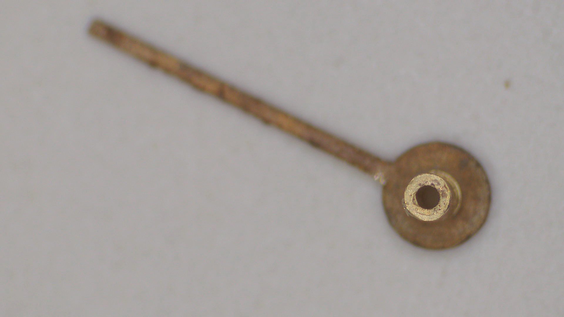

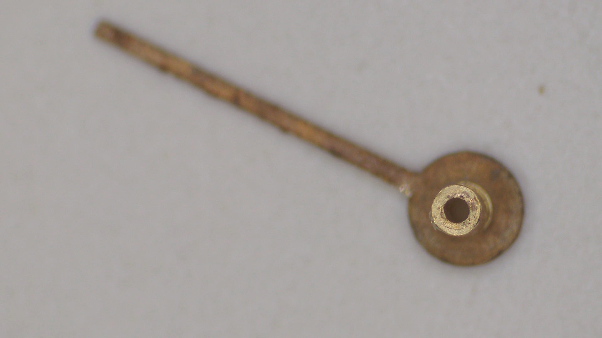

I have a seconds hands from a Landeron 51 that seems to be a bit loose.
When I took it off I noticed some "goop" on it, so it may have been "adhered" by something.
Best way to tighten it?

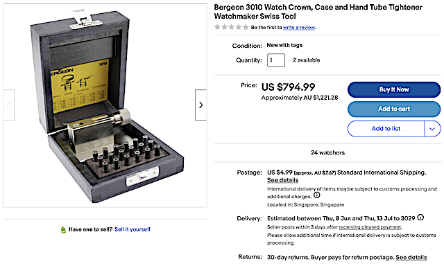

If you don鈥檛 have (or want to buy) a Bergeron hand tightening tool, I鈥檇 say the lathe is the next best option. The actual hand tightening tool will compress the pipe all the way around. The lathe collet will crimp it in 3 places in the shape of the collet. It will do a perfectly acceptable job.
18,834
39,163
I had a look at the Bergeon 3010 馃槻

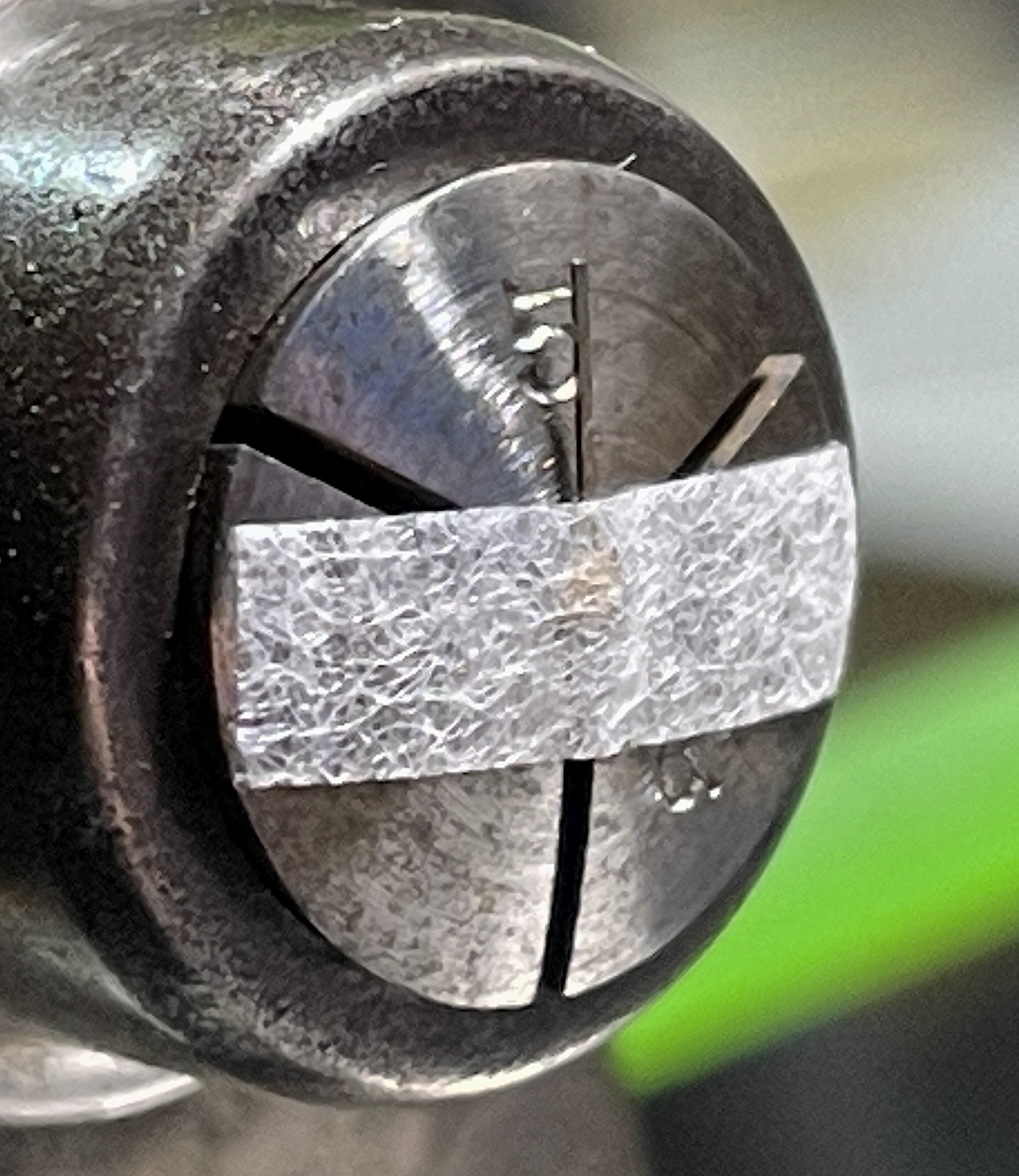

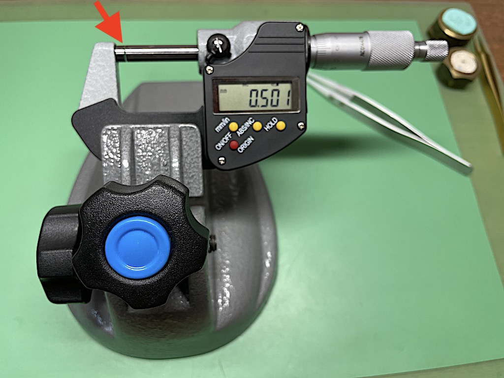

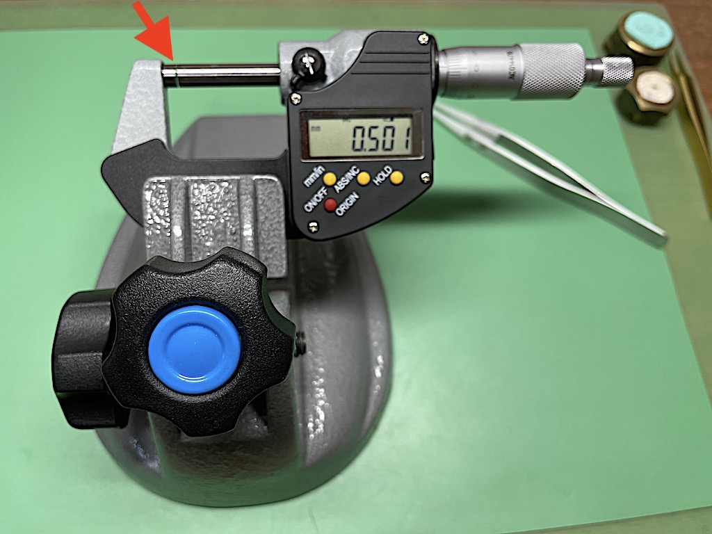

So to find a collet. First, measure up.

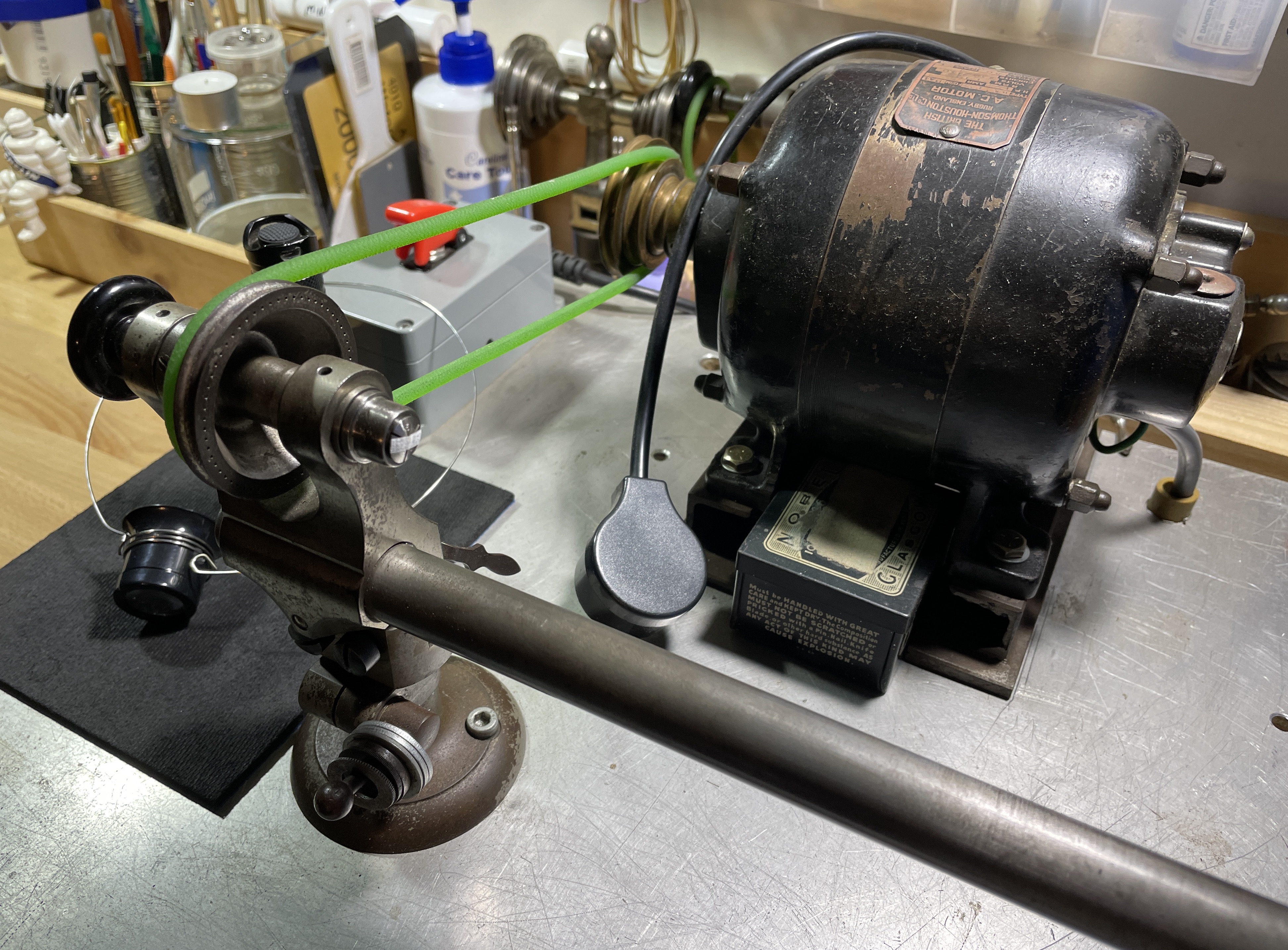

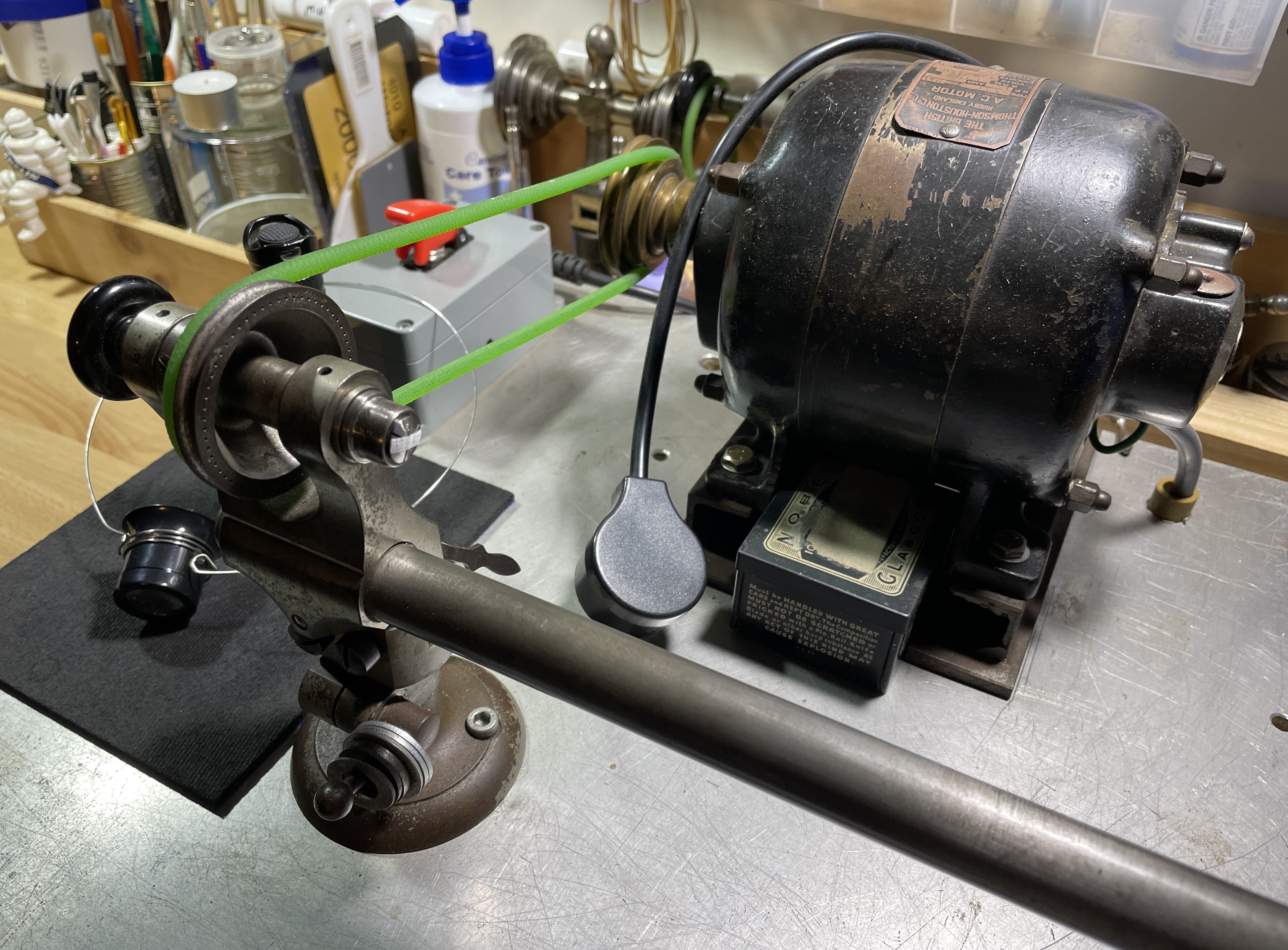

Then off to the garage to set it up on my lathe.

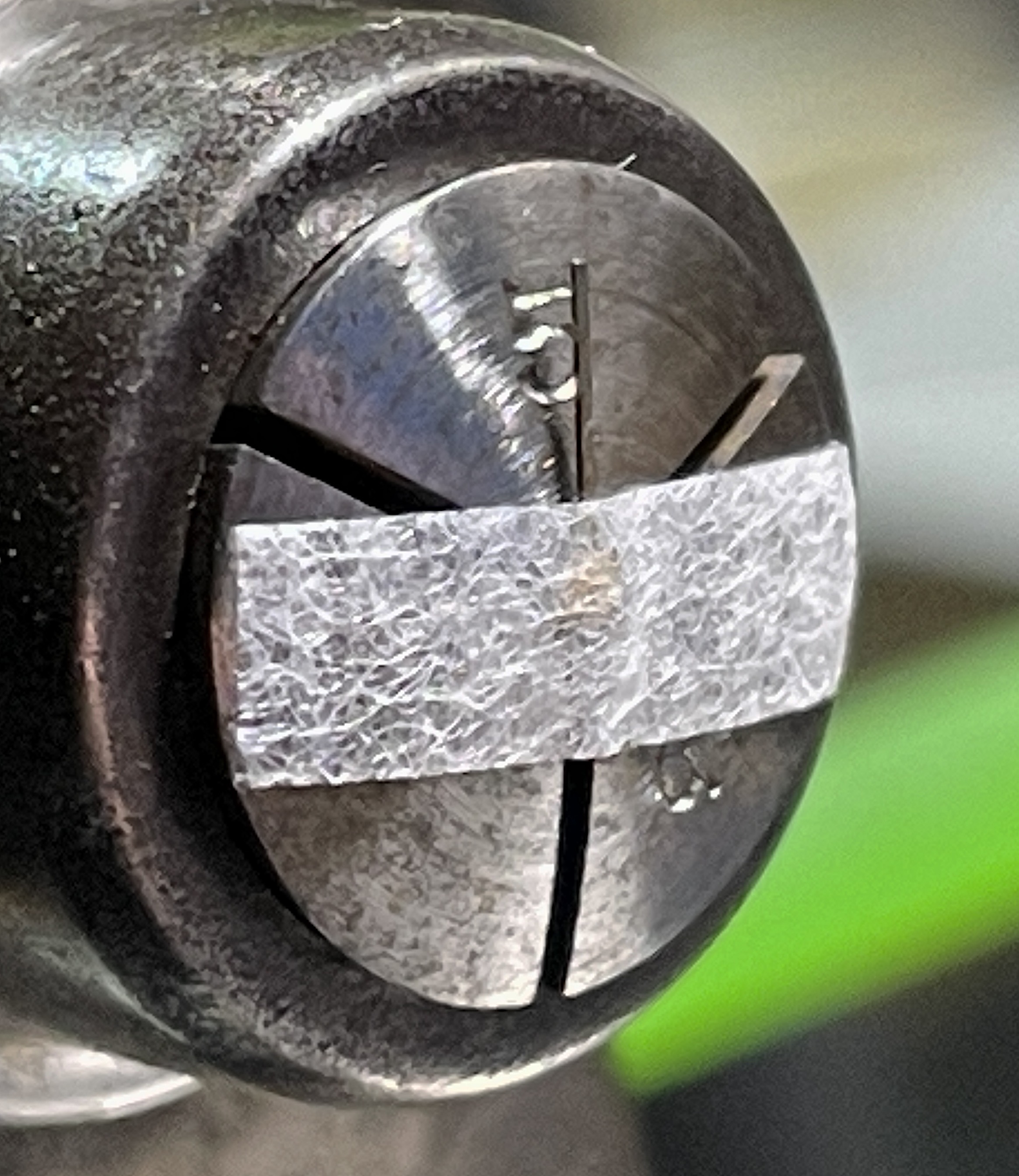

Hand was held in a No5 collet with surgical tape and given a light "squeeze" by closing the collet.
And then after some light broaching, it pressed on nicely.

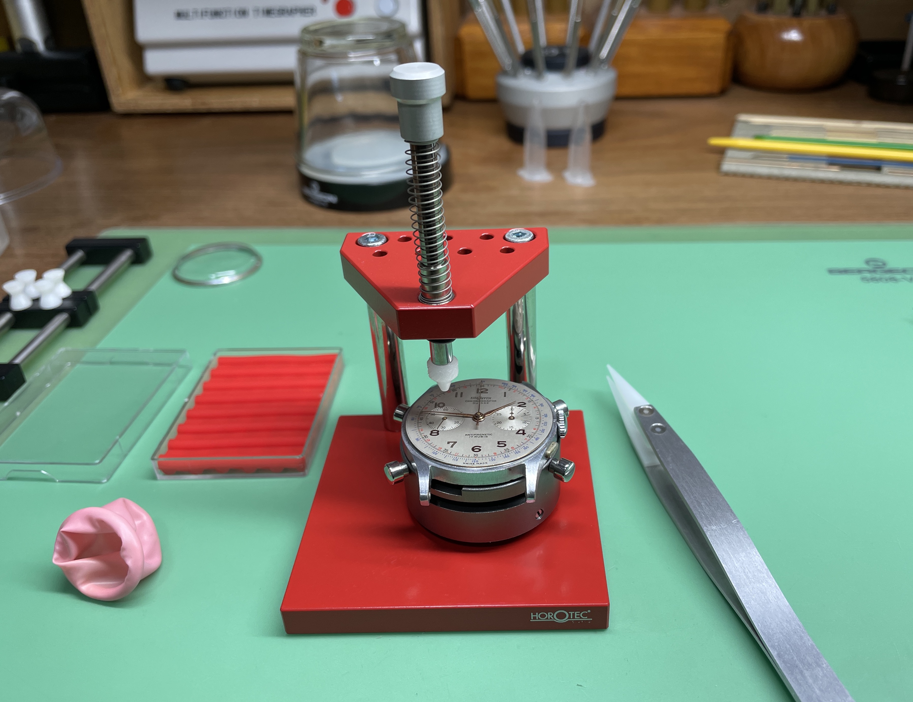

And that completes the task.

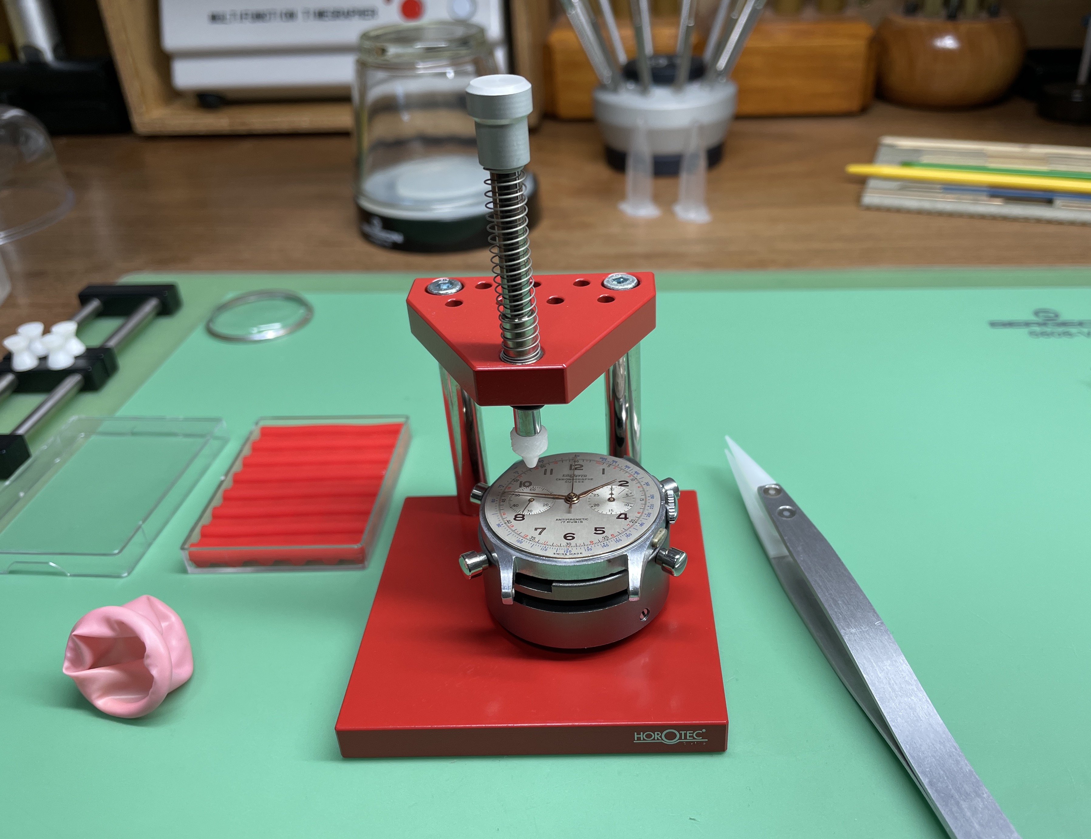

Actual watch finished here.
