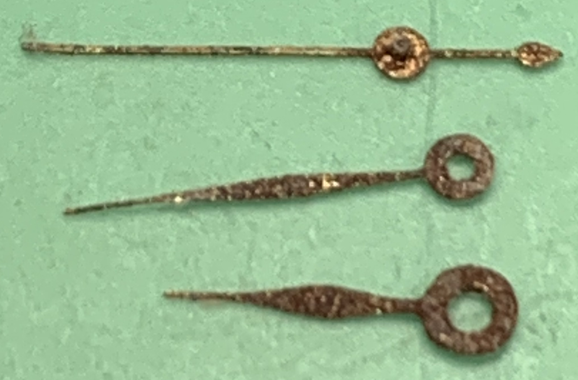

As I have returned to working with the chronographs, I found that some of the hands have become rusted and discolored. The transfer kit came with a lot of foil colors. I was going to link to the place where I got them only to find they are no longer available from that supplier. Similar foils may be available in crafts stores.

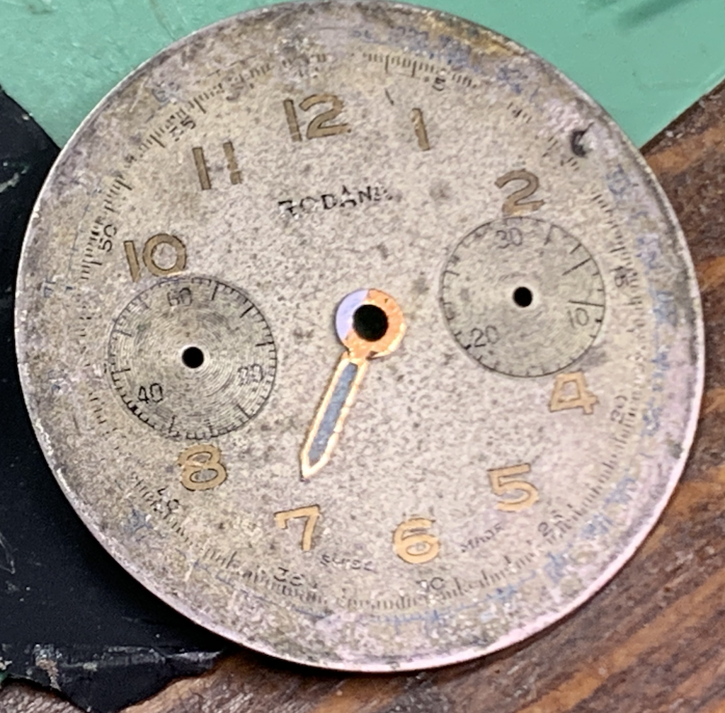

I did not document the process as I went. Some of the things did not work. So lets start with the result of the completed hand on a scrap dial.
The hand started life as a scrap hand and was somewhat rusted not unlike the Val-72 hands that may be the eventual target of this experiment.

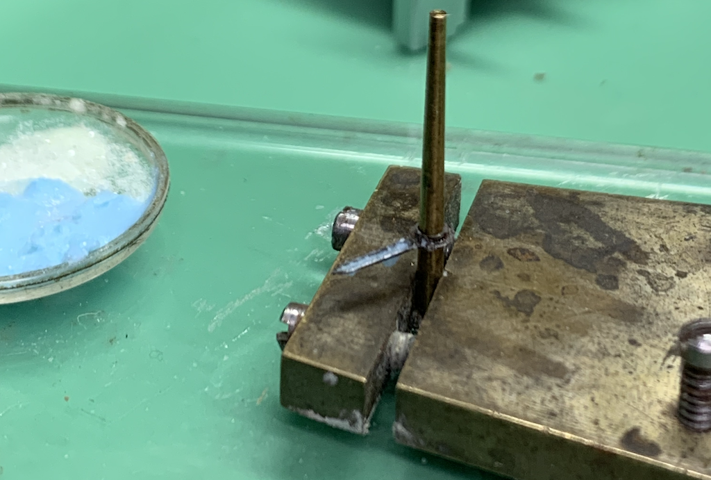

The hand was sanded with fine sandpaper and lapped on glass using a screw head polisher and a taper pin. Which can also double as a stand for working on the hand. These shows the post foiled hand being lumed.

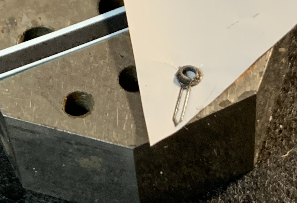

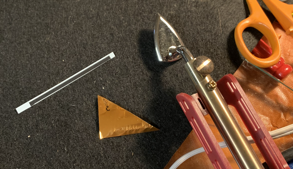

I no longer have a toner based laser printer. I did notice when I got the foils from the kit, that there were some sample runs with black boarders. I got the idea that perhaps I could use a small iron (for working on doll clothes and other fine cloth work.) That I could transfer the toner from a scrap then float the decal paper off.
I used some feld backing from camera light seal to iron the hand against. The toner stuck to the hand and the transfer paper washed away. Inverting the hand onto the foil and pressing it transferred the foil to the hand.
The hand was lumed as shown above.
I chose to use the blue paint (and keep the yellow green glitter.) As I wanted to try a different color combinaton.
The results are most pleasing. The macro setting on the phone does not capture how it really looks to the eye.
