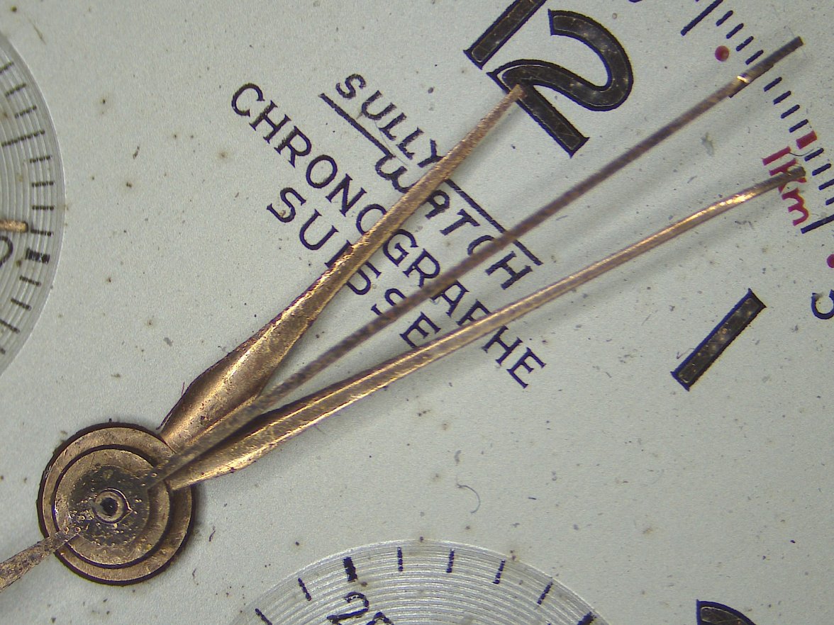

Especially when they have 50 years of accumulated dust/oil/crud.
Main hands.
Minute Recorder Hand
and Minute hand.

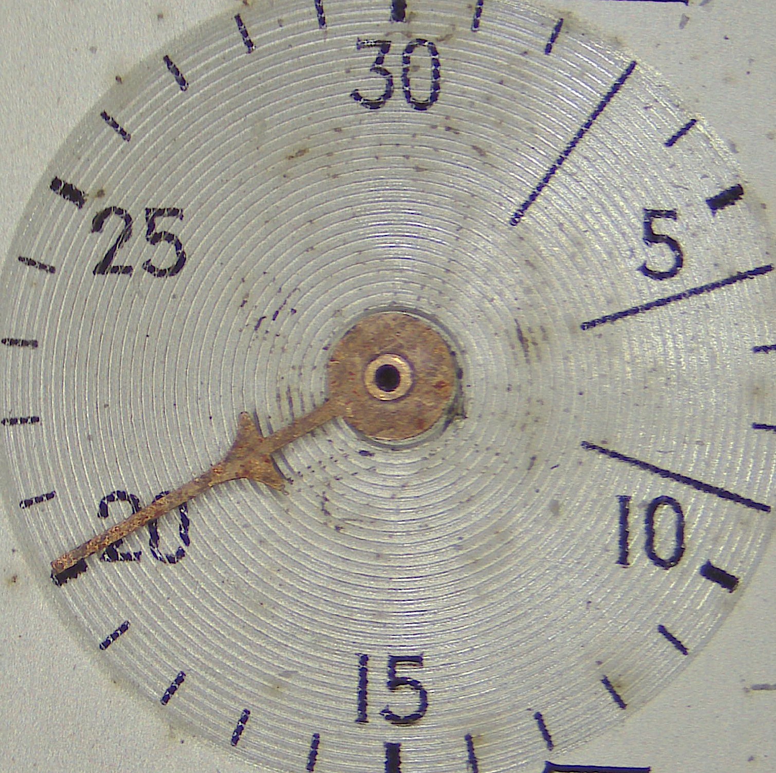

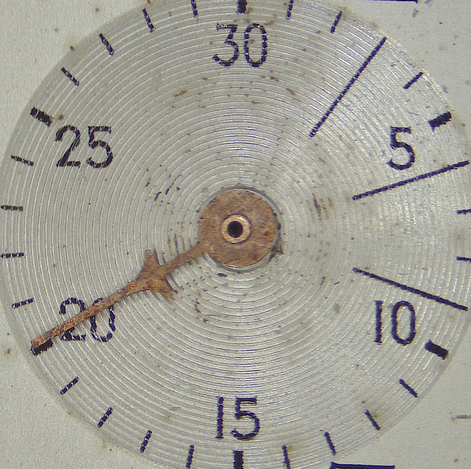

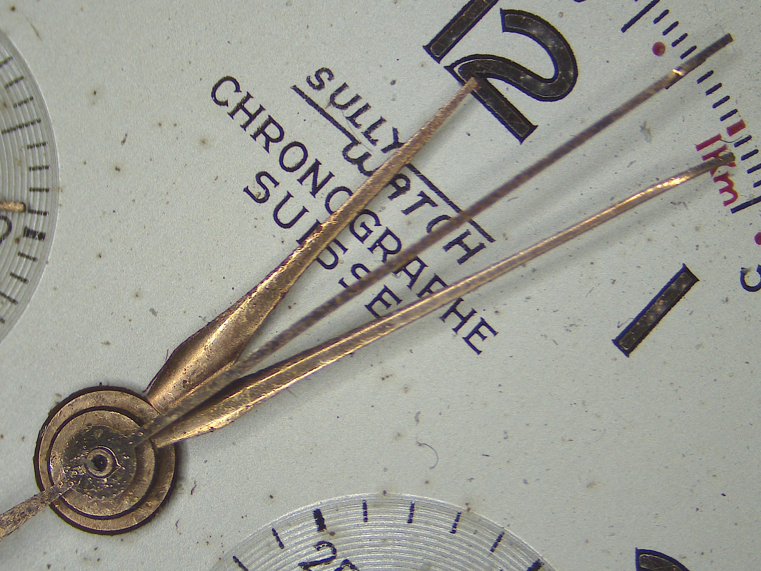

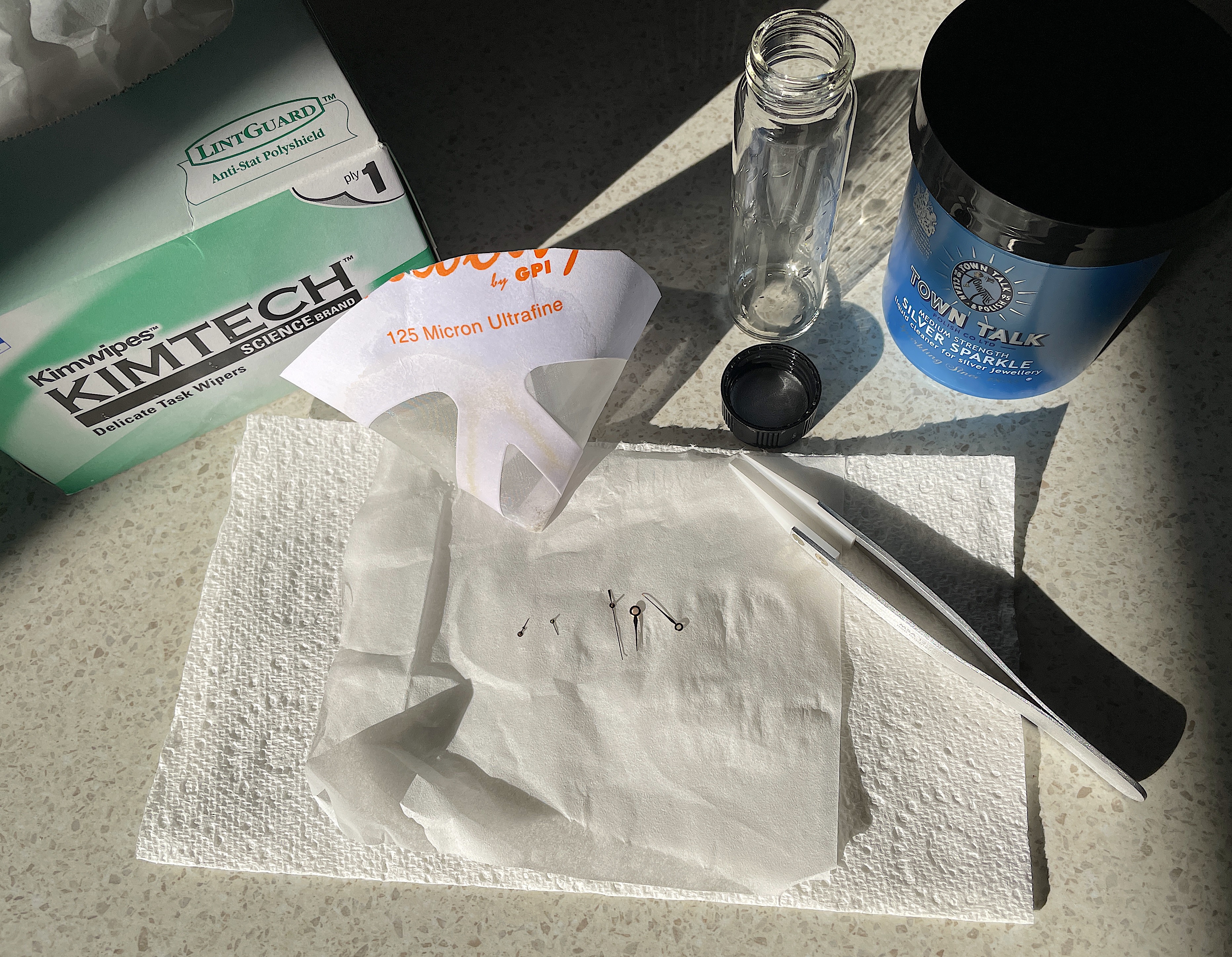

As you can see, they are rather dirty and have slight corrosion blisters along the edges. They're from a Landeron based chrono I'm servicing and when I went to put them back on I checked them out and went "Ugh!, no way!".

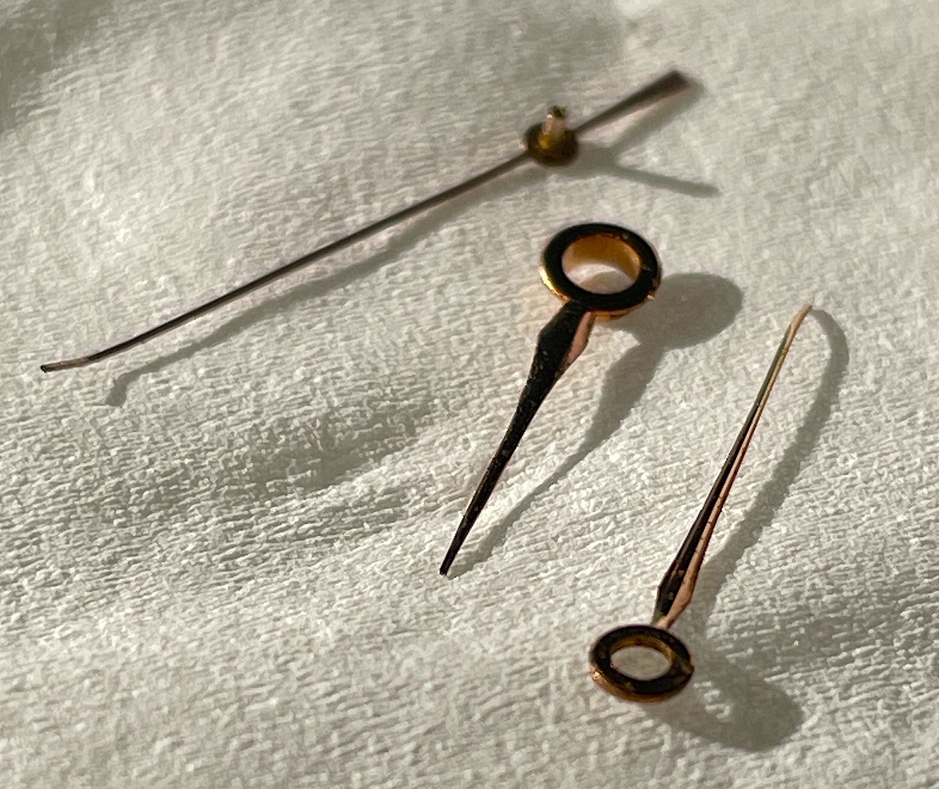

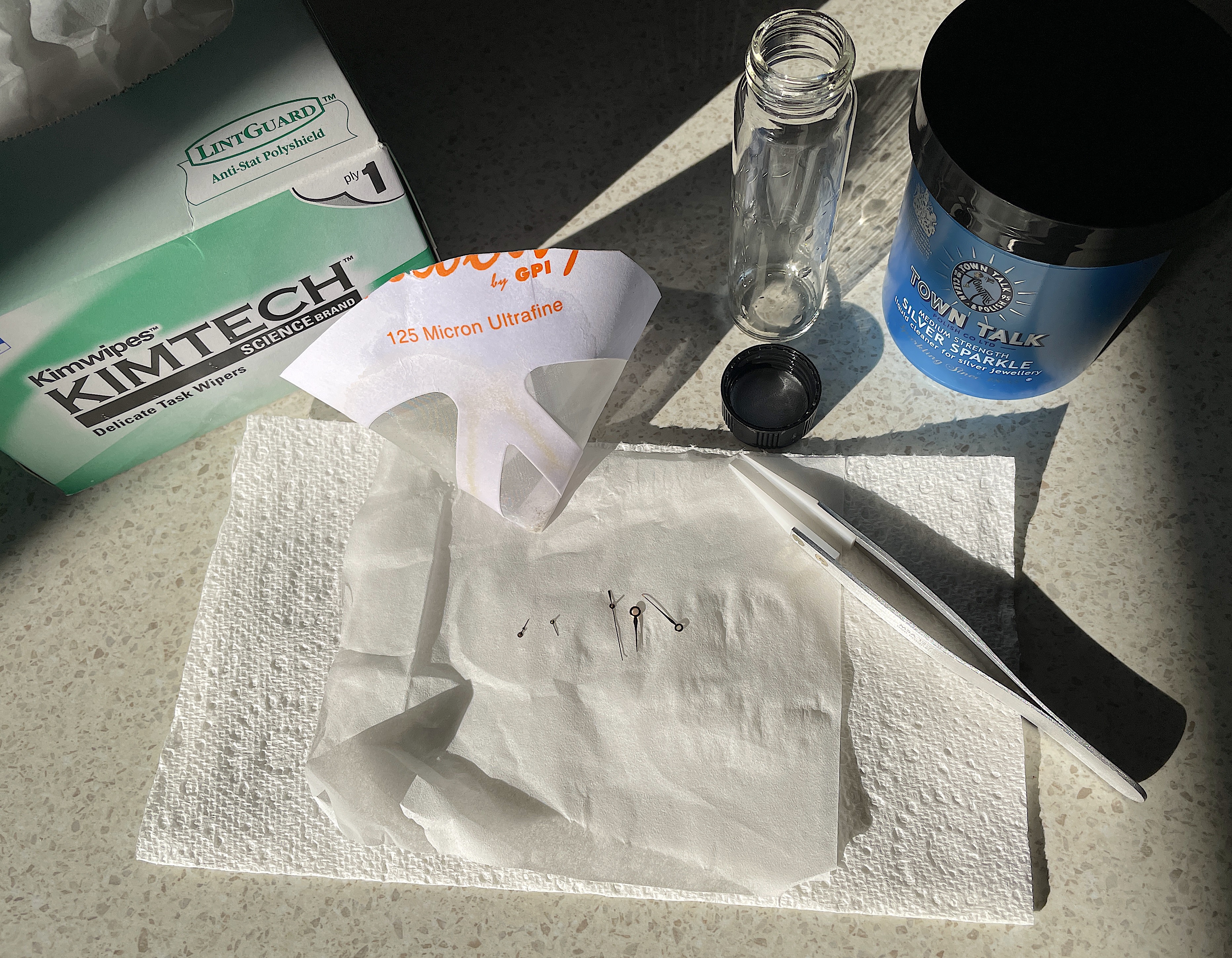

So how do you clean hands as delicate and rare as these. The risks associated with mechanical cleaning were too great, so my solution was a solution, Town Talk Silver Cleaning Solution in fact.

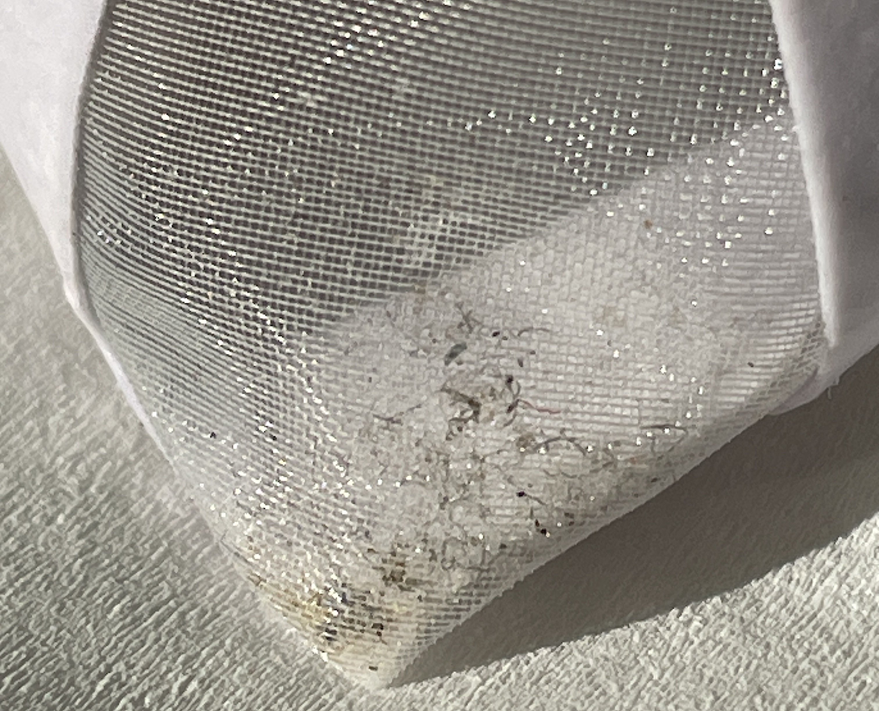

I had a 100ml tube jar and filled it with the cleaner, placed the hands into the jar and put it in the ultrasonic bath for 5 minutes. Then the solution was poured off and successive fills of distilled water added and allowed to rinse off the solution. The whole lot was then poured gently into a 125micron funnel filter, then laid on a Kimwipe to dry in the sun.

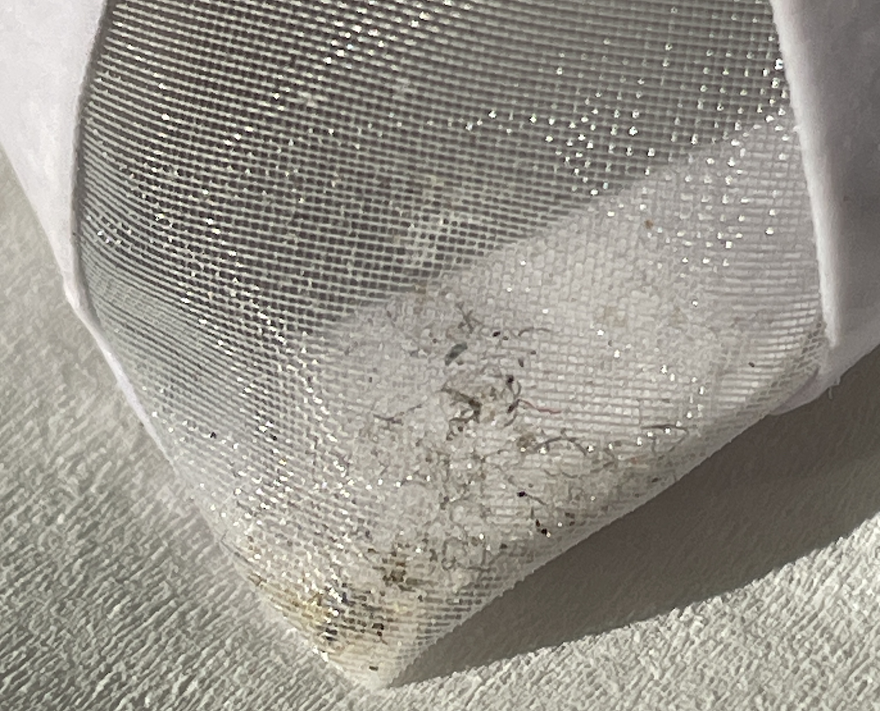

This is the crud trapped in the filter.

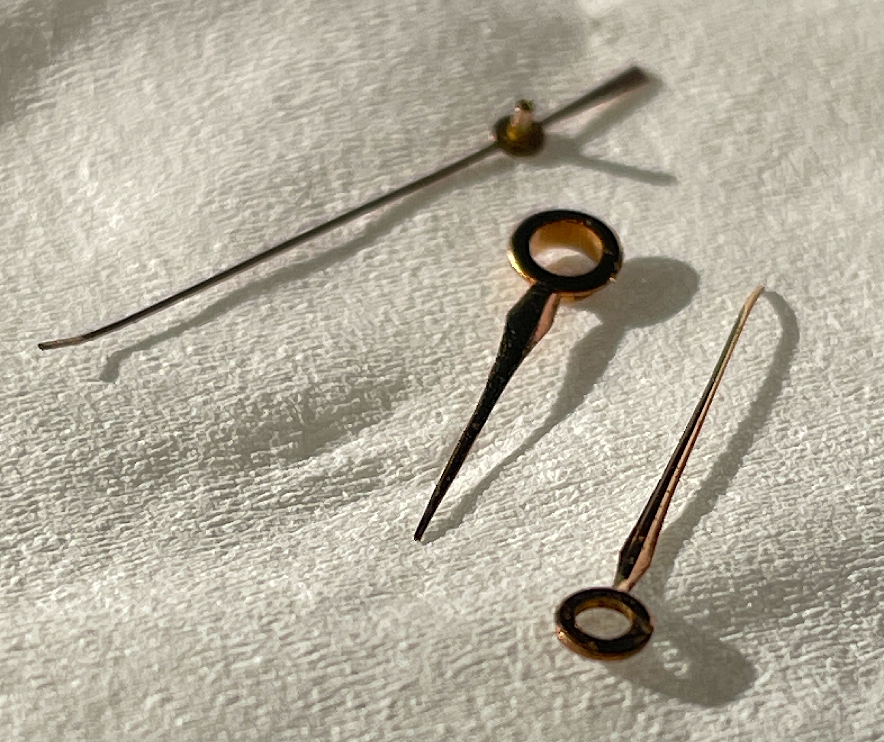

I think they turned out quite well.

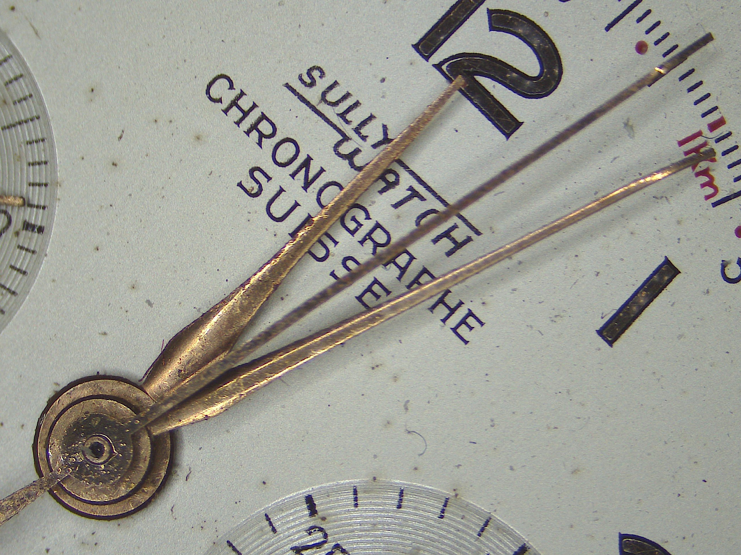

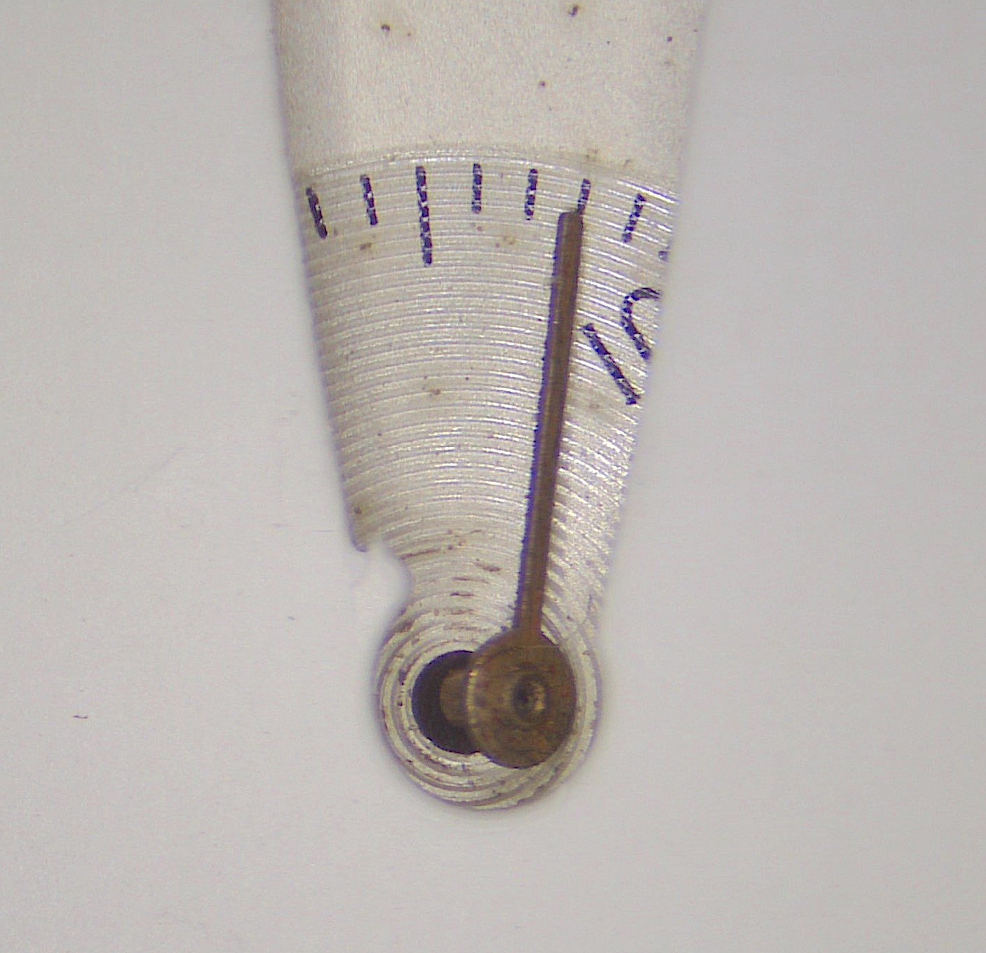

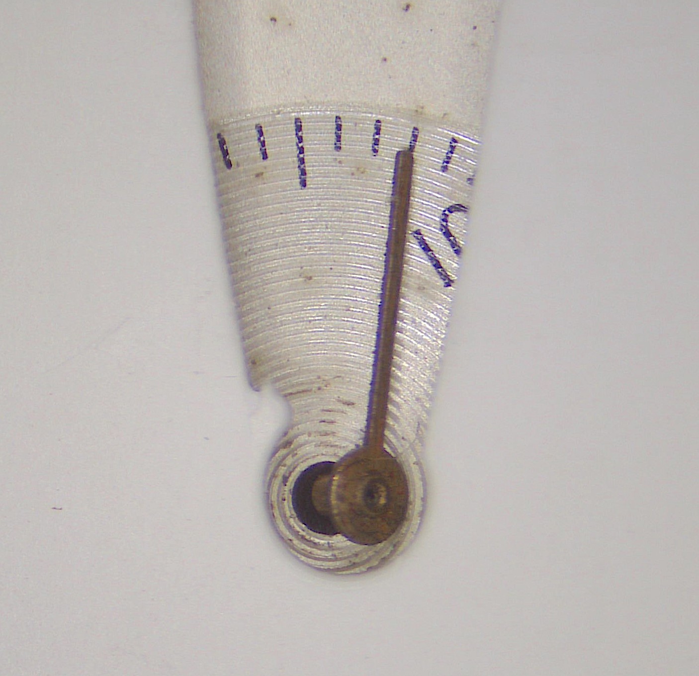

Do I attempt to clean the dial. From arm's length it looks OK, but under a scope it looks pretty bad. If I knew most of the spots and blemishes would come off I'd try the cleaning solution, but I'm not sure so I think I'll just have to live with a soft brush and a puffer to clean it up.

Very nice result. I'd like to see the final result once it's all back together as well!

Wow - nice result. As for cleaning the dial, I can report only several failures, despite taking every care I could think of. I would do the minimum to get the dial clean - just gently wipe it over with a cotton earbud to remove the dirt. However there are far more knowledgeable OF members who may be able to give better opinions.

Nice work, what a difference.. Silicone buds might be good to use on that dial😉

I used some silicone tip buds to remove the larger dirt/grit specks.
Followed that up by using a fine sable brush (cleaned before use) to dust off anything loose remaining on the dial. That's as far as I was willing to go.

@JimInOz The hands have come out beautifully. Can I ask are they made of brass? Does this silver cleaning solution trick work on all metals? Are there any metals you can't use it on?
1,320
1,679
I think brass on this scale would probably be too soft, they are most likely plated Steel
