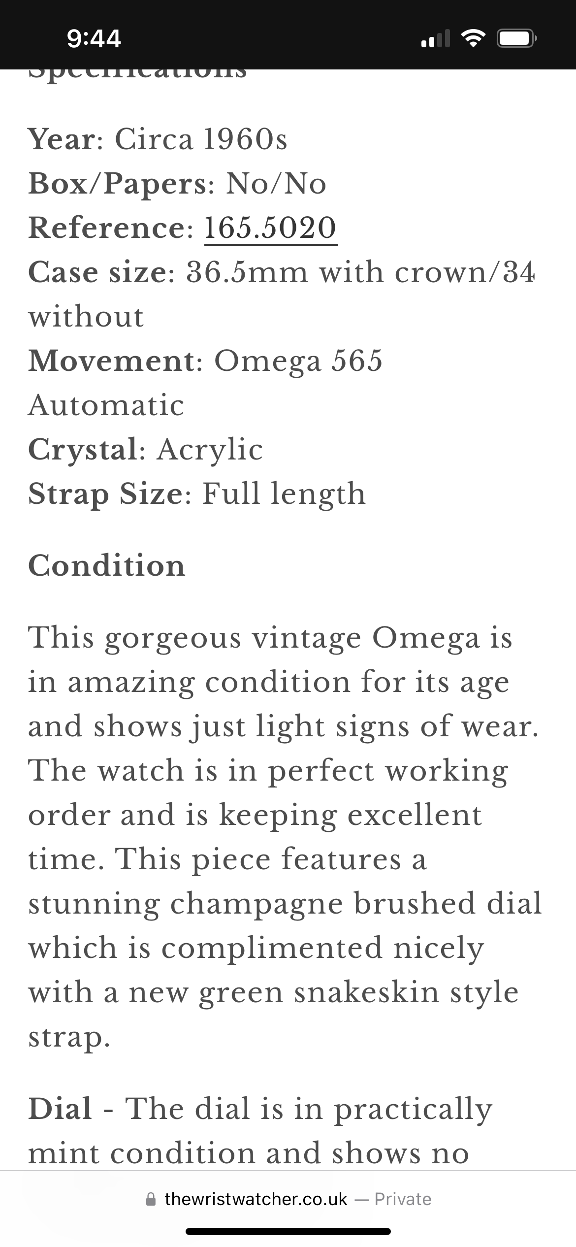

Thanks for getting back to me so quick. He doesn’t have a picture posted from the inside of the case back. But he posts the details here. The price is 1214 usd for reference. Thanks again!

The plated crown should be replaced, as the seller notes. The lugs are quite rounded over from heavy polishing, but other than that I don't see any issues.

There's not many of these for sale to get a good idea. From what I'm seeing, the case should be 9ct gold. If you're wondering, there isn't a lot of gold value. The case is thin and I would guess not more than 15 grams, which puts the gold value at ~300 Euros or less on scrap value. I don't exactly consider the price a bargain.
Just for you to look at options, there's other DeVille references that are more popular. I have a 166.020 myself. These come with all kinds of case materials and dial styles.

Agree with above, the price is pretty strong for a polished case. It might be less in the new year.
Being in a rush to buy a vintage watch usually means you are sacrificing quality and/or price.

If the case is solid 14k, the price is fair, IMO. If it's gold-filled, then the price is at least 2x market value.
It’s a solid 9k gold. I have just had a hard time finding solid gold with champagne dial for a decent price.

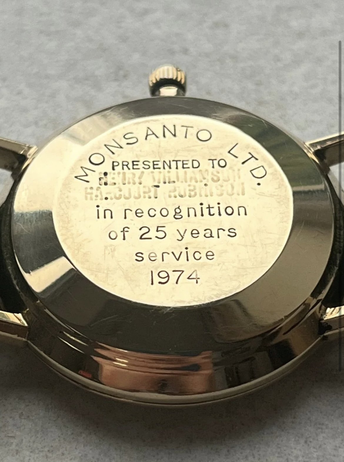

Monsanto? Shouldn't such watches be shunned like WWII German collectables? 🙄
