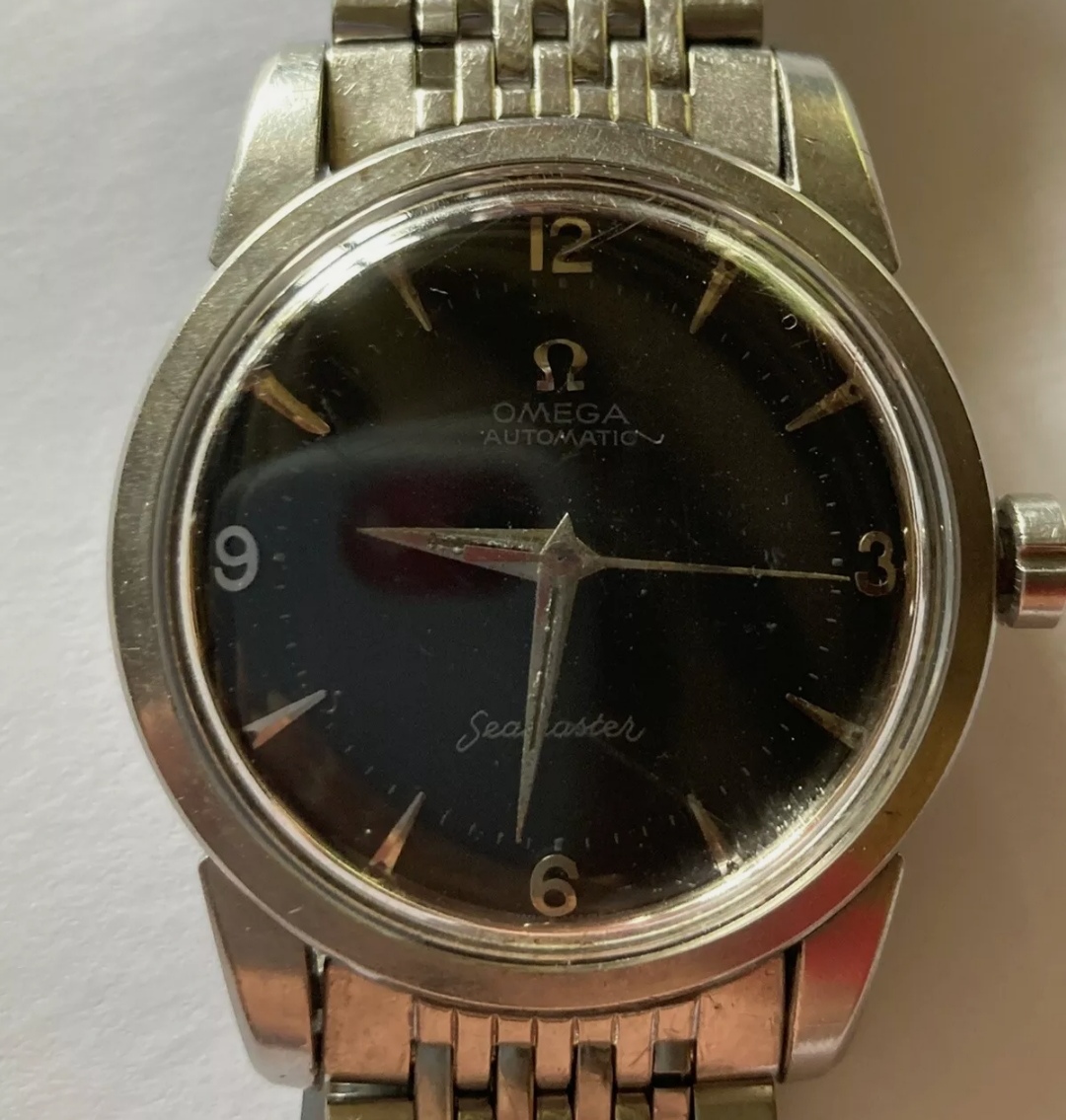

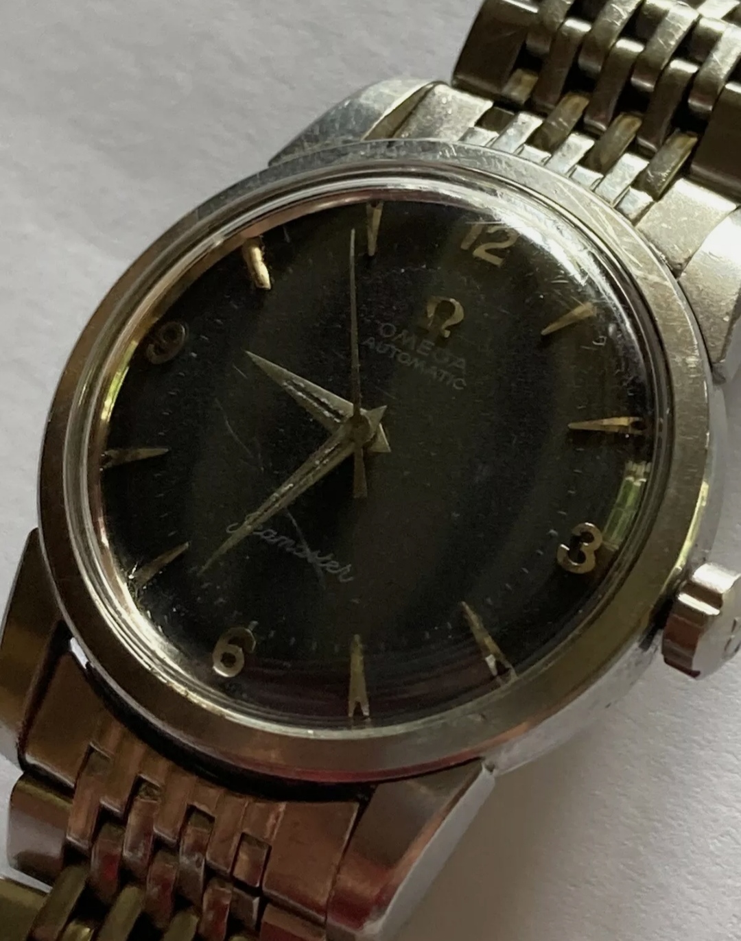

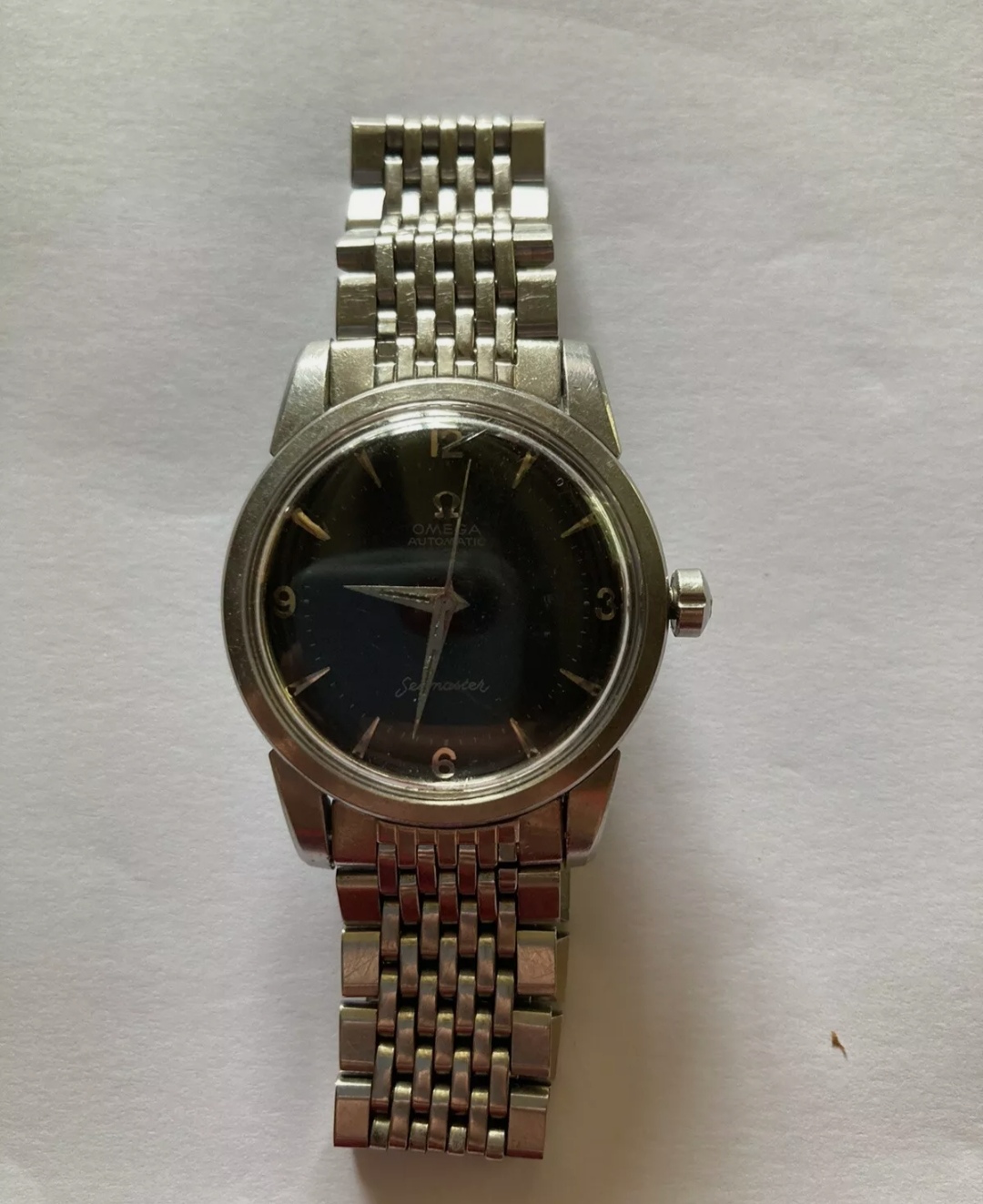

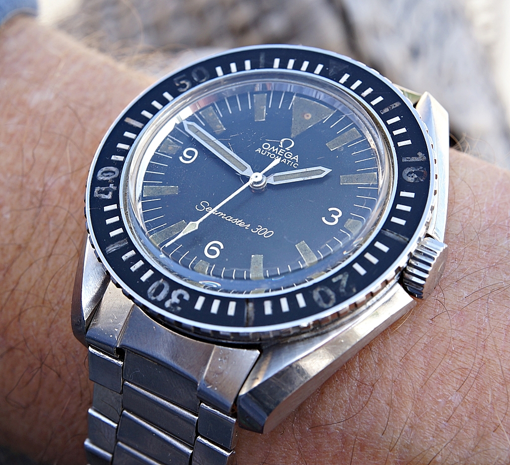

Hey guys,
What are your thoughts on this dial? In my opinion everything looks ok. Swiss made is there, text looks right and case looks unpolished. I am aware that black dials are minefield but this one looks right.
Thanks in advance
Tom
2,597
5,666
Regarding the applied numerals, does the 1 of the twelve look higher than the 2 ?
Also does the 6 look a bit wonky ?
As you say the dial text looks pretty reasonable so it’s only the numbers that would make me worry. Better photos would help a lot but I guess that’s all you have.
3,238
6,787
+ 10 o clock index...😗........
black dials are beautiful and dangerous 😀
2,597
5,666
Actually looking at it again, some appear applied and some appear just painted on. The nine looks like paint, as does the 1 of the twelve. The 2 of the twelve, the 3, and the 6 look applied. Edit to add that in o5er photos the 9 might be OK but still the 1 looks odd to me.

I’m interested to see what it looks like when you get it. Sometimes lighting, angled, dial damage, can make it hard to tell if things are right. Fingers crossed.

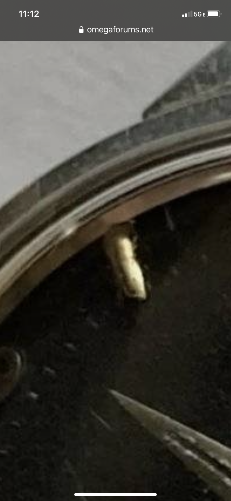

Edit: My .02 - that crown is dangerous too I believe, I think Chinese faked a couple of crowns, that model was one of them, but I never saw any conclusive evidence
1,588
12,730
Thanks for the input. I was so focused on printing which looks legit that I didn't even noticed problems with numerals. Managed to make a deal with seller and canceled the sale. No more black dials for meeeeee :whipped:

Do you mind sharing what you were going to pay for it?
And did the auction show any movement pictures?
Despite the issues with the applied markers (which could be crystal distortions), I feel the rest looks good and I wouldn't outright call it a redial without seeing it in person.
If the price was good enough, I would even risk buying it.
