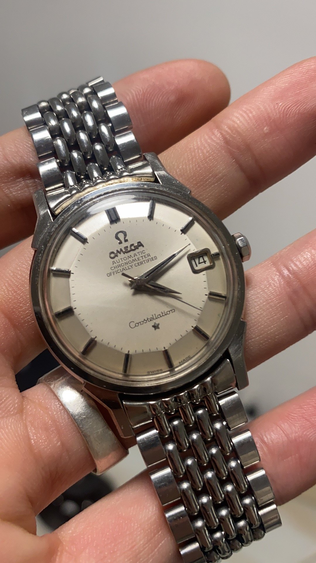

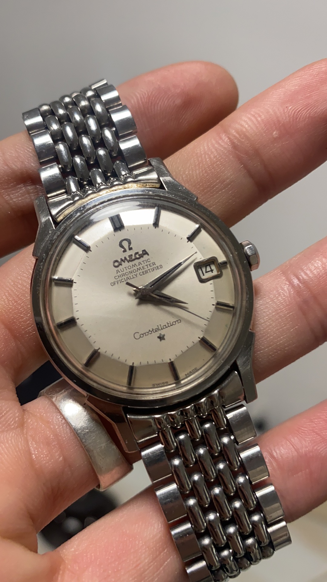

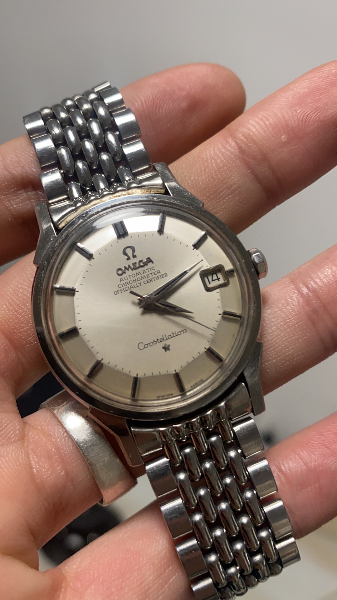

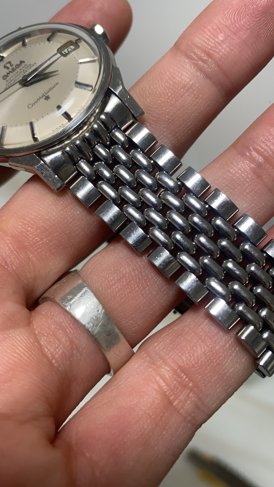

How about this constellation,Everything is original?Cal.561
The price is about $1300
How about the price?
Thx!
278
356

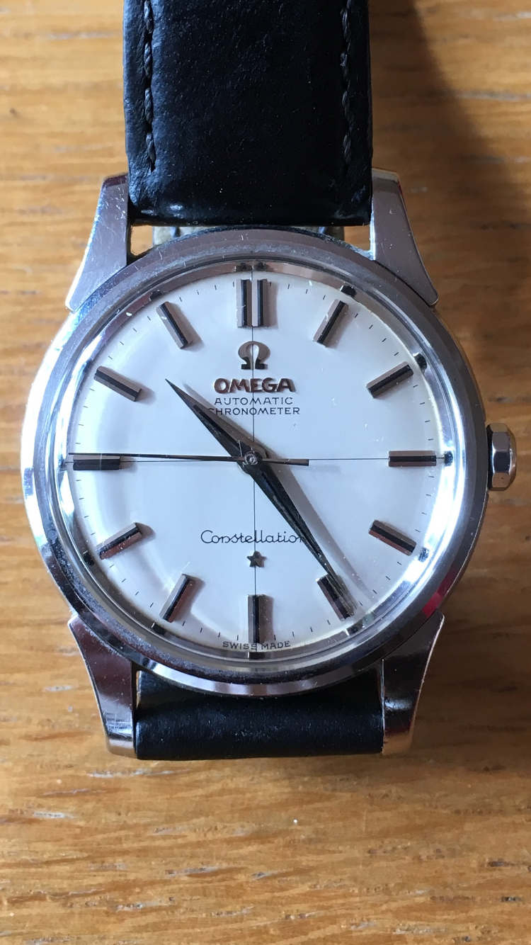

Jeez... I would have said original dial 😬
Could you provide us a face front photo of the dial please?
2,298
3,157

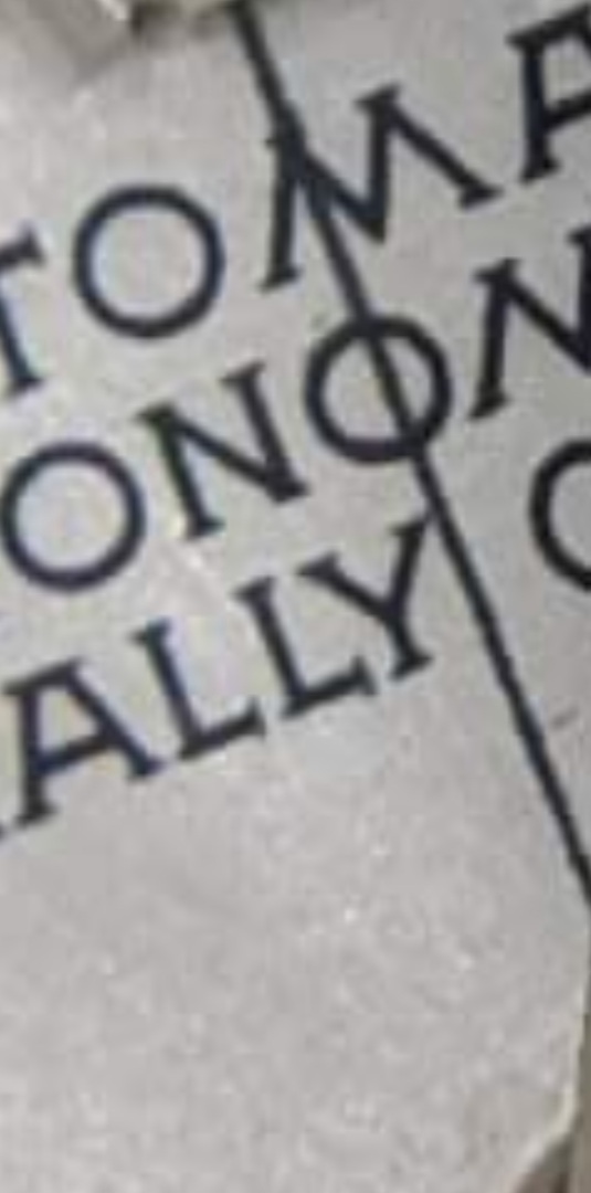

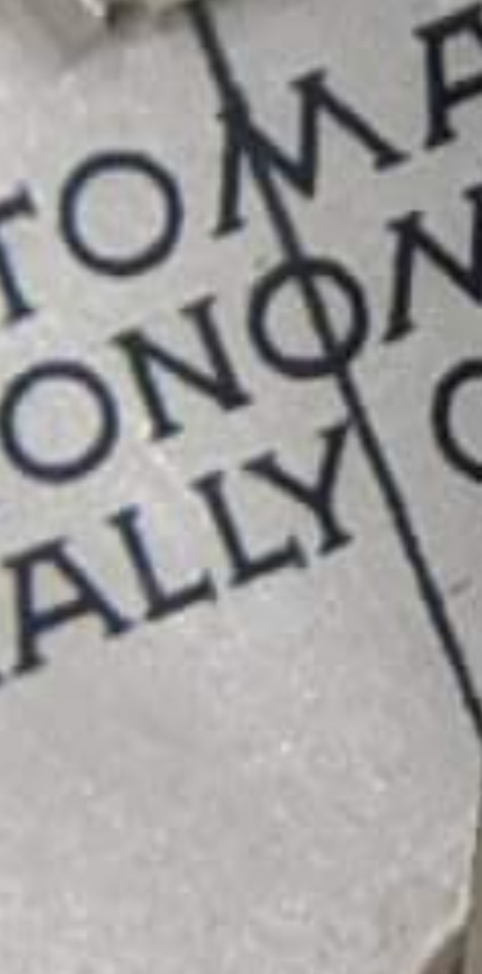

Redial unfortunately - doesn’t pass the MOY test
Good eye! Font didn't looked bad at first look
Spacing is also wrong, look at the second A in Automatic

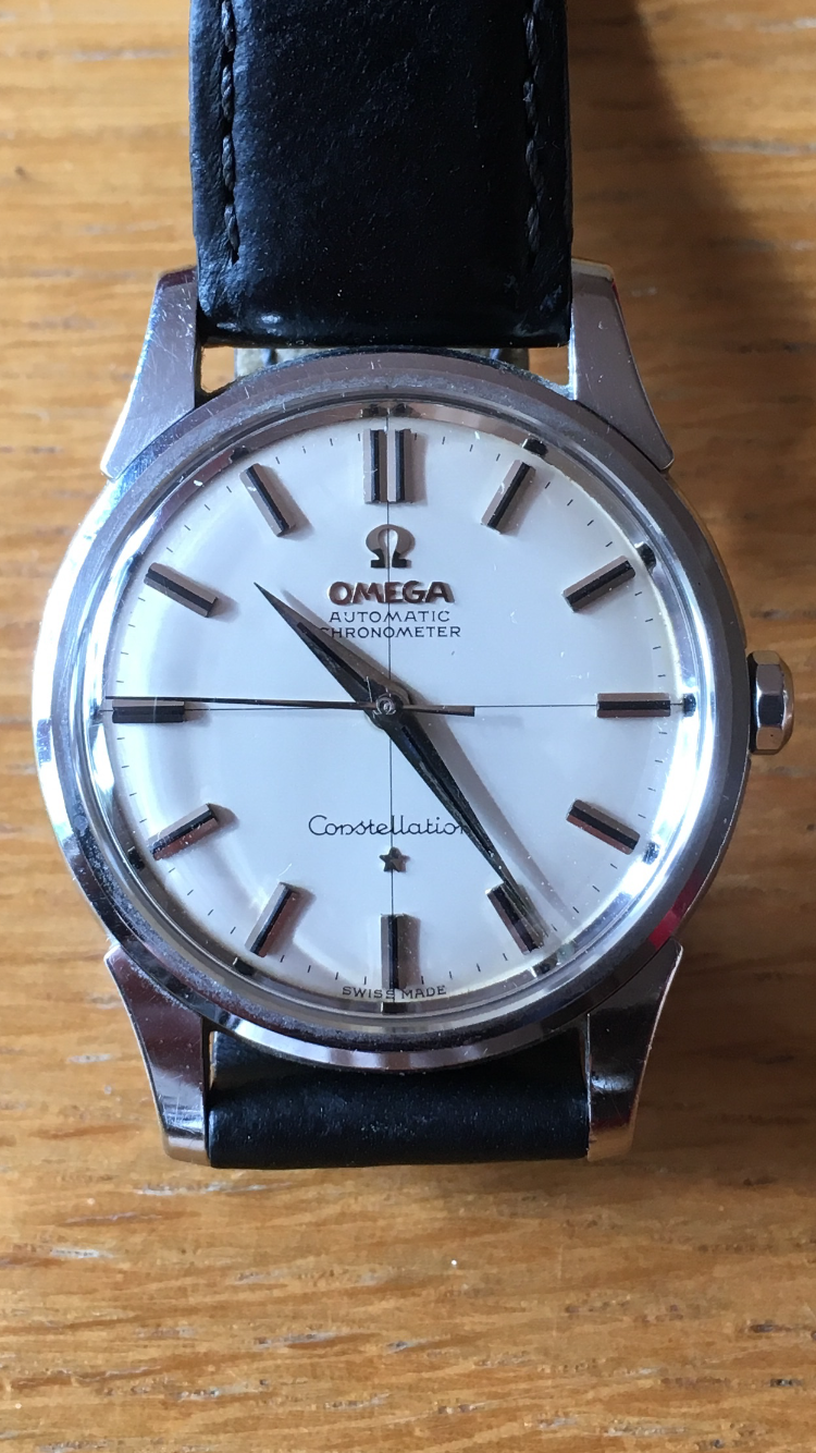

Love the MOY test! A very useful tool, although I note from the link that there are exceptions.
Presumably it can be adapted to an 'MO' test when the 'officially certified' is missing?
indeed it can - shown here with a cross hair.
The relationship of the cross hair to the first L in Constellation is important too (which differs slightly between dome dials and pie pan)

Brilliant - something that beginners like me can do as a first check. Thanks very much.

But...sometimes MOY test is not enough. Rediialers are doing very well now.

I really would like to see better pictures first of the dial. The fact it does'nt pass the moy test is not enough for me.

Yes. I saw what you wrote. But I'm not convinced it's a redial. I have the feeling I saw this text configuration more often. But I would like to see straight up pictures in normal light. I would say for now the dial is genuine.

Could be the angle, but the minute track between 1 and 2 looks very crooked in the first picture, particularly looking at the distance between the minute track and edge of the pie pan.

Glad I’m not the only one... 👍
