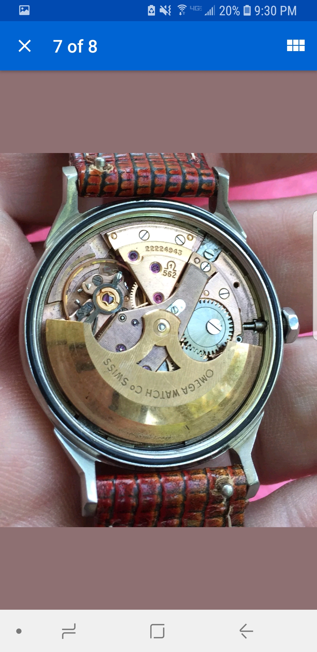

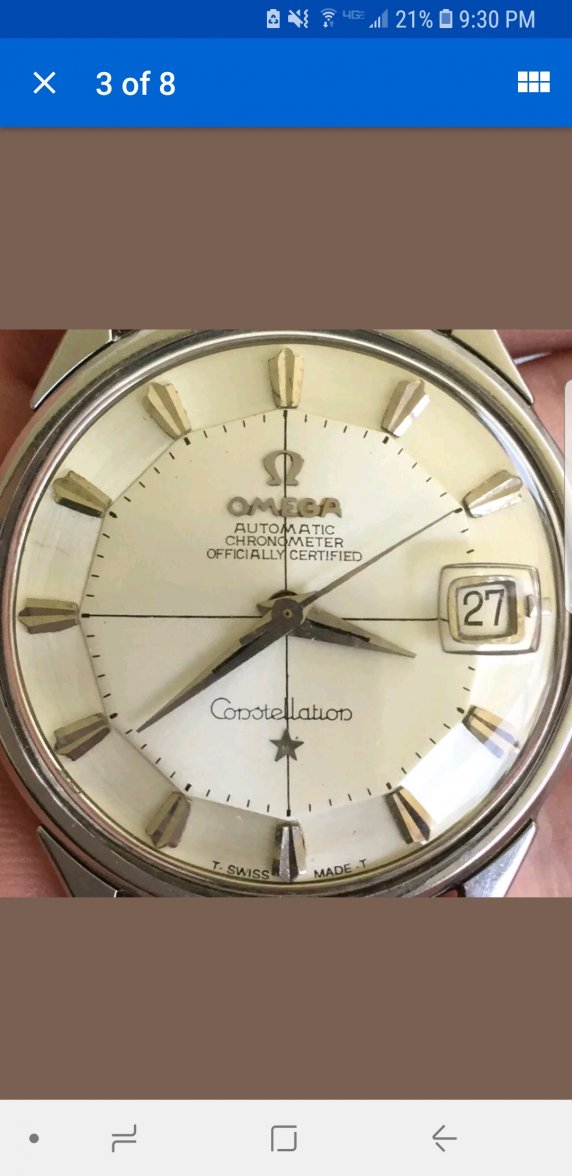

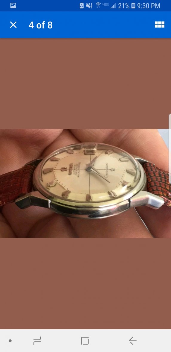

    Not sure whether I should buy this or not.. I love it but pretty sure it's a redial and think everyone would agree with me.. the movement isnt to p Screenshot_20180617-213021_eBay.jpg Screenshot_20180617-213028_eBay.jpg Screenshot_20180617-213051_eBay.jpg Screenshot_20180617-213039_eBay.jpg retty buy was told it runs great.. is it worth it?

    Redial.
    Pass.

  4. Dan S Jun 17, 2018
    18,814
    43,264
    In addition to it being a redial, the movement is made up of parts seemingly assembled from two or three different watches. This forum is primarily frequented by collectors, so you will probably not get many recommendations to buy it.
  5. kyle L Grasshopper Staff Member Jun 17, 2018
    4,418
    11,222
    I would pass...looks frankened. Dial might even be a fake.

  7. Bill Sohne Bill @ ΩF Staff Member Jun 17, 2018
    3,889
    8,951
    562 movement........
    Non chronometre
    I don't like case ........can't put my finger on it.....
    I would pass ..
    Oh agree on dial.... Non original surface.
    Bill
    Edited Jun 17, 2018
    Skrv likes this.
  8. mondodec Editor Constellation Collectors Blog Jun 17, 2018
    843
    871
    Dial is definitely a Chinese fake, and the case is also a fake. These have been around for a few years now, and provide enough reasons for due diligence to be done fastidiously on all 167.005/168.005 and 14900 and 14902 cases.
