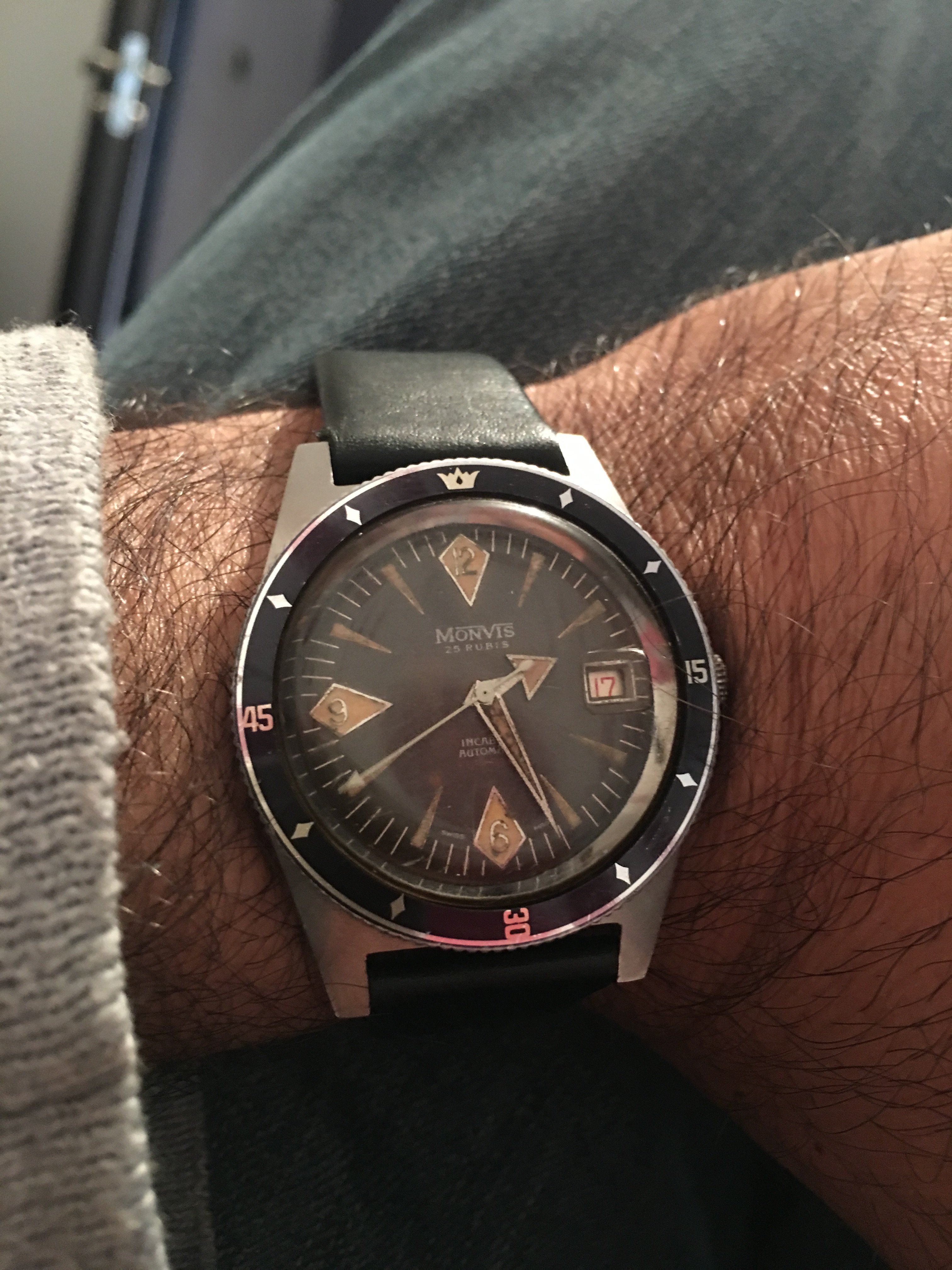

Fab! This appears unworn. Don’t let the bezel fool you. This wouldn’t be safe to wear in London fog. Runs like a one-jewel top.
That’s a really nice look

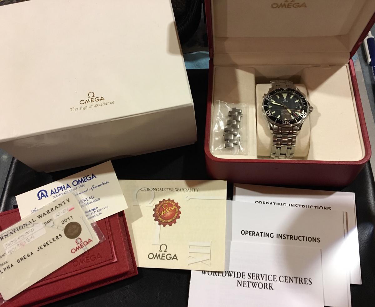

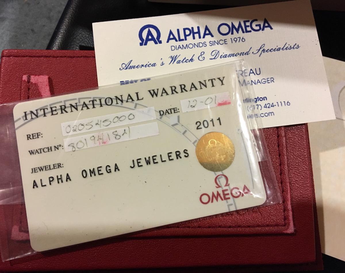

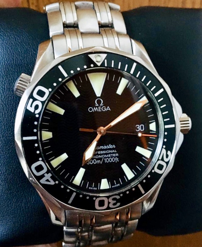

My first is on the way...a Seamaster has always been a grail to me, and the stars aligned yesterday😀
Can’t wait to see it in the flesh

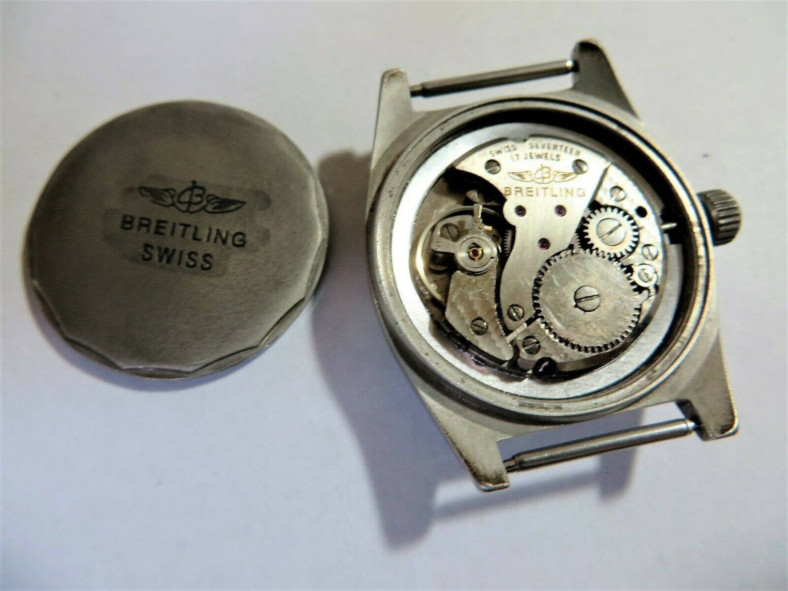

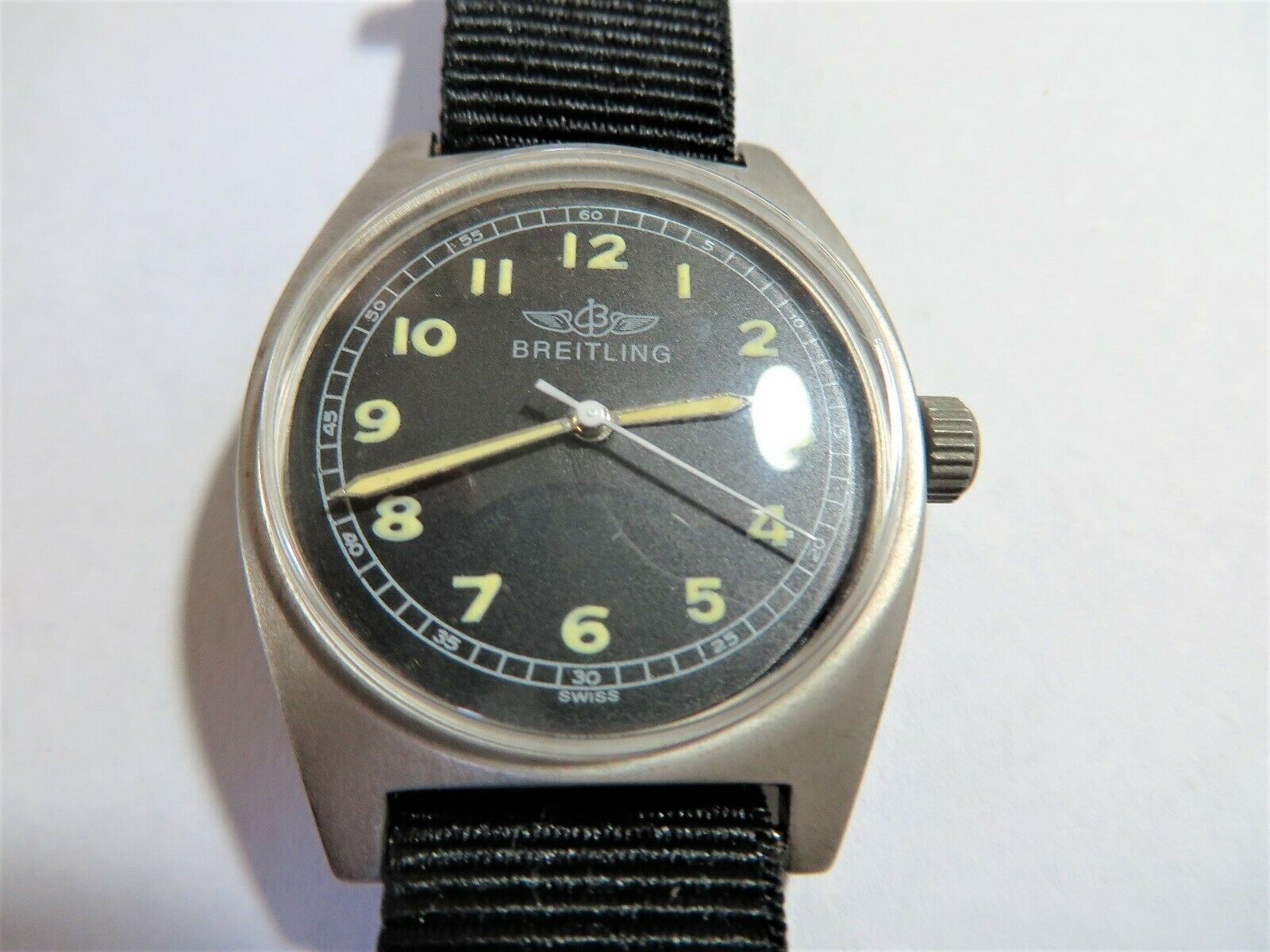

Hi all,
Can anyone tell me anything about this Breitling?
The seller doesn't know the manufacture year or the model, only that it's a running Breitling.
I bought it recently but it hasn't arrived yet so I don't have a serial number.
Any info would be greatly appreciated and I'll update once I know more.
Thank you

Fake. The FHF movement (cal 96 probably) is widely used in fakes.

Can you expound on that? I have no idea what "FHF movement" means.
Sorry, I'm pretty new to collecting and know nothing about Breitling or their movements.
Thanks

FHF is the maker of the movement. Not used by Breitling. The watch is a total fake and you should cancel the sale if possible.

I will certainly try to cancel it.
Where does it say it's an FHF movement? The only makers mark I see is Breitling.
I will say I'm not surprised to hear it's a fake because when asked about a serial number the seller said there wasn't one anywhere on the watch.

The Breitling engraving on the movement is fake. The Breitling engraving on the back of the case is also obviously fake (you can even see where it was ground down around the engraving). The dial is fake.
Here is a picture of an FHF 96 movement, you can see they are the same: http://www.ranfft.de/cgi-bin/bidfun-db.cgi?10&ranfft&69&2uswk&FHF_96

Wow, I never noticed.
Thank you! I am writing the seller as we speak.

You might find it interesting that while I've been waiting for a response to my request to cancel the order I've been looking at his recently sold items. Most are higher end watches "Breitling, Jaeger-LeCoultre, etc..." and they all have the same FHF movement.
I find it impossible to believe the seller did not know it was a fake and just happened to coincidentally sell several watches with the same fake movement.
The seller's name is "miced-49" and this is an item number for a current listing of his: 362654139772
Beware.
