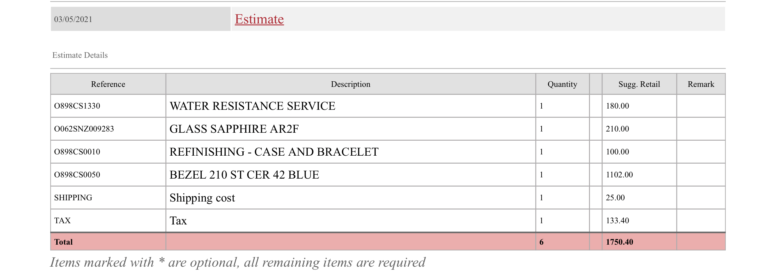

I sent in my watch to the swatch group for a service quote, it’s 210 for the glass but they charge you an additional 180 for the mandatory water resistance test for opening it and swapping it out, I tried talking my way out doing the water test but once they open the watch it goes into full service mode.
What threw me off was the ceramic bezel, turns to find out they don’t sell you the insert but the whole assembly, I heard that as of q3 last year they stopped selling you the inserts only. I have two 300 smp’s the blue dial and white dial versions, the white dial version is flawless, both less than a year old, the white dial is flawless but at the end of day is the outside AR coating a big deal for me? Not really, it just surprised me since it’s my first watch with an outside AR coating and was a huge learning experience for me I guess

Wow! The cost of a new bezel is enough to make me shy away from the Seamaster 300 ceramic.
