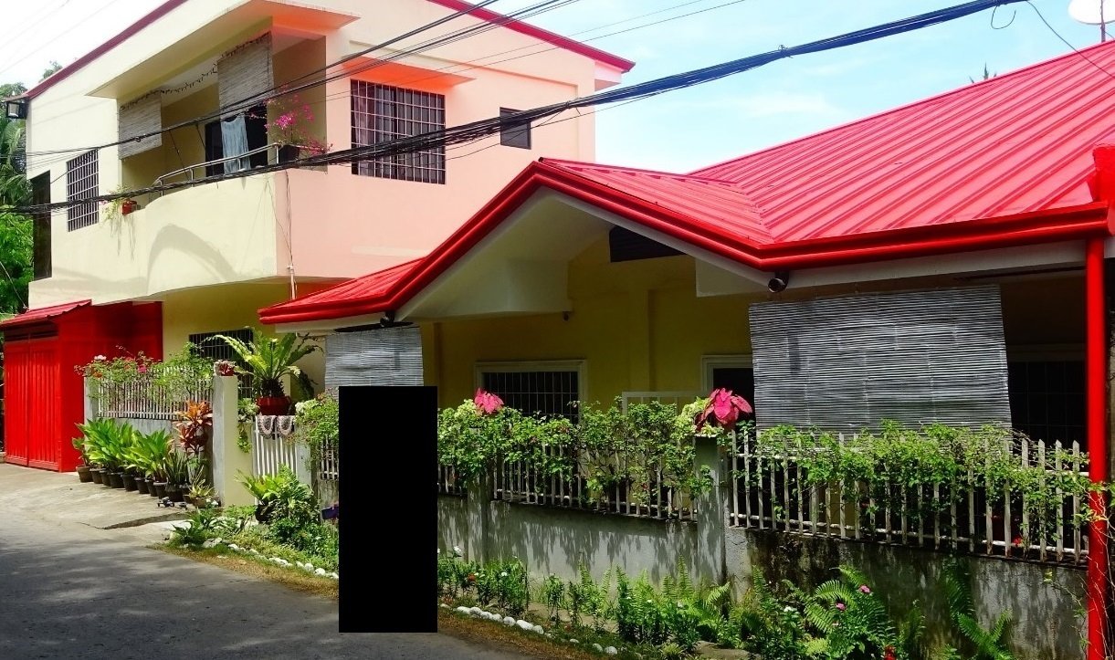

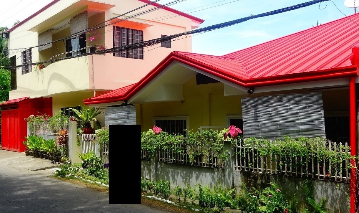

Built 4 Homes in the Philippines, One on beach front plus have a Farm with some builds on it. Instead of going all full metal show..... Here are the 2 newest ones built side by side. Blacked out area is blocking my Wifey. Privacy concerns.
