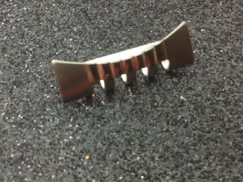

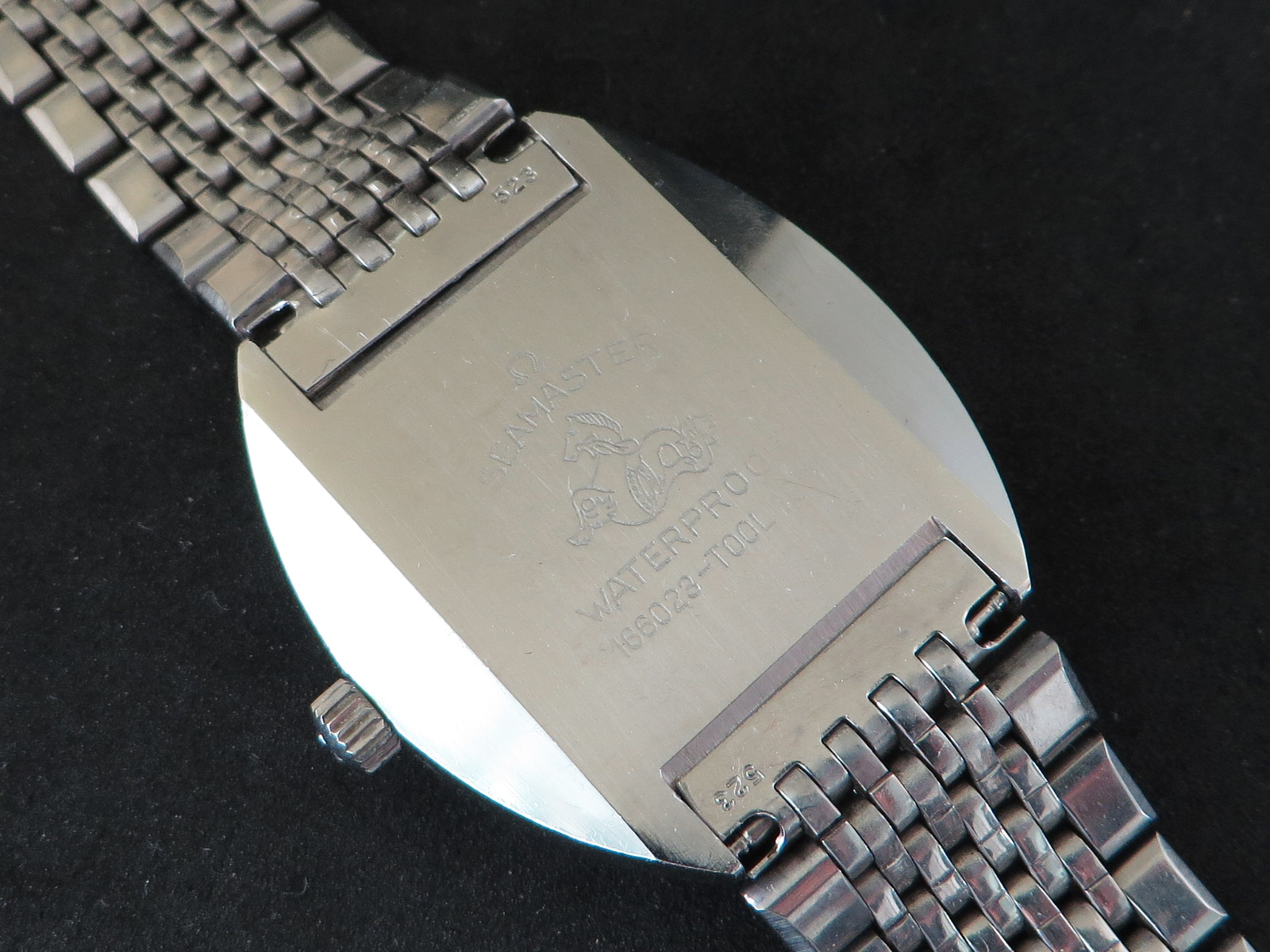

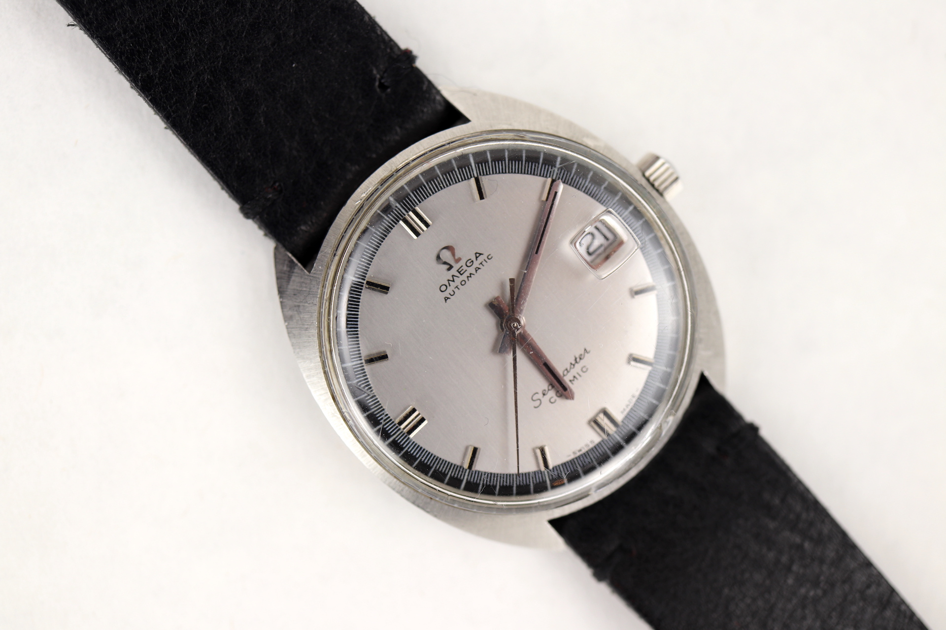

I just purchased a Seamaster Cosmic ref. 166.026 from a member on OF and I am thinking of putting a Uncle Seiko 1171 bracelet on it with the 19mm links. I searched for and found a photo of the 523 end links that would have come on the Cosmic BOR, and the shape seems pretty similar to the 19mm links for the 1171. Please look at the photos below of the Cosmic, 523 end links, and the end links from the listing for the 1171 homage bracelet. I have three watches on BOR bracelets and I am looking for something different for this watch. None of the photos are mine, but all are from this site or eBay. Hopefully that is ok.
Has anyone put a 1171 on a Cosmic 166.026?
Does anybody know a reason it would not work?

The Cosmic end-links are unique in their back side shape.
1,193
6,193
Thank you @X350 XJR. I can see that now on the photo of the 523 link. I should probably grab the links as they appear to be pretty hard to find and wait until a reasonably priced 1068 bracelet comes around.

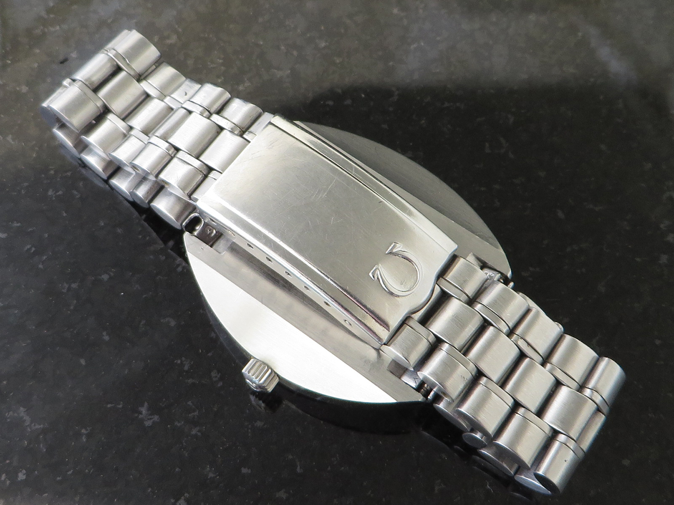

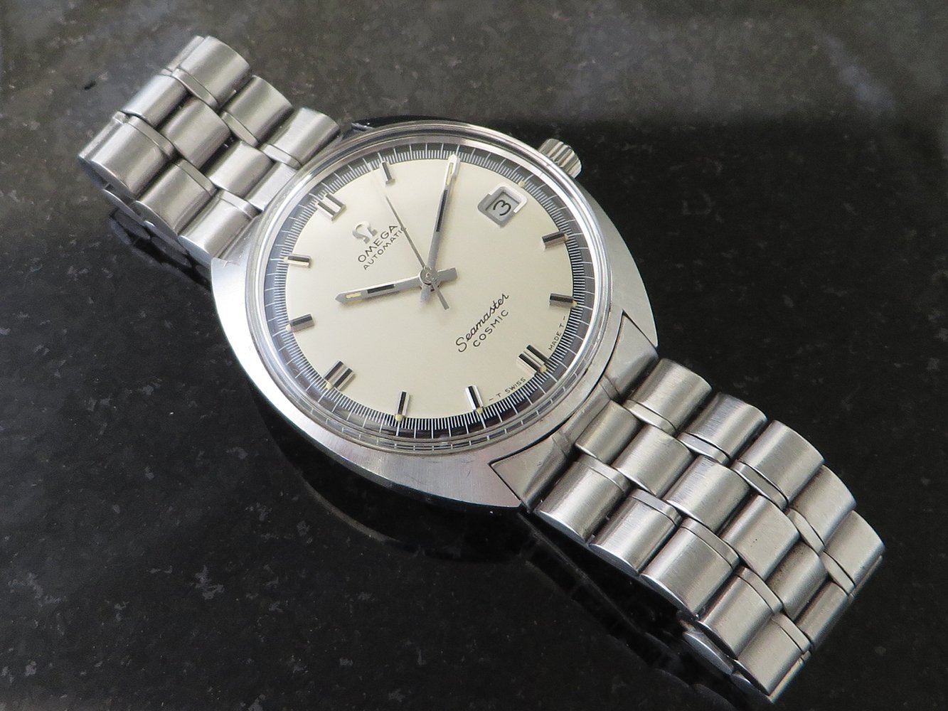

Here for reference is one I sold with the 1068/523.
1,193
6,193
I am pretty sure the one pictured is a 1098/526. I cross referenced several examples on eBay. It looks really great on that watch. I have found one and it is on the way. Thanks @Toishome
13,491
31,809
Oops, it would help if I cut and pasted the correct numbers. 😬
