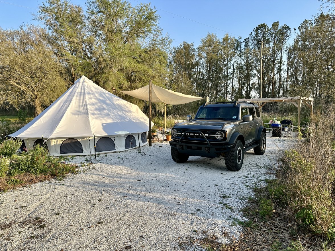

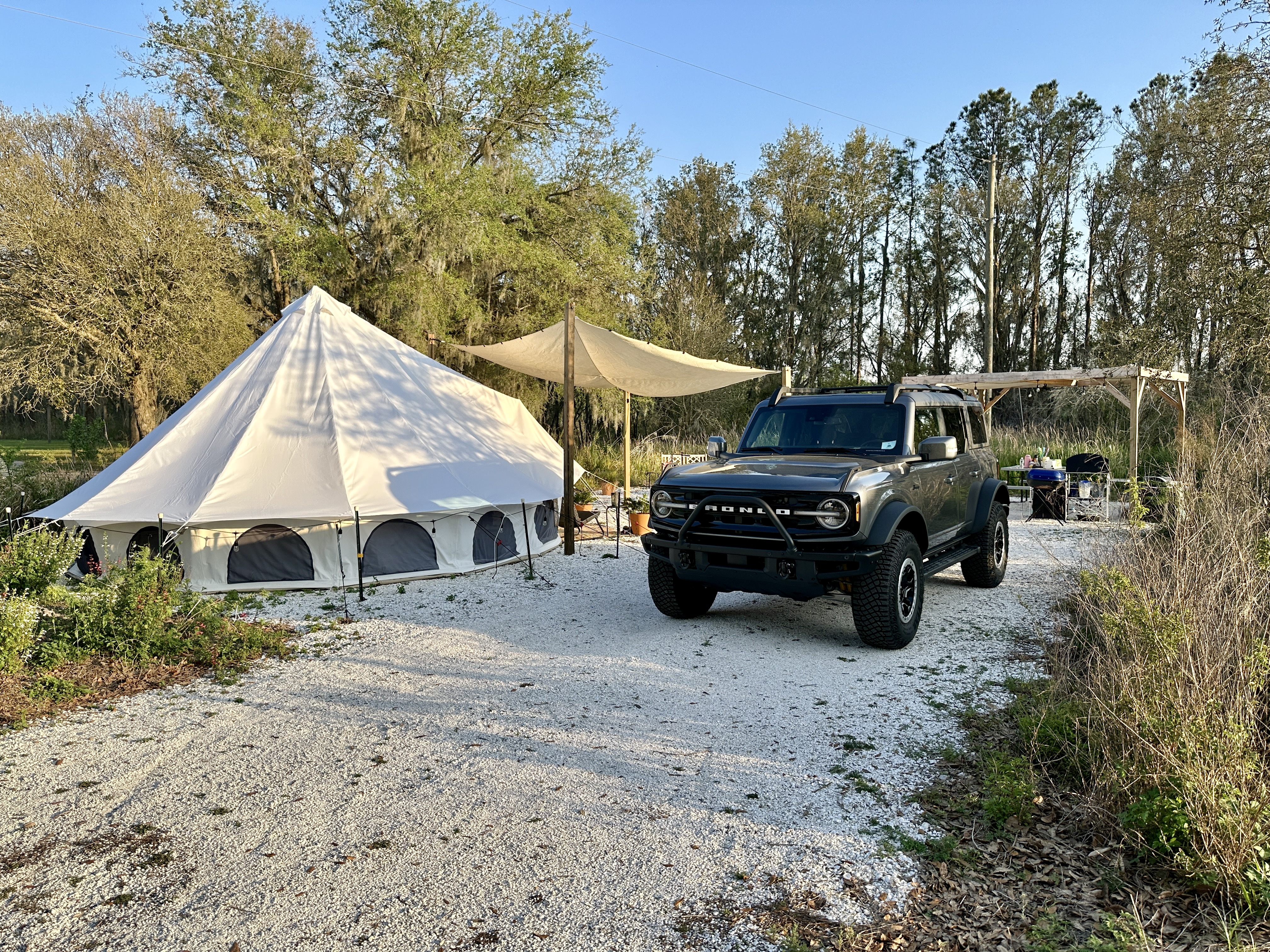

An ultra light tent, while spendy compared to other types of tents, costs so much less than a house.
As a current and former homeowner I can say, "Tents are The Way".
4,911
25,038
The family and I spent the weekend in a pretty nice yurt thing. I'd be down, but not sure about the rest of them...
