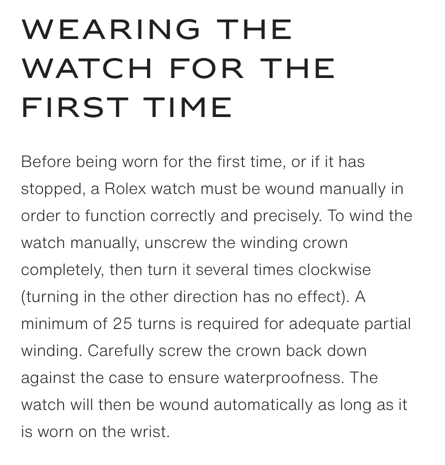

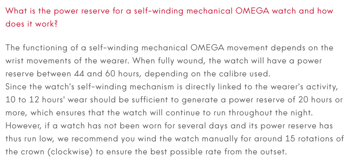

That's certainly your choice, but not consistent with how manufacturers expect their watches to be used. Here are the official instructions for Rolex and Omega, for example.
https://www.rolex.com/en-us/watch-care-and-service/caring-for-your-rolex.html

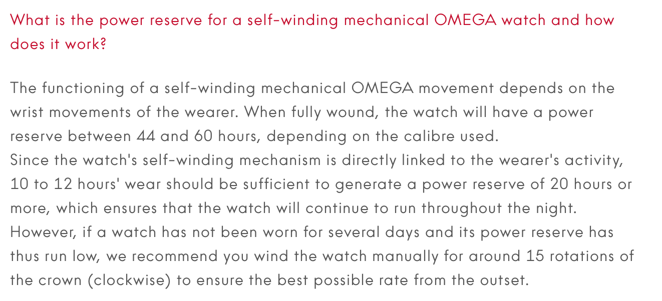

And the following from Omega FAQs.
I certainly understand the common recommendations. It would be inconvenient to advise someone to wear a watch for several minutes before setting it. This is just part of my ocd. If I ever saw compelling evidence that allowing the rotor to initially wind is more detrimental to the movement than hand winding, I would change my routine. To elaborate on this some more, another thing that factors into this decision is putting wear on the clasp and the locking tang by taking it off more often. (I also depress the spring pushers every time when closing the clasp to reduce friction)
