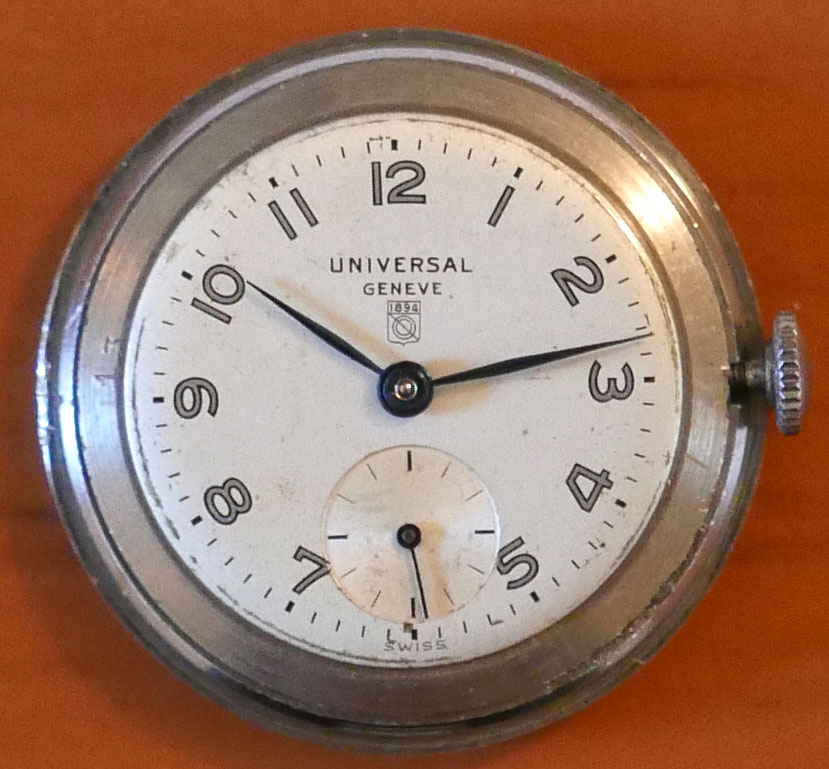

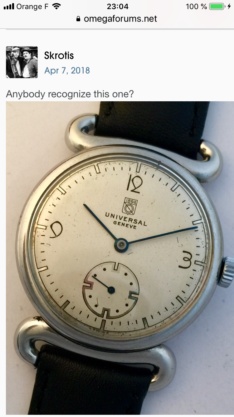

Reference and serial on these two please but without further research, I am very dubious about the second one you show. Almost certain it is a redial.
The abnormality is on dial, not crystal. Hoewever, as is often said, the proof is in the pudding so please show dial. Another way of proving this one is to remove dial and take a pick of back of dial .... Is that an option.
ref on the first one is 212213, serial places it at 1945-46
ref on the second one is 28341 serial places it at 1945
Will include a closeup on the second below, I don't doubt the dial. This is a smaller sized ladies watch. I suppose it's possible someone redialed it back in the day, but it seems far more likely to me, just an uncommon dial. It think it's one of the nicest ladies UG I have come across.

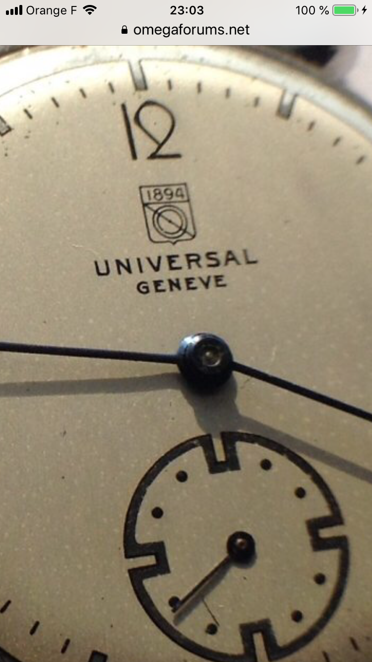

Getting back to the OP's watch, I don't think the shield is the relevant point, I think it's the rest of the details that have to be evaluated. If anything I think the shield makes it LESS likely to be a redial since it's one more detail that would have to be redone? I have come across so many of these shield logos before I never doubted them and didn't even realize others here had questions.
I won't claim to know for sure on the OPs dial but my gut says it's OK, so I would just enjoy it.....

Hmmmm.... at the risk of sounding smug this thread now seems to be further documented evidence for the proposition made above:
what I’ve seen on the one brand I explore the most is that people have trained their brains to recognize the most familiar and frequent patterns and when something’s unusual, they conclude it must be wrong.
And then in a number of cases, further research shows that the initial reaction was misguided- and that there were in fact variants.
After 80 years, certainly a great many watches must have disappeared and been destroyed— and so the emerging patterns are only the most widespread models.
With prices having increased as they have, I can understand people erring on the side of caution if they are buying— but otherwise new discoveries can be quite rewarding.

Interesting to note the logo was made in 1937 and OPs watch dates to (probably) 1938

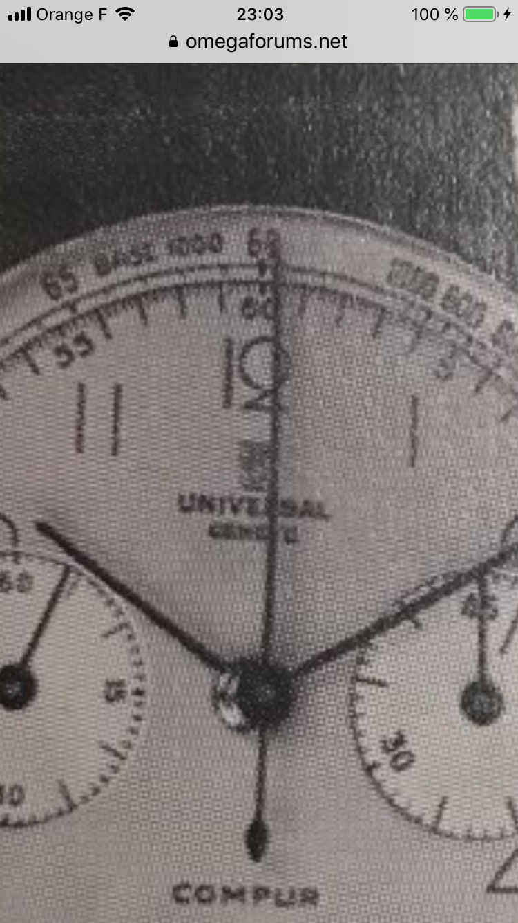

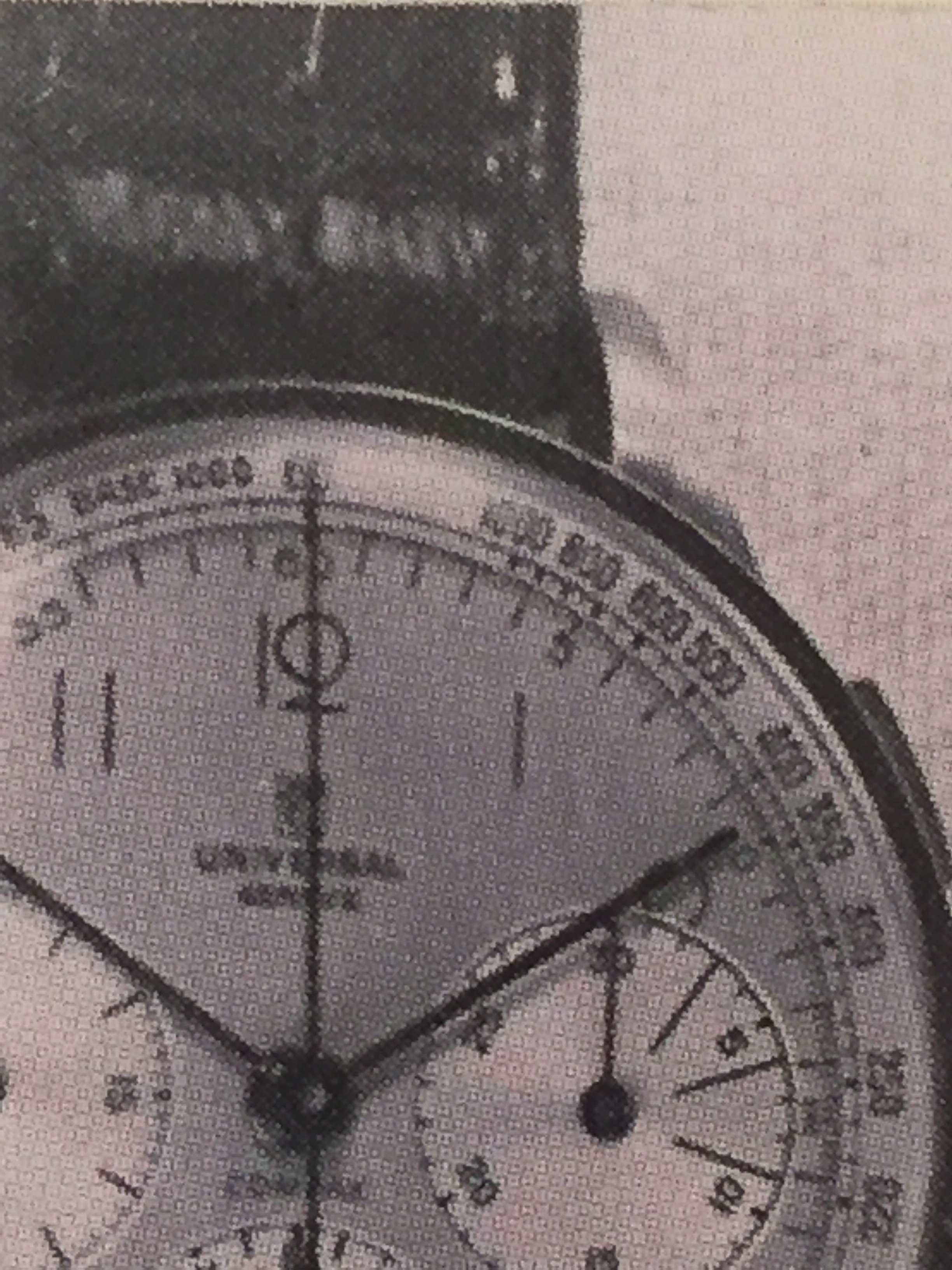

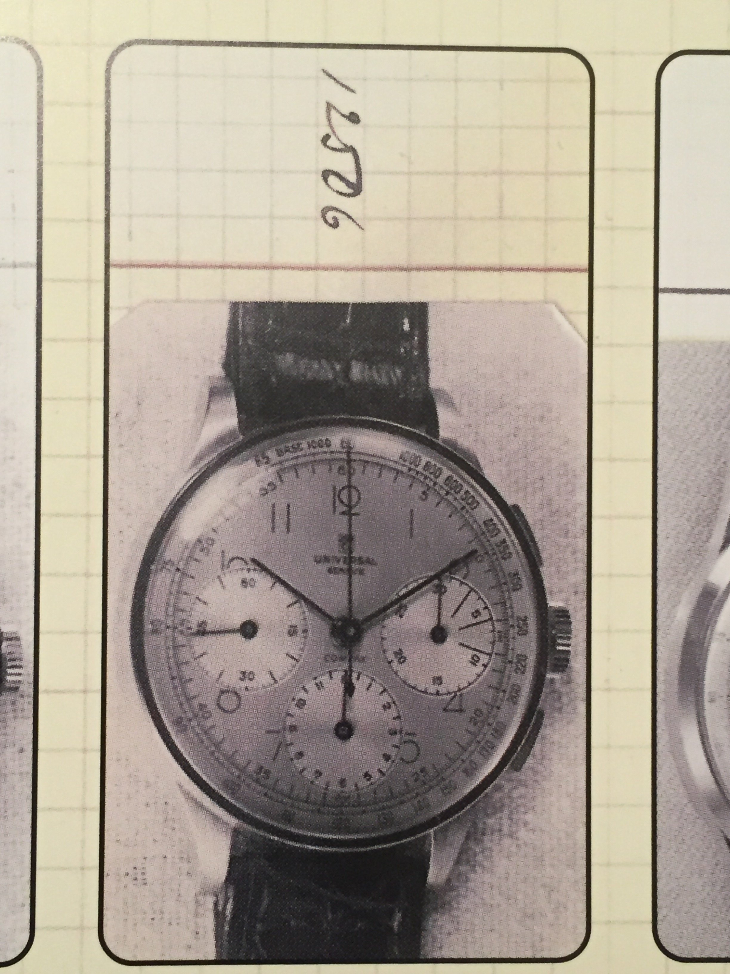

May I add those, “further documentation” found in another UG thread here about UG watches with deco numbers?
The beautiful scarab lugs is credit @Skrotis (with a few pending dibs including mine) - and the other is from the Sala archive repro, which @Florent posted to show the logo is documented in the archive (I’m enlarging it for clarification).
https://omegaforums.net/threads/universal-geneve-deco-numbers.70607/page-6
And then I found another logo one in Sala p. 291 (last two pictures).

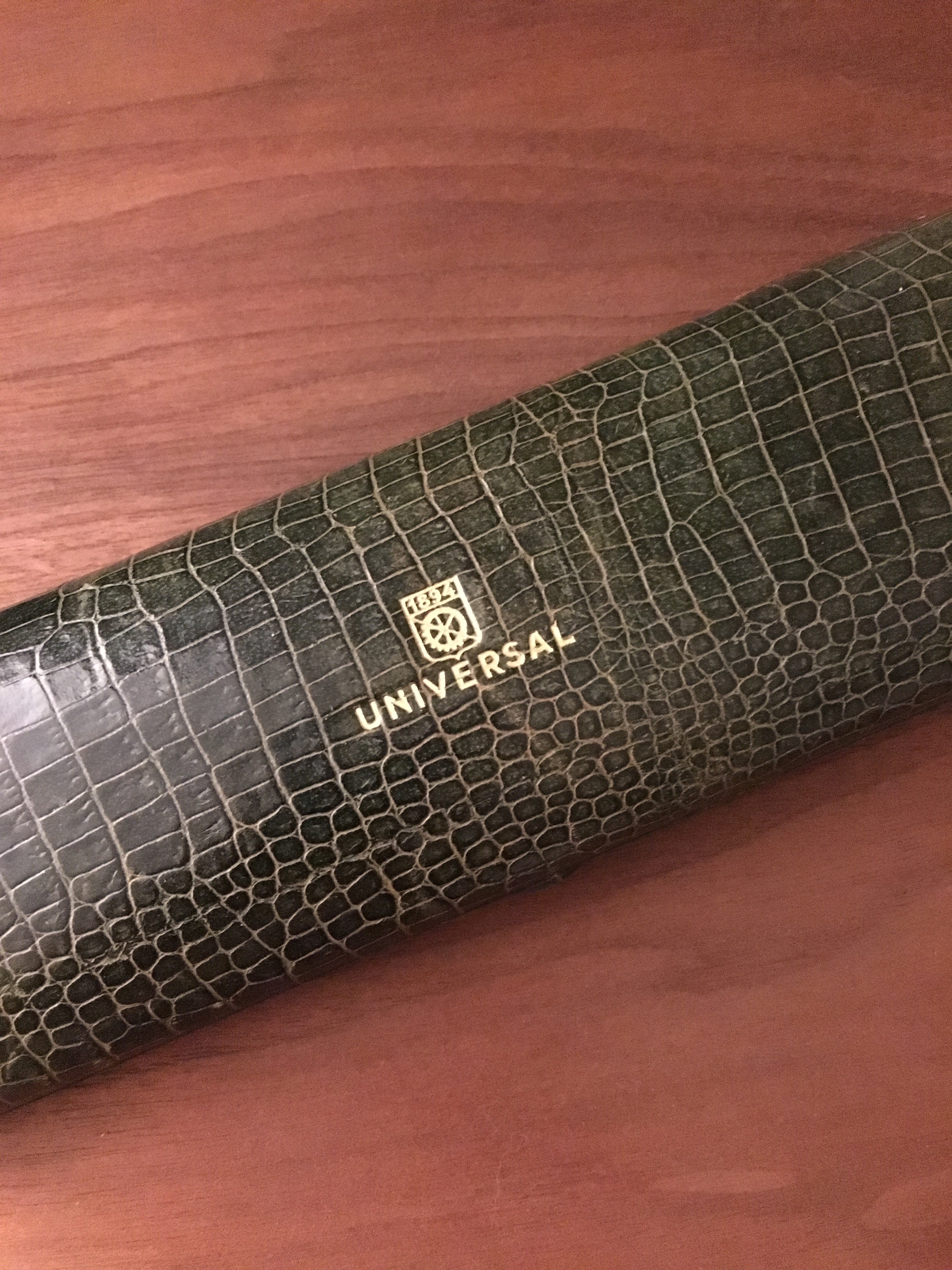

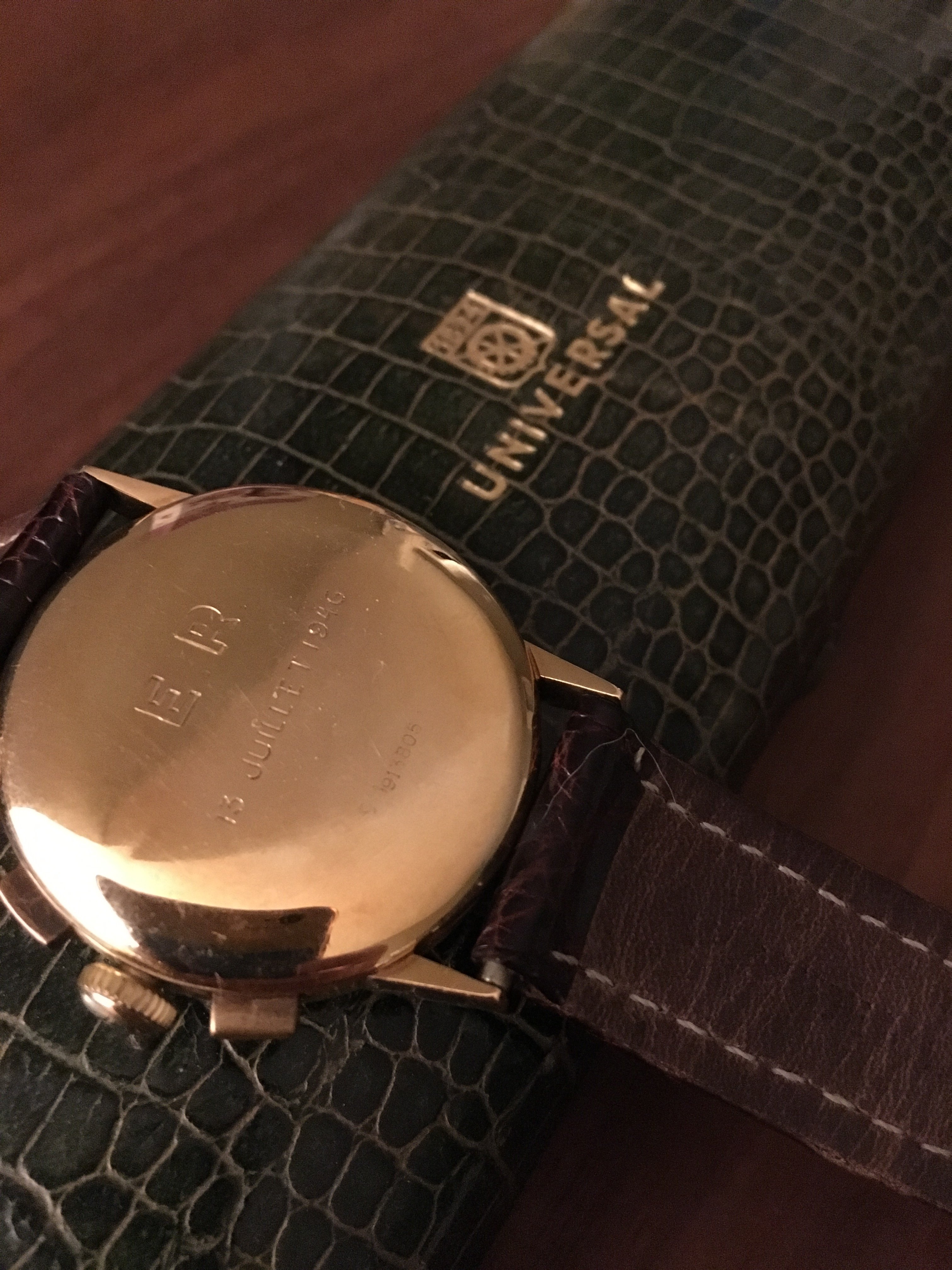

Here’s the original box that came with a Compax with a serial number dating it to1942-1943.
3,628
8,389
Wow. Epic box.

Very nice. More of that logo from Sala-could not see a date on the document though.

After reading the thread and looking at that dial, I would say 100% original piece. Congrats 😉
