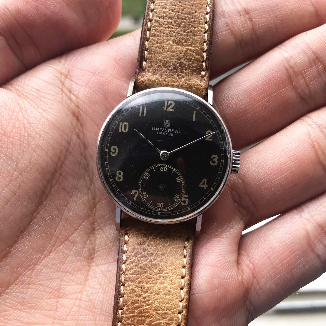

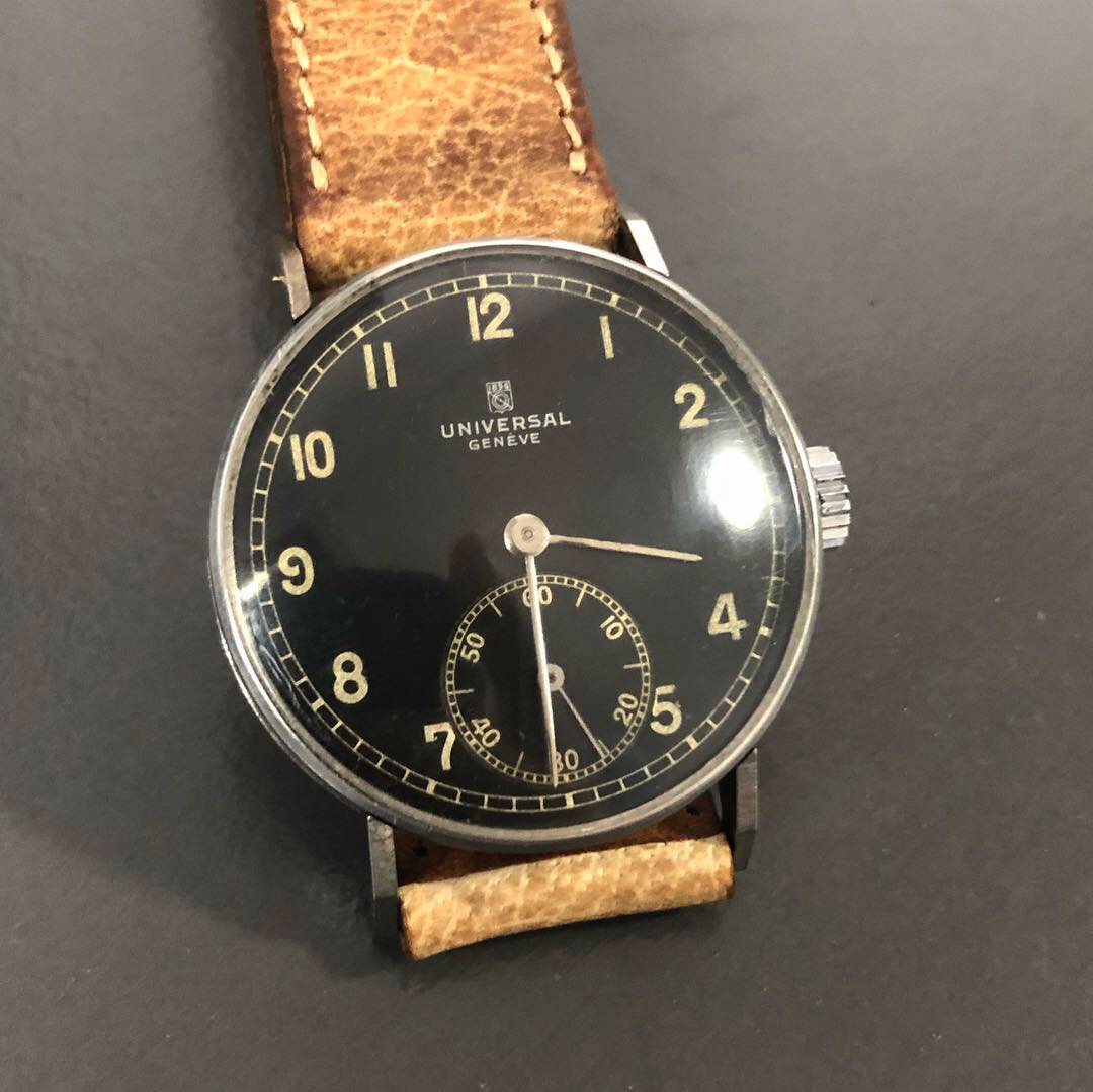

New watch always excites me. This time it is a Universal Geneve gilt dial with steel case. It has the old UG logo printed. My research tells me that this logo was used by UG sometime in 1937, which allows me to date this watch to somewhere in the 1930s. I have no expertise to open the case back, so there isn't any shot of the movement.
Anyway, here are the photos. I would be delighted if anyone has more to share about it.

Redial is my vote. Going back through the search function ...Logo on dial was a 50/60's thing.
1,175
3,011
Perhaps I am mistaken but I am always suspicious of watches with that logo on the dial. That style of logo is found inside case backs from 1937 to 1953 but I'm not so sure about dials.
I know that there is one example in Sala but the fact that there is just one example amongst the hundreds in Sala does little to convince me.

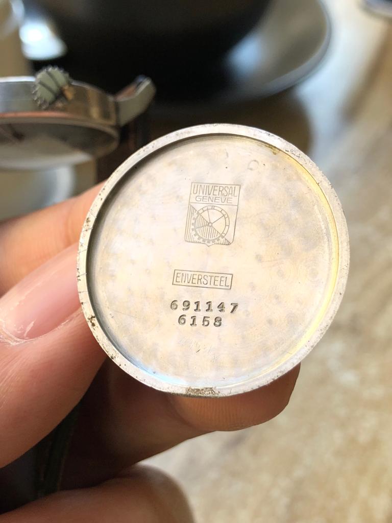

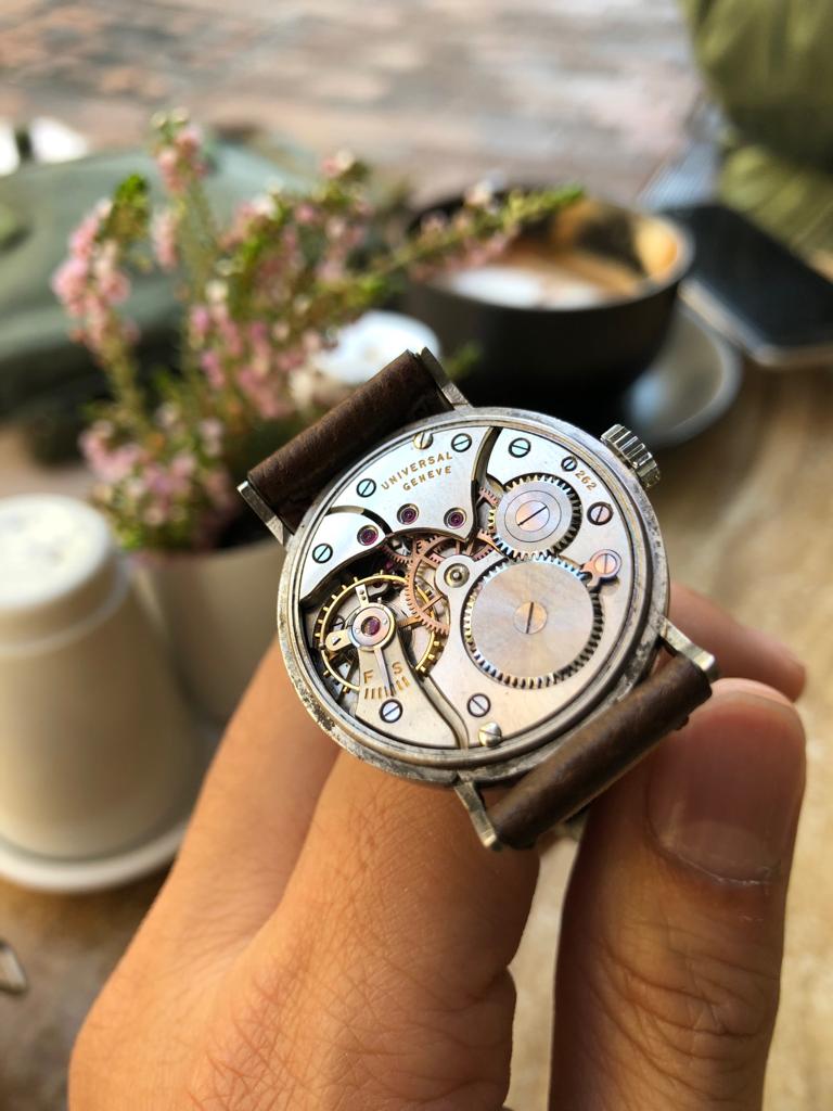

As requested. Here are the photos. That is all I have as these are from the seller. I still didn't manage to get the case opened myself

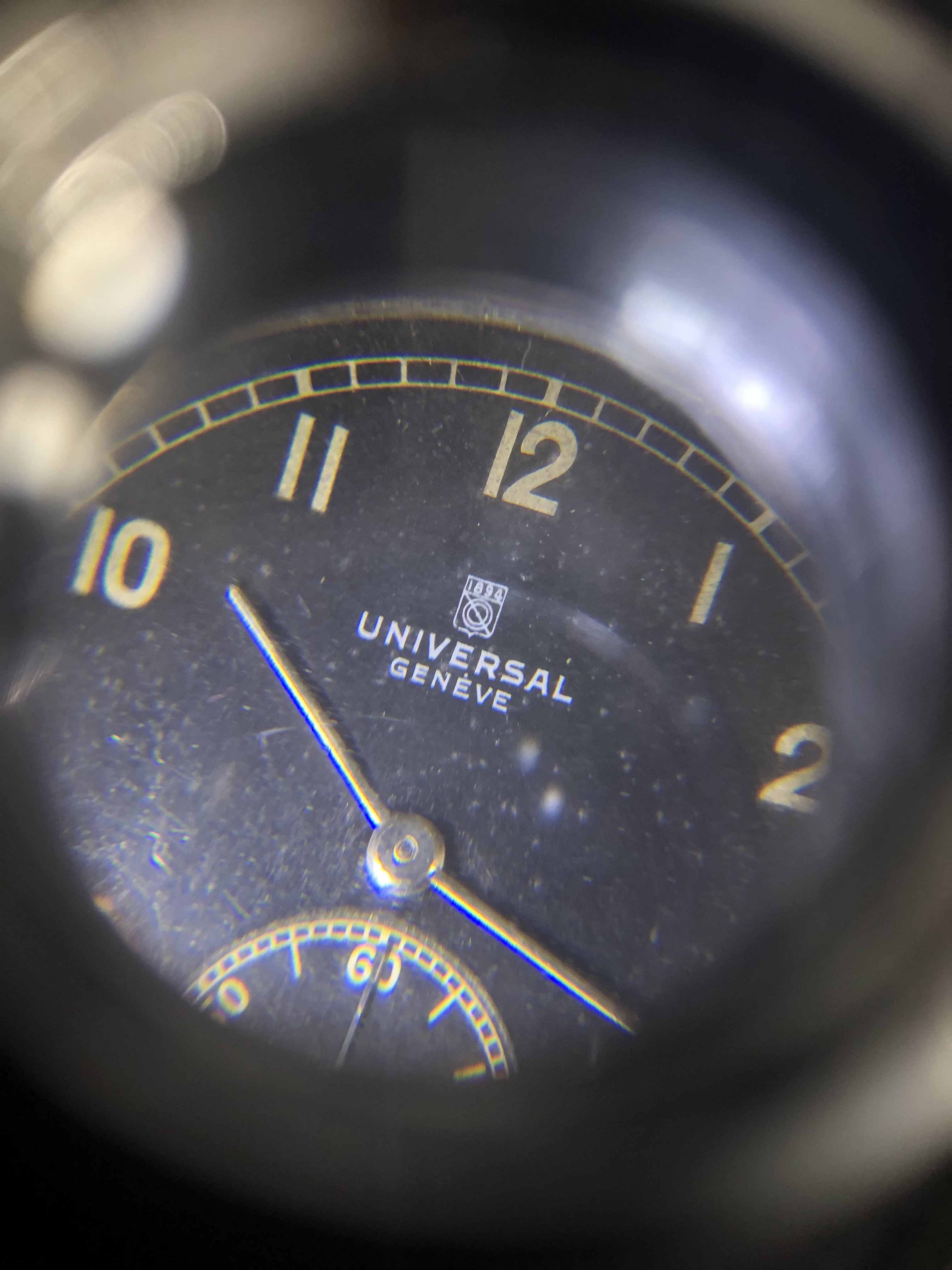

I am not remotely a UG expert, however, I do happen to have two cents to offer. I suspect that the dial is original, as it is not a recent production, shows good quality fonts, and it is difficult to imagine why a red-dialer would have gone to such lengths to produce a rather intricate logo that is typically not found on UG dials.
Also, given the relatively good condition of both the case and movement, why, many years ago, might a redial have been required?
9,595
27,670
I'll add that the seconds track is remarkably well done if it is a redial. Like Tony, I am not an UG expert in any measure.

Case is correct
However, dial is not. It is either a redial or a modified dial. Here is a catalogue image of the case and dial combination going back to late 30s which ties in well with the serial number.

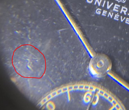

The dial tells a story. Looks like whoever prepared the dial did not do a very good job as there are still nicks and scratches on it. as nicks and scratches are painted, it would indicate to a serious quality control issue or a redial ...
I am going with the later!
