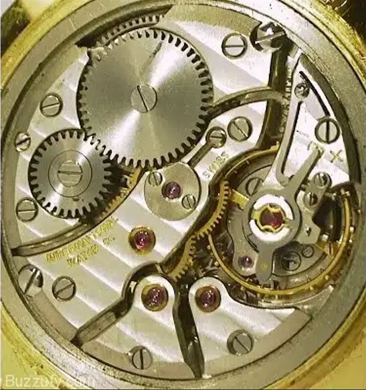

Does the watch have a fixed or mobile stud carrier? I don't know. I have attached a stock photo of the movement if it helps.
