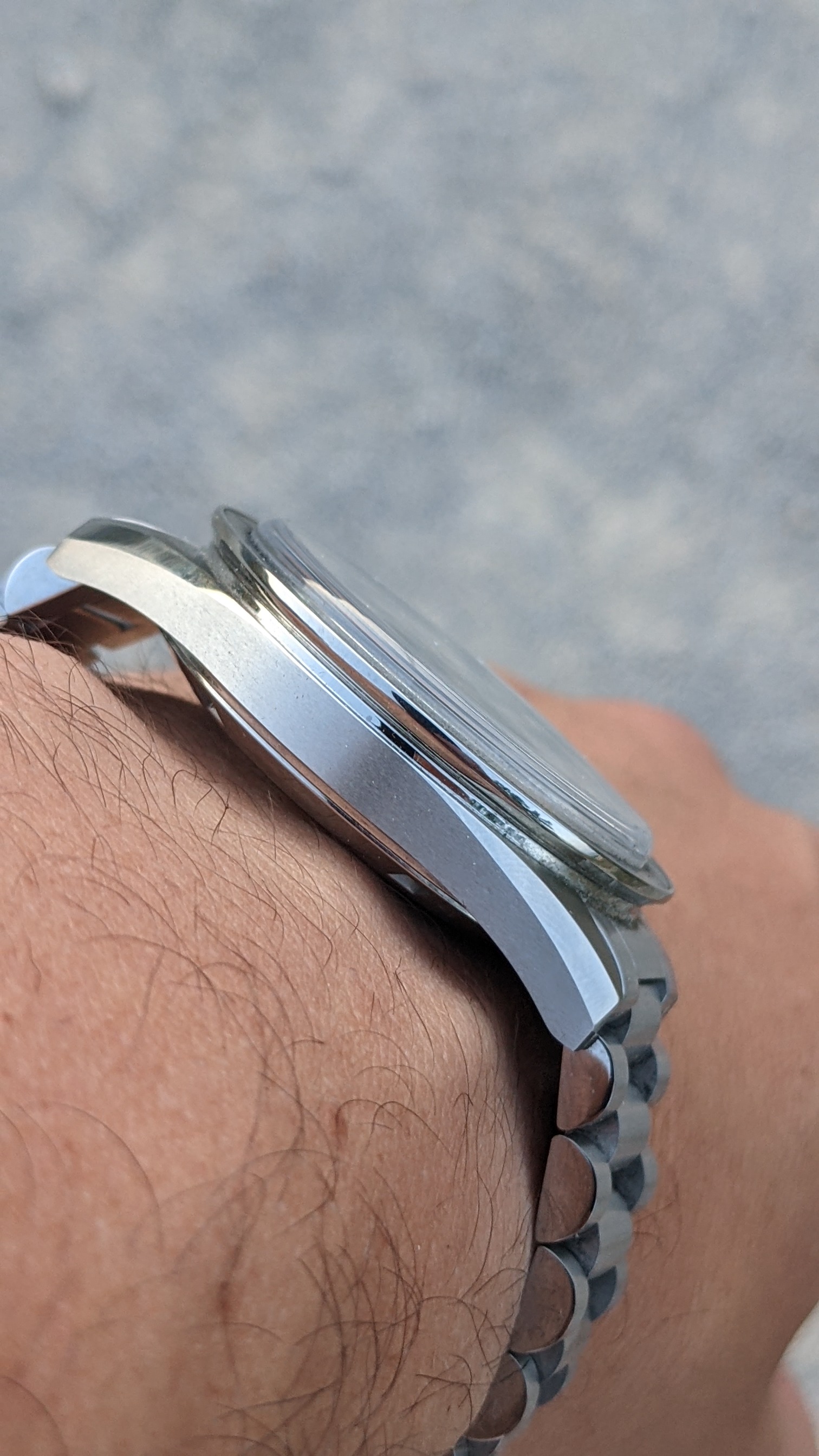

For me there's no turning back for a single vacuum test.
The difference is huge, now I find my Snoopy 3 uncomfortable in comparison to my (modified) FOIS.

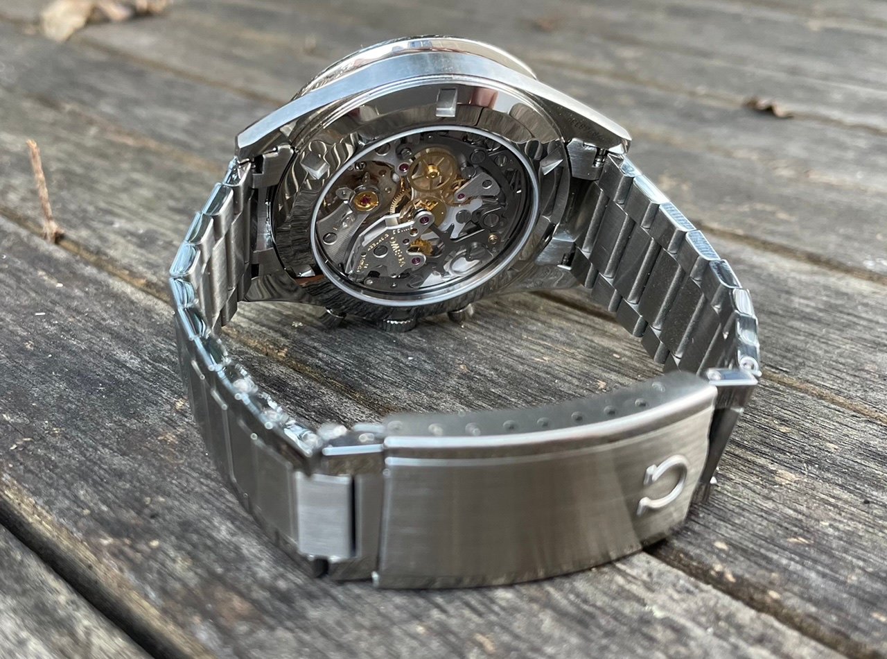

One you try on the thinner FOIS, you'll never go back. The caseback is game changer in terms of comfort.
Agreed. I think someone determined that the FOIS carried a greater proportion of its thickness in the caseback due to the deep engraving, with the Spiralwinder v2 shaving a full millimetre off the thickness. That alone is worth the price and when you add the visibility of the movement and the greater comfort from a smooth case back, it’s a no brainer.
I’m thrilled with mine.

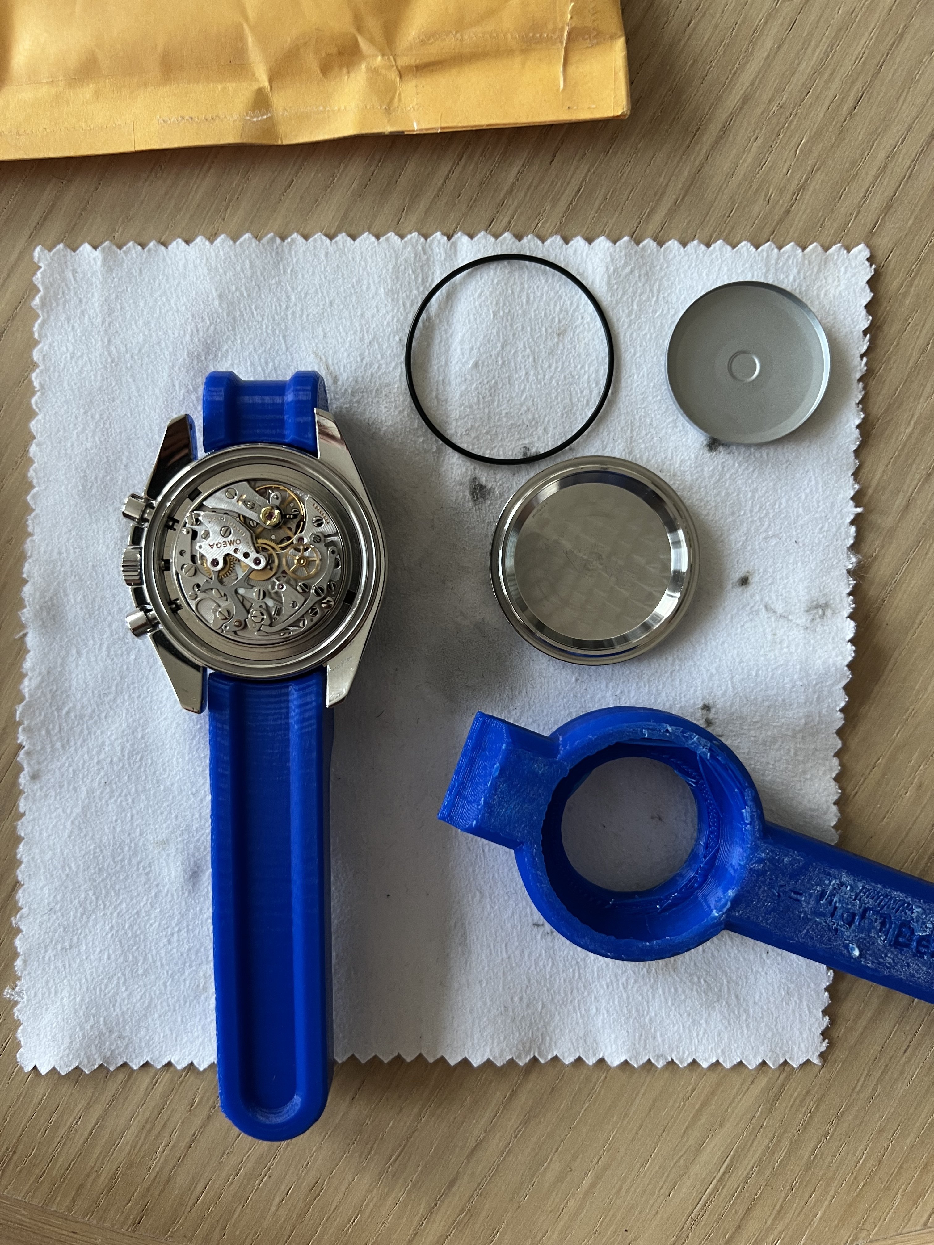

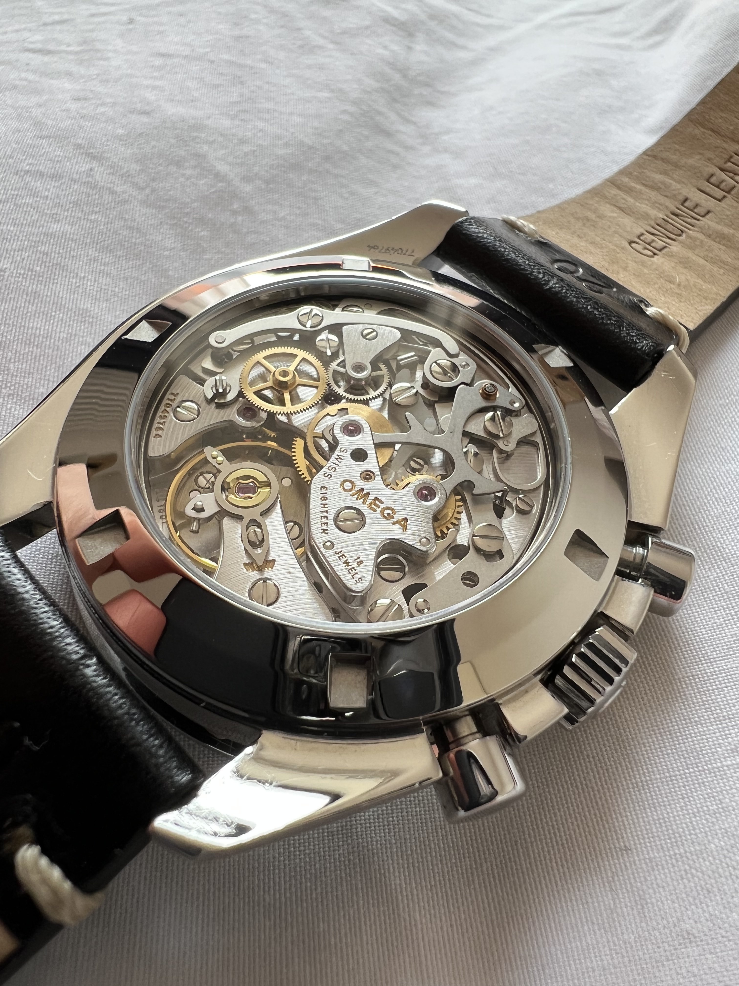

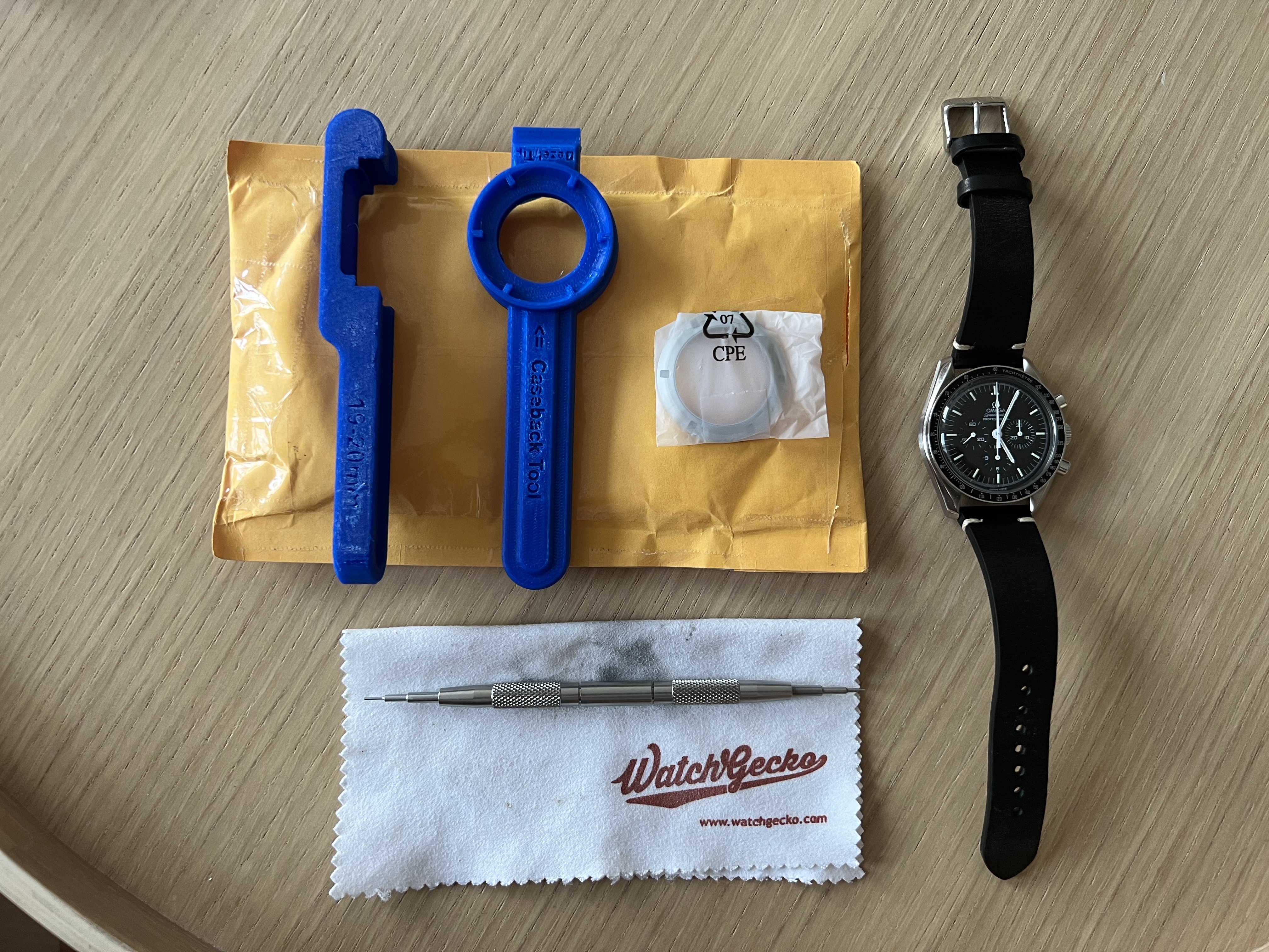

I’ve found this thread useful, so wanted to share my experience with Sprialwinder’s speedmaster display caseback.
Order placed 2 April, delivered to me in the UK on 13 April. The included 3D printed tools worked a treat, swapping the caseback from my 3570.50 was quick and painless.
I don’t have a timegrapher, but haven’t noticed any major deviations in accuracy over the past few days of wear. It hasn’t been pressure tested, but it’s never been the watch I wear daily or take near wear, so I’m not really concerned.

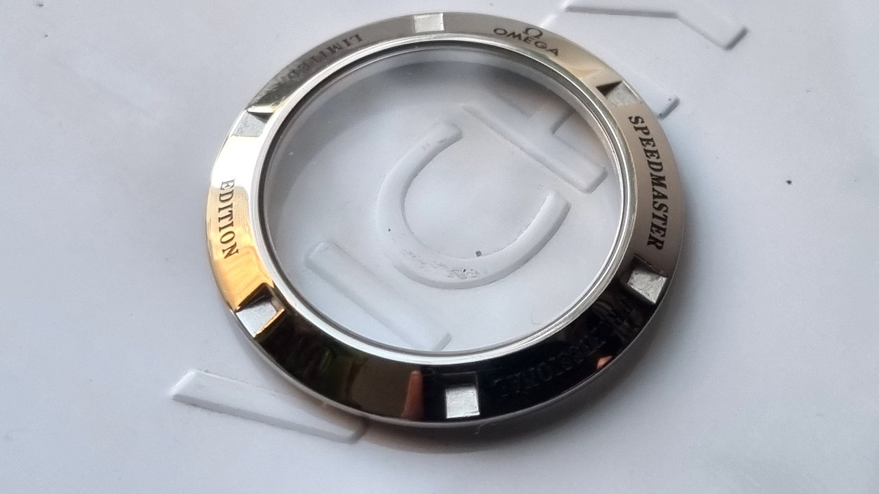

This is the case back I have, it's an original Omega I bought from OFREI back in 2003:
The story of reducing the height is a new thing. When I got the case back it was just to be able to see the movement.
I also have a CK-Pulse, and I tried a couple of days ago to install the sapphire case back just out of curiosity. And it did NOT fit.
I was pretty convinced that the CK2998 had exactly the same case as the FOIS, but maybe it is not the case ?
I measured the thickness of the case backs and the sapphire one is a good 0.5 mm thinner, but the outside diameter of the threaded portion is about 0.5mm larger than the stock case back’s. So this is not a tolerance issue, it is simply different/not compatible.
This is strange, because I have used this sapphire case back on a standard Speedy Pro from 1999. And it did fit just fine. So maybe it’s the case of the CK that is not exactly the same ?
After this experience I would be concerned that the after market case back might not fit the CK either...

I'm pretty confident is the same case as FOIS. So it should fit the same.
