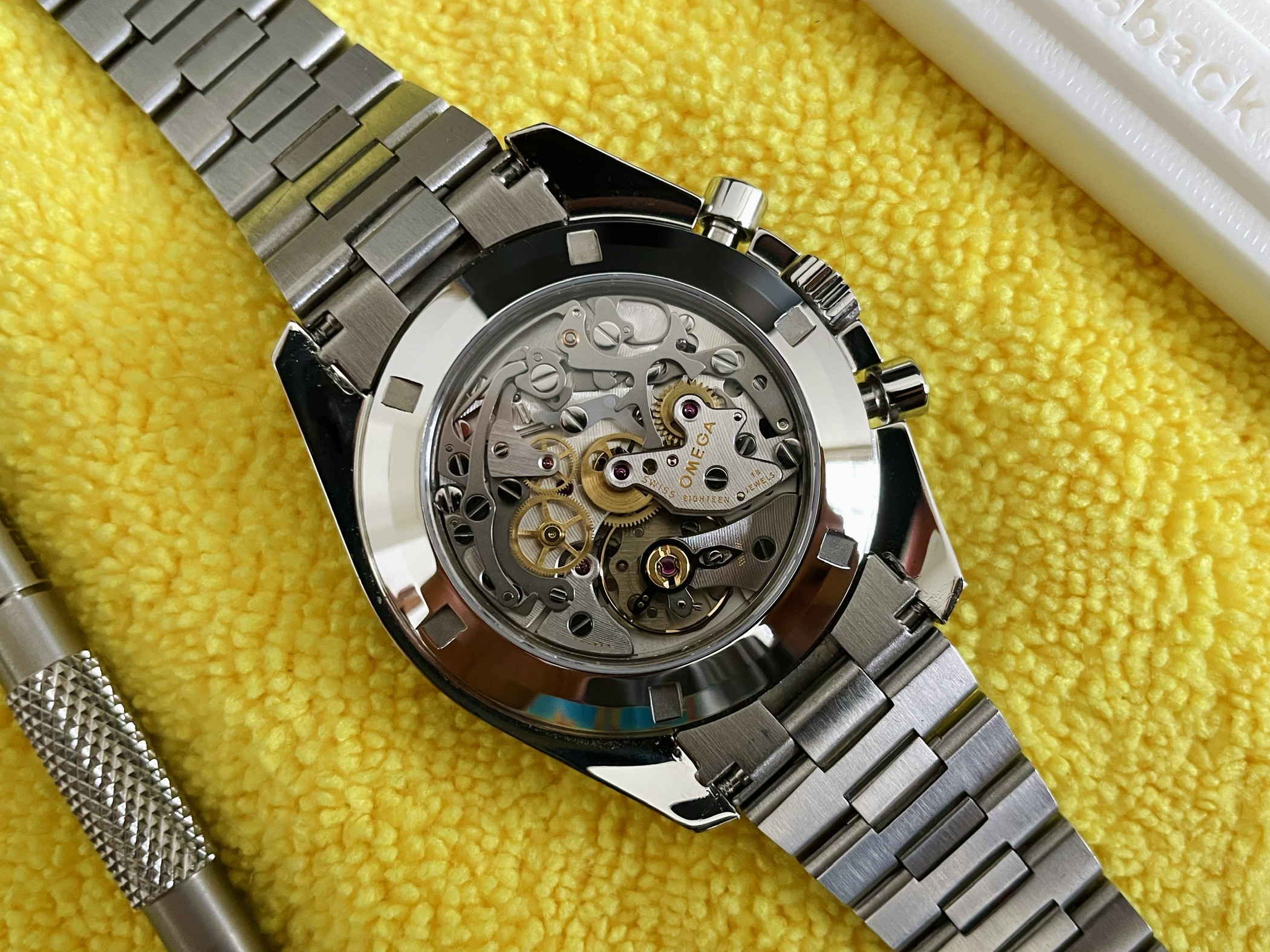

Yes, I am on the east coast. Hope it gets to you soon. Until then, here's a pic of mine to hold ya over:

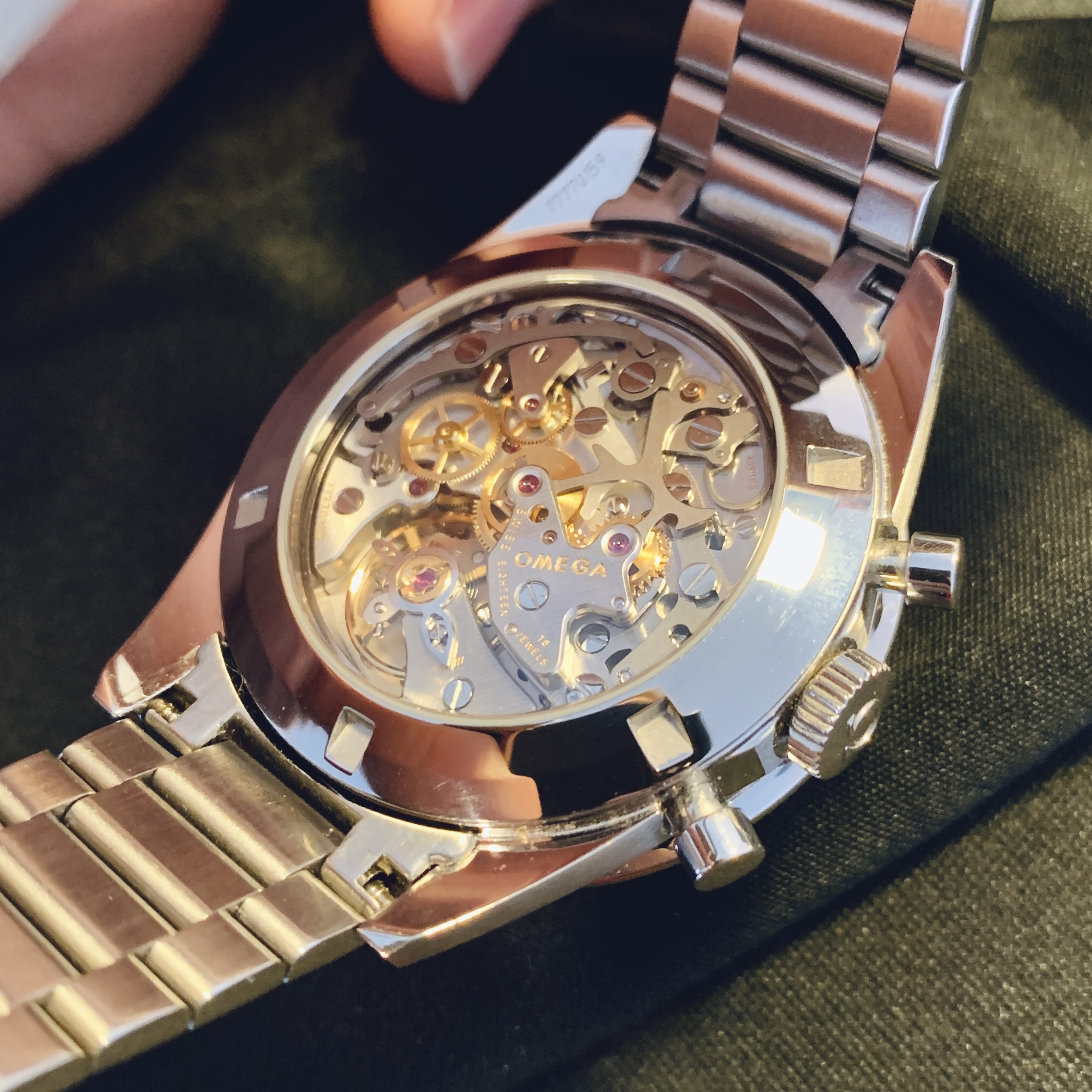

Mine arrived this morning, hurra! Ordered on the 6th Feb, delivered on 25th Feb, so 19 days or around 2.5 weeks to the UK.
Fitting with the supplied tool was super simple. That 1mm difference in case height really makes all the difference, so much more wearable.
