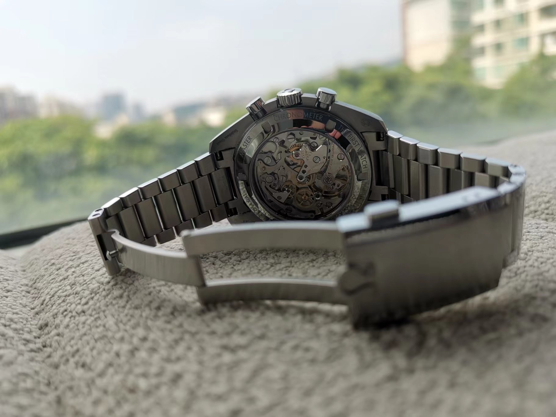

Well, I decided to take the plunge and order one for my 3861. It arrived crazy fast! The provided 3D printed case opener worked easily and painlessly. Installation took maybe a minute. The movement looks *super* close to the crystal, but I guess I'm hoping their engineers accounted for this. Watch now fits slightly closer on my wrist, not that that was ever really an issue for me. Regardless, the movement is beautiful and this is a pretty cool and easily reversible mod.

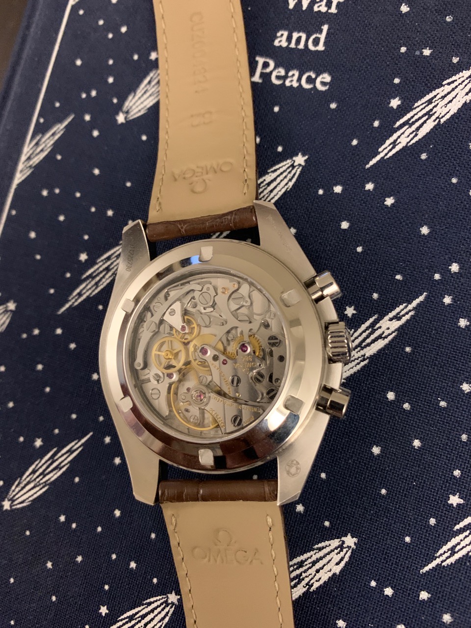

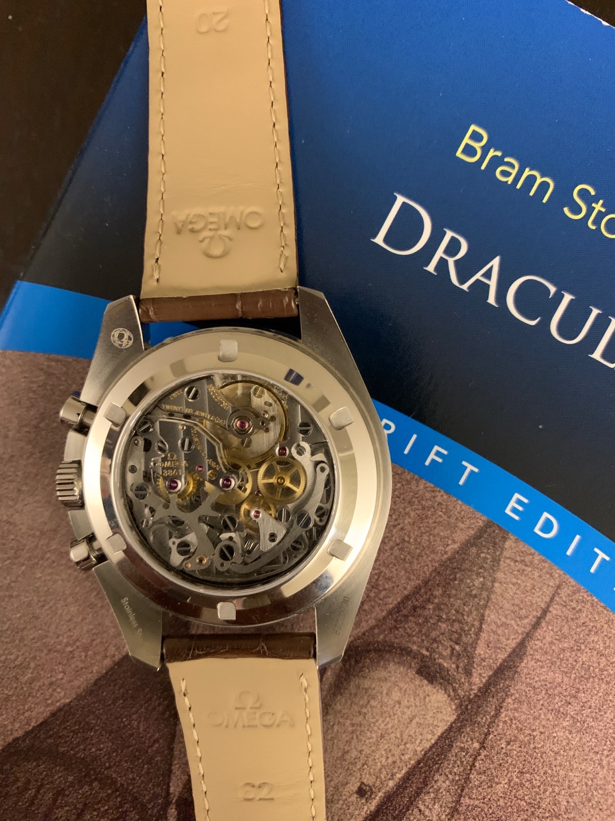

Received Spiralwinder caseback on Wednesday; had ordered on Saturday. I'm pleased by the product. Only minor critique is that the very high polish on the metal perimeter, combined with its sharp angles, really shines in the light and draws the eye away from the 3861 movement it's designed to showcase. The high polish was not an issue with Thomas Priek casebacks for the 1861, since the metal perimeter on that is convex and not angled.
For those in the Bay Area, the fellas at Geneva Watch Repair in the Shreve building did the caseback swap and had me in & out in 5 minutes. They also did a water resistance check and confirmed 5 bar.
I'm quite bad at photography, but here's how it worked out:

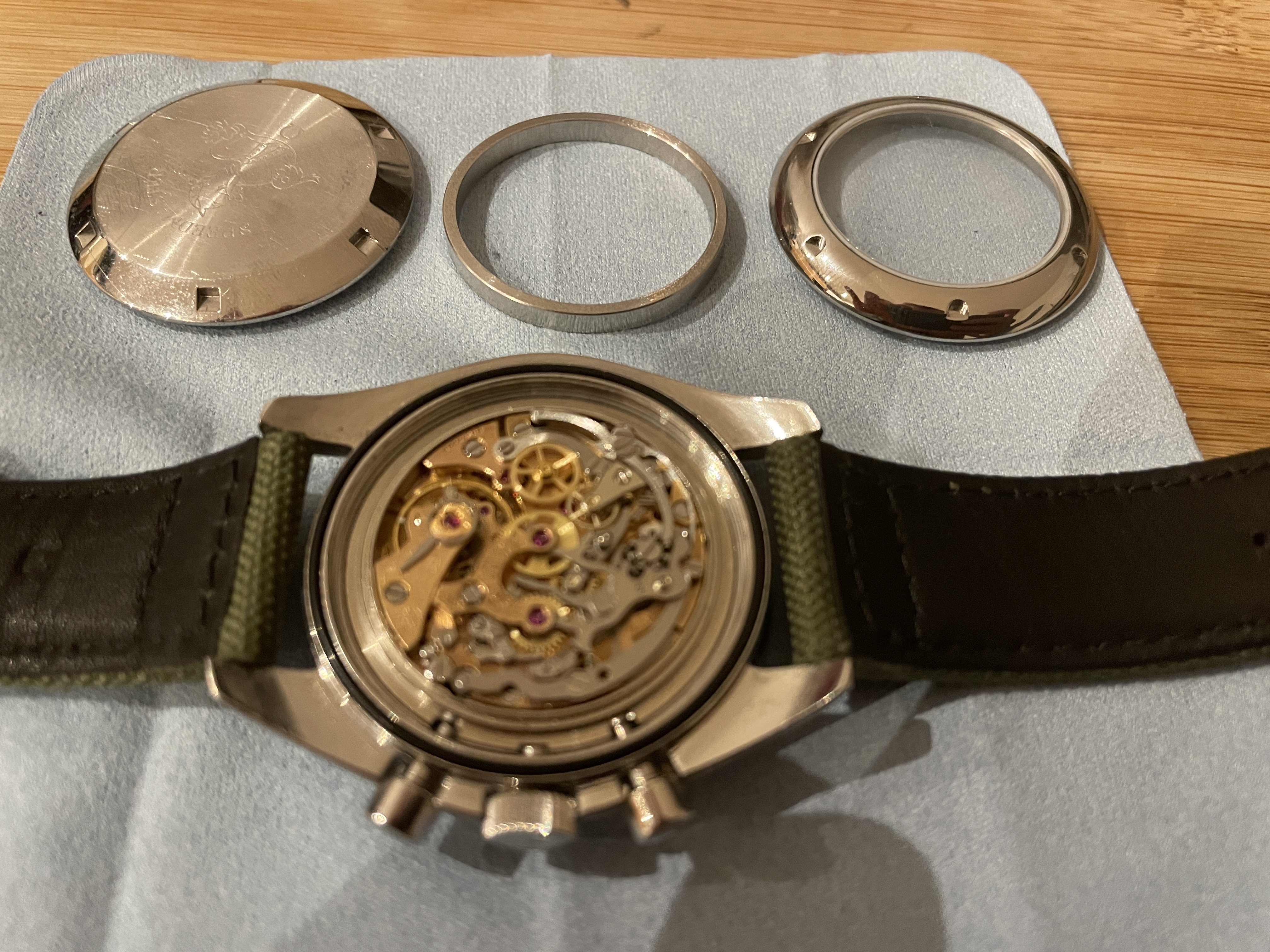

This thread helped to find a sapphire caseback for my 145.012. Thanks a lot! I just received a Preik and when I installed it and turned the watch, something is moving inside the case. It‘s either the spacer ring or the whole movement. Does someone have an idea what I did wrong?
30,326
78,262
The spacer is likely the issue - did they provide you with a taller one? If not, you may need to add an O-ring on top of it.
4
3
Thanks for the swift replay. It came with the one attached in the middle.
30,326
78,262
If I recall, sometimes his spacers aren't tall enough to keep the rattle from happening.
4
3
Alright, thanks. I will try and contact him to see what his solution might be. What kind of o-ring would I need in case he isn’t of any help.
30,326
78,262
Measure the OD of the spacer, and get one slightly smaller. Likely a 0.8 or1 mm cross section would work.
4
3
Just to give an update: I contacted him and he sent me a higher spacer in the mail that made the wiggle disappear.
