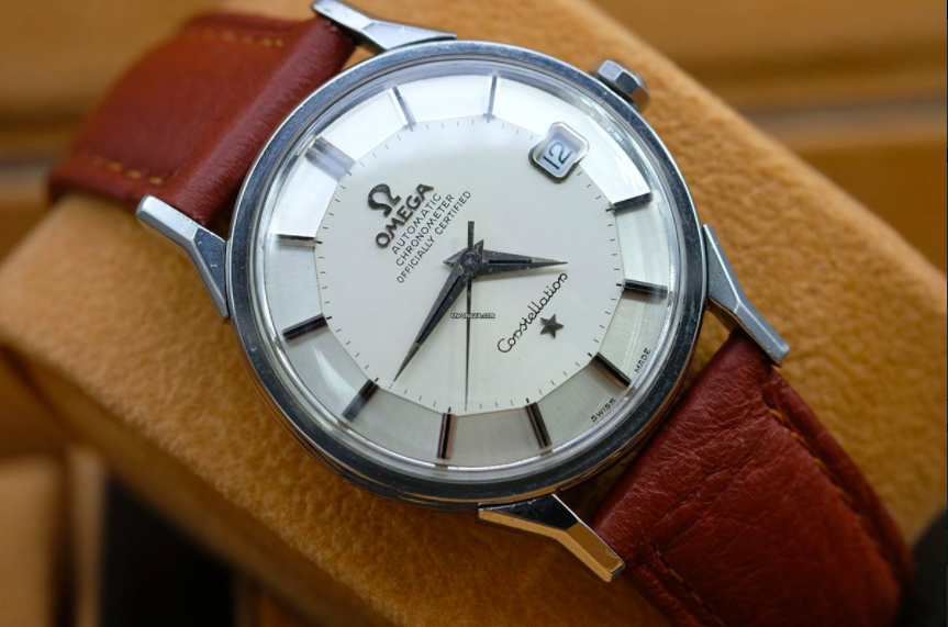

First post here. I've been looking for an Omega Constellation and I think I just found one on Chrono 24.
I'm new to this, but I give it a shot.
This is a Constellation Pie Pan with dog legs - Ref 168.005 - with a 564 caliber (quick set date).

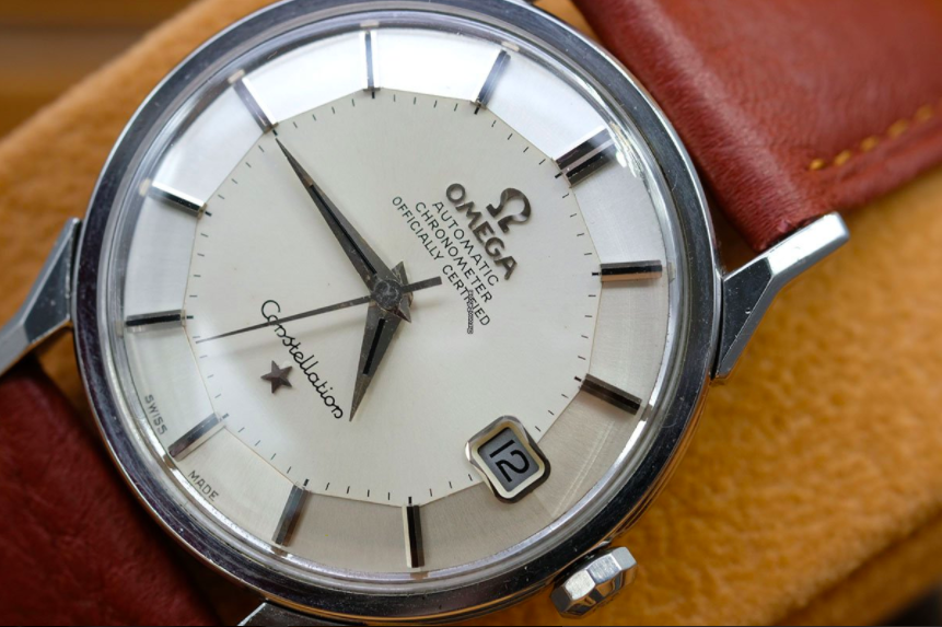

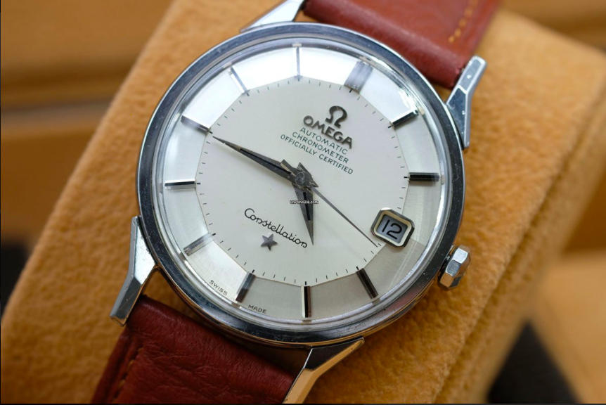

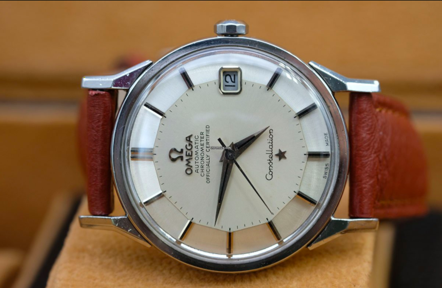

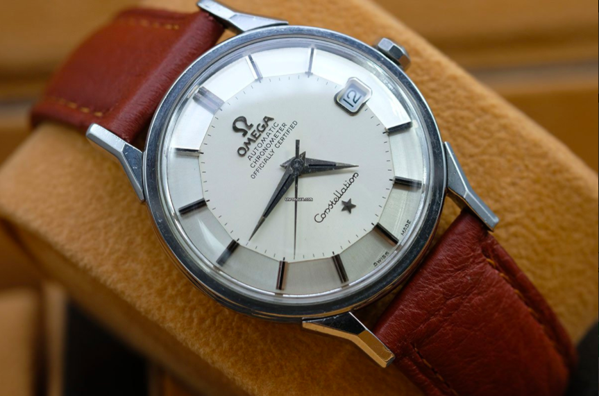

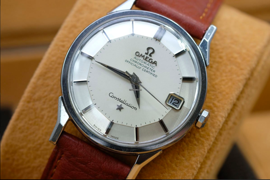

- The dial seems in good shape to me, original and non-refinished. The onyx markers and hands seems good also. I'm just wondering about the "Swiss Made"...

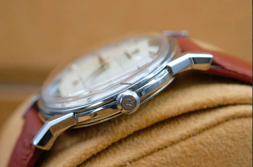

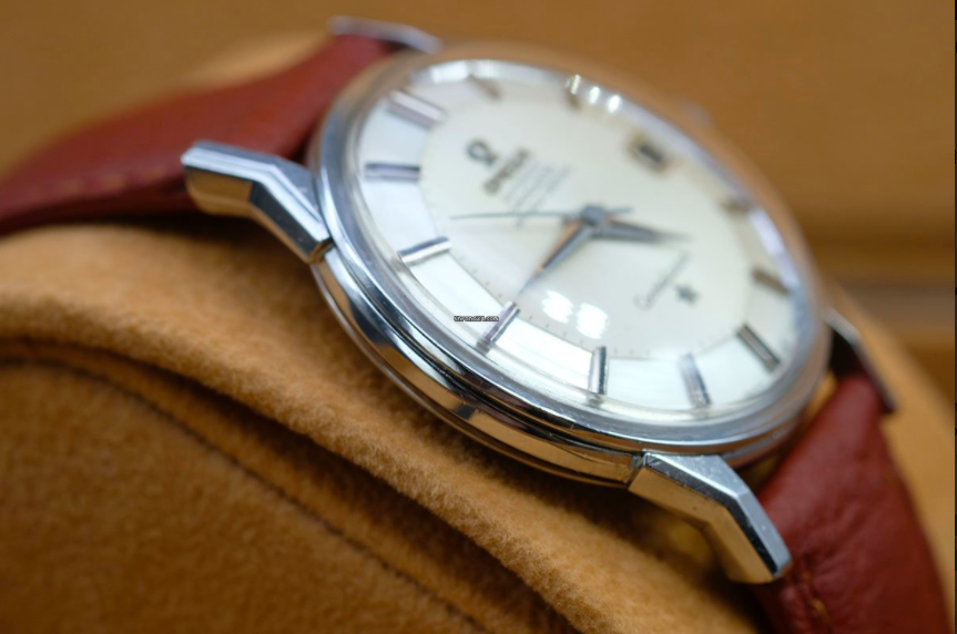

- The case looks in good condition with sharp lugs and only few scratches.
- The crown is original and in nice condition
- Band and buckle are generic

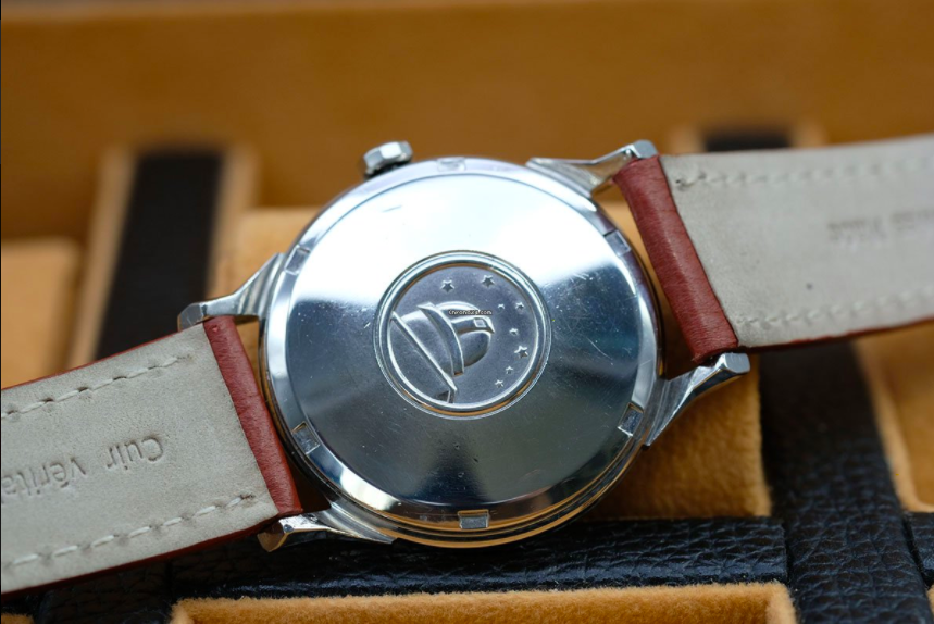

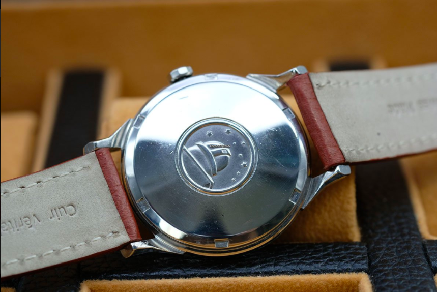

- It lack a photo of the inside of the caseback, but I will ask the seller to verify the ref 168.005

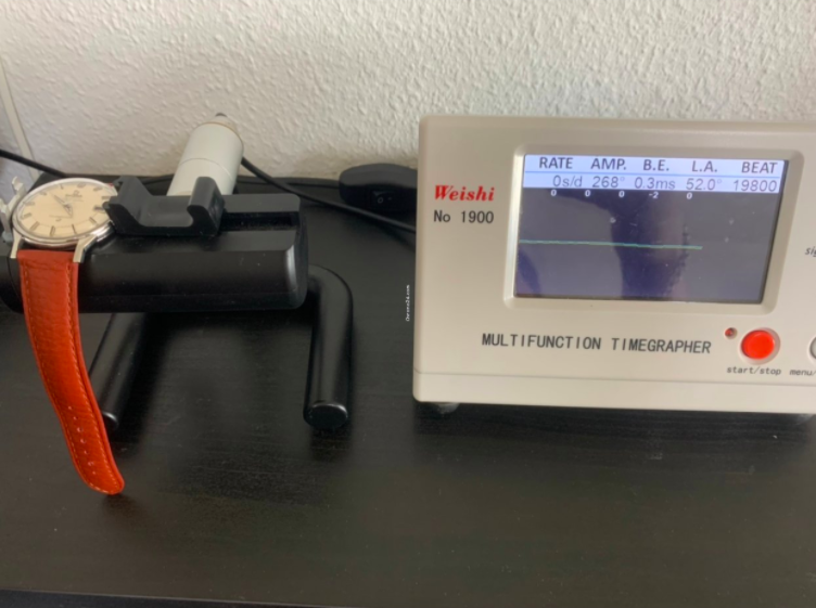

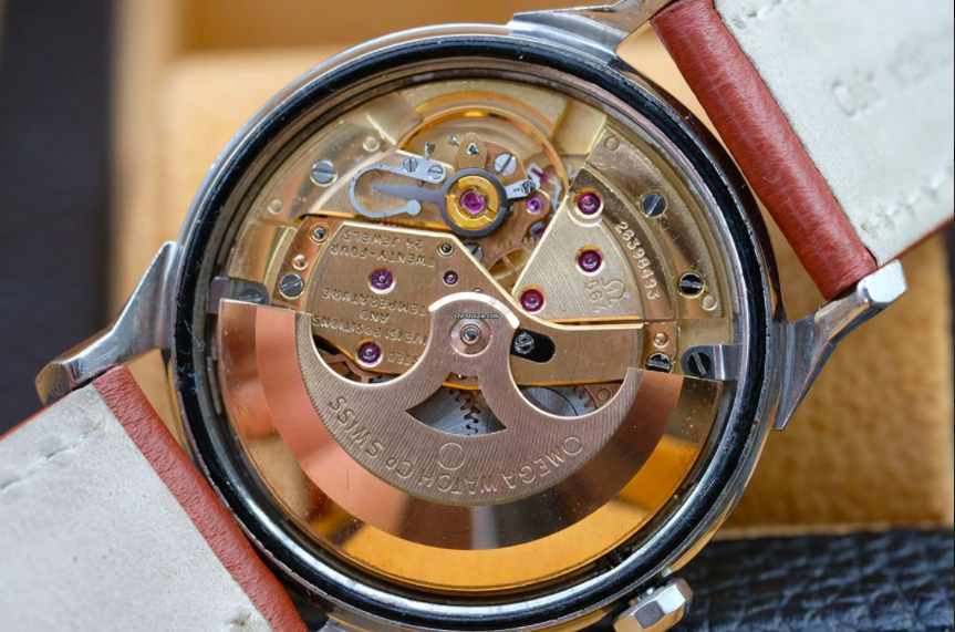

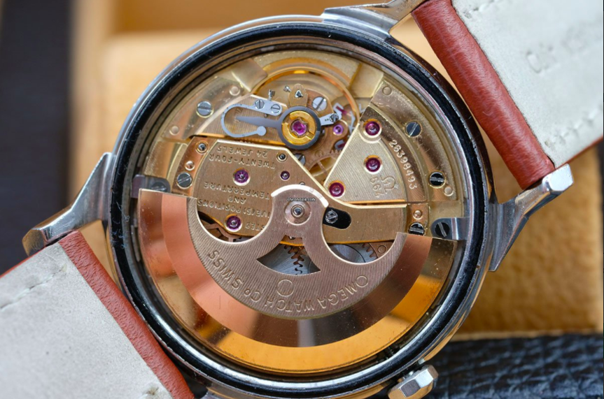

- The watch has been serviced in March - no paperwork, but a 6-month warranty is provided. The movement is clean and marked 564 that corresponds to the correct caliber
The price is 1600 euros, a bit high, but the watch seems in really good condition.
Did I miss something here ?
Please feel free to correct me and tell me if I'm wrong about this watch as you are the experts.
Thanks you for your advices

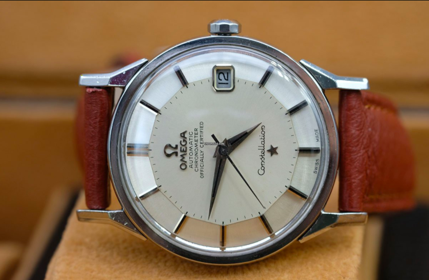

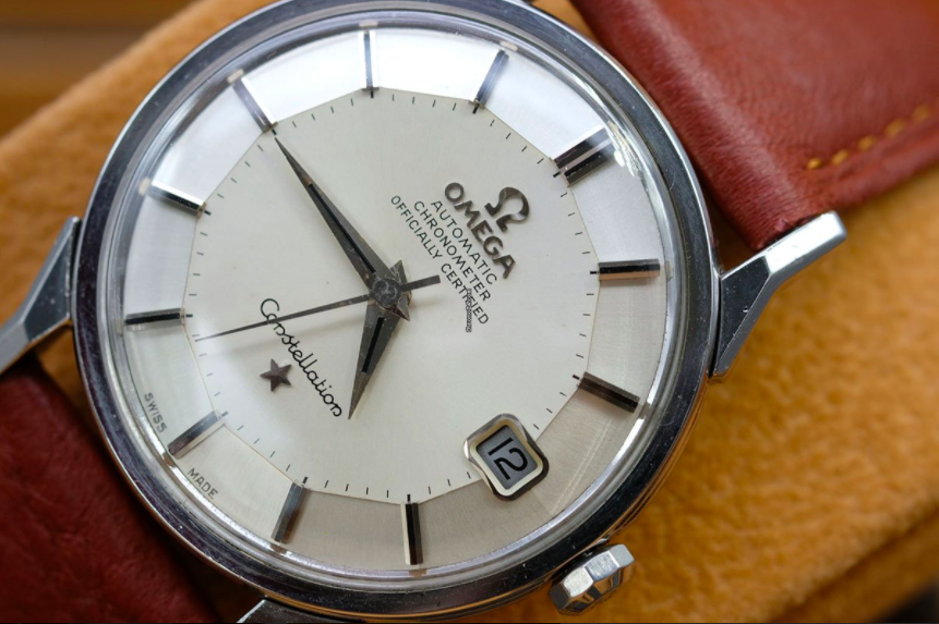

Are you sure they are black onyx inserts? Looks like black painted to me.

I think the watch and the dial is stunning. The rotor might have been changed. Let´s here som more opinions...
Yes, I made a mistake. You are right

The six o'clock marker is starting to fade, I think.
I think it's the reflection because on the 1st and 6th photo, it looks fine

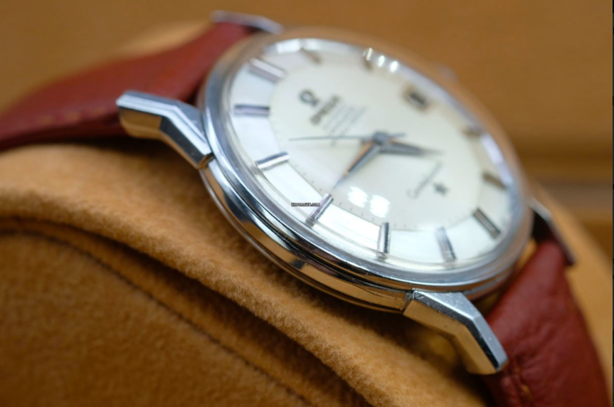

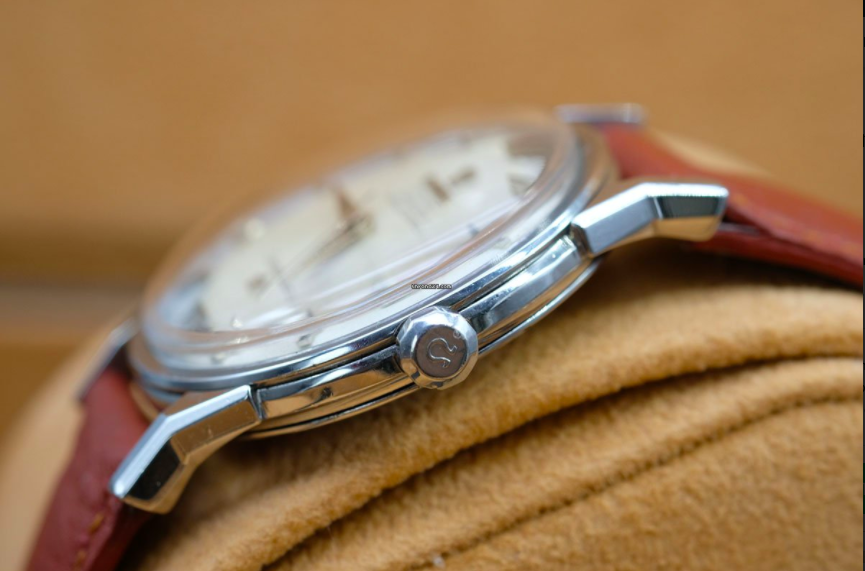

The watch is in great shape, just wondering about the facet on the upper side of the lugs, it looks wider than usual, but still great dogleg.
Price is really good for the European market in my opinion, especially while sold by a professional with warranty...
