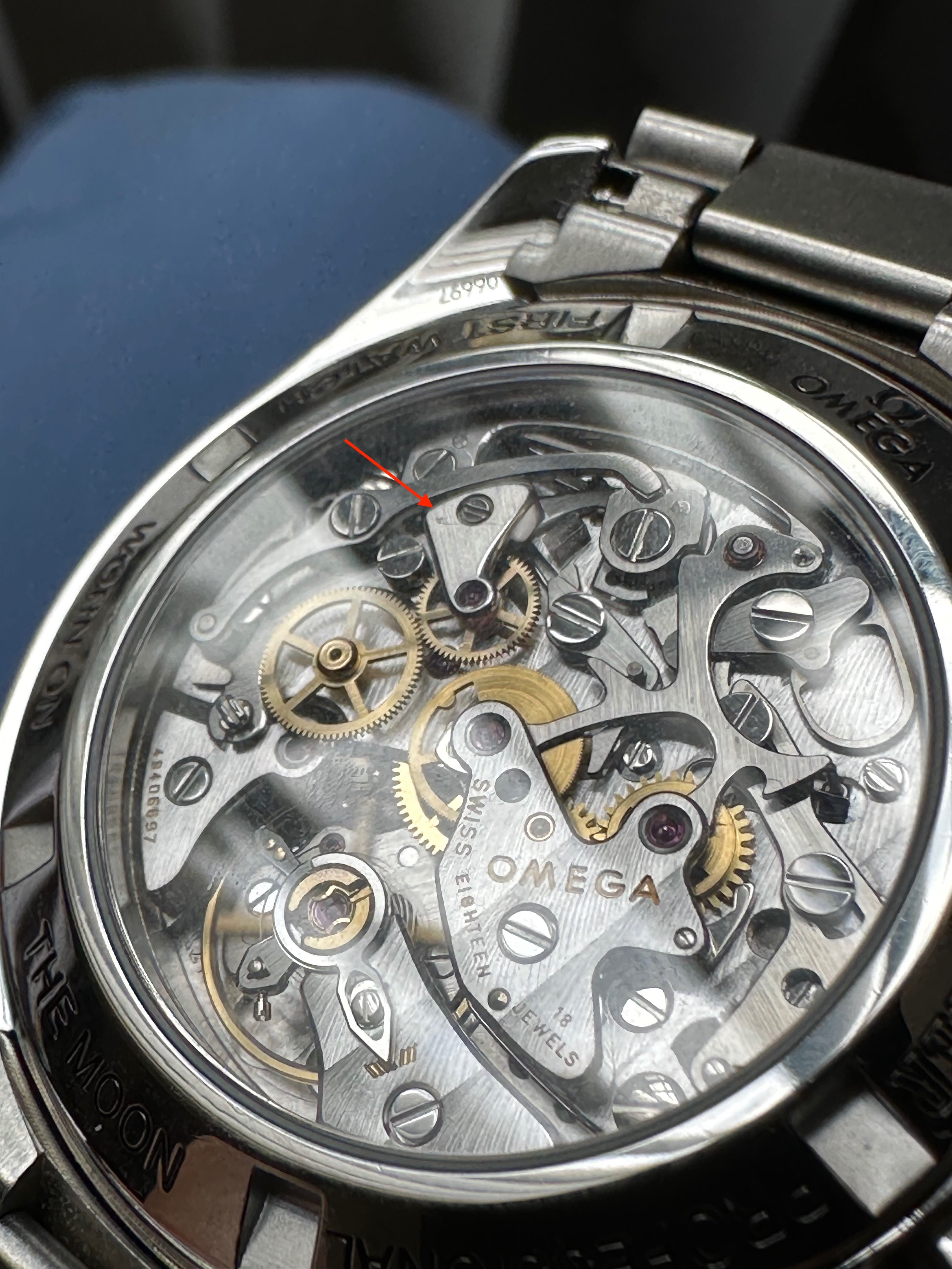

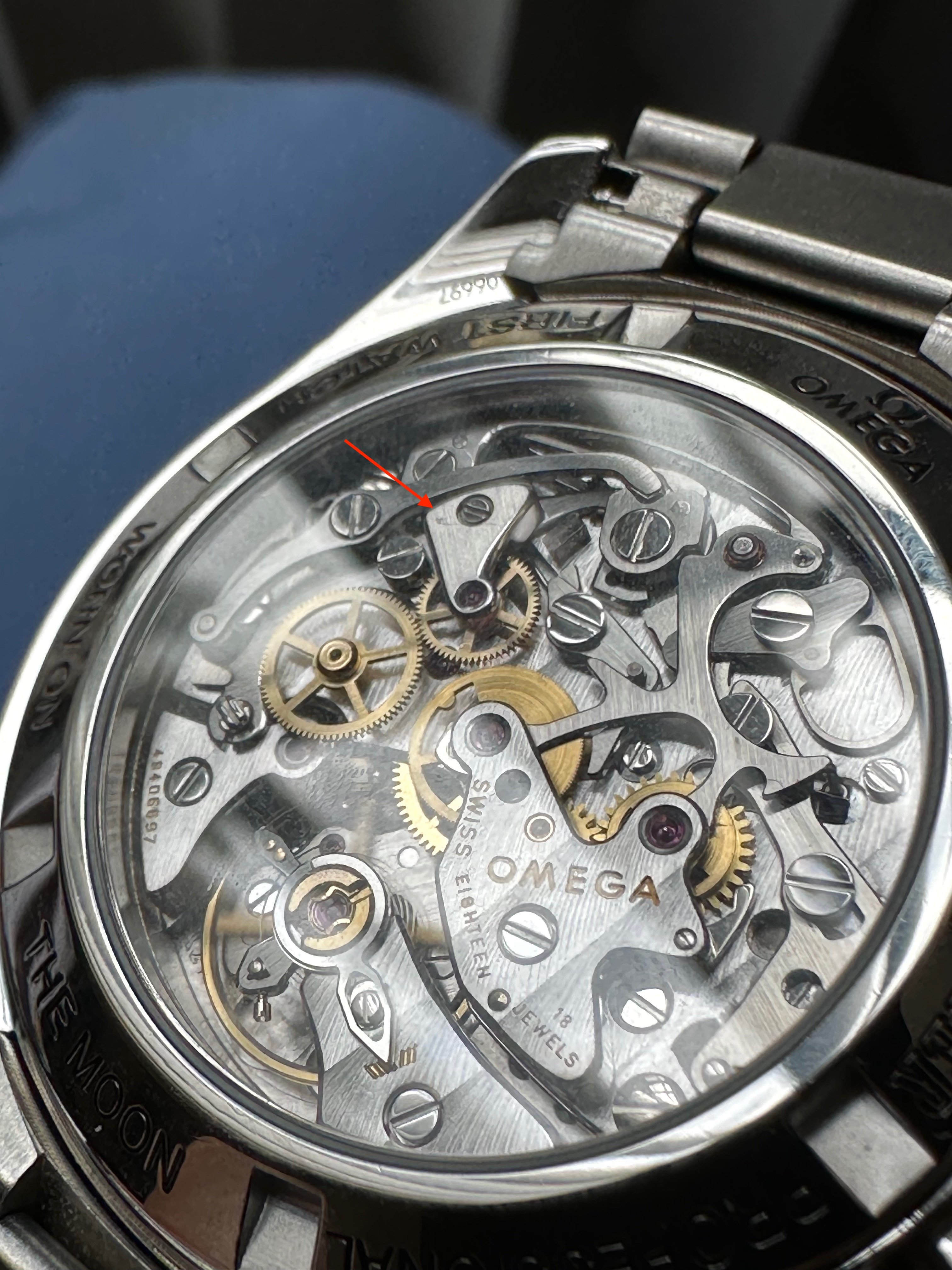

My Speedmaster is finally back after having spent 6 months at the Omega service center. Fortunately, it seems to be functioning well. Less fortunately, there are still a few superficial marks left on the movement, though they are less noticeable now:
I was curious what the service report from the Omega Service Center would say about the state of the movement after having been "serviced" by the local watchmaker. Unfortunately, the report had been misplaced and could not be found when I went to pick up the watch today - I actually do not believe this was intentional. It does seem to me, though, that a larger than expected number of parts had to be replaced:

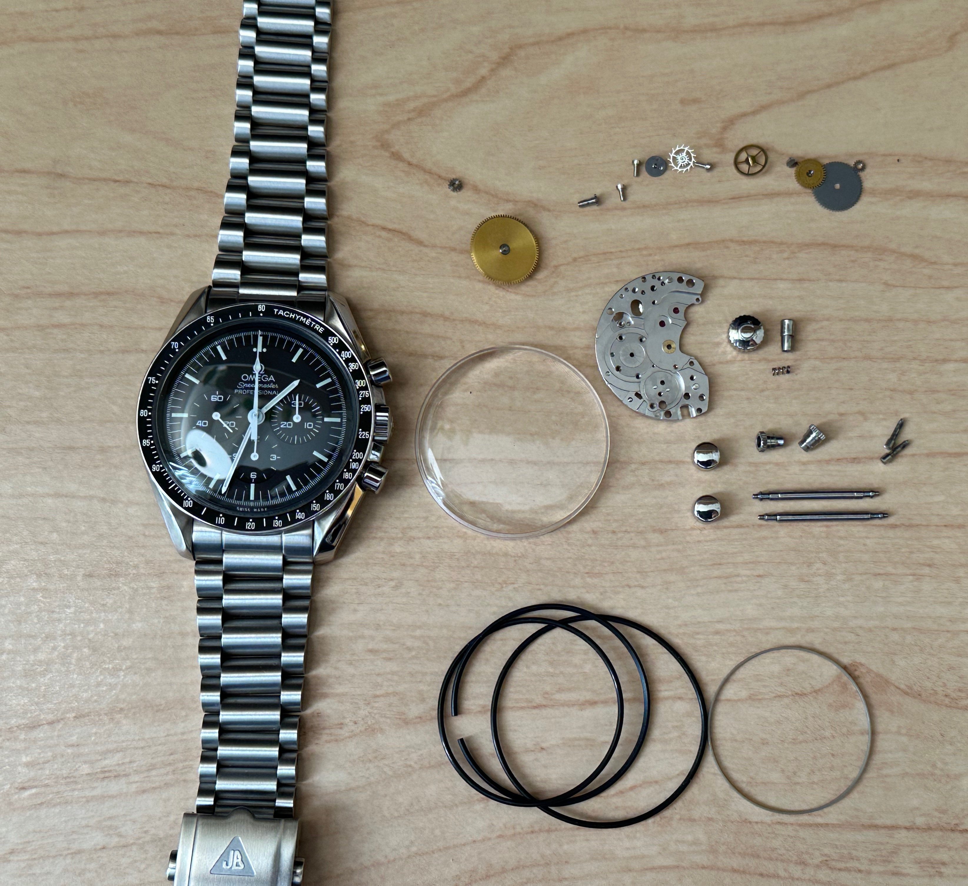

Not really. Service at the brand service centre tends to be quite wasteful in some ways. So for example the barrel assembly is replaced as a unit, rather than just replacing the mainspring, which is usually all that needs replacing. In this case, they didn’t even bother taking the barrel apart to see if any of the other parts are worn...they just replace the entire thing and are likely discarding perfectly good parts.
Not sure why they replaced the bridge...possibly due to damage from the previous service. Usually the main wear spot is the hole that the barrel arbor goes through. I ream out the worn hole and install a bushing, but Omega just replaces the whole thing. In general they replace rather than repair...

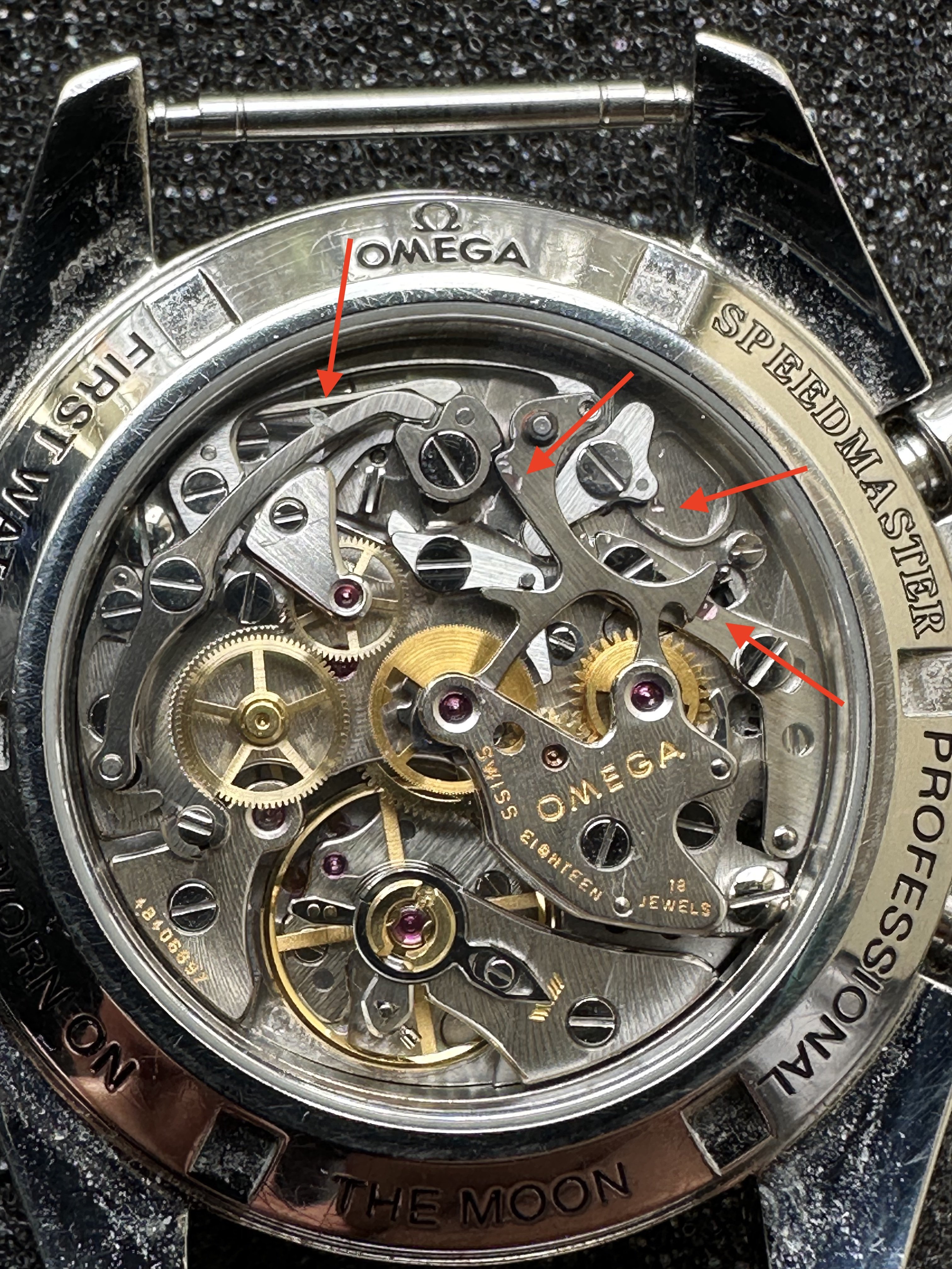

TL;DR - local Omega-certified watchmaker damaged my Speedmaster during a routine service. The store wants me to return the watch to him for repairs. Given his crappy handiwork, I think maybe I should instead fight for a refund and send it to Omega.
Longer version (with pictures!) - I dropped my Speedmaster off at a very well-regarded luxury watch store that has an in-house watchmaker. It was running fine, but was due for a routine service (last serviced in early 2018). The watchmaker bills himself as a "master watchmaker" and "horological MD". He has a certificate on the wall showing that he completed Omega factory training and there are numerous "Authorized Omega Service Center" signs around the service department area. His prices are identical to those of Omega. As it was easier to drop the Speedmaster off with him in person rather than packaging, insuring, and mailing it to Swatch, I could see no reason not to have it serviced locally.
About 8 weeks later, I get a call saying the Speedmaster is ready. After picking it up, I noticed the crown was rather tight and difficult to wind. It is also running -40 seconds/day (it was +5 seconds/day when I dropped it off). I emailed the watchmaker, who said he would look at it. I dropped it off, and picked it up again 3 days later. When I have some time later that evening, I fully wind the watch and set the time. So far so good. I check it an hour later and see that it has stopped running. Clearly something is off. I decide to look through the caseback and was rather pissed to see new scratches on the movement, scratched up screws, debris attached to the under-surface of the caseback, and multiple excessive drops of oil. Here are some pictures after the service:
Here are some before the service (unfortunately before the advent of the macro setting on the iPhone):
I obviously tried reaching out to the watchmaker expressing my concerns. He has decided not to respond. I then contacted the service department manager at the watch store directly, who expressed great concern and said to bring it back from them to look at and repair.
So my question to the sages of OF: Would you bring the Speedmaster back to the same watch-butcher, I mean "Horological MD"? Or would you demand a refund and send it off to Omega for repair? Thoughts? I am not going to name and shame, as I hope to come to an amicable solution with the watch store (which has been great up until this point).
