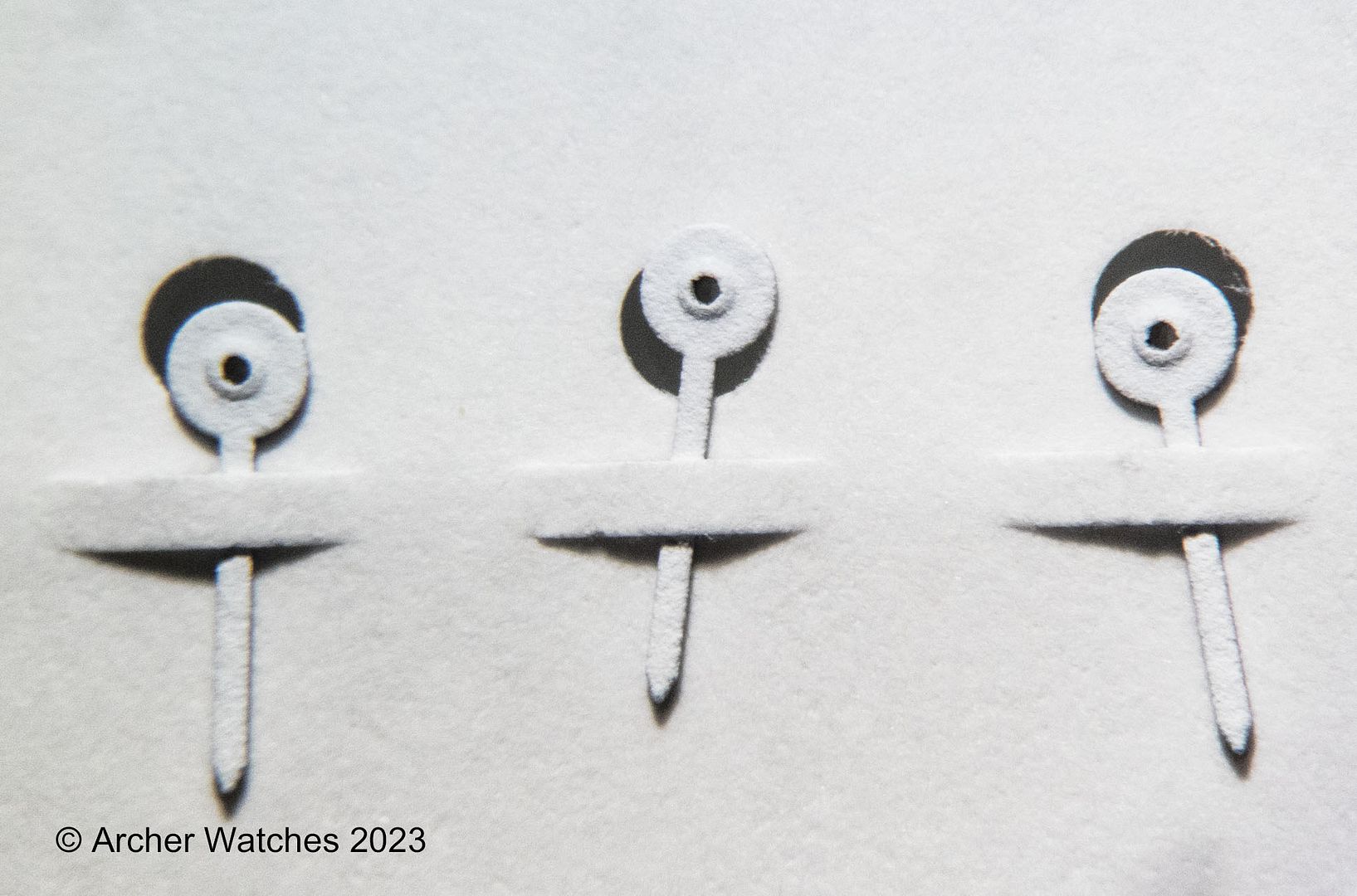

In terms of the hand shape and finish, these do have some variation. Here's my current stock of minute counter hands (these were ordered directly from Omega):
Looking at 3 of them under a microscope, the finish looks similar to the one he replaced:
You will also note that the one on the far right appears to be slightly thicker than the other 2. This variation is within one single order of hands, so the fact that your hand looks slightly different to me is not a sign that it is some aftermarket hand.
