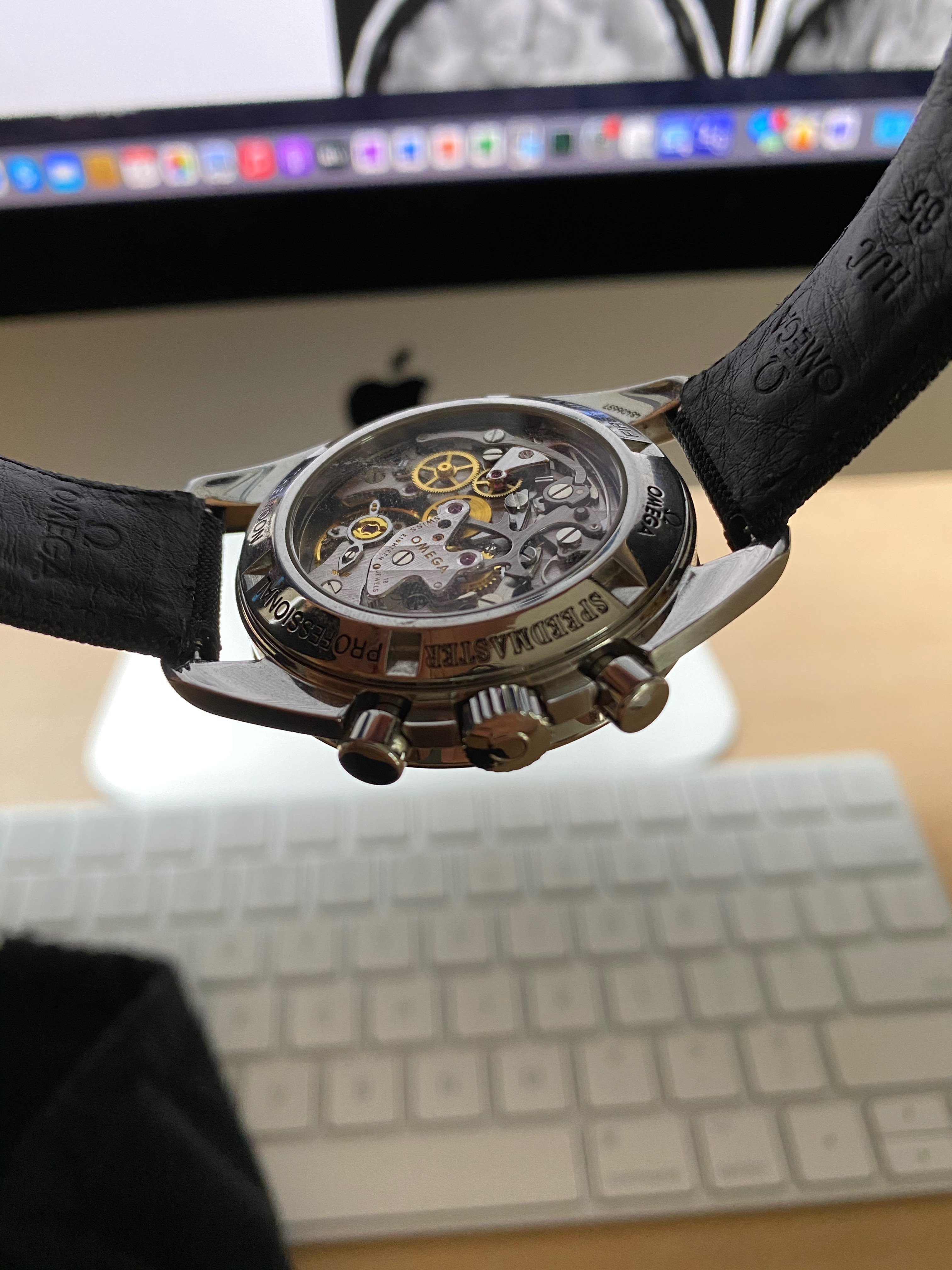

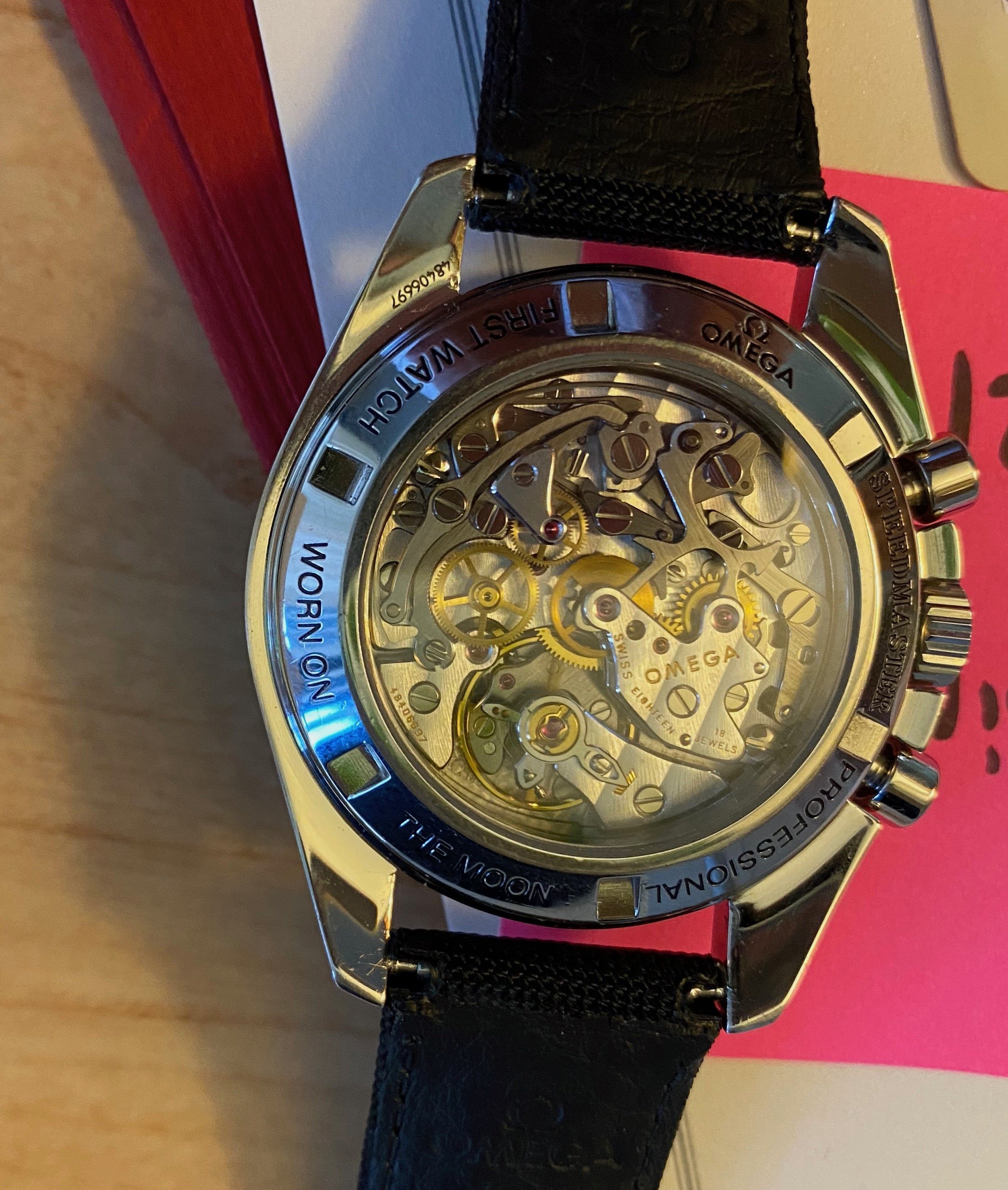

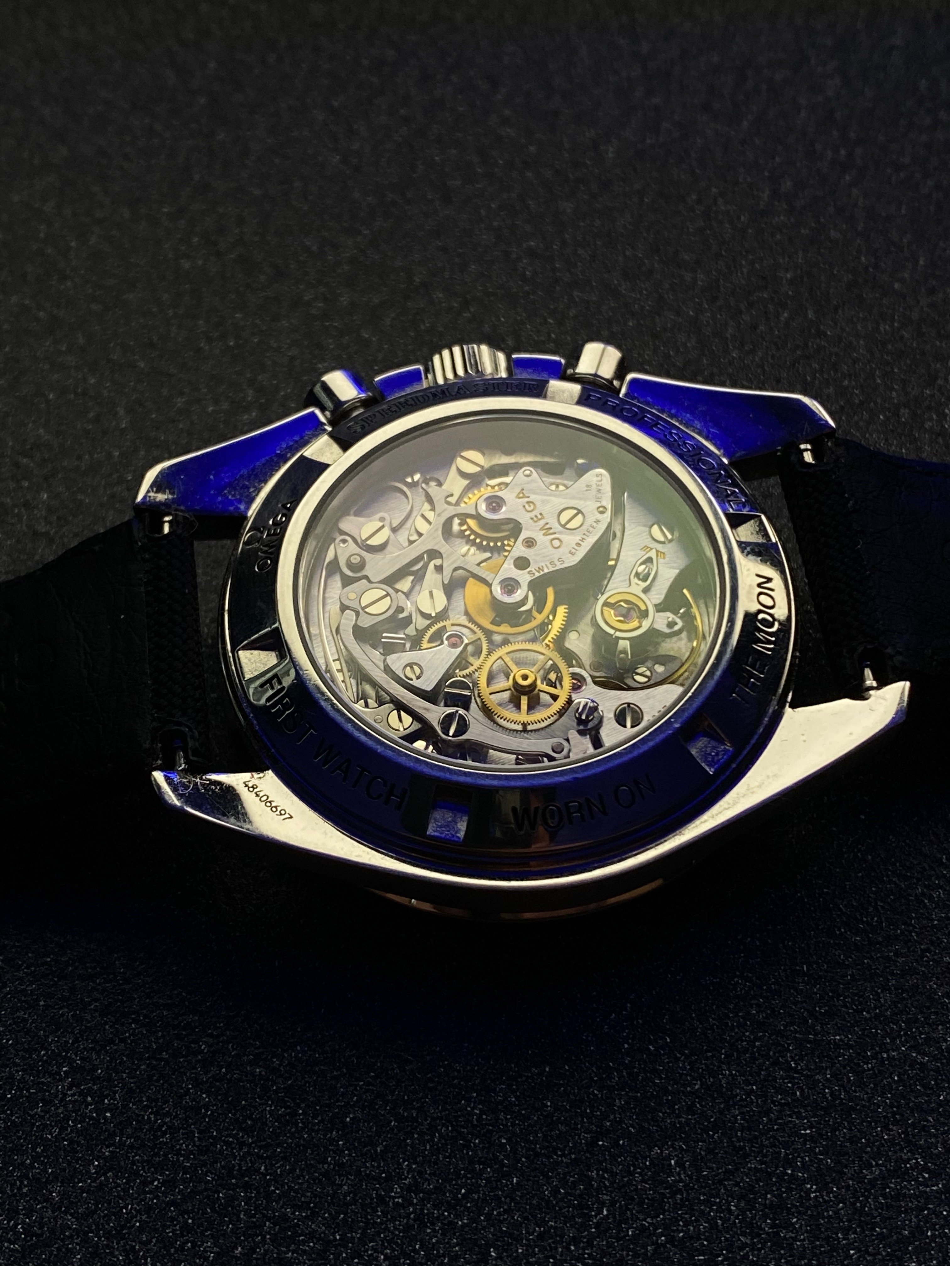

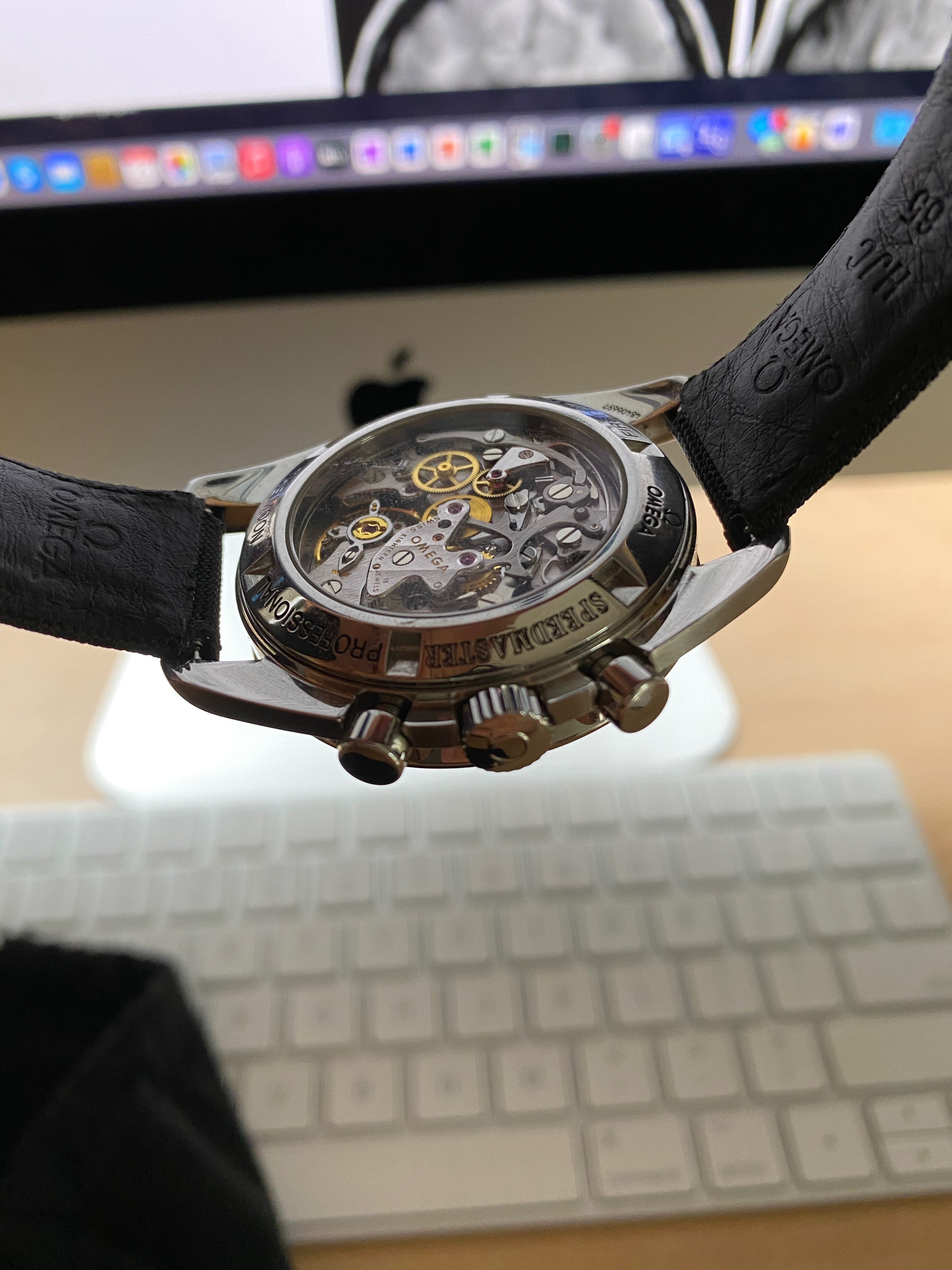

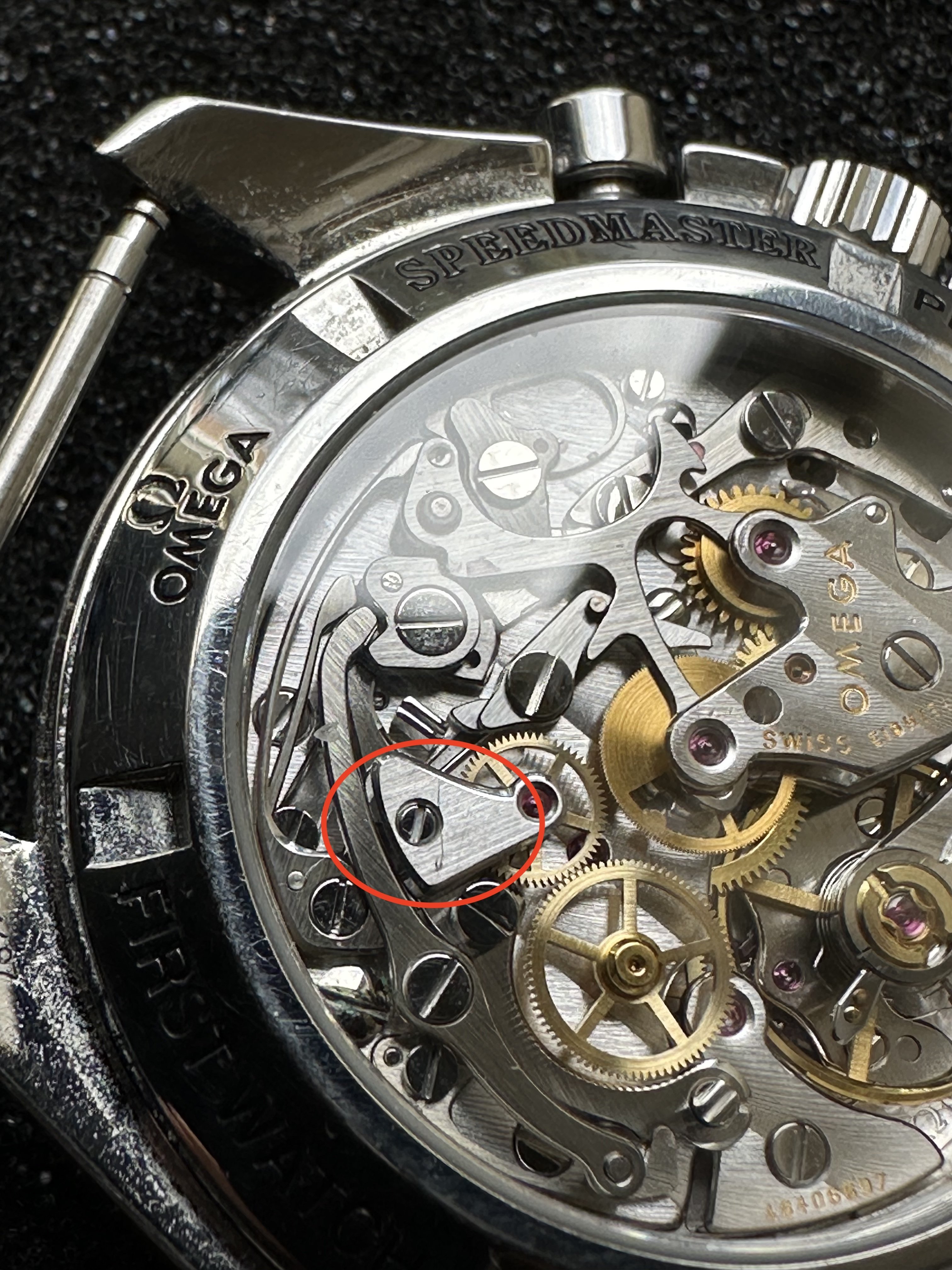

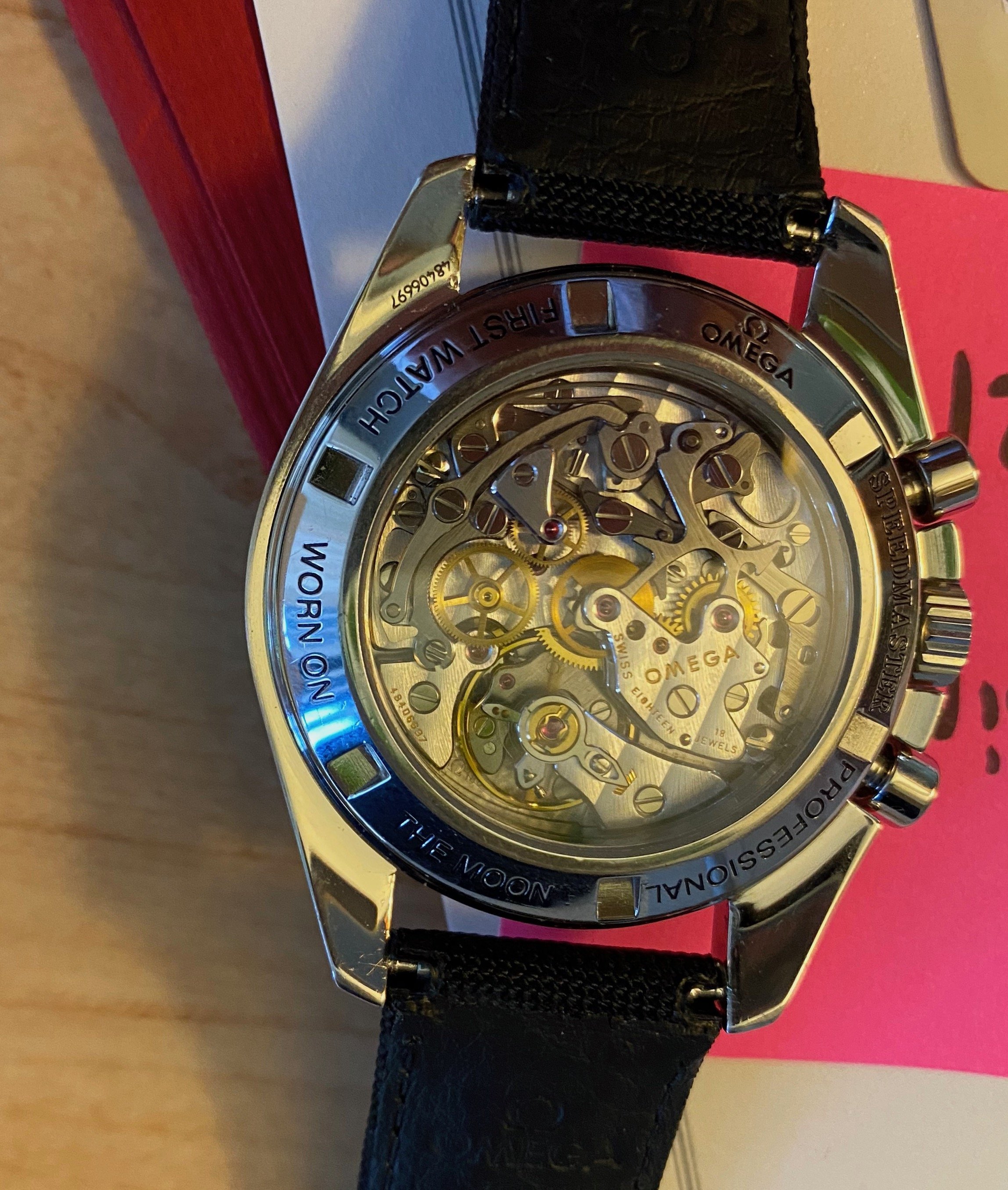

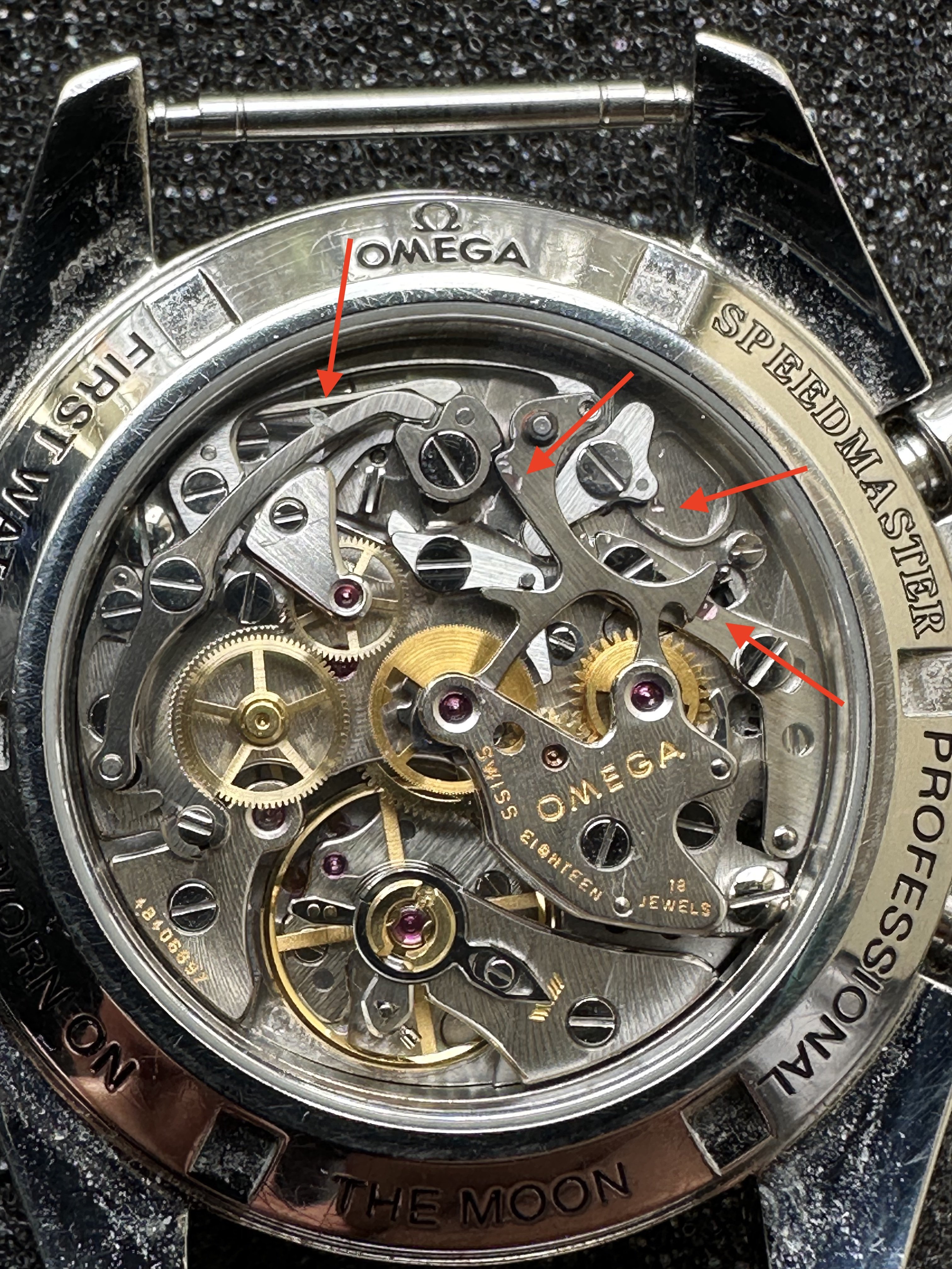

Longer version (with pictures!) - I dropped my Speedmaster off at a very well-regarded luxury watch store that has an in-house watchmaker. It was running fine, but was due for a routine service (last serviced in early 2018). The watchmaker bills himself as a "master watchmaker" and "horological MD". He has a certificate on the wall showing that he completed Omega factory training and there are numerous "Authorized Omega Service Center" signs around the service department area. His prices are identical to those of Omega. As it was easier to drop the Speedmaster off with him in person rather than packaging, insuring, and mailing it to Swatch, I could see no reason not to have it serviced locally.
About 8 weeks later, I get a call saying the Speedmaster is ready. After picking it up, I noticed the crown was rather tight and difficult to wind. It is also running -40 seconds/day (it was +5 seconds/day when I dropped it off). I emailed the watchmaker, who said he would look at it. I dropped it off, and picked it up again 3 days later. When I have some time later that evening, I fully wind the watch and set the time. So far so good. I check it an hour later and see that it has stopped running. Clearly something is off. I decide to look through the caseback and was rather pissed to see new scratches on the movement, scratched up screws, debris attached to the under-surface of the caseback, and multiple excessive drops of oil. Here are some pictures after the service:
Here are some before the service (unfortunately before the advent of the macro setting on the iPhone):
I obviously tried reaching out to the watchmaker expressing my concerns. He has decided not to respond. I then contacted the service department manager at the watch store directly, who expressed great concern and said to bring it back from them to look at and repair.
So my question to the sages of OF: Would you bring the Speedmaster back to the same watch-butcher, I mean "Horological MD"? Or would you demand a refund and send it off to Omega for repair? Thoughts? I am not going to name and shame, as I hope to come to an amicable solution with the watch store (which has been great up until this point).

The text on the caseback is in a different position in the after shots... almost like it wasn't screwed down enough. You might have some water resistance issues.

My advice would be to take it back to them, and insist they send it to Omega for a full repair, including replacement of the scratched parts, at their expense.
