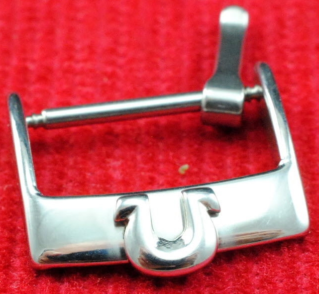

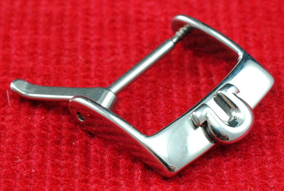

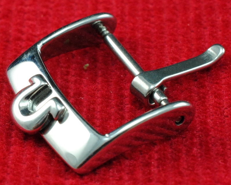

Hi Ross - Welcome to the forum.
Both are counterfeit.
Actually pretty much all of the buckles offered by this seller are reproductions.
28
13
Good thing I came here first, thanks for the help!! Can you point me in the direction of a reputable buyer?

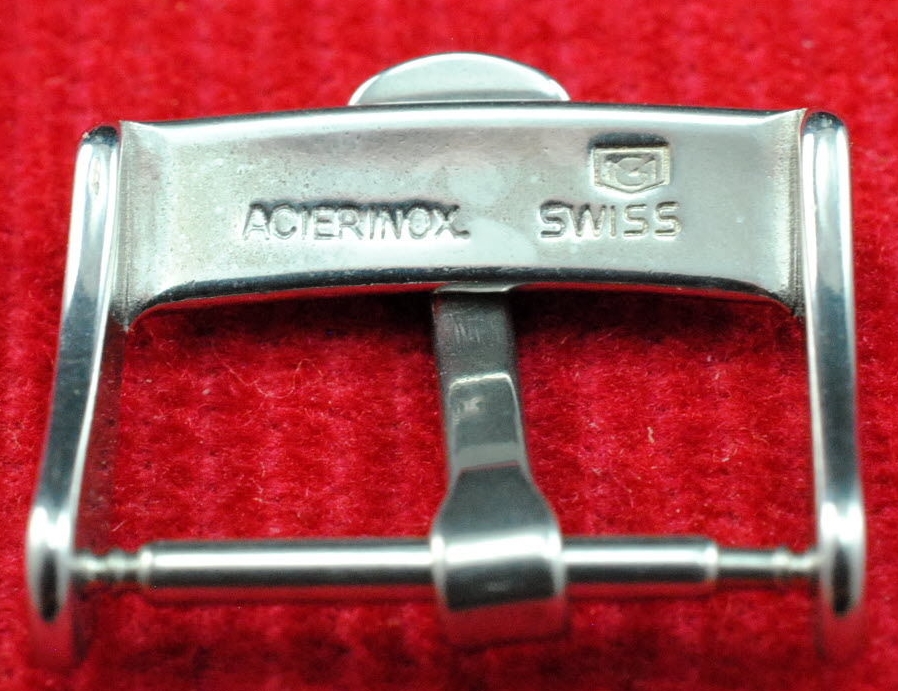

Yes it is well done fake, look at the S in Swiss and the MG marking.

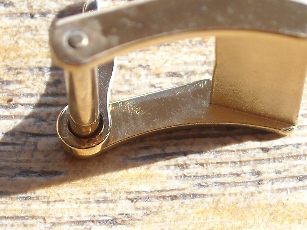

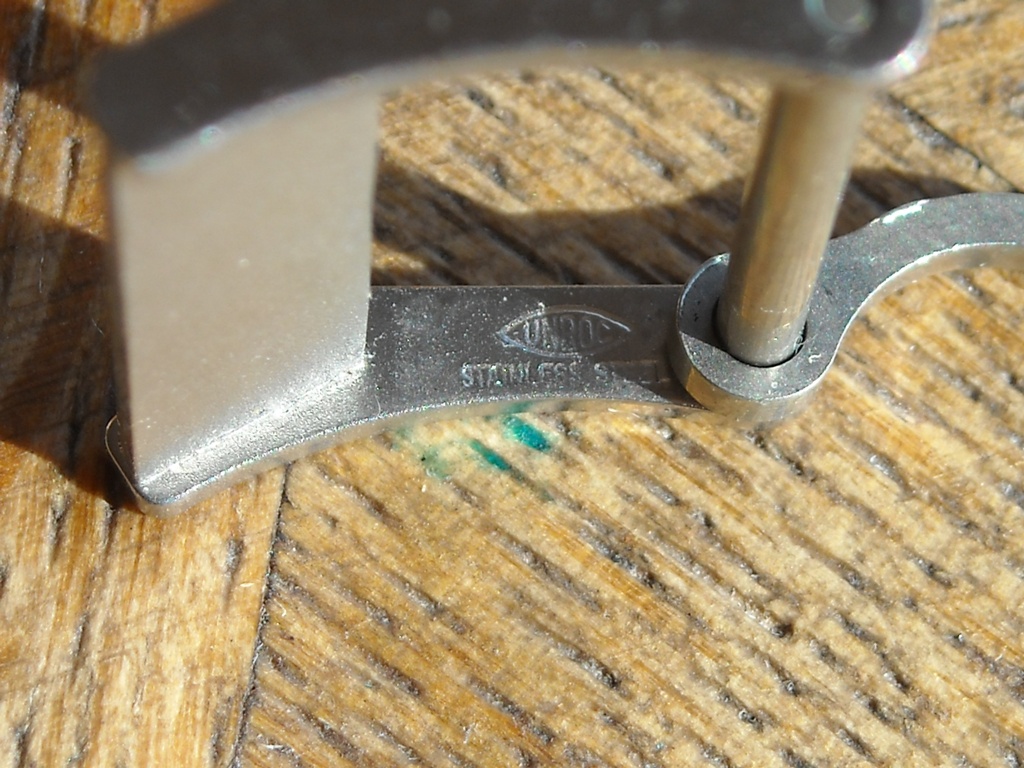

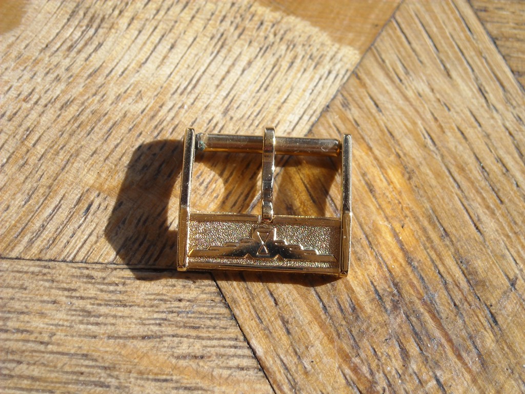

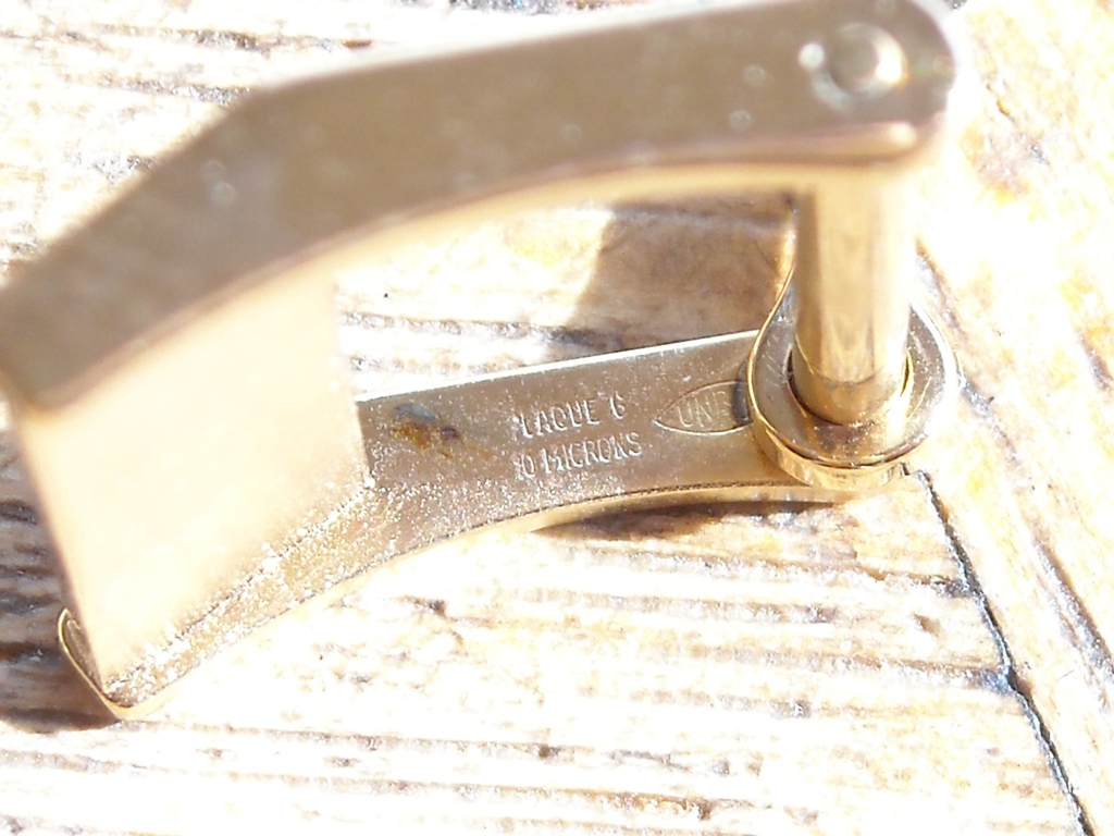

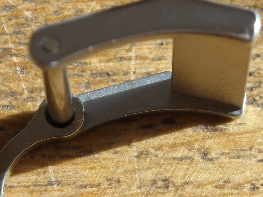

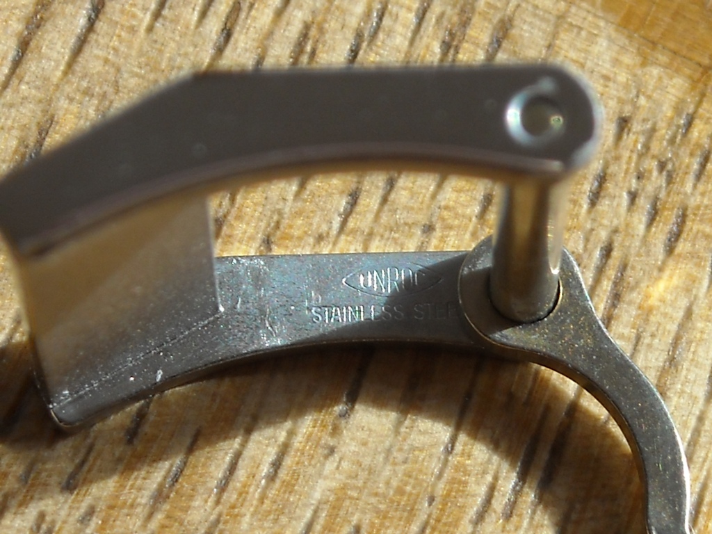

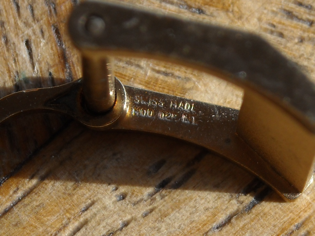

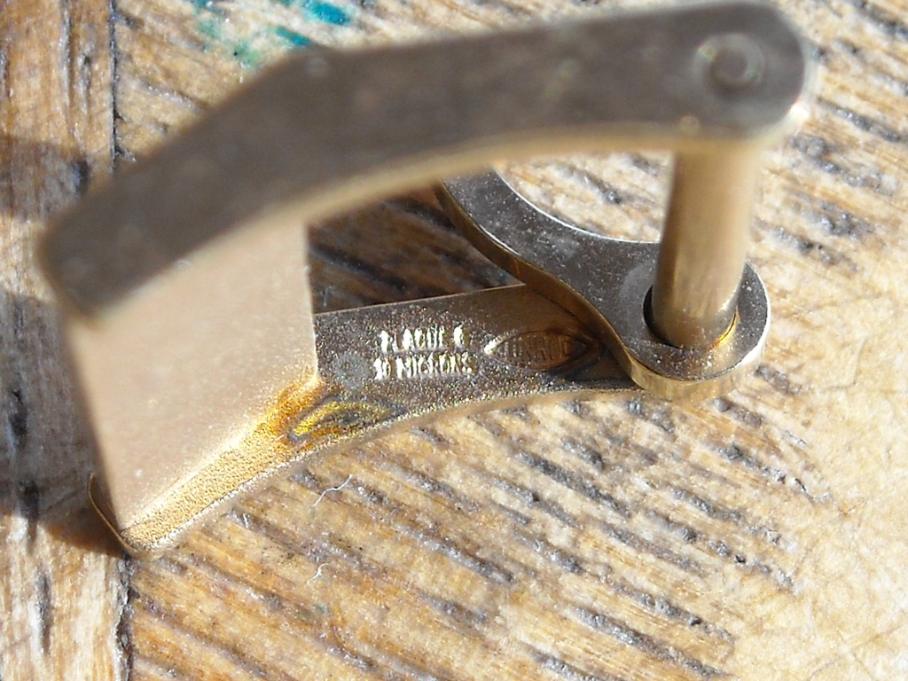

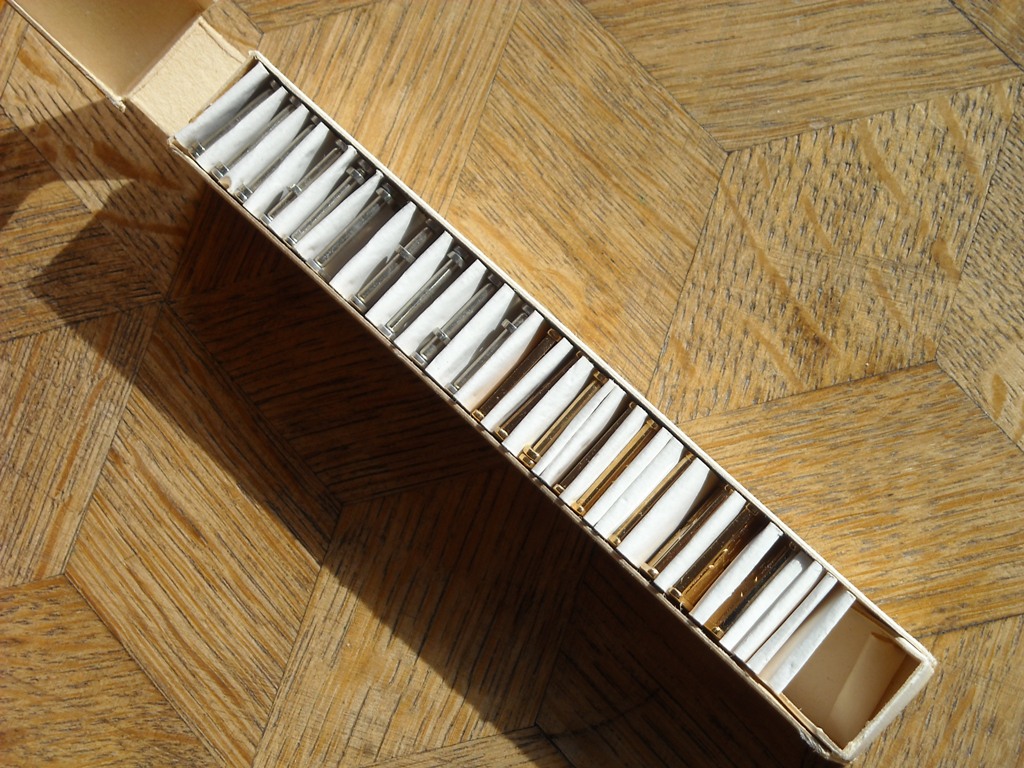

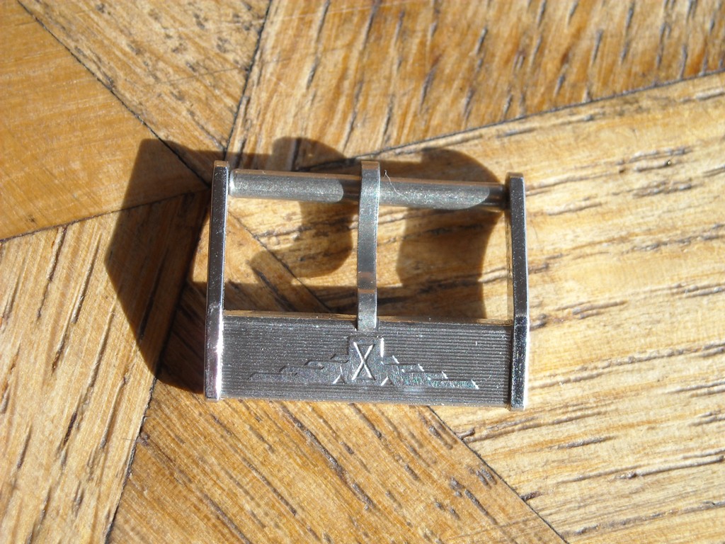

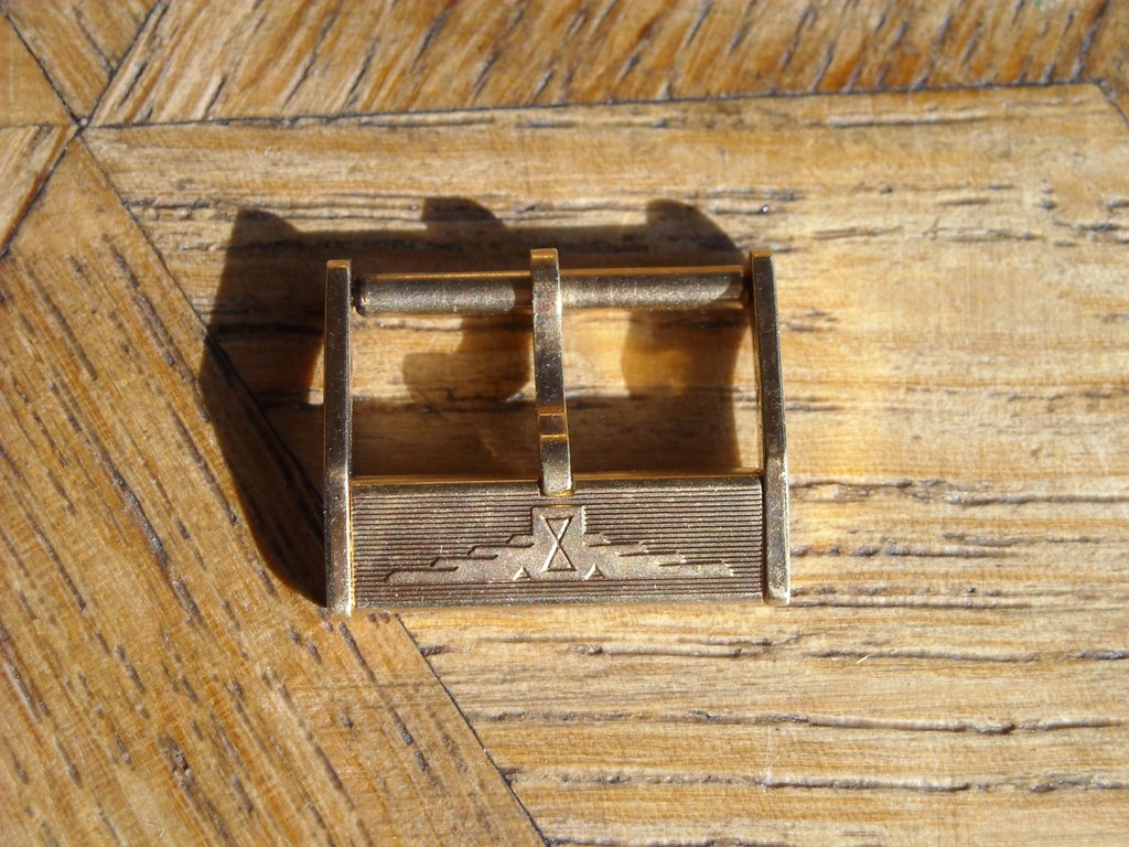

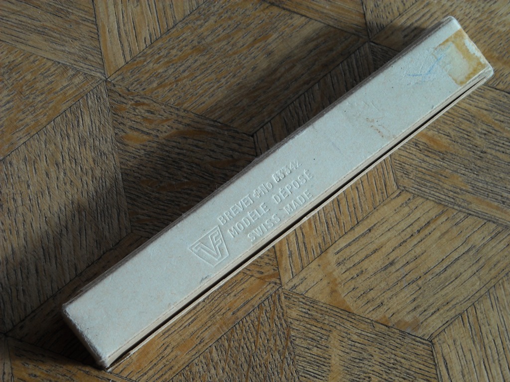

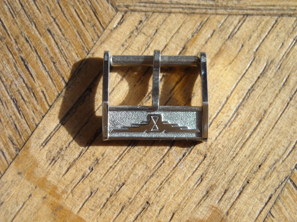

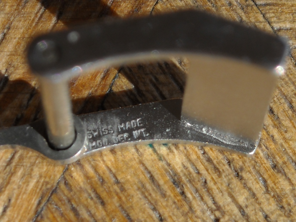

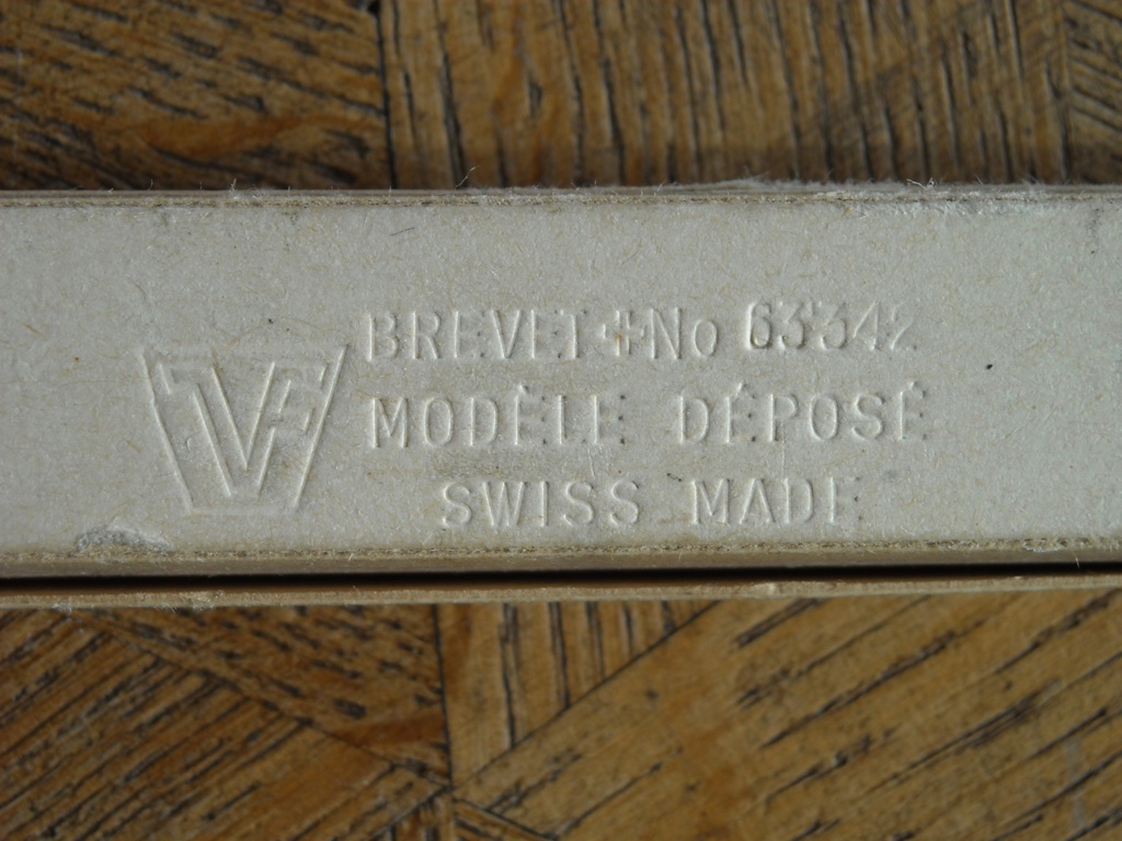

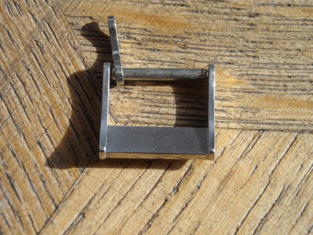

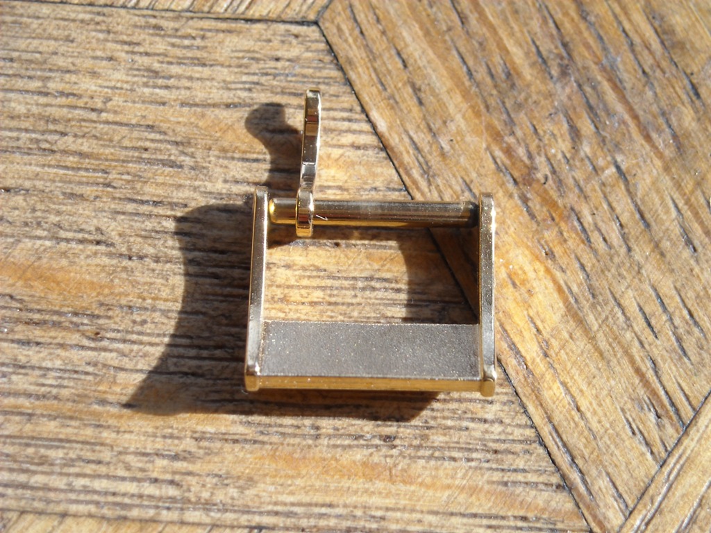

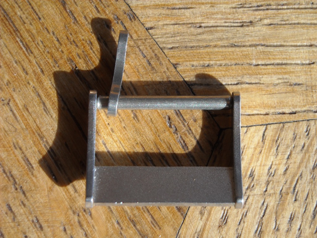

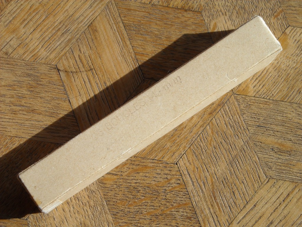

I have news that corroborate my theory. Swiss manufacturer are less Swiss (or square if you prefer) then we thought. We all live in the fear of buying fakes and frankens (including me) and start sweating when something is not like in the book or the forum...
Yesterday I bought 50 N.O.S. Longines buckles, some still in the manufacturer's box.
And guess what ? In the same box, some have one hallmark and some have none. Furthermore the other buckles of a different size have two hallmarks. Could any collector have imagined that in his worst nightmare ?
Here are the pics....
Box + Buckles from the box :
Some have no hallmark at all.
